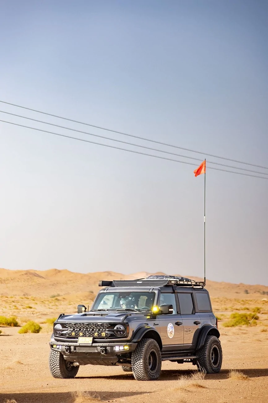

I live in Oman, where summer temps go well above 45°C (113°F).
This Bronco is my daily driver, dune car, and camping rig — so every modification had to make sense in real heat and real sand.
Wheels & Stance
• RRW RG3-H forged beadlocks
• 0 offset
• 25mm spacers
• OEM Goodyear Territory MT 35”
Suspension
• ICON Stage 7 (~2.5” lift)
• Upgraded control arms
• Adjustable track bar
• Factory skid plates retained
• Standard rear springs
Engine & Heat Management
Stock turbos, but upgraded supporting systems for airflow and temperature control.
Intake & Boost
• Injen intake
• Upgraded charge pipes
• Turbosmart diverter valve
• Ported throttle body
Cooling
• CVF intercooler
• Lower-temp thermostat
• Auxiliary fans
Exhaust
• CVF downpipe
• Full custom 3” exhaust (single outlet, resonator + muffler)
Supporting Mods
• Ford Performance spark plugs
• Ford Performance dual catch can
• Tuned by MPT
On local 98 fuel:
358 WHP / 435 WTQ
Lighting Setup
• 9 rock lights
Front Bumper
• 4 × Baja Designs S2 Pro
• 2 × Baja Designs Squadron Pro
A-Pillar
Grille
• 4 × KC HiLiTES amber LEDs
Rear
• KC amber HiLiTES used as a chase light
Headlights
• AlphaRex LED Headlights

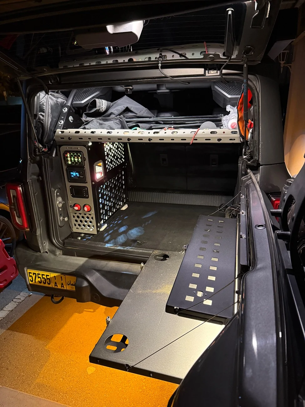

Overland & Electrical
• 120Ah lithium auxiliary battery
• Custom rear electrical box
• Fused distribution system
• Rear shelf
• Rear door fold-down table
Air System
• ARB air compressor mounted behind the spare
Exterior & Protection
• Vented hood
• Air Design fender flares
• Ford Bronco Raptor rear tire carrier
• Aphcarios roof rack + remote awning
• Full-body PPF protection
Monitoring & Recording
• ScanGauge
• Carabator screen
• Wolfbox G800 dual dash cam
If anyone is building for extreme heat or dune performance, I’m happy to share what I’ve learned.

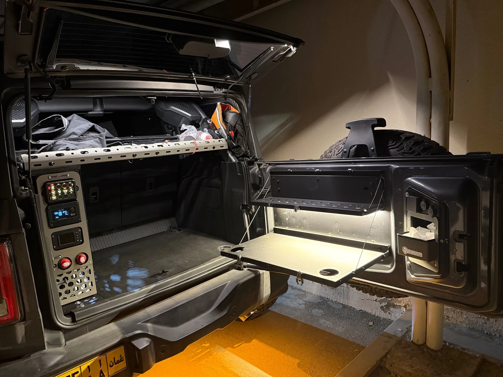

What lighting system are you using for your cargo space, I need exactly that!
It is a Chinese LED strip lights, i have a few in the back. I used to have them for outdoor use as well but i changed them to rock lights. You can use rock lights from amazon inside of the car. They are very durable and strong

Can you show more pictures of your electrical system? That enclosure looks sick
I have i video of it in instagram but it is in Arabic, but i think it will be clear for you. Please ask if you have any questions
