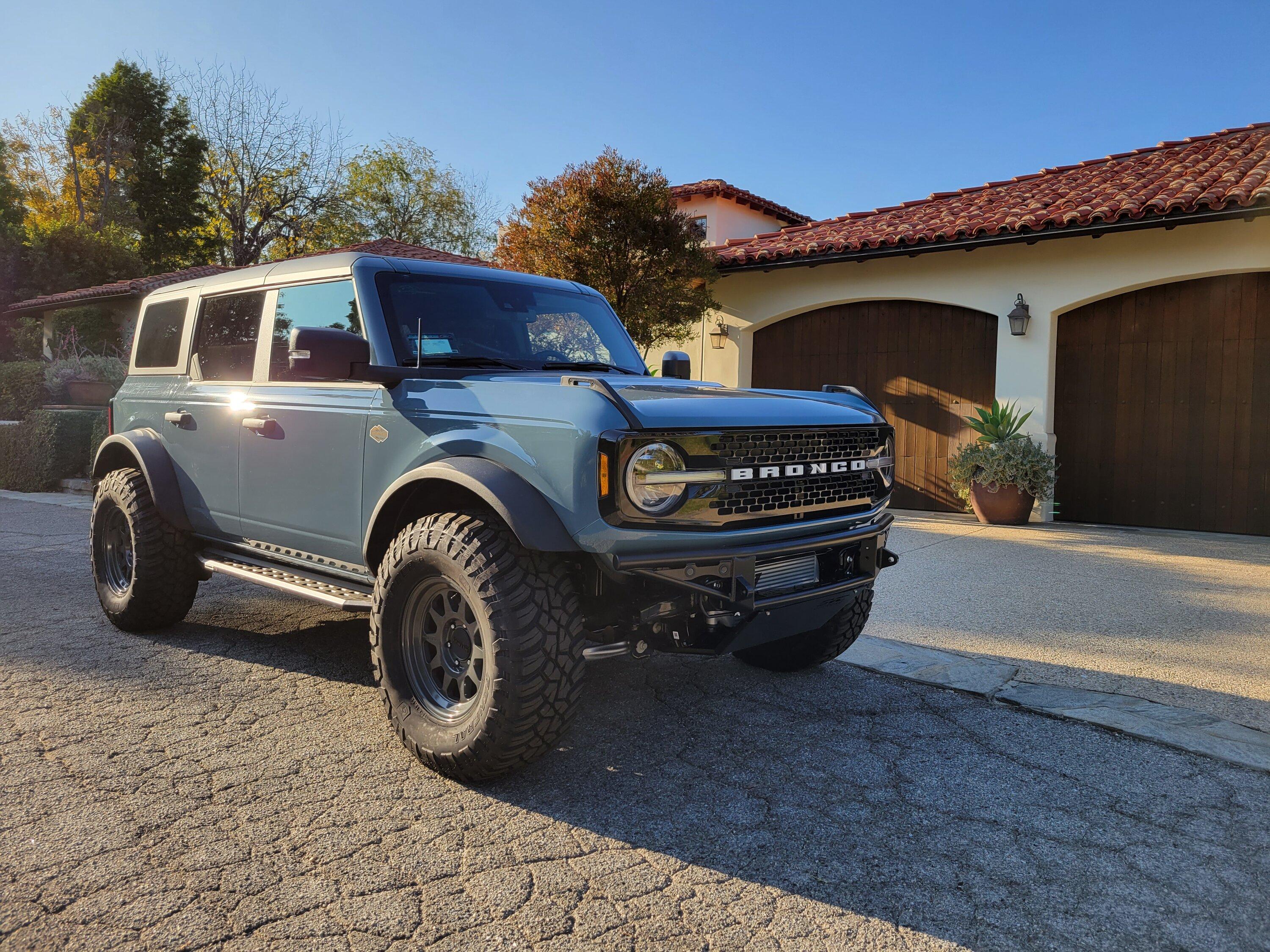

After 7 days of ownership and with 125 miles now on the odometer:
Ford Bronco 2022 4DR A51 Wildtrak - Desert Road Beast Build 20221214_152451

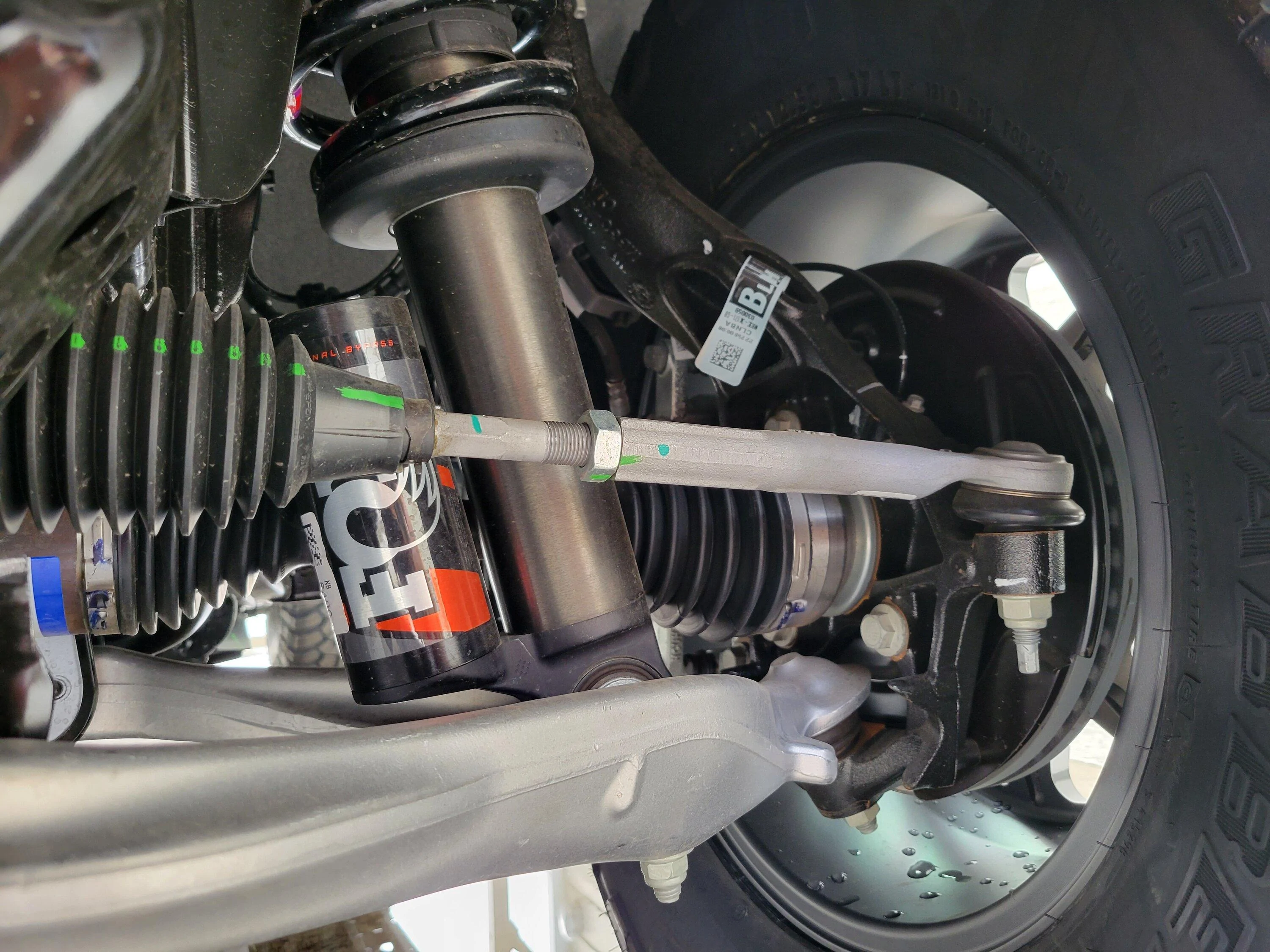

Nice! Have a MY 22 4dr Wildtrak awaiting shipment now. Very similar spec to you but ordered in cactus grey to match the raptor I have. MIC, Lux pack, Rack, HOSS 3.0, Leather, MOD bumper, etc. Looks like you ordered with the HOSS 3.0 judging by the orange on the wildtrak side logo. How do you like the ride so far? Would you mind sharing some pictures of the suspension for me? No one out there has posted too many pics of it. Already have some true 35’s anlong with RRW RH-6 rims sitting in the garage. Appreciate it and enjoy!

Sure, here you go:
Hoss 3.0 tie rod

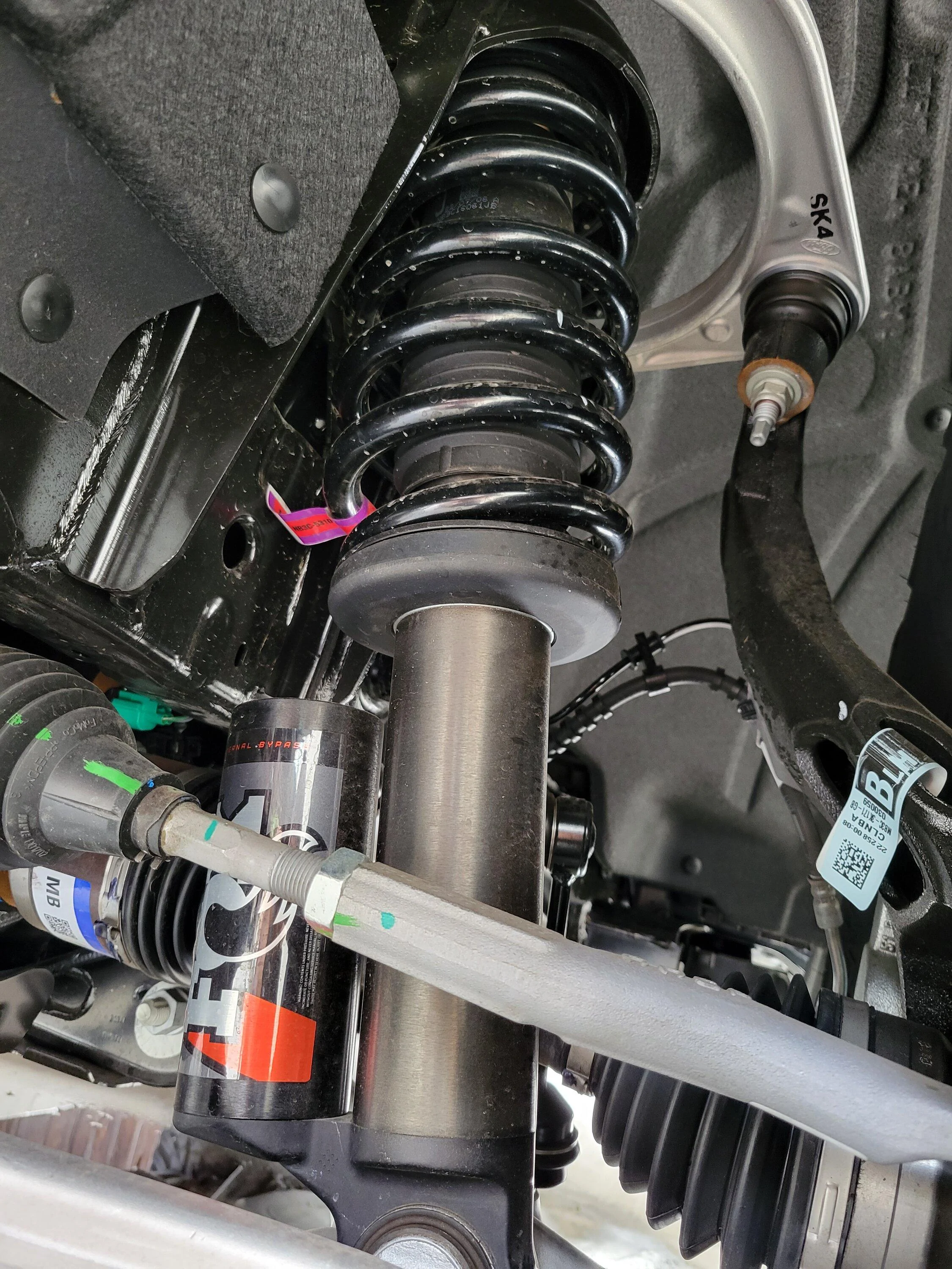

Front Hoss 3.0

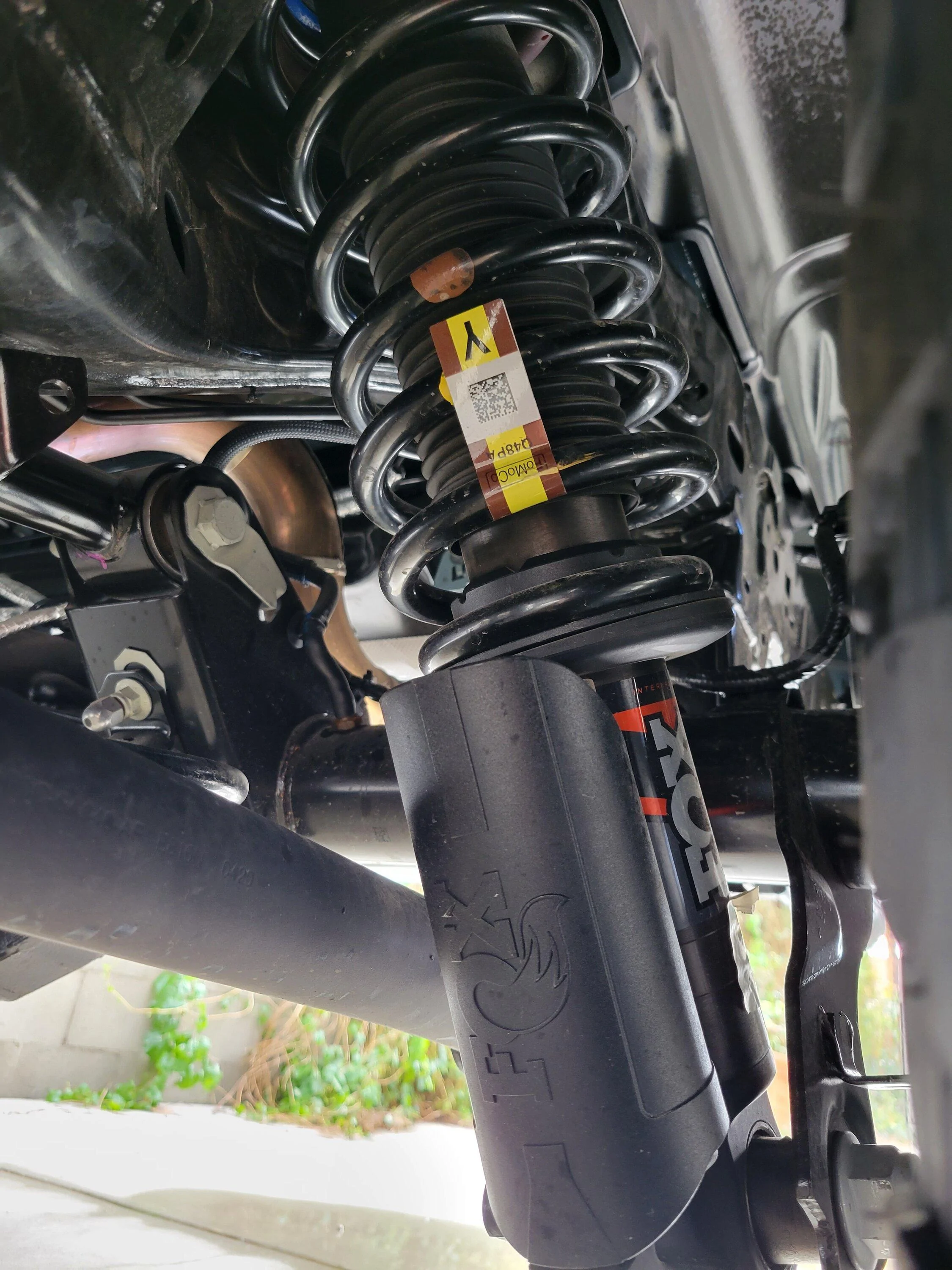

Rear Hoss 3.0

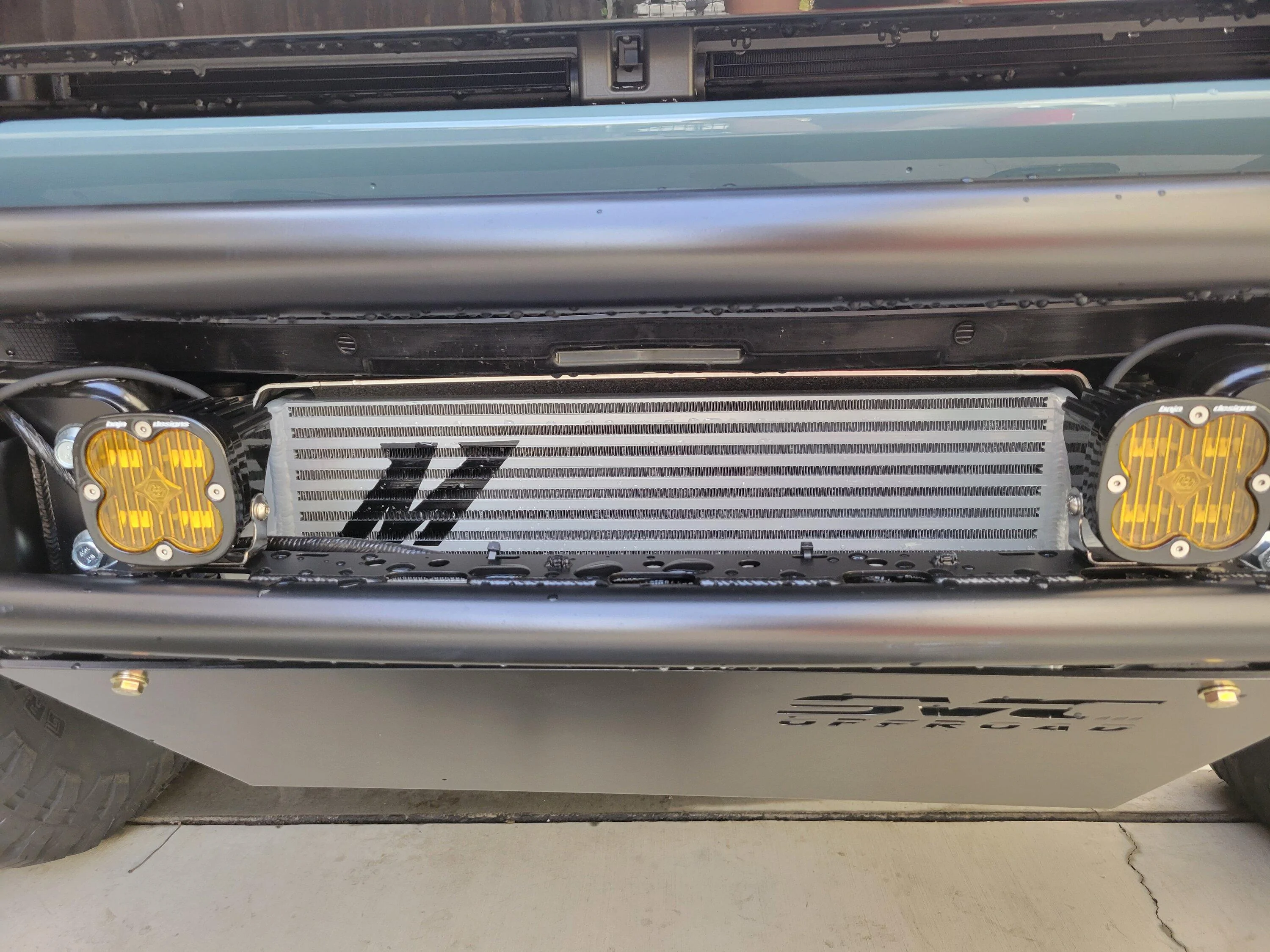

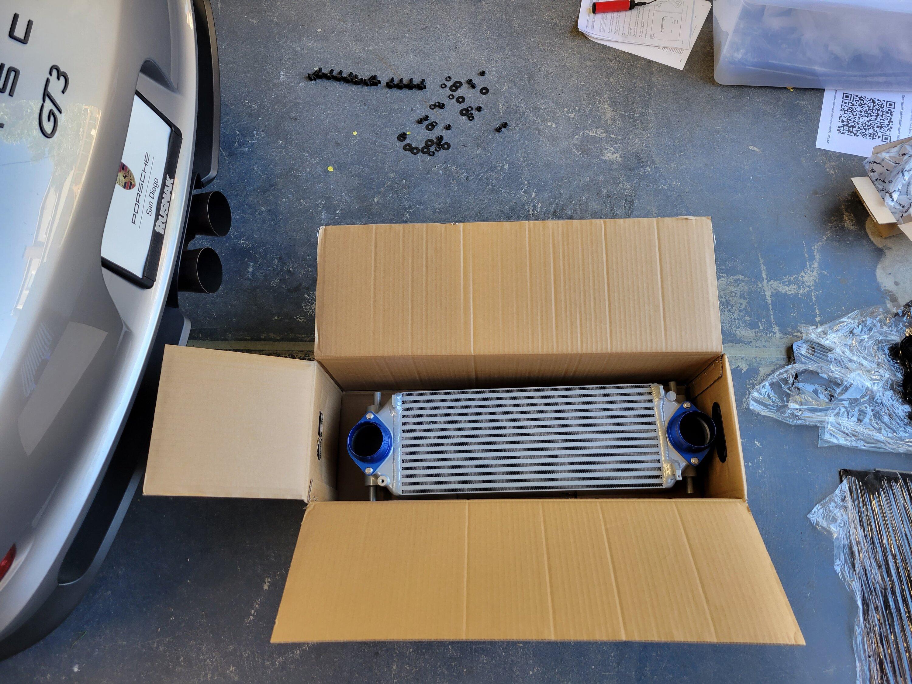

Mishimoto intercooler install was super easy. High quality product, and fitment is like OEM. With the bumper off, the intercooler swap took no more than 5 minutes.
Drove the brand new Bronco less than 40 miles while stock, so can't really make a comparison of stock vs upgrade. Chose not to install front shutters or flap vents behind the IC. The Mishimoto comes with attachment points and hardware to install like factory if desired.

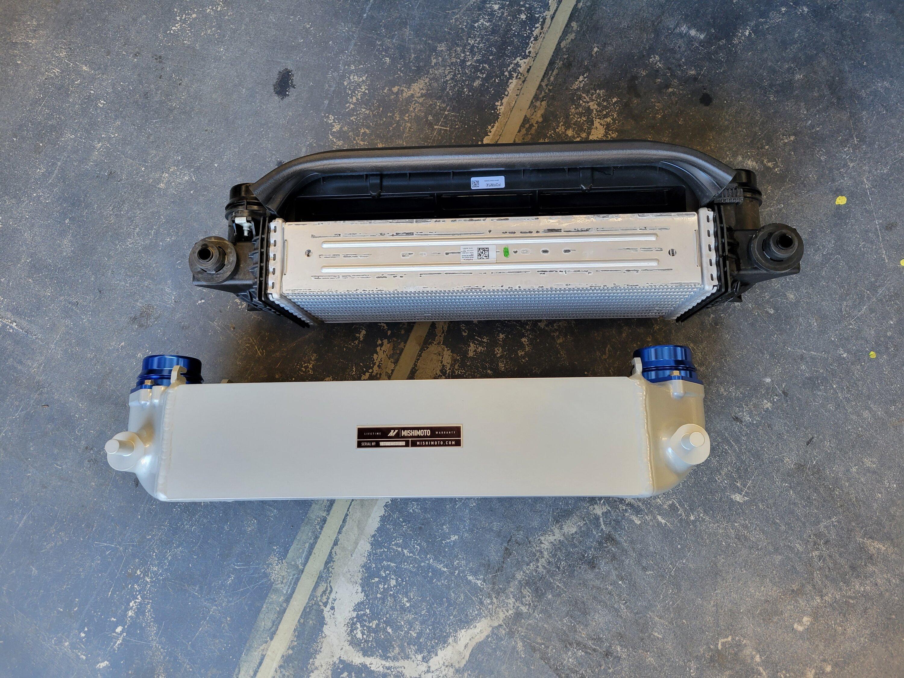

Intercooler came very well packaged, and includes hardware and machined & anodized hose fittings. The fittings did not come attached, and require a torque wrench with in-lbs along with blue loctite.
Ford Bronco 2022 4DR A51 Wildtrak - Desert Road Beast Build Mishimoto IC
OEM vs Mishimoto intercoolers
Ford Bronco 2022 4DR A51 Wildtrak - Desert Road Beast Build IC comparison
Installed. Could use a duct to keep air from flowing around the core.

Looks great. Those tires look huge compared to stock. I know those generals in 35 are about 1/2 larger in terms of height, but they appear bigger than that. How are the X3's onroad? I've been eyeing the General ATX, given i'm afraid the X3's are a bit too noisy onroad and my mix will be more onroad than off.

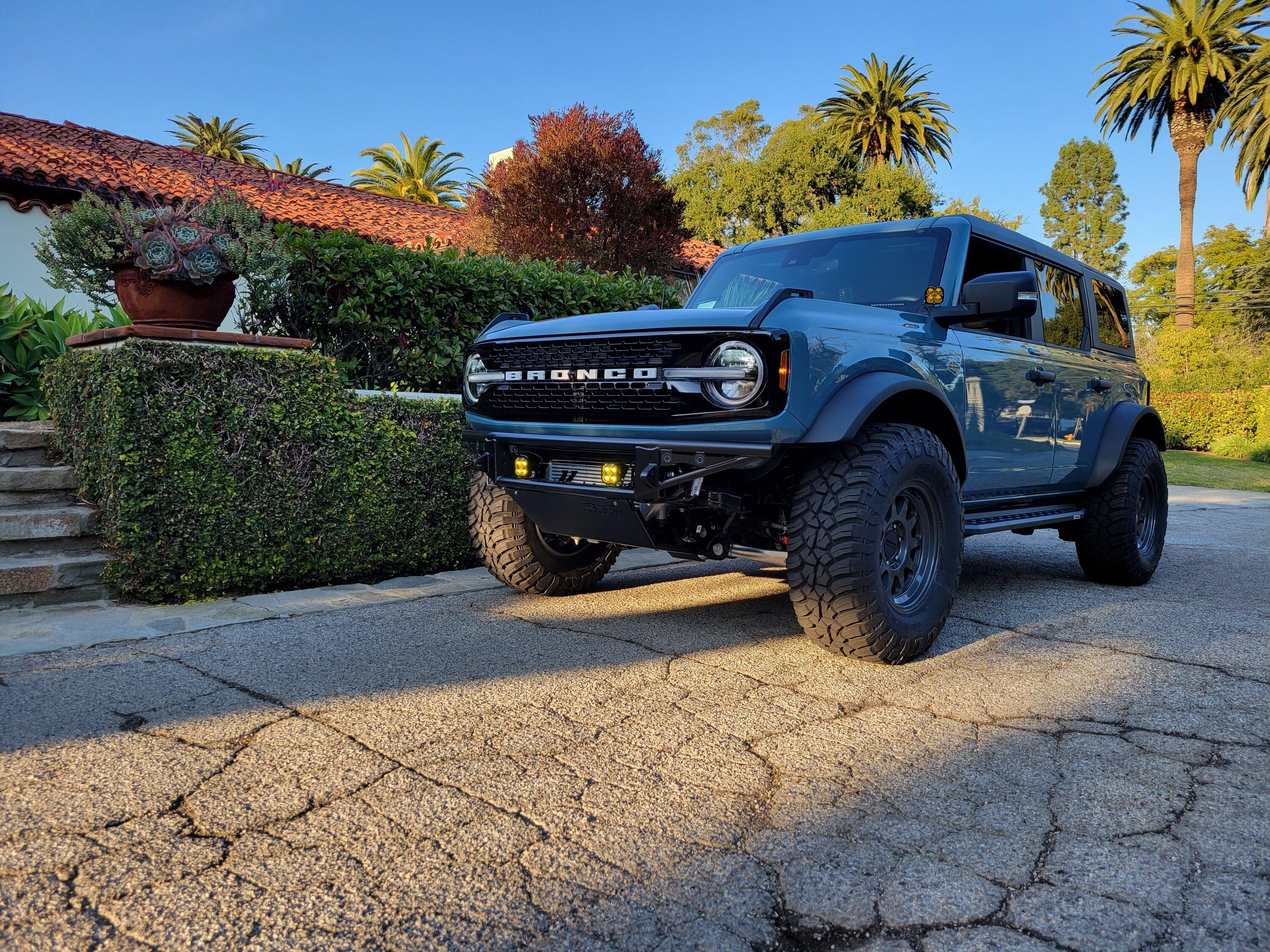

You're right that the X3's appear quite a bit larger than stock. Part of it is the 0 offset wheels pushing the tires out nearly 1.5" on each side, and the big lugs on the X3's make them about 0.5" taller than the factory tires.
I got them for going through sand and mud, though I think they also look pretty cool. It was painful for me though knowing they are a bit heavier than comparable tires, as I'm a huge fan of weight reduction and usually looking for the lightest parts possible.
35" tires are plenty big for the Bronco, and this wheel/tire combo already comes in around 100 lbs. Going bigger is nonsense IMO.
Road noise with the insulated hardtop seems average for these kind of tires. I'm used to sports cars with wide tires and not much noise control, and have quiet cars to go out with the family.
