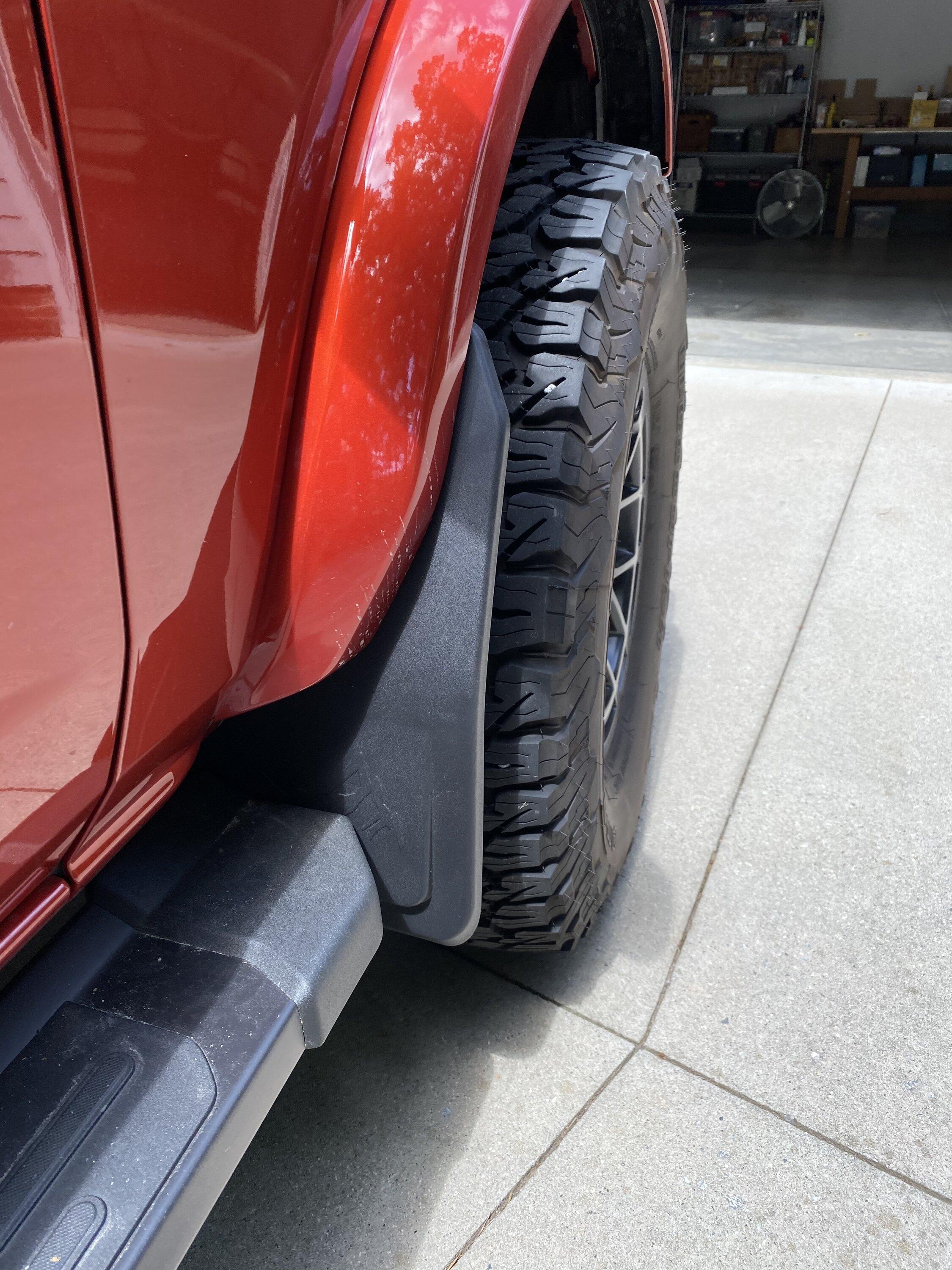

When I was looking to replace my stock OBX tires to something bigger, I wanted stay with a ”C” rated tire. All the larger 18” are “E” rated. Ended up dumping the OEM wheels and tires and went 17” RTR’s +30 and 315 KO2’s. Poke is a little over an inch. I installed Malbec front flaps and with the stock OBX running boards, I’ve had no chips so far, and I travel gravel fire roads a lot. Very happy with the KO2’s.

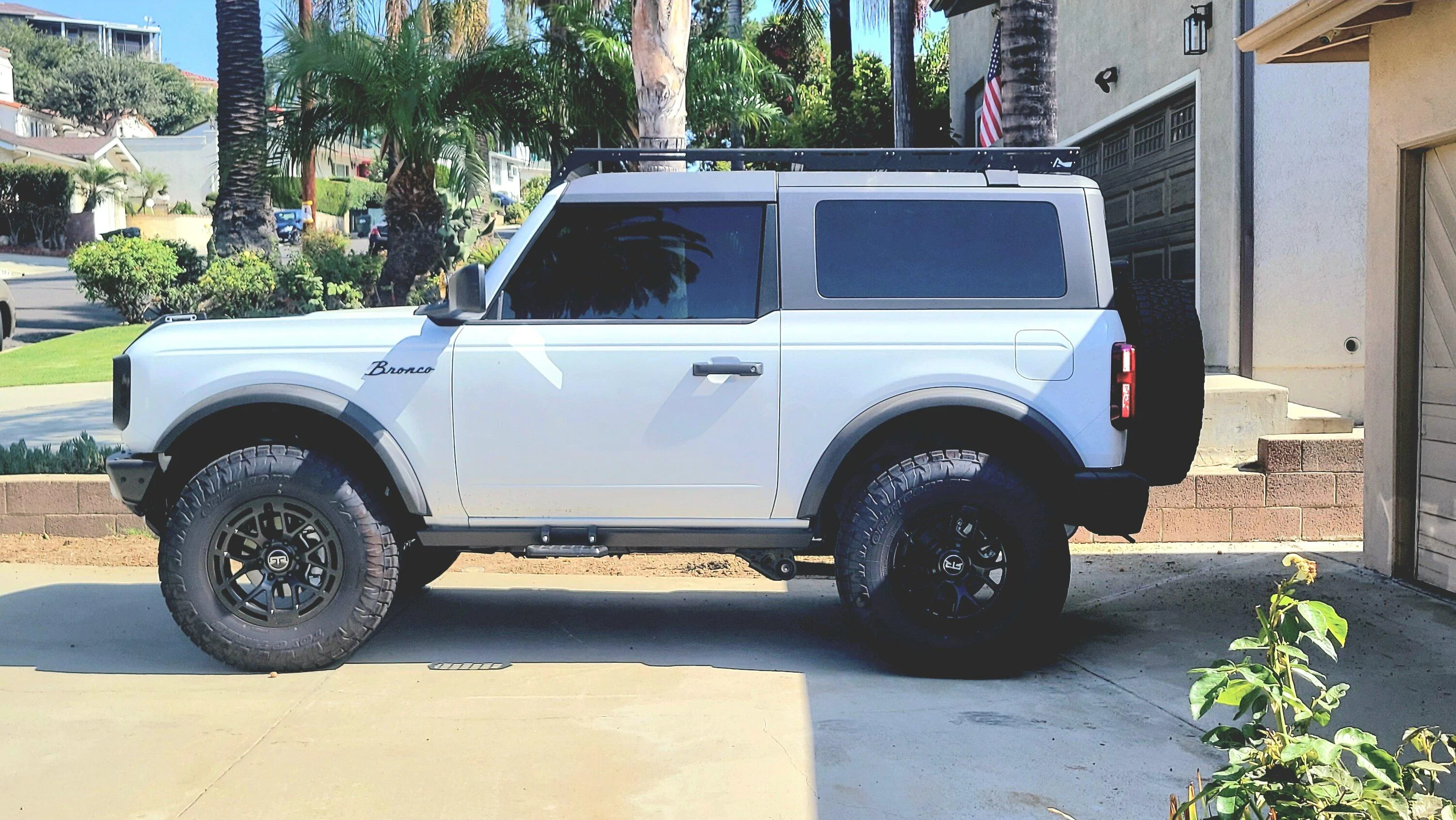

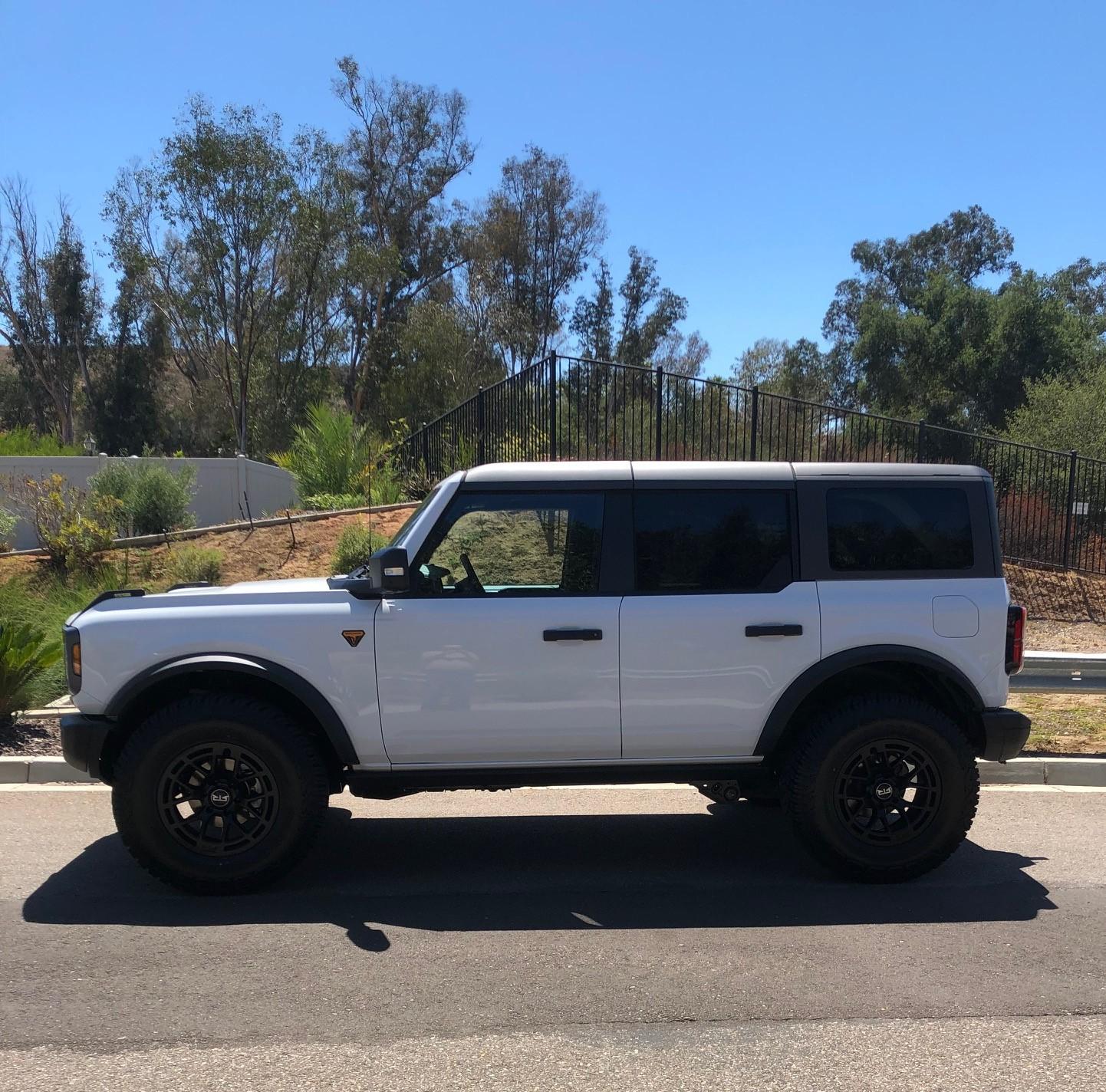

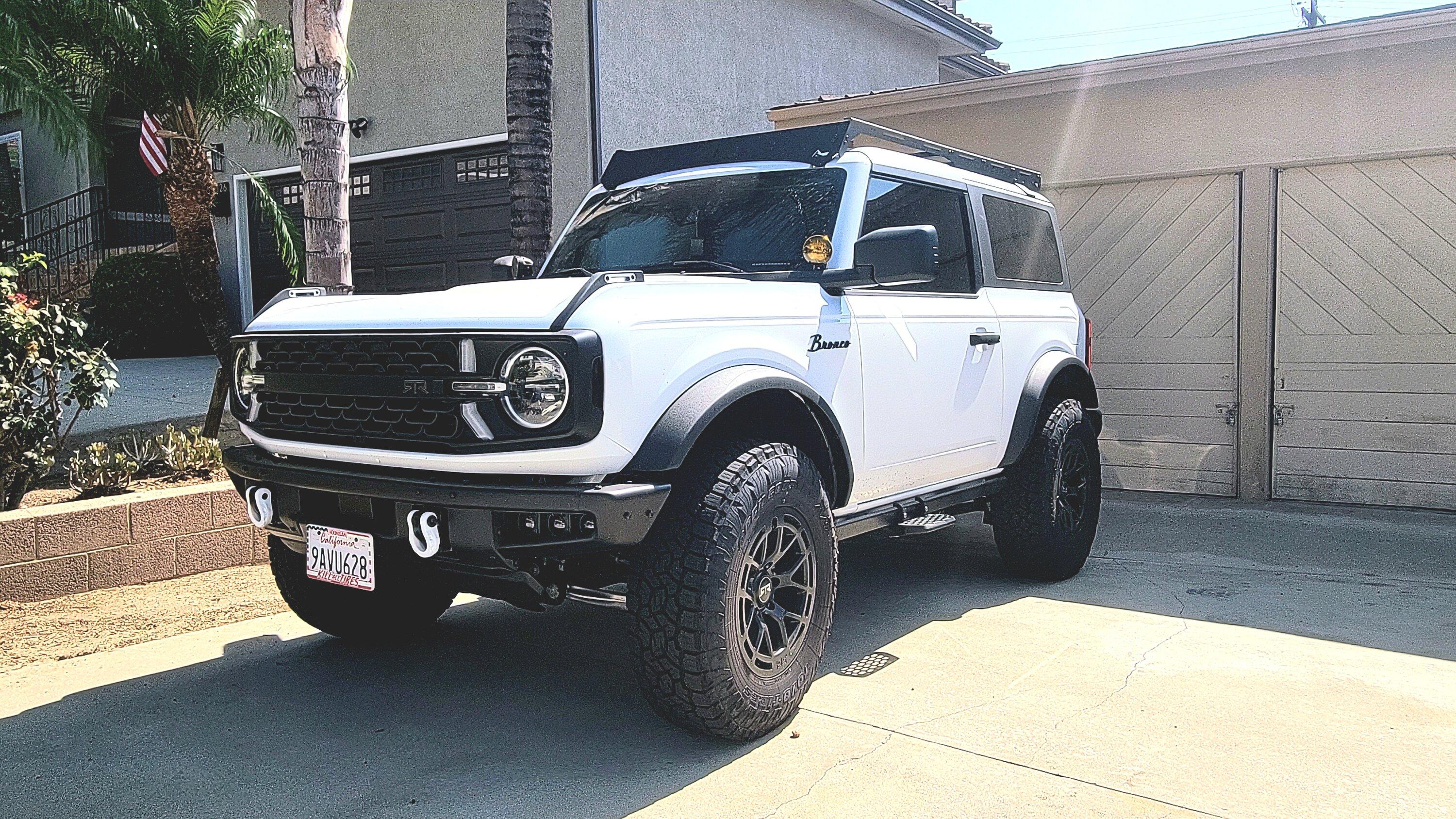

I changed my non-Sas badlands, from !7" to 18". 9" wide rims, with a "0" offset. I removed the crash bars and added 35" Geolander X-AT tires, with a Zone 2"/1" lift level kit.
