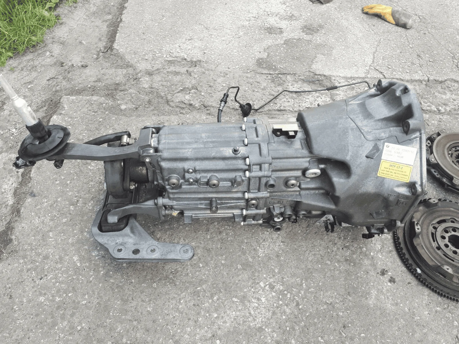

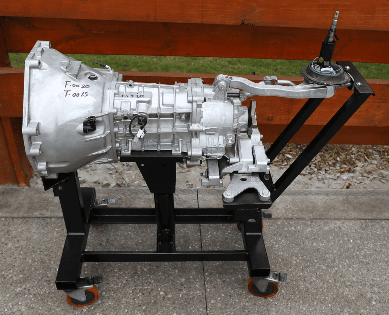

Sure, the MT-88 is a new design rated for more torque and more gears.
"The new Mustang GT500 is the same as the old Fiesta but it's just a new design with more power."
But like the MT-82, it also requires considerable external shift linkage, which was the past issue.
No it wasn't.
This is the area of my concern. Ford needs to ensure that this shift linkage issue is put to bed with a robust design on these "incomplete" Getrag gearboxes.
Tremec manual gearbox on top and Getrag below with external shift linkage.
Tremec gearboxes:
Ford Bronco 2.3 vs 2.7 1614782136261
Ford Bronco 2.3 vs 2.7 1614782182483

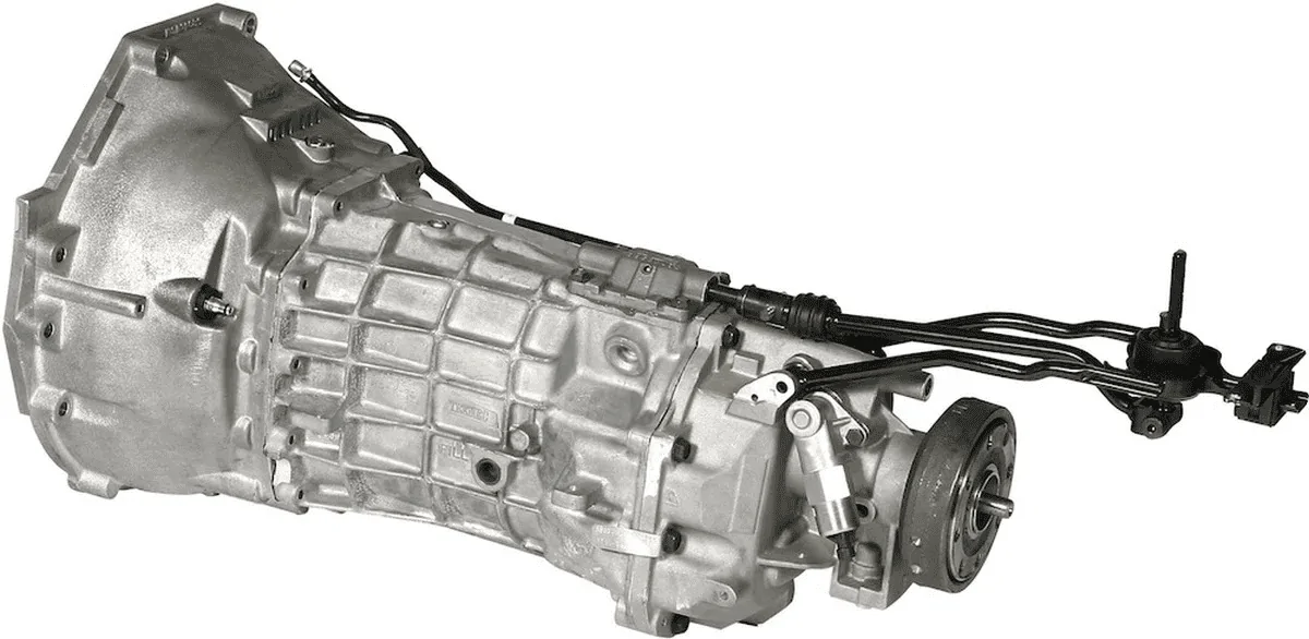

Here's the ZF transmission from a V10 M5:
Ford Bronco 2.3 vs 2.7 1614782655136
Remote-mount shifters are used to isolate the driver from NVH of the drivetrain and allow flexibility in locating the shifter between different models. Every OEM Tremec installation (ZL1, Hellcat, GT500, GT350, etc.) uses a remote shifter. You're thinking of the aftermarket Tremec transmissions where end users are just expected to punch a hole in their floor wherever the shifter lands.
