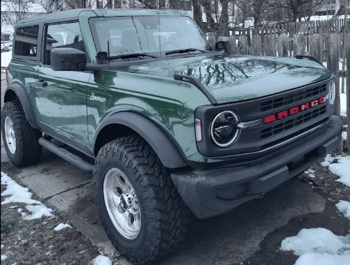

What wheels and tires did you install? Did you lift it?
Mickey Thompson Classic III, 17"x9"
Nitto Trail Grapplers 285/70/17
So overall 33", and no lift.
I don't plan to do a lot of off roading; probably just some sketchy dirt backroads and sand, but a lift would probably be wise if tackling more intense terrain

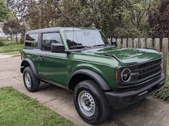

What tires can fit on the stock steelie rims?

i have Hankook Dynapro 285/75/16's on my steelies, which is about as large as you'd want to go. They are a bit over spec for rim width but I haven't seen or felt any ill effects. They work good in the snow and don't negatively affect economy or performance.

Thank you. Looks fantastic

Do you remember what your off-set is on your MT Classic III's? Is it the same off-set on all four?

0mm offset, I'm fairly certain it's the same on all 4. Decent poke.

Never had a bad experience with Hankook.

Keeping the steelies was my very 1st option for a long time so I looked into this quite a bit. At one time i was thinking of true 33"s on the steelies, 255/85/16, but the selection is limited. Also considered 32's, 235/85/16 or 265/75/16.
