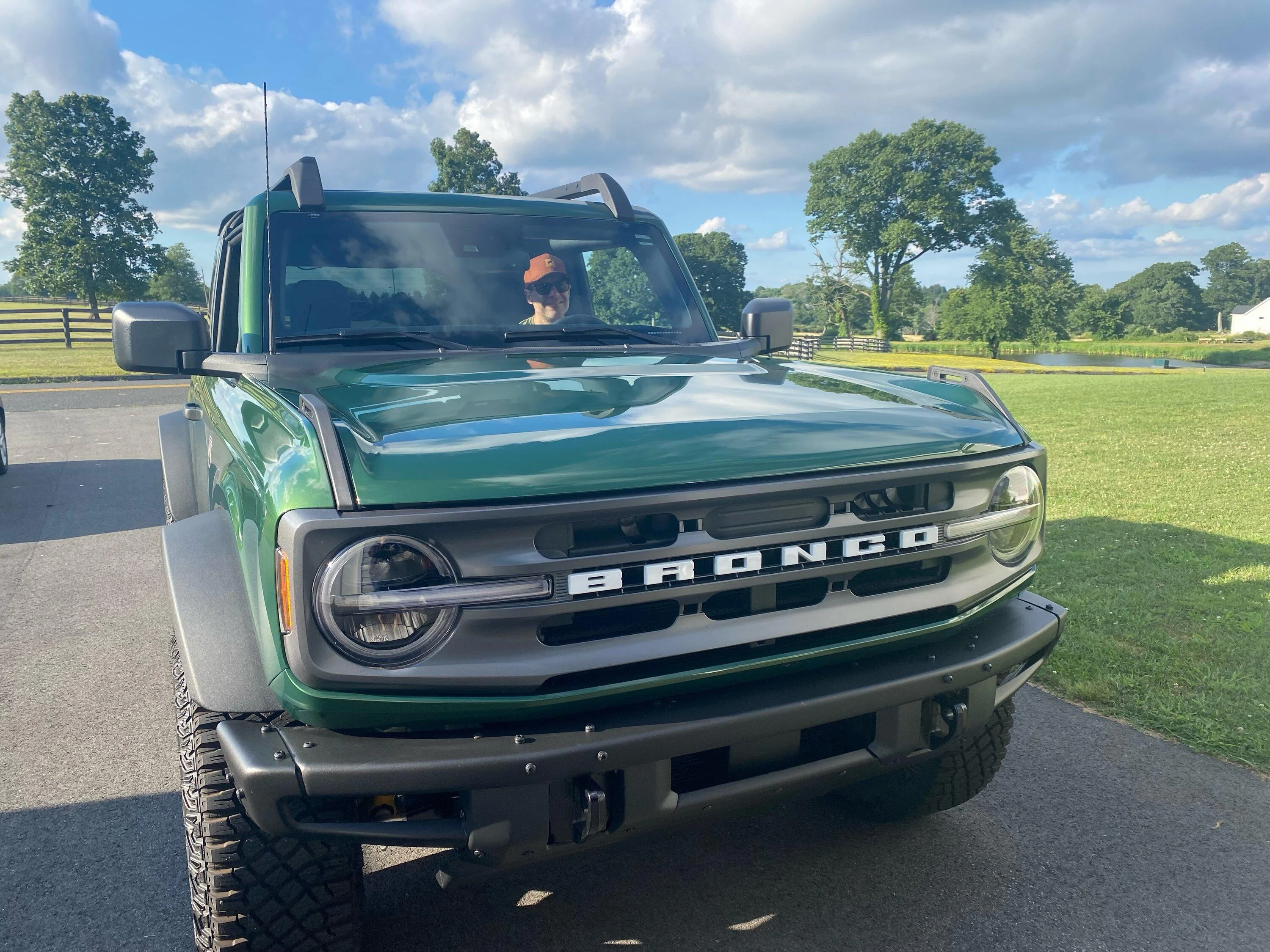

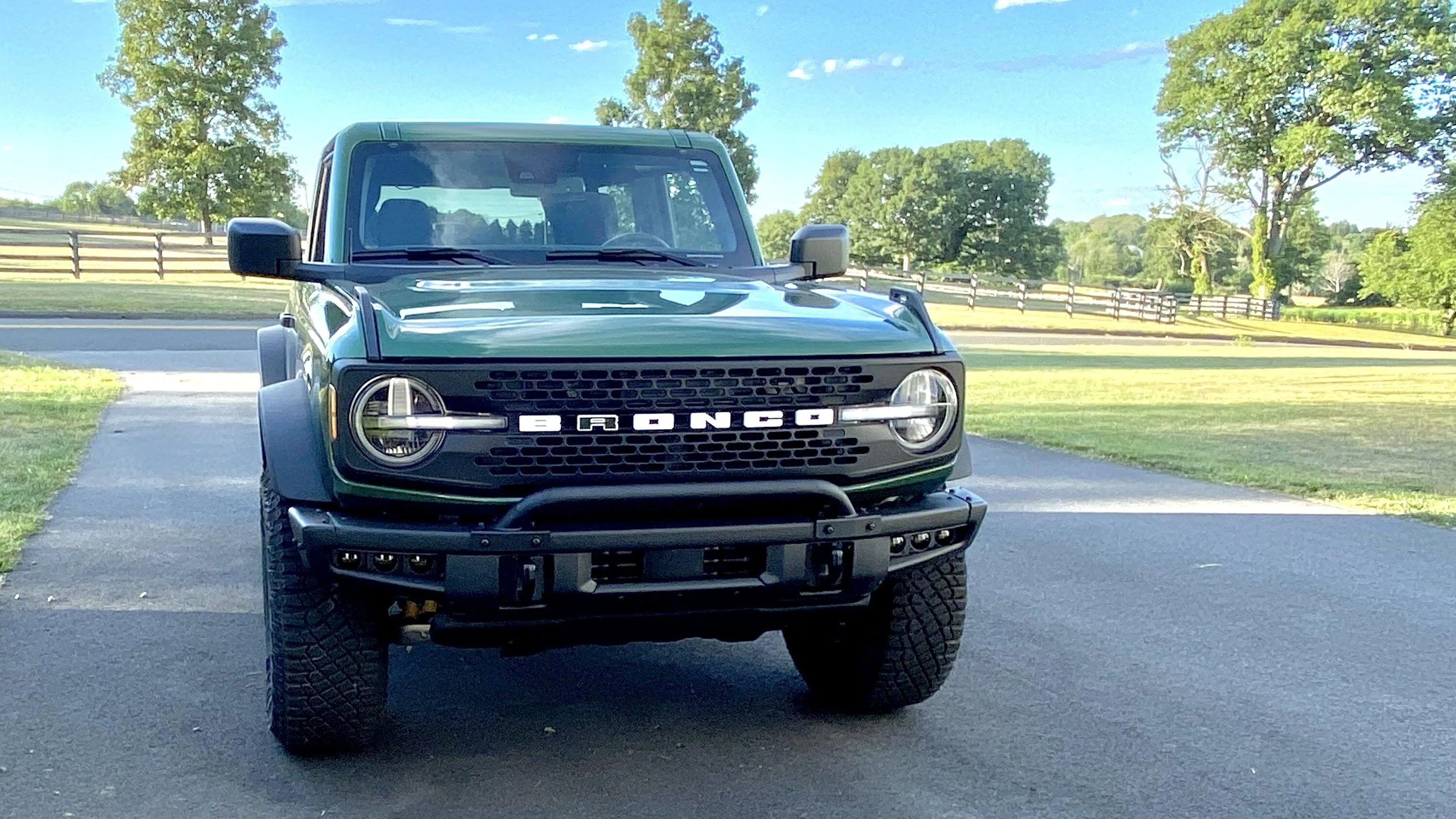

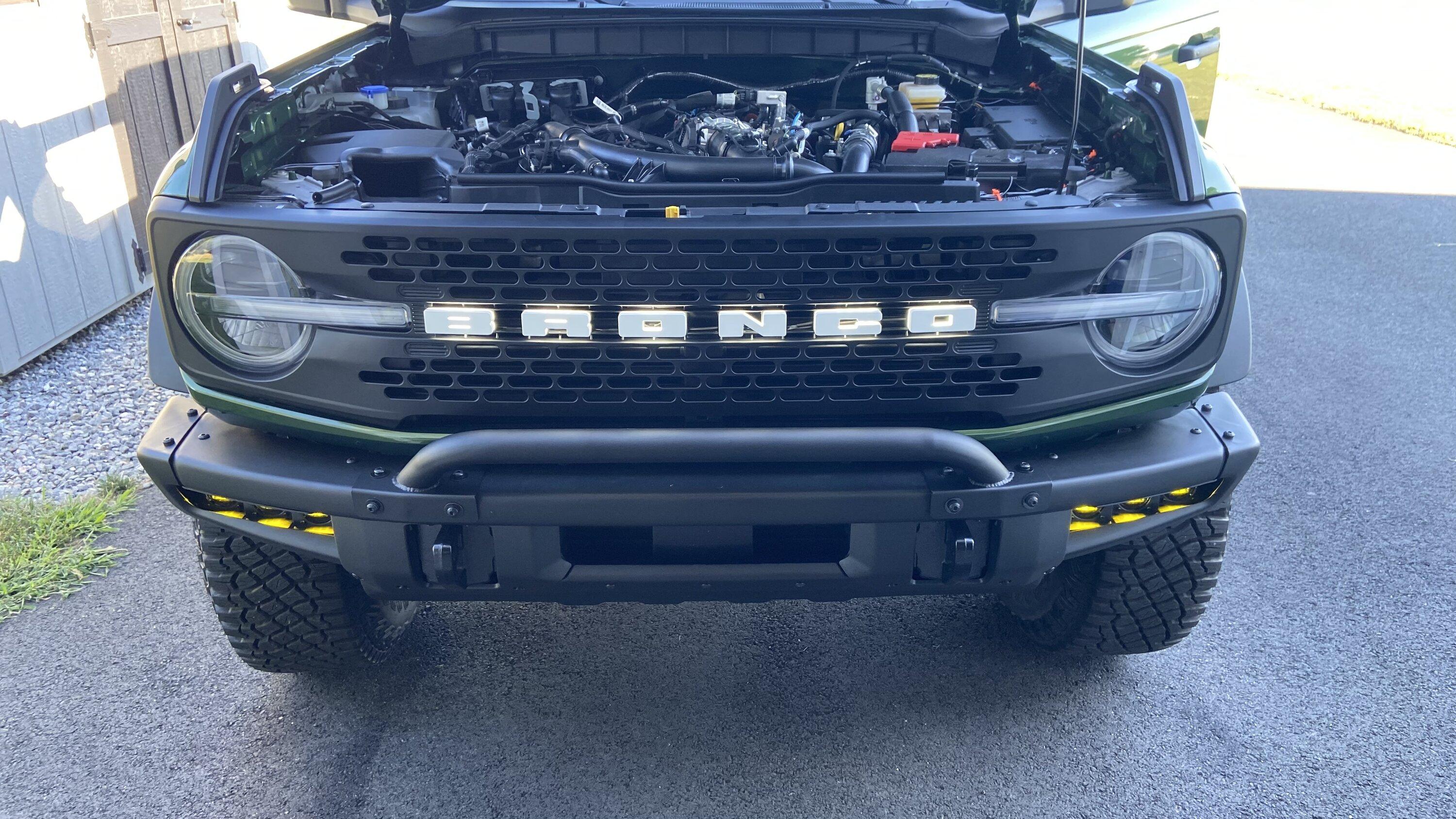

Worked on a few projects over the last few days. I completed my front end update which includes the following:
Xipex Matte black grille
Oracle light up letters
Oracle fog lights
Malbett Bull Bar

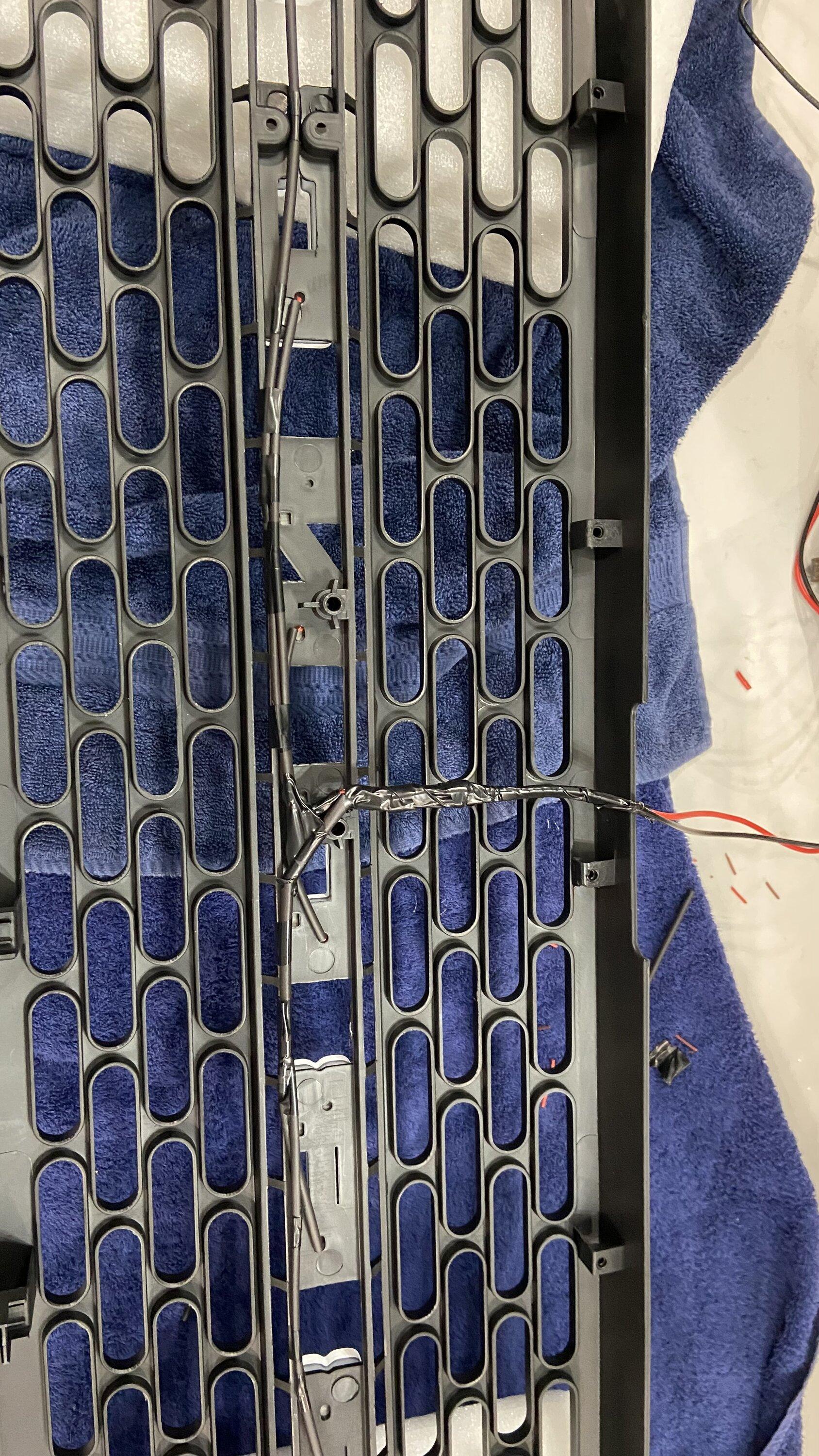

I got the new grille and lights all installed and hooked up. All installs went well. Honestly I have never installed anything like this on a car but didnt have any issues other than a couple self inflicted issues from not watching video on the install for the grille and not looking at the included parts :D

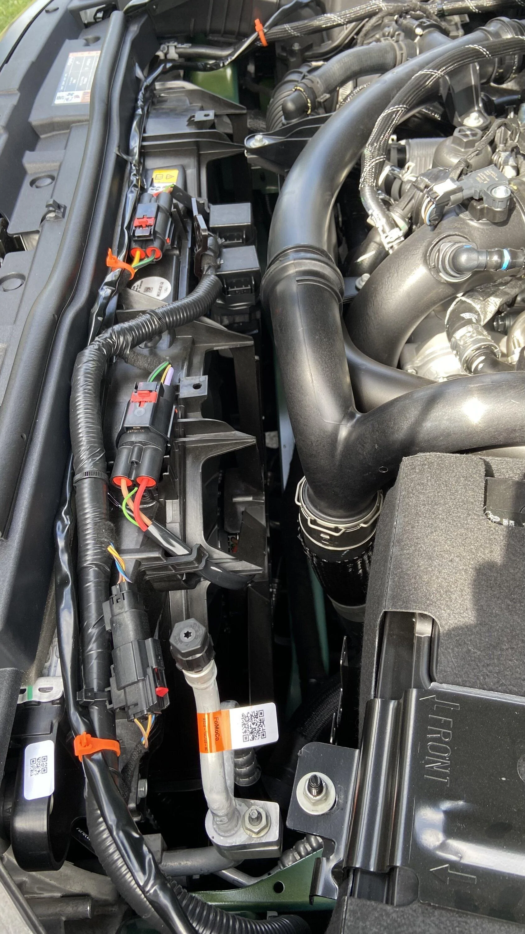

I have the AUX switches so the bronco letters are tied to AUX3 via the wire that runs to the grille. The fogs i wired directly to aux4. I grounded both on the battery. I wrapped all the letters writes black so they are not visible from the outside. Everything worked first shot, WOoo! Love the look of the new front and and very happy with how it turned out, looks a lot better than stock and is more functional now, well the fogs are, the others just look cool, lol.
Oh also added the bull bar. Great fit and really looks great on the mod bumper and does not cover the letters.
All letters work!
Ford Bronco My eruption green 2-Door build EFEFECC1-A465-4352-B8BD-9D0230B75CEC
Completed front end. Grille, light up letters, fogs and bull bar

Red wires taped up black so they are not visible from outside.
Ford Bronco My eruption green 2-Door build 7492007B-4119-4DFE-9B7B-382F3B500CA6
Tried to make the wiring clean. Tied everything down

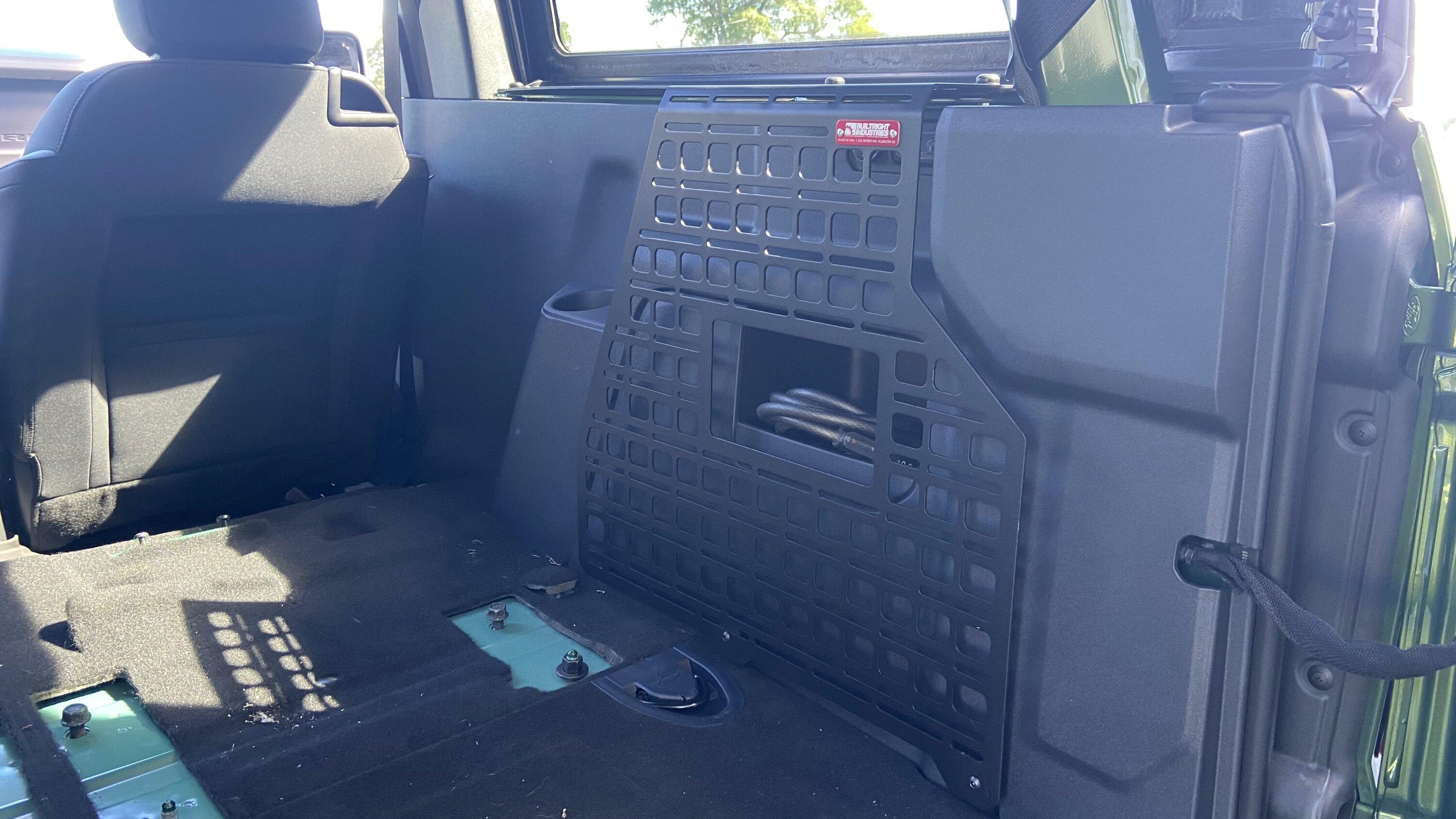

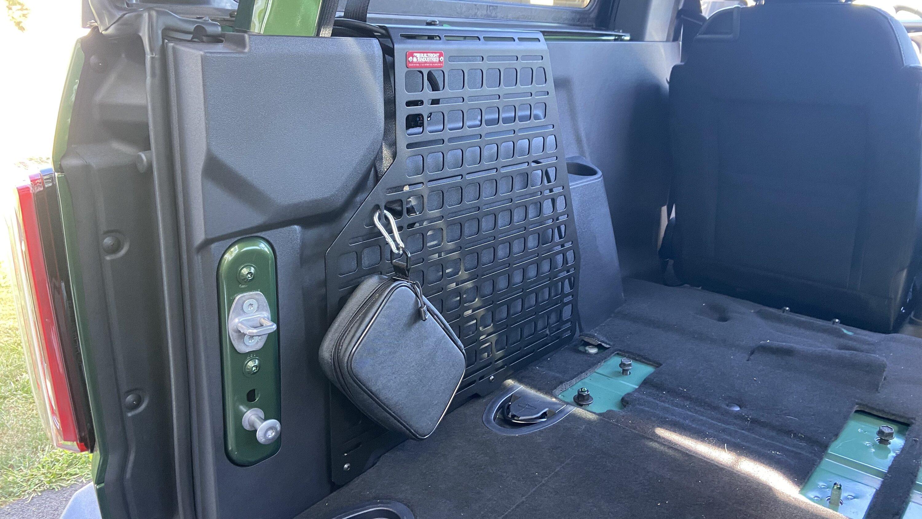

Another small project I did was add the built right Molle Cargo Panels to the rear of the bronco. I have done a seat delete and will be building a new platform in the back over the next week. The panels were easy to install though i did break one clip but not really paying attention to how they loosen :(

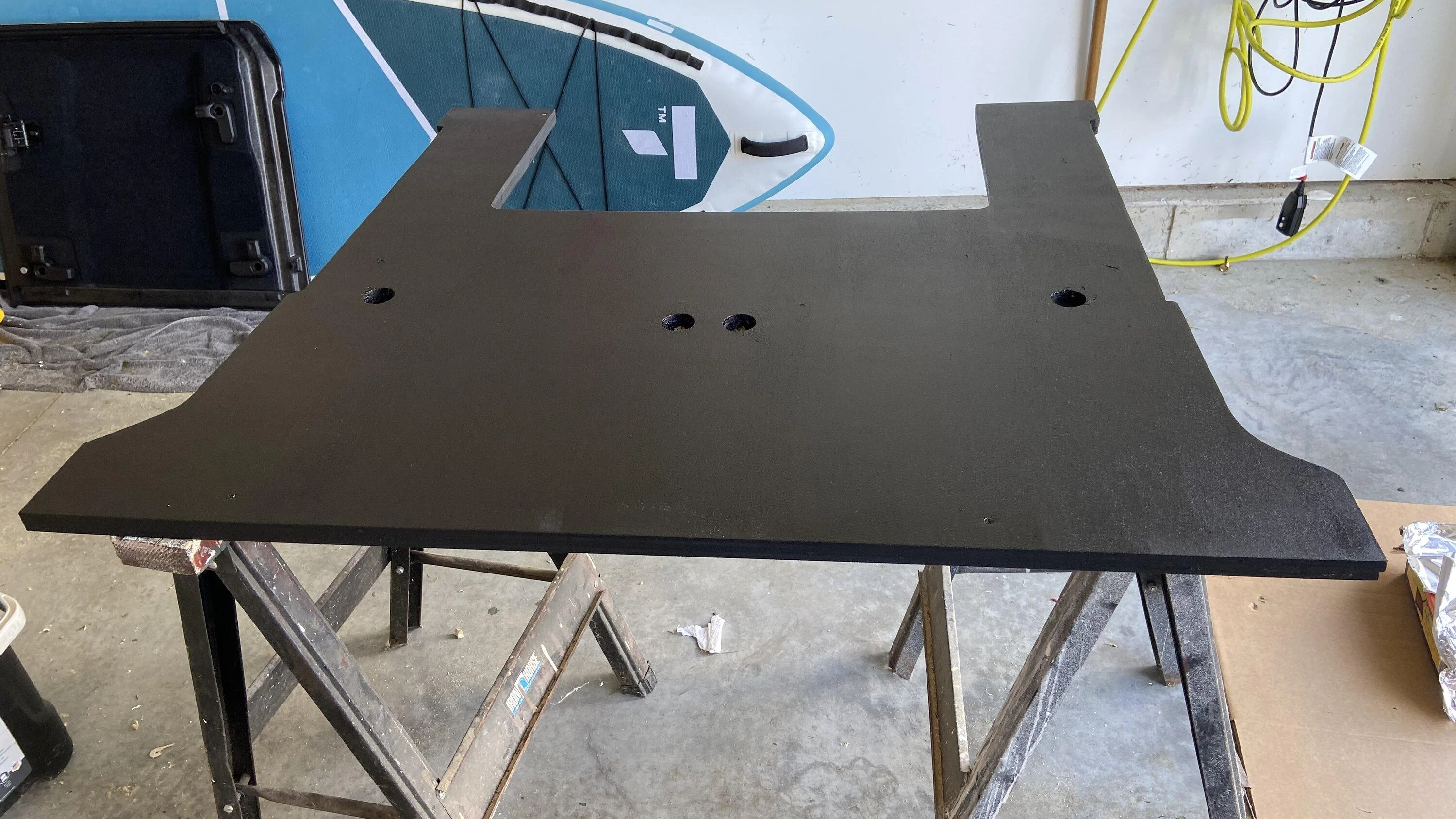

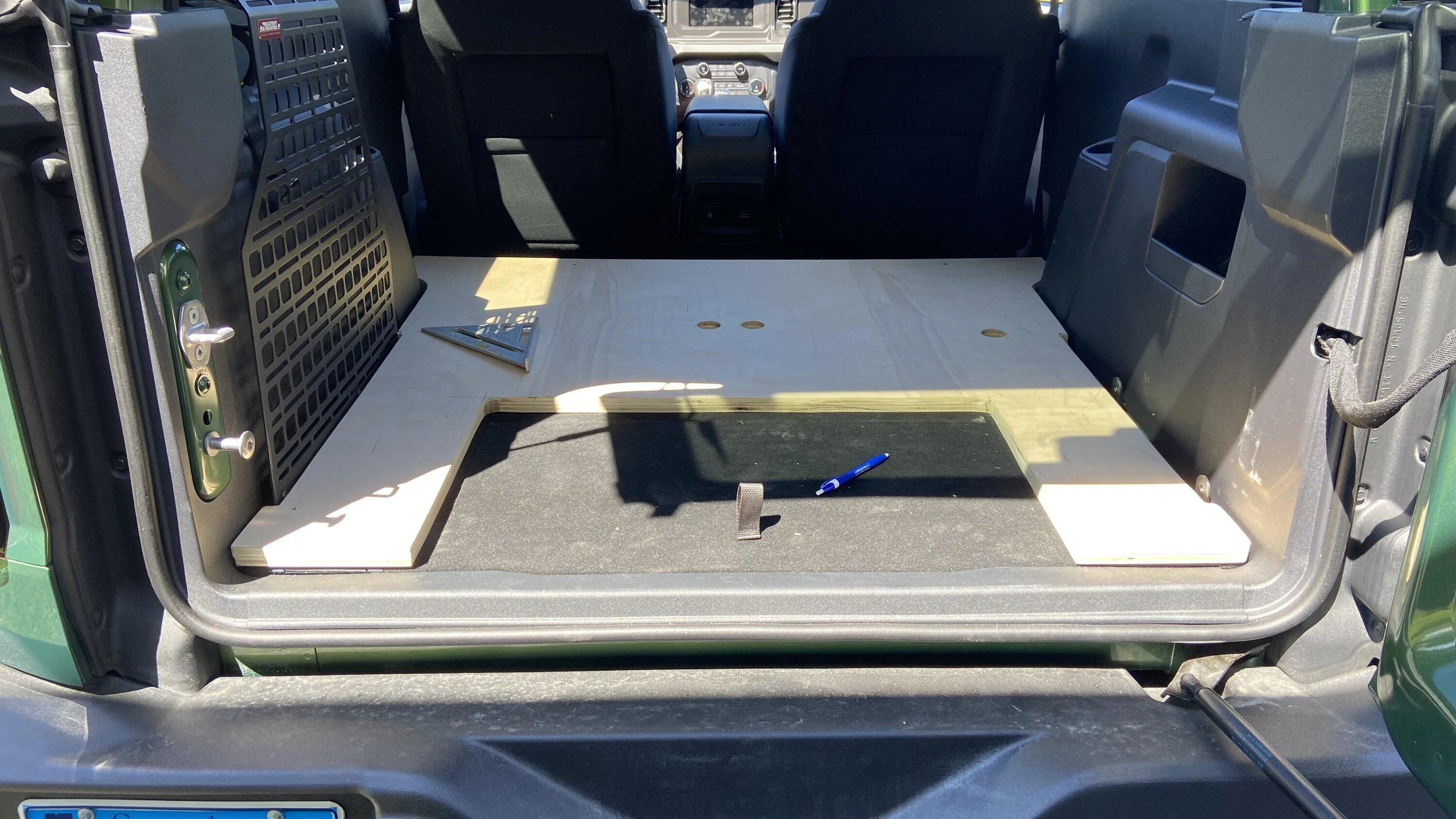

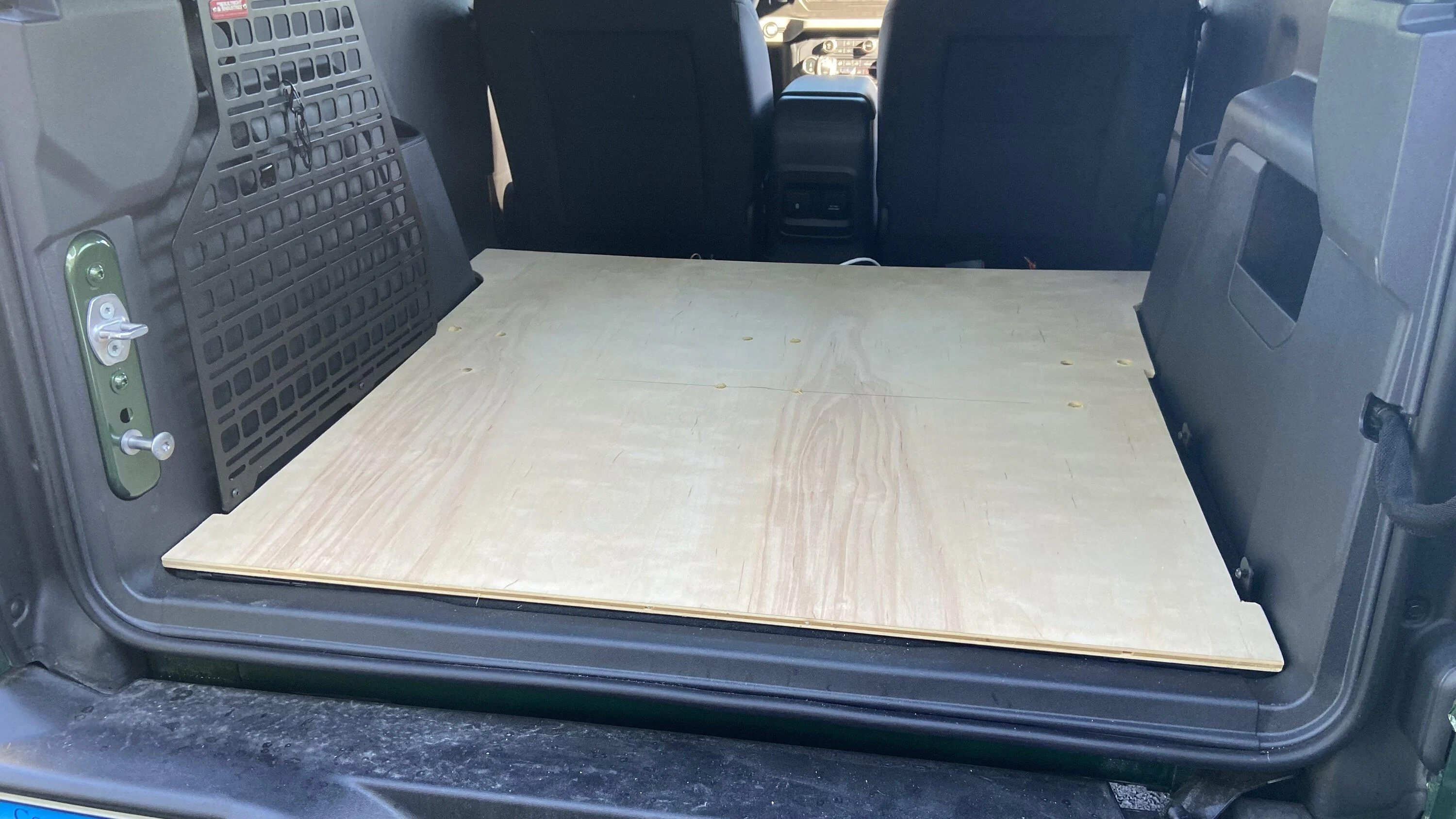

Did some work building my platform.

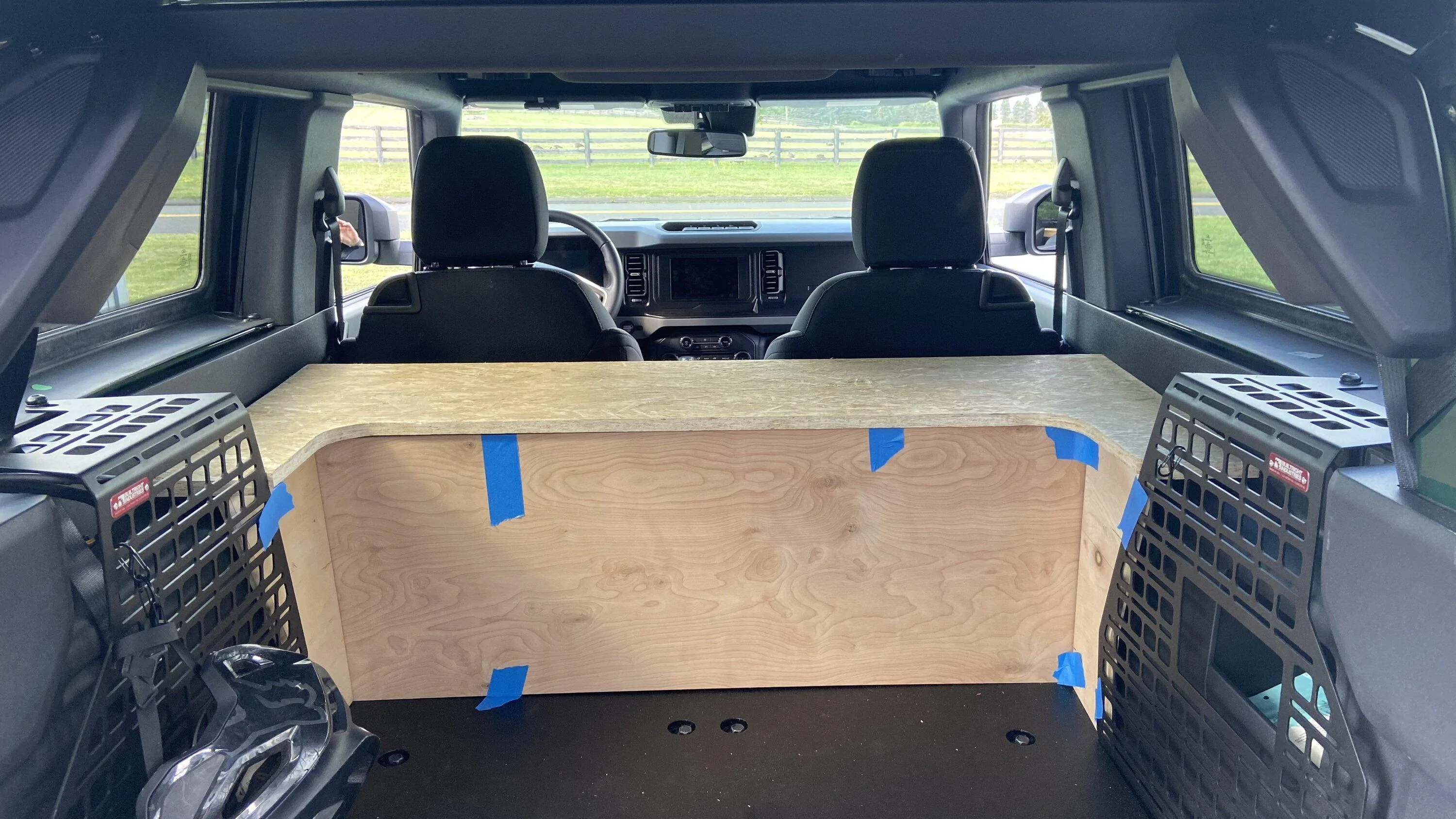

starting to box in the sub box next it will look built in and have a shelf on top. going to wrap it in black marine vinyl.

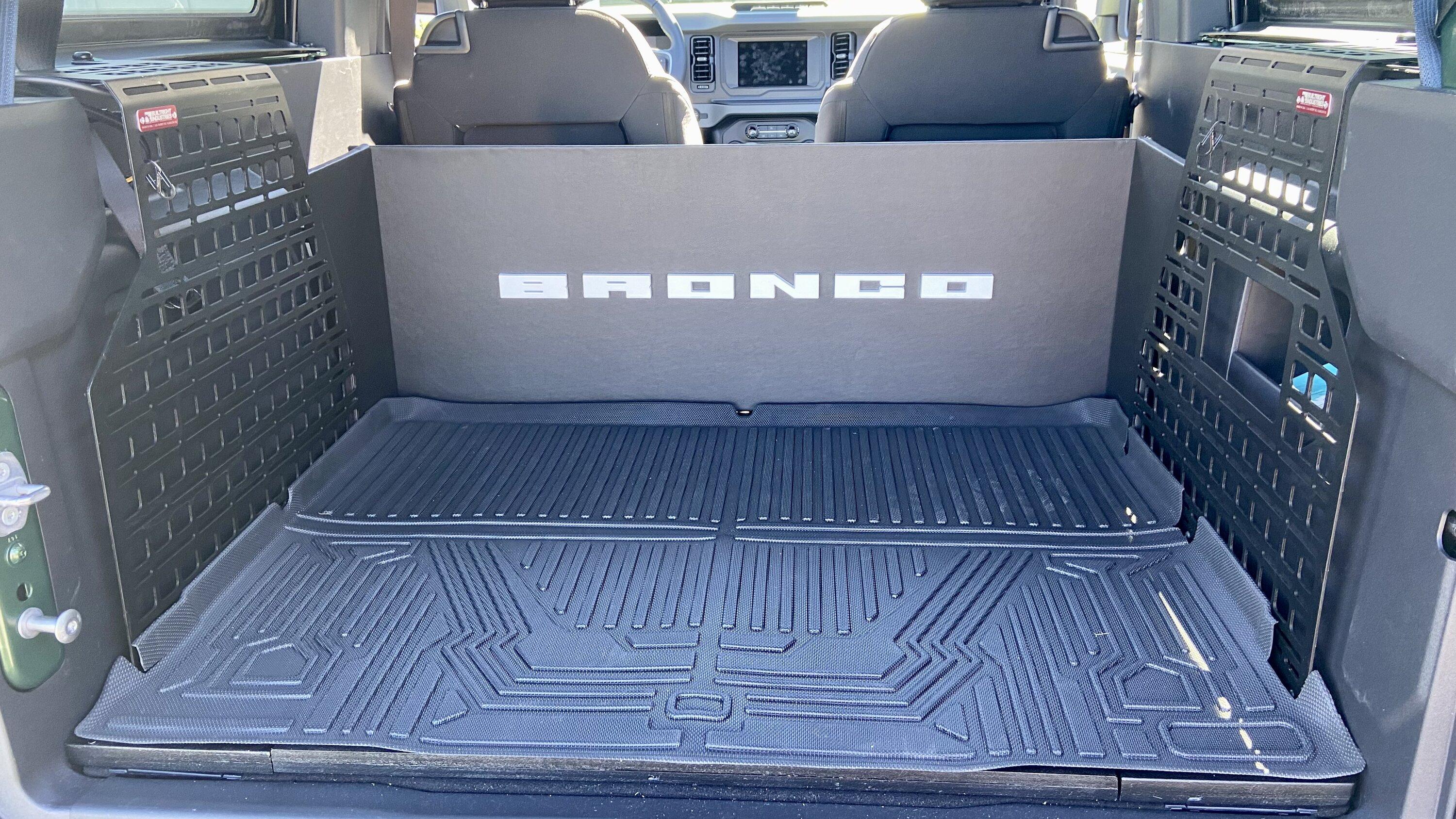

Built all the rear cargo panels to box in the sub and create a shelf. Going to cover in marine grade vinyl. May do the shelf in bedliner though not sure yet.

Would for sure do the seat delete if I had a 2-door. Looks awesome.
yeah I have no real need for the rear seats and now have a cargo area as big as the 4 door and will have an additional storage shelf. Plus had room for a large sub box which has drastically improved the sound of the audio along with my other upgrades there. Also everything I did is reversible if/when I ever sell.

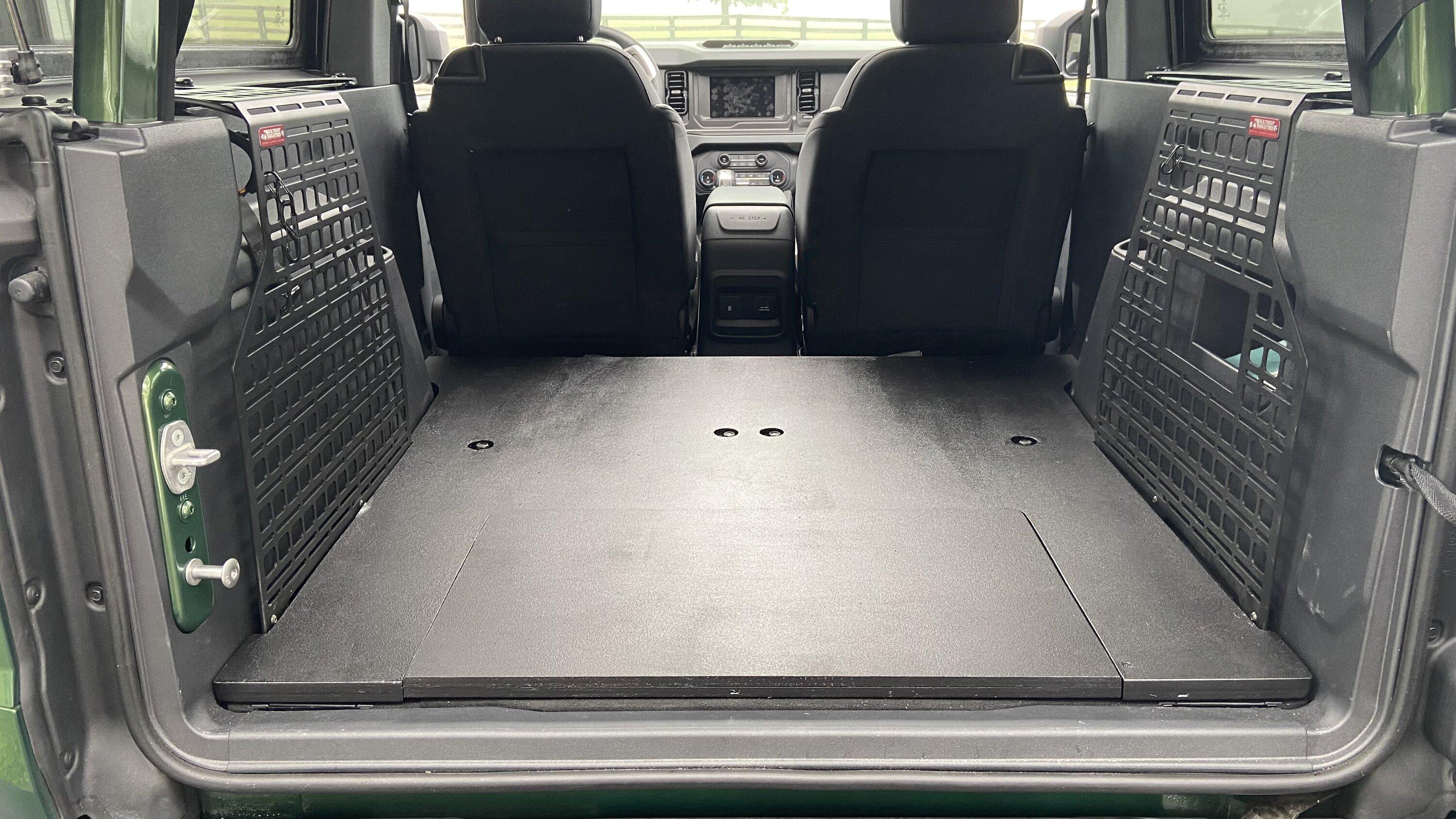

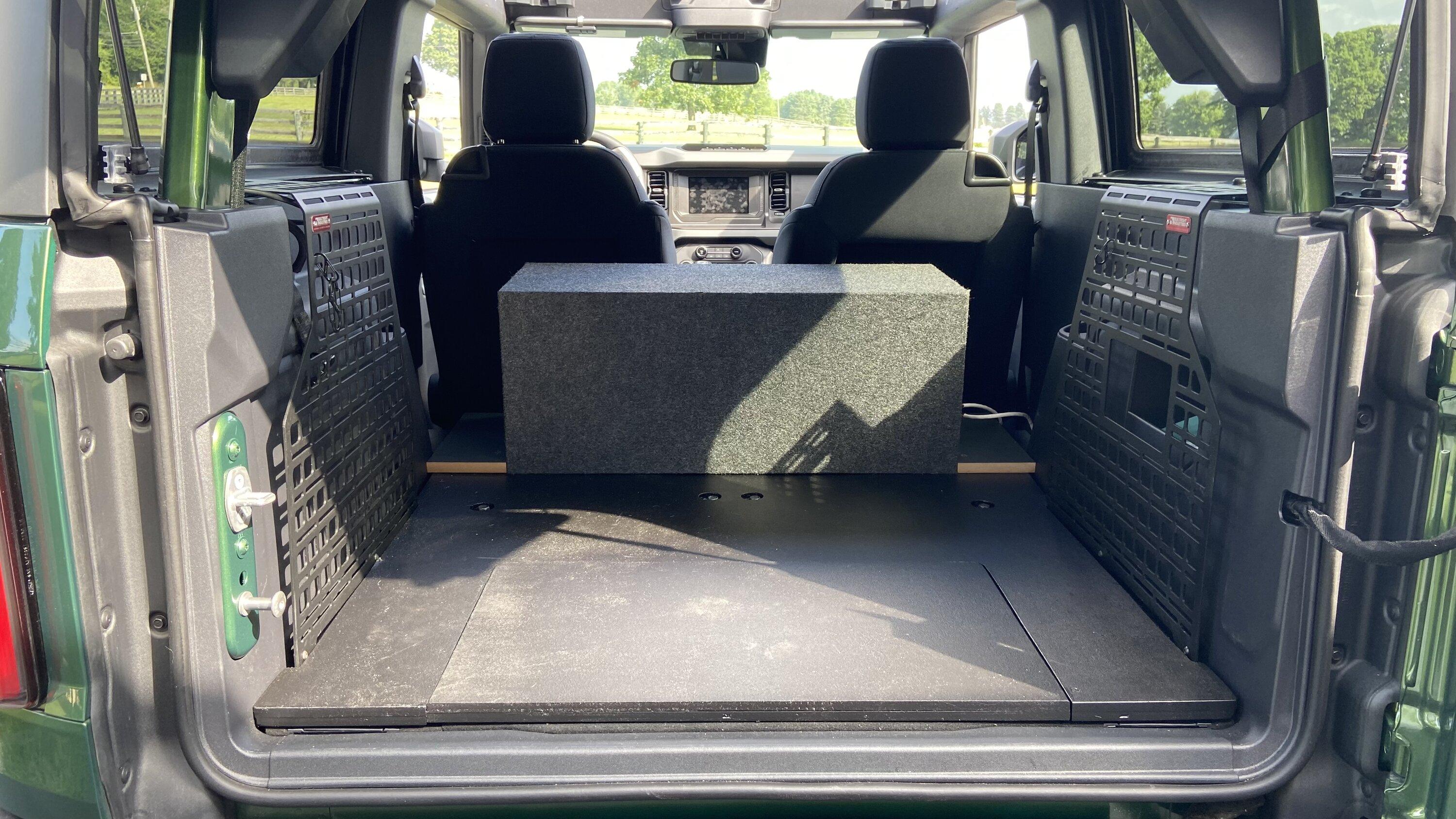

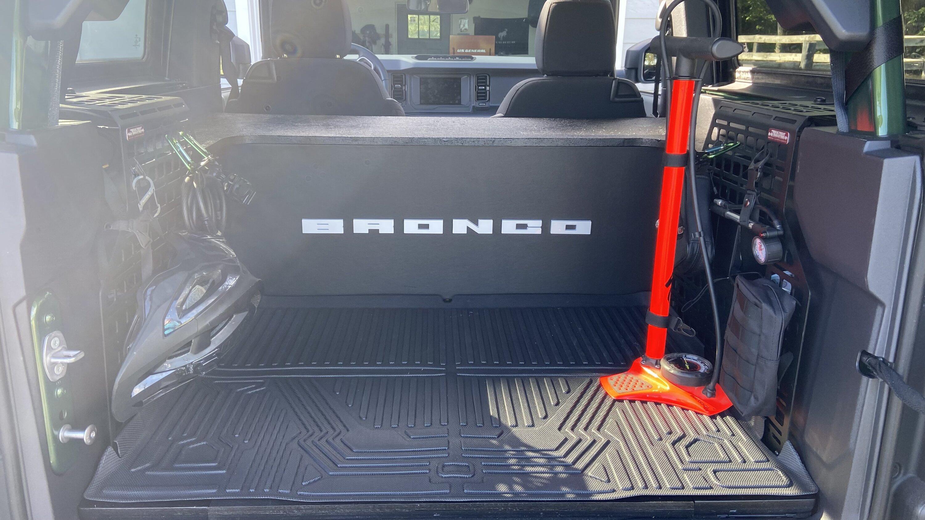

Got the rear cargo area sides I built out of birch plywood wrapped over the last couple days with marine grade vinyl. Got some contact cement and did it myself. Was not too bad of a job. Everything is in place with double sided tape so I can break it down if needed. Decided to do the shelf that will sit above the sub in the same bed liner paint I used for the floor. Got 3 coats on it itday so just waiting for it to dry. Coming along nicely I think. had the extra bronco letters from the grille I purchased so figured what the hell.
the mat is one for the 4 door which fits perfecting in the expanded area.
