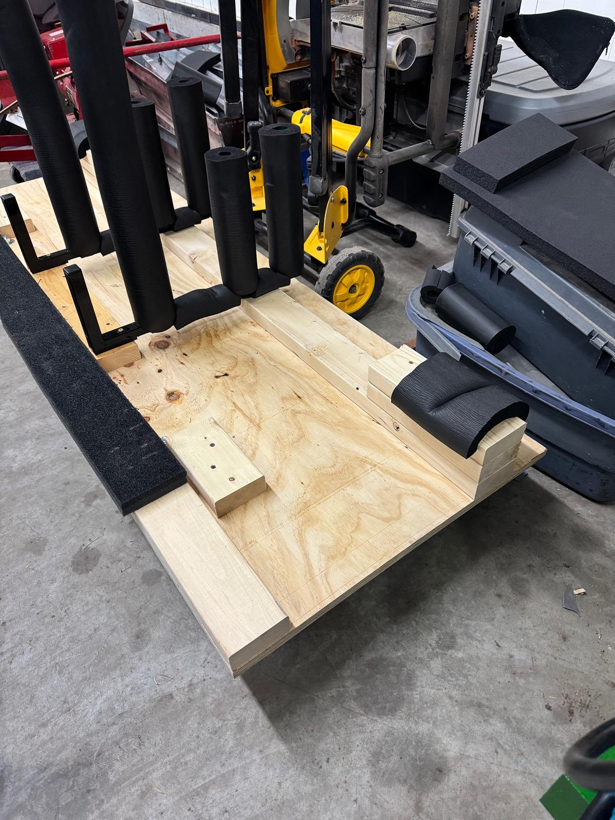

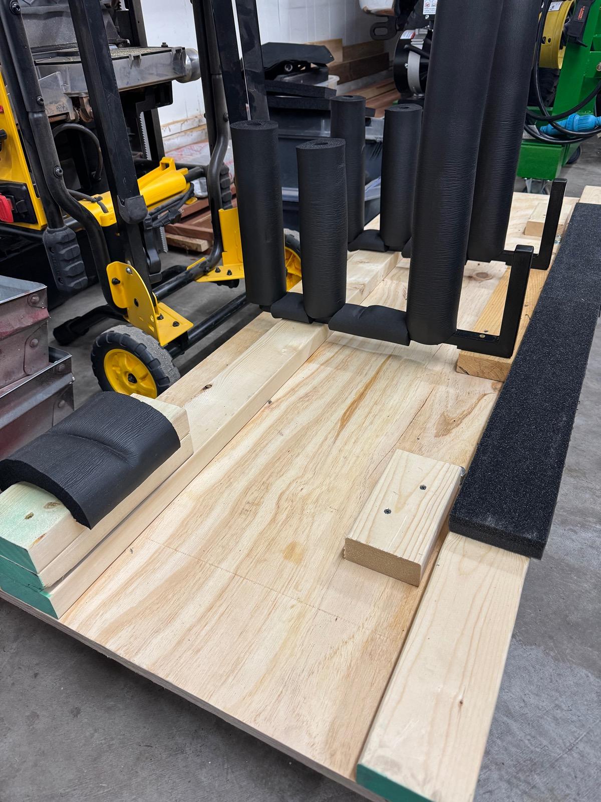

I received the cart for my two door because they said that it would work with the two door but it did not. It’s good quality and easy to assemble but the front two brackets on the clam shell fell right on top of the bars and pads, so it wouldn’t sit in there properly. I assume it would work fine for a four-door but I’m not sure. I bought a piece of three-quarter inch plywood and robbed all of the parts and pieces off of the cart, but modified it so that the front of the clamshell slips into a slot. I hated wasting all the money on the cart originally I’m very happy with how my modified cart ended up.
