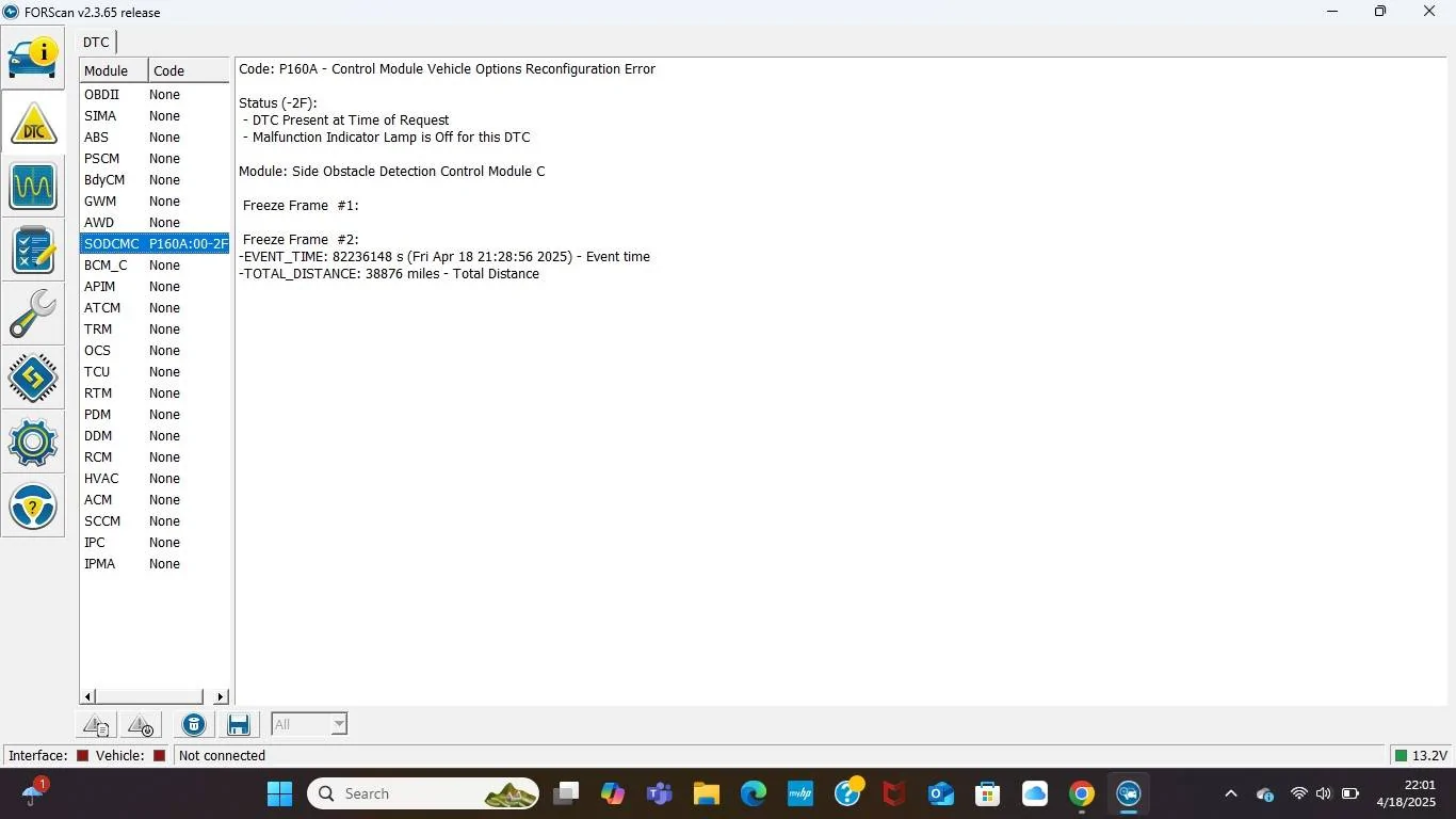

Ok on my first real road trip with my 22 BD and discovered that the settings I had previously done for tire size were just a bit off. Figured no problem have the laptop and cable with me will just tweak it a little. Now im getting a DTC, SODCMC 160A:00-2F.
Ford Bronco 2021+ Bronco ForScan Thread forscan1

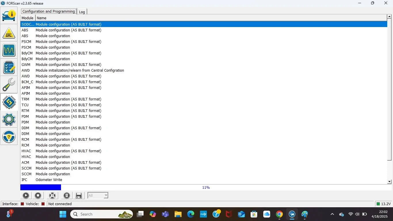

Running version 2.3.65, did the AWD relearn but there is no longer an option for PMC relearn.
Ford Bronco 2021+ Bronco ForScan Thread forscan2
SODCMC keeps failing when I try to open it. Did try doing SODCMC reboot with no change. Any ideas what im missing on the new version?

Email forscan support. They are awesome and can send you a custom copy of the software to get what you need going. If you’re missing an option now.
