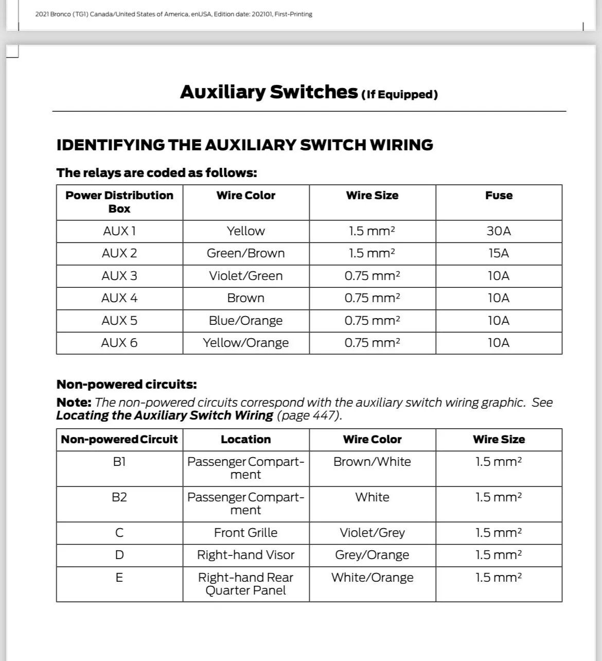

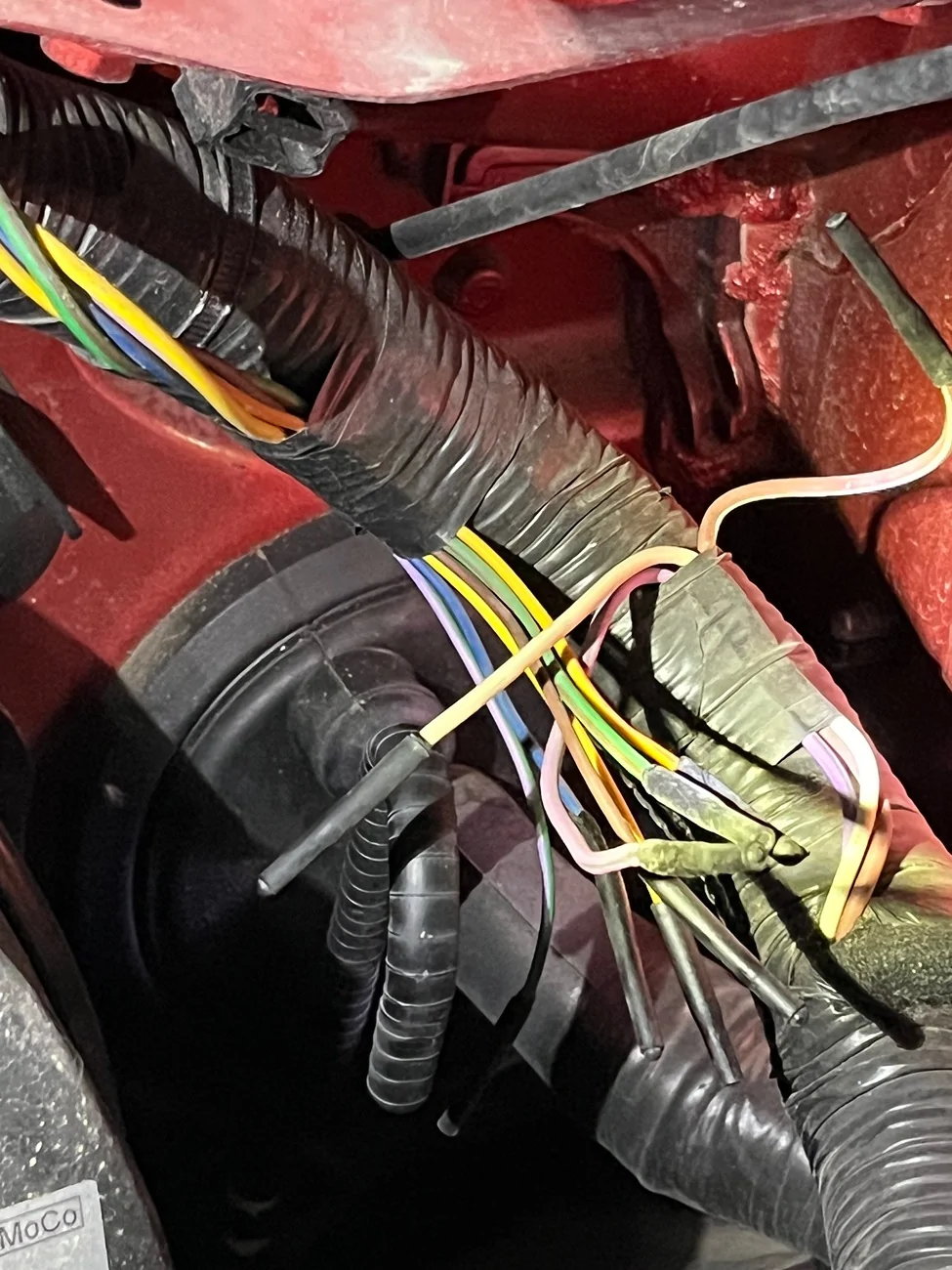

I have a 2023 Outrr Banks-how can I tell if it has pre-run wiring for aux switches. I see a bundle of wires in the engine compartment driver side but don’t know if these are the pre-run wiring for aux switches.

This might help you.

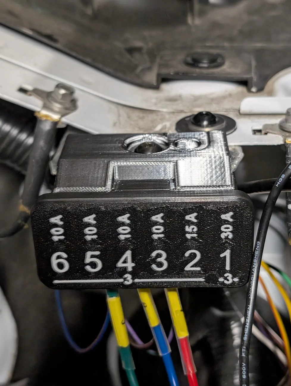

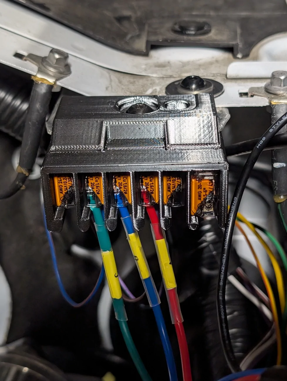

Also, @Dirtrider has an awesome junction box he makes. I bought two from him, one for each of our Broncos. He incorporated Wago connectors which are easy and dependable, plus they allow you to change your accessories wiring plan without cutting wires. They are great.
Ford Bronco 2023 Outer Banks pre-run aux switches wiring PXL_20260223_220314345
Ford Bronco 2023 Outer Banks pre-run aux switches wiring PXL_20260223_220339799
