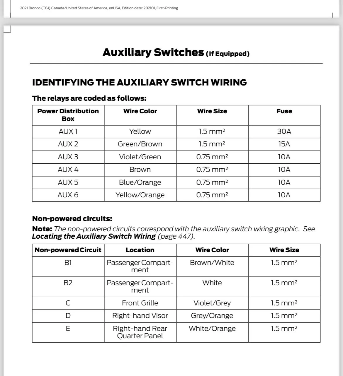

Where in the owners manual do I find the wiring colors and locations for the Aux switchs. I only have the manual that loads from in the car.... just cant find what I need

You can't find this stuff in the 2024 version - at least not by searching for it, or under auxiliary switches - it's impossible to find.

Owners manual
Ford Bronco Wiring colors and locations for the Aux switches? IMG_3699
