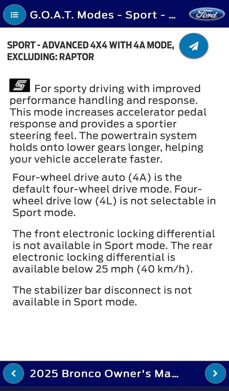

@mpeugeot has over 100k and I believe he uses 4A 100% of the time if I’m not mistaken.
JawnyBronco
Sep 24, 2022
1,307
5,049
DelMarPa
2023 Bronco 4dr
Ford Bronco '22 OBX 4A Binding issues... Need TSB IMG_8781
