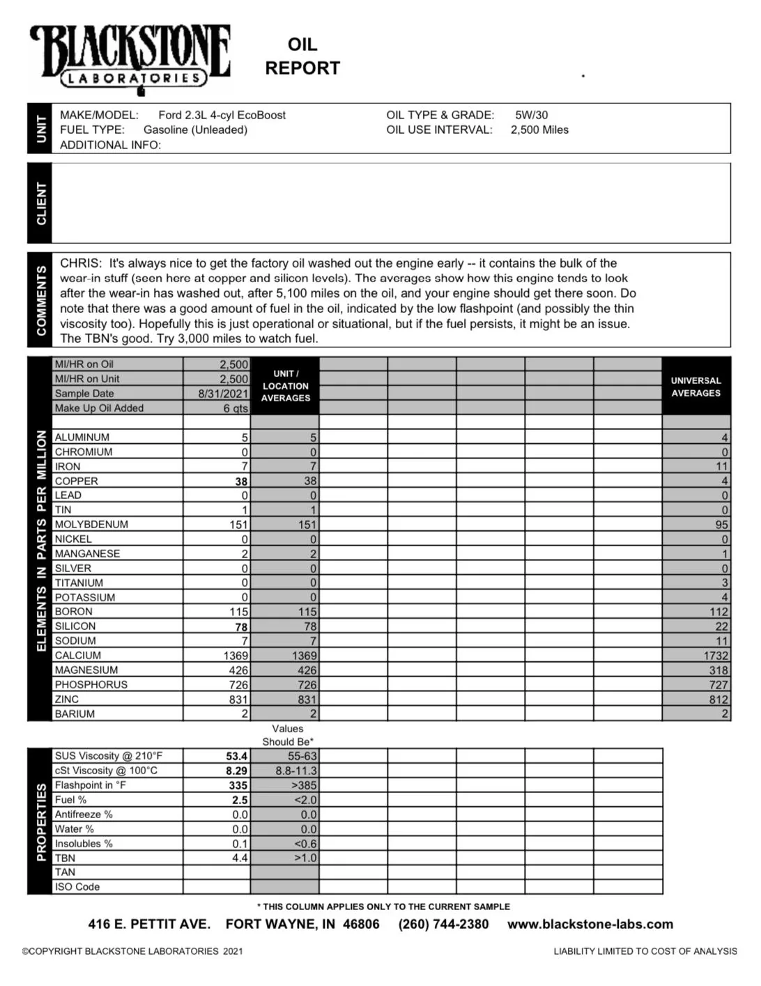

I chose to wait until 2500 miles for our first oil change. I know a few on here were insisting on 1000. I split the difference so to speak.
Even though the dealer insisted 5000 would be fine and that I was wasting money - I was confident in wanting to see what this report revealed and provide info for the rest of the community to make their own decisions based on these results.
I used Ford Pass Points - which is weird because I gained 495 points at the same time.
Those of you with more experience - please chime in. I’ve used Blackstone in the past - but, it was for a TDI/Diesel engine and I was moderating metals due to camshaft wear
Breaking-in regime was:
Drove it as suggested by manufacturer. 1,000 went quickly. Lots of hilly backroads, some highway and to and from work - which is only a mile (down/up hill). Wondering if that has something to do with fuel in the oil.
I am pretty certain I kept it below 3500 RPMs (for the most part anyhow) and didn’t take it off-road until after the 1k.
Ford Bronco UPDATED AGAIN: Blackstone Laboratories Oil Report - 2.3L Engine @ 2500, 5000, 10,000 and 15,000 miles (now using Motul 5w30) 2F53E321-2FD6-4646-883E-C023FC7FF426

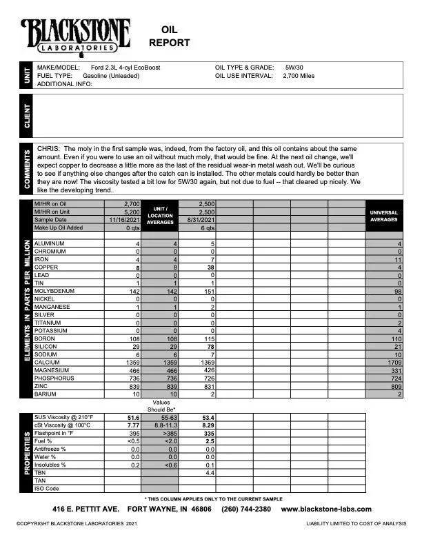

5K (Motorcraft/FL-910S):
Ford Bronco UPDATED AGAIN: Blackstone Laboratories Oil Report - 2.3L Engine @ 2500, 5000, 10,000 and 15,000 miles (now using Motul 5w30) D817F451-F6F7-4517-829E-ACAD2B9E67D8

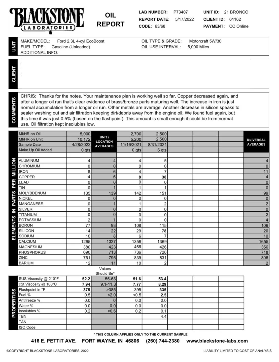

10k (Motorcraft/FL-910S):
Ford Bronco UPDATED AGAIN: Blackstone Laboratories Oil Report - 2.3L Engine @ 2500, 5000, 10,000 and 15,000 miles (now using Motul 5w30) C64114CC-6417-4159-A43B-5B6140597535

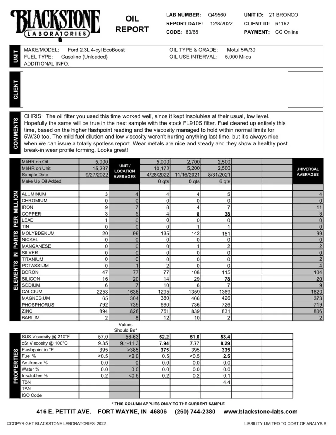

15k (Motul 5w30/FS-400S):
Ford Bronco UPDATED AGAIN: Blackstone Laboratories Oil Report - 2.3L Engine @ 2500, 5000, 10,000 and 15,000 miles (now using Motul 5w30) 185FDD46-A7F6-41F4-9C5A-957232A6D201

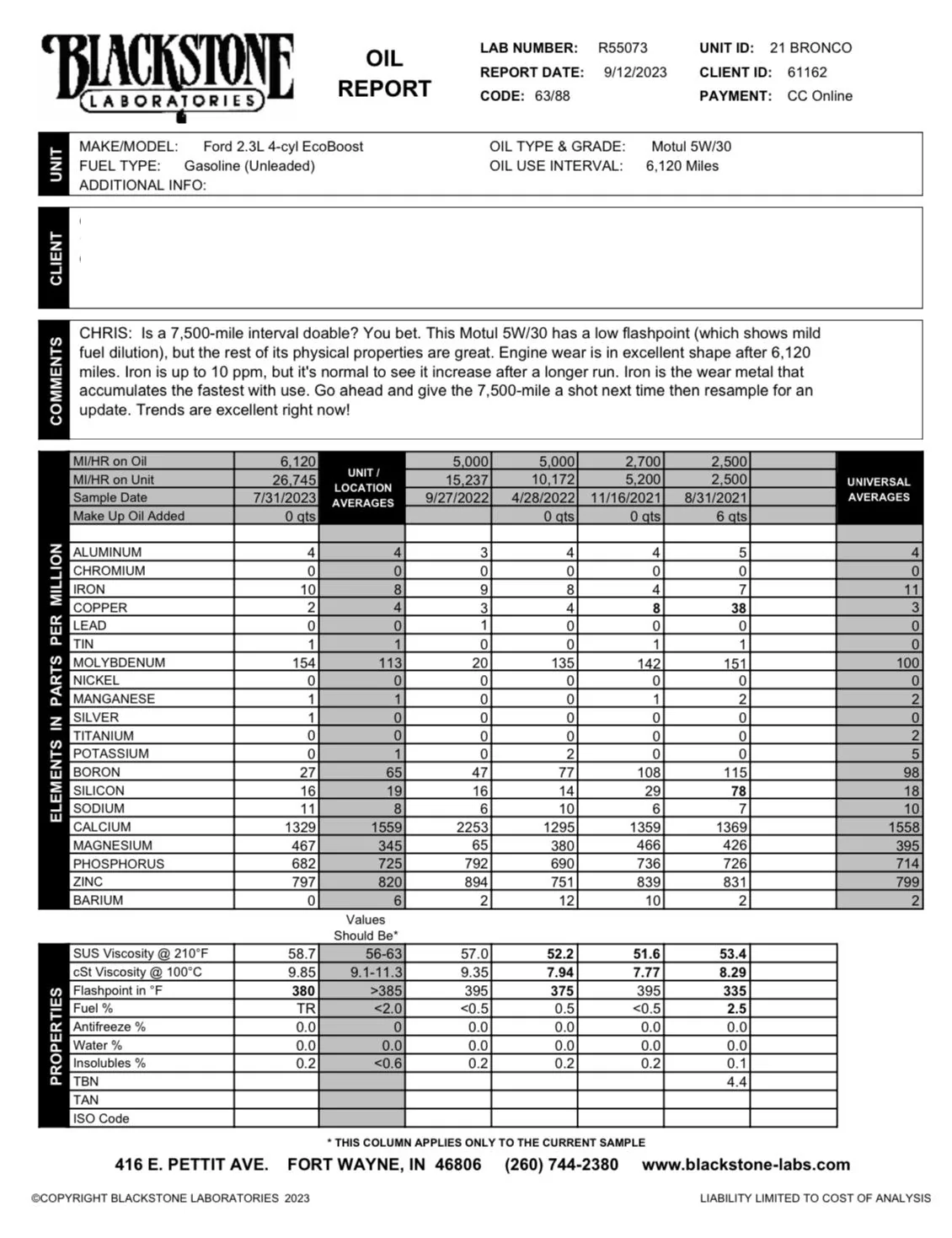

26k (Motorcraft/FL-910S):
Ford Bronco UPDATED AGAIN: Blackstone Laboratories Oil Report - 2.3L Engine @ 2500, 5000, 10,000 and 15,000 miles (now using Motul 5w30) IMG_4924
What engine break-in regimen did you follow?

Drove it as suggested. 1000 went quickly. Lots of hilly backroads, some highway and to and from work - which is only a mile (down/up hill). Wondering if that has something to do with fuel in the oil.

Fuel diluted oil is not uncommon in the first oil analysis, the rings aren’t set until the engine works some. If there is too much fuel in the next sample run conventional oil on the next oil change. Lots of short trips, idling or babying an engine can cause fuel dilution. Those rings need some heat and work to seat.

The one mile short trips can cause oil dilution.

What I get from the commentary is that a catch can is a must. Fuel in the oil is from the emissions/pcv system.

I’m waiting for someone to make one for 2.3L - UPR Products seems promising. Not that I think that’s the issue.

The analysis is on the report.
you just have to read it.

Fuel in the oil is from the rings not seating and the engine not getting hot enough to vaporize the fuel. A can isn’t going to do anything for either of those conditions.
