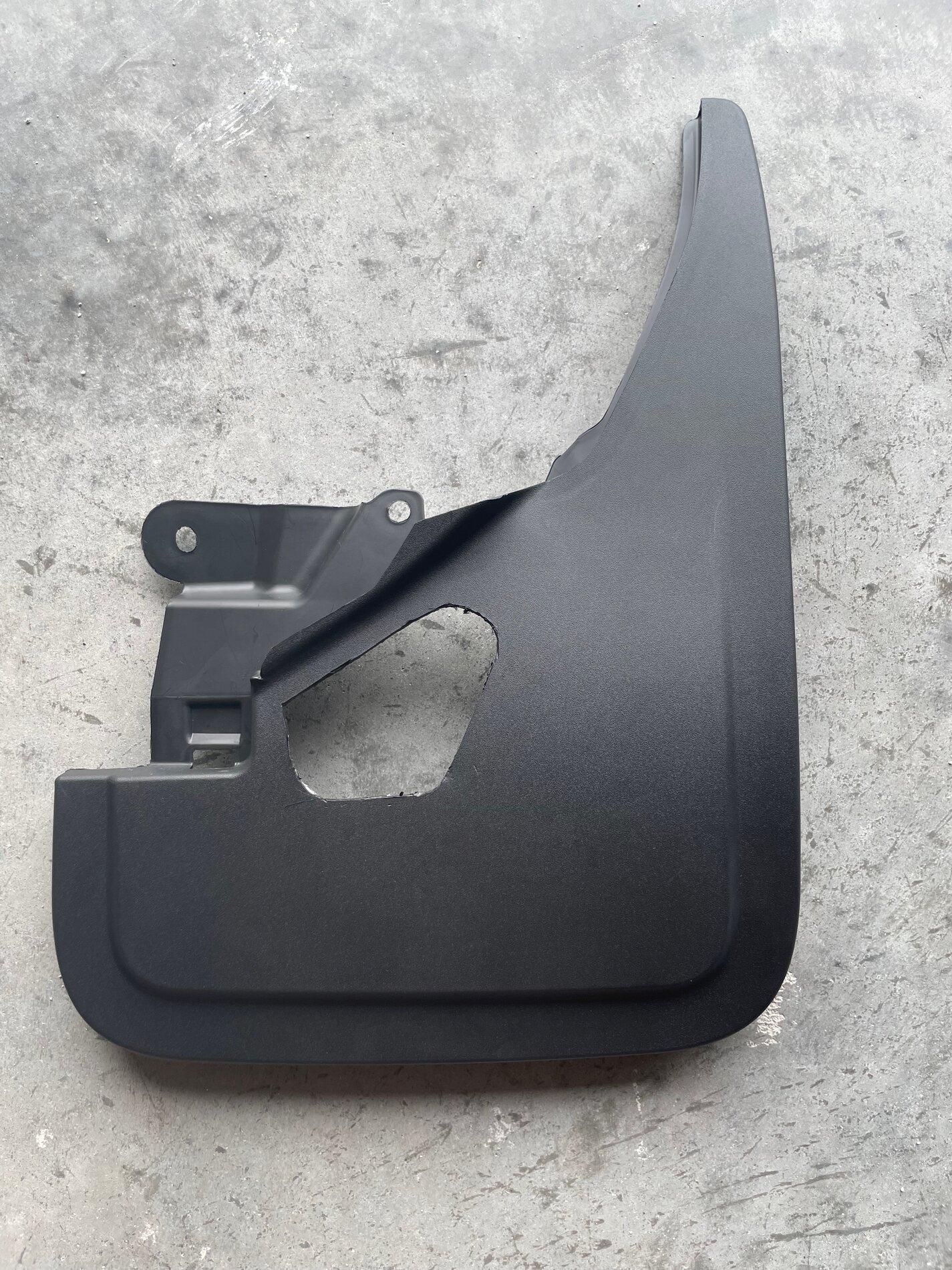

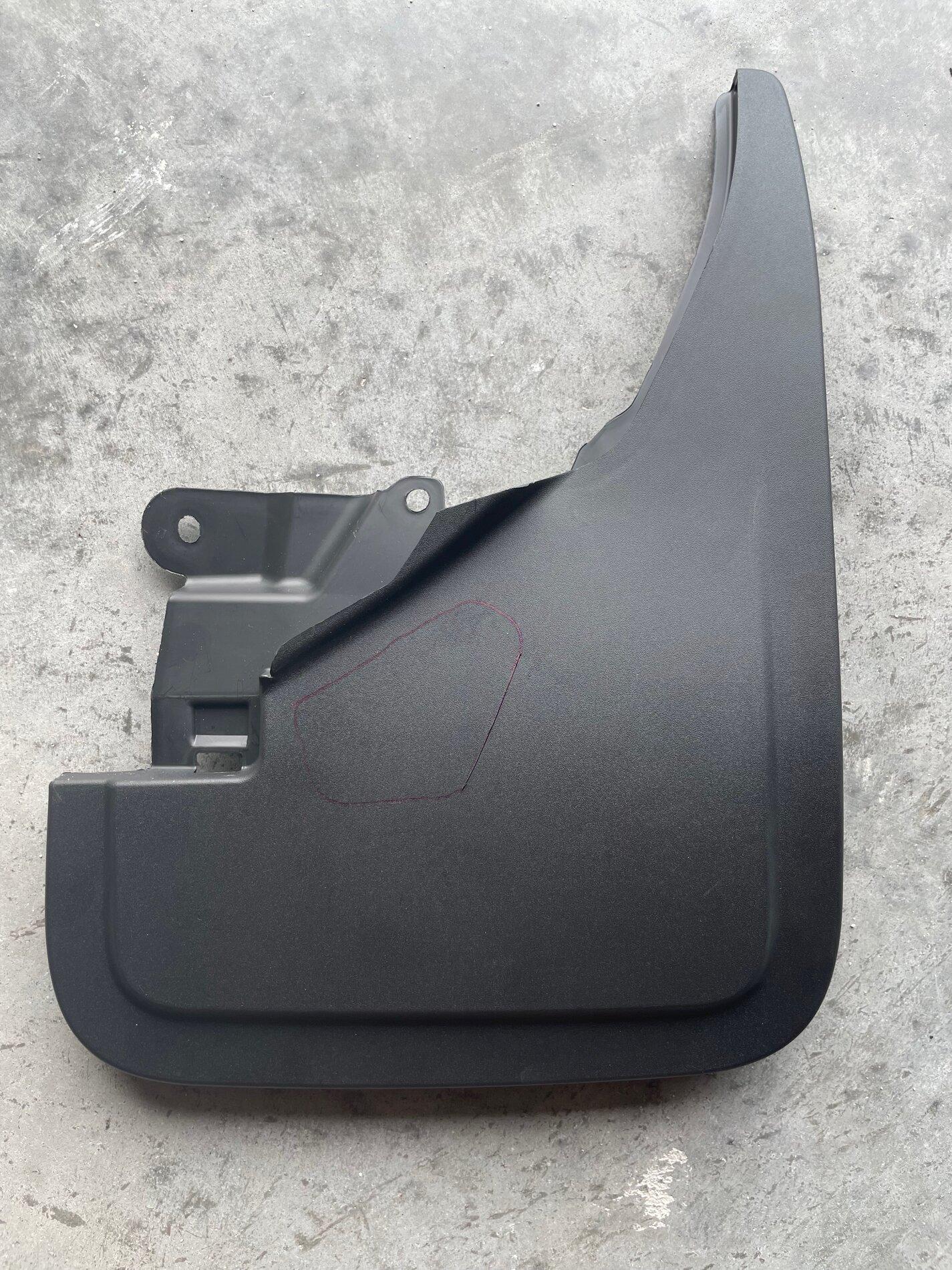

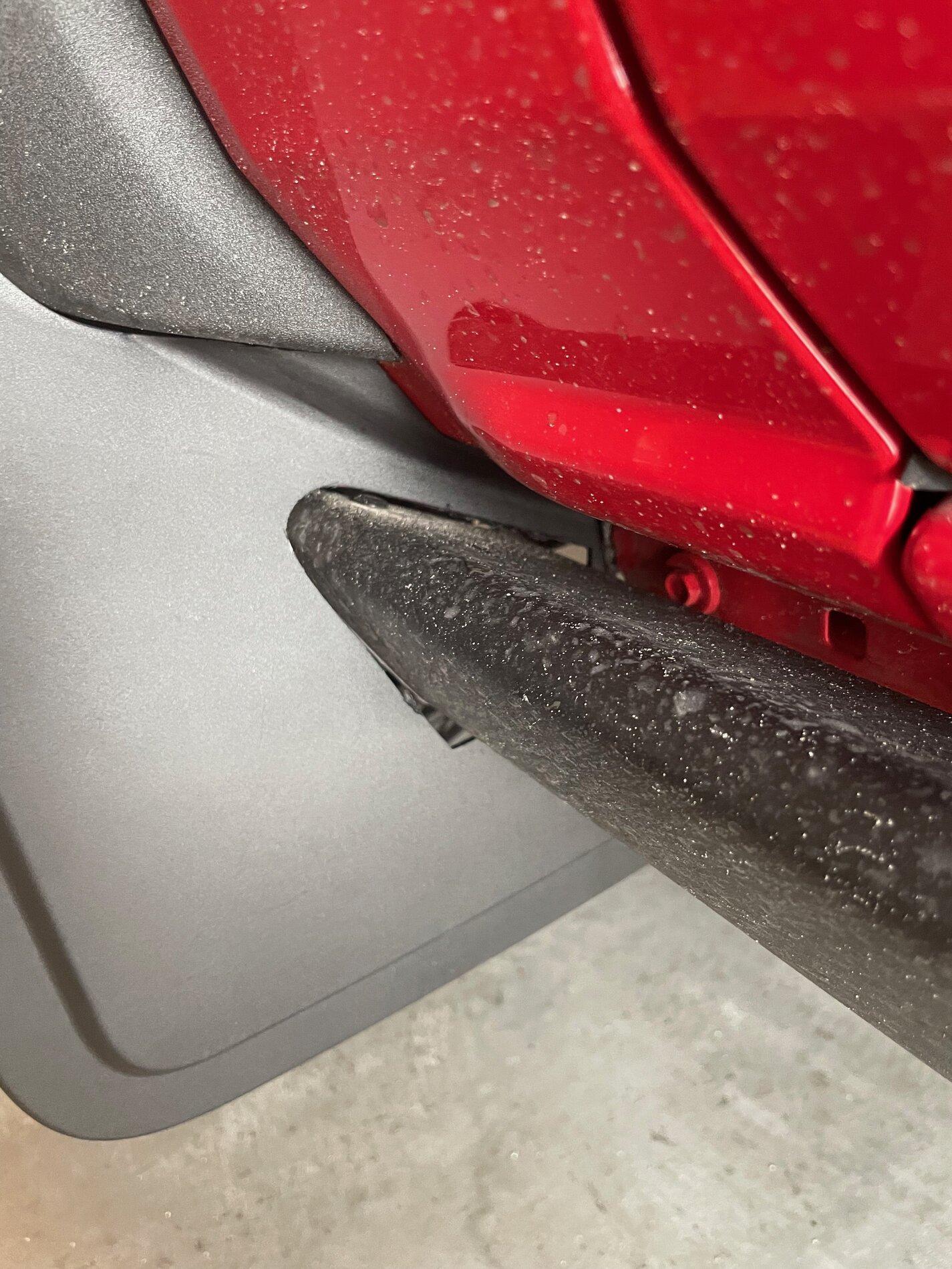

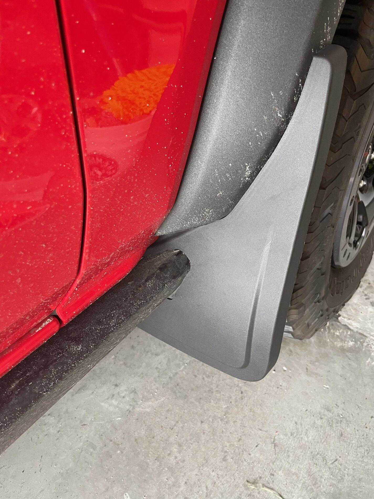

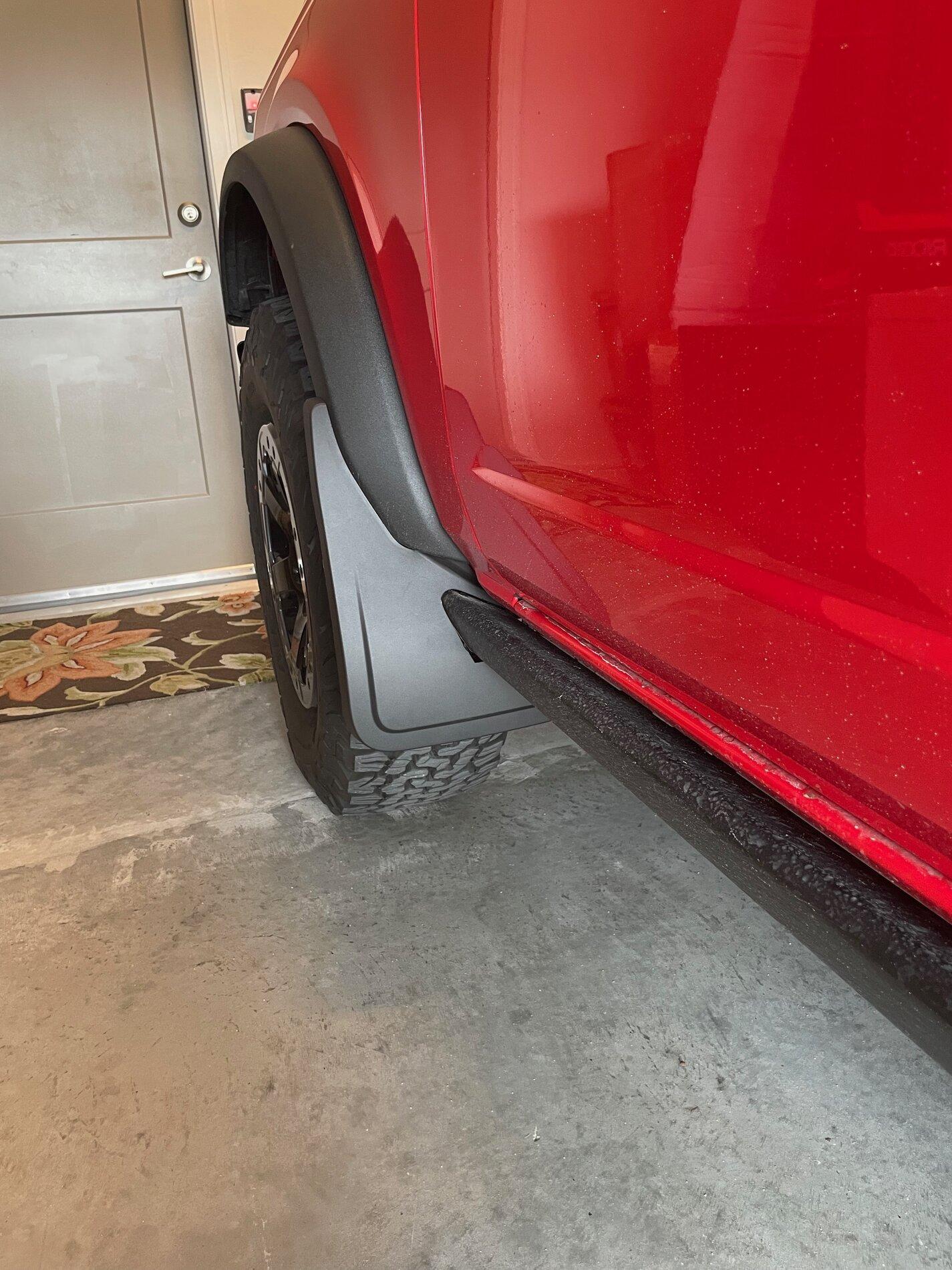

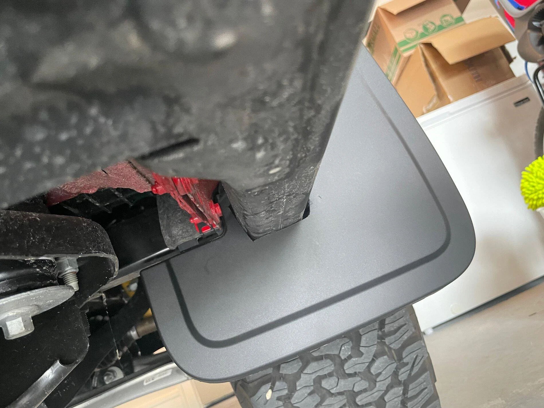

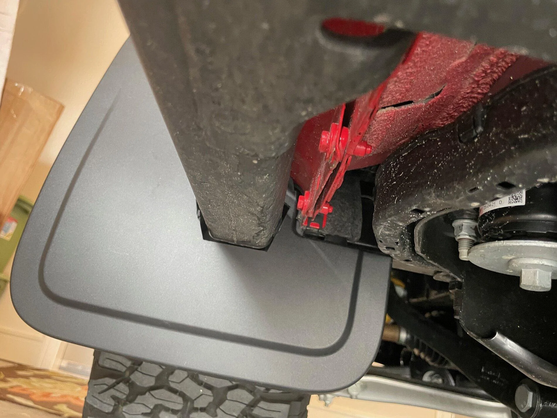

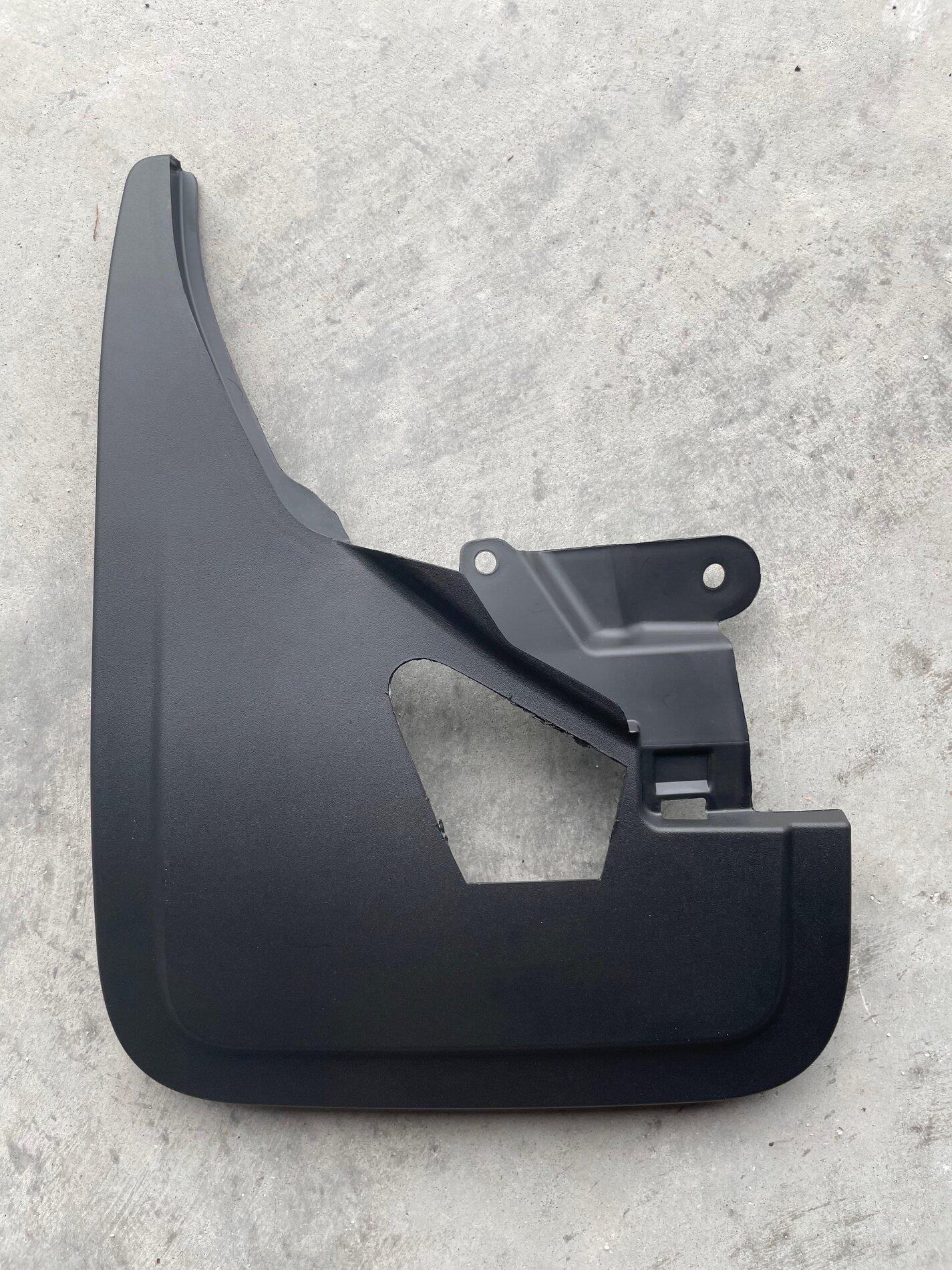

ROCK CHIPS/SPLASH GUARDS/MUD FLAPS: Shopped around and got a little duped by the stock photo for the Ford splash guards that show the upgraded Badlands wheels with the splash guards (suggesting they fit a Badlands). Bought them and then found the fine print that says they don't fit a Badlands (due to the rock rails). Shopped other products and wasn't happy with the look or the cost so I cut holes in the Ford pieces and they fit great and really do the trick. Have driven in multiple downpours in southwest FL and they've kept a lot of water (and sand) from being splashed up into the Bronco because we leave the doors off all the time.

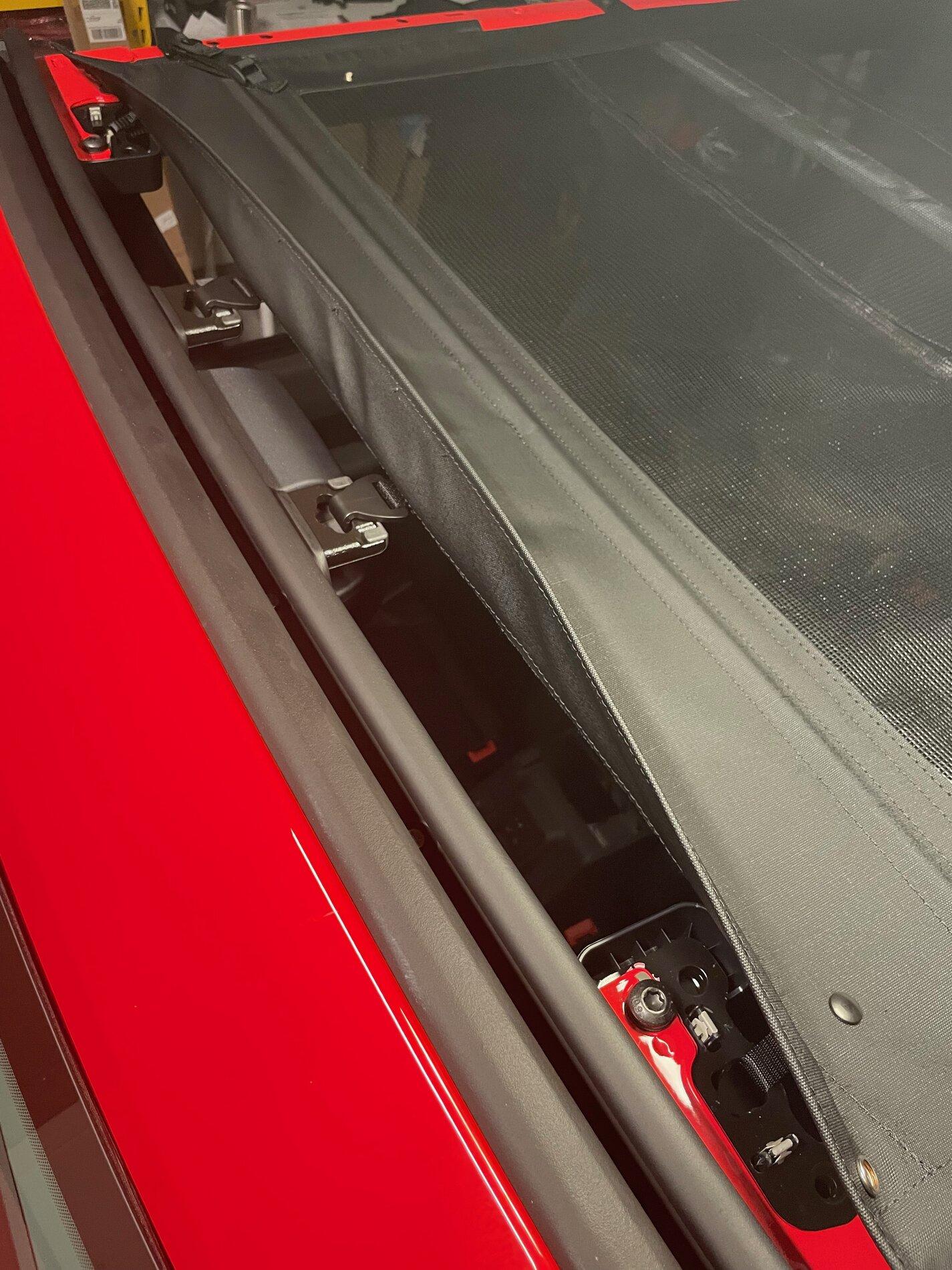

SUN SHADE: Wish it fit as good as the bungee attached shades we had for the Wrangler. The Bronco doesn't have the cross bar in the middle, which gives better views but limits options for attaching a shade so that it won't get blown in the wind and flap all over the place. The shade we got will flip back at the very front at any decent speed. It does the trick but leaves us thinking there will be better shades coming out in the future. We love the sun and the air but need to protect our young kids from getting a sunburn since we leave the top down as much as possible.

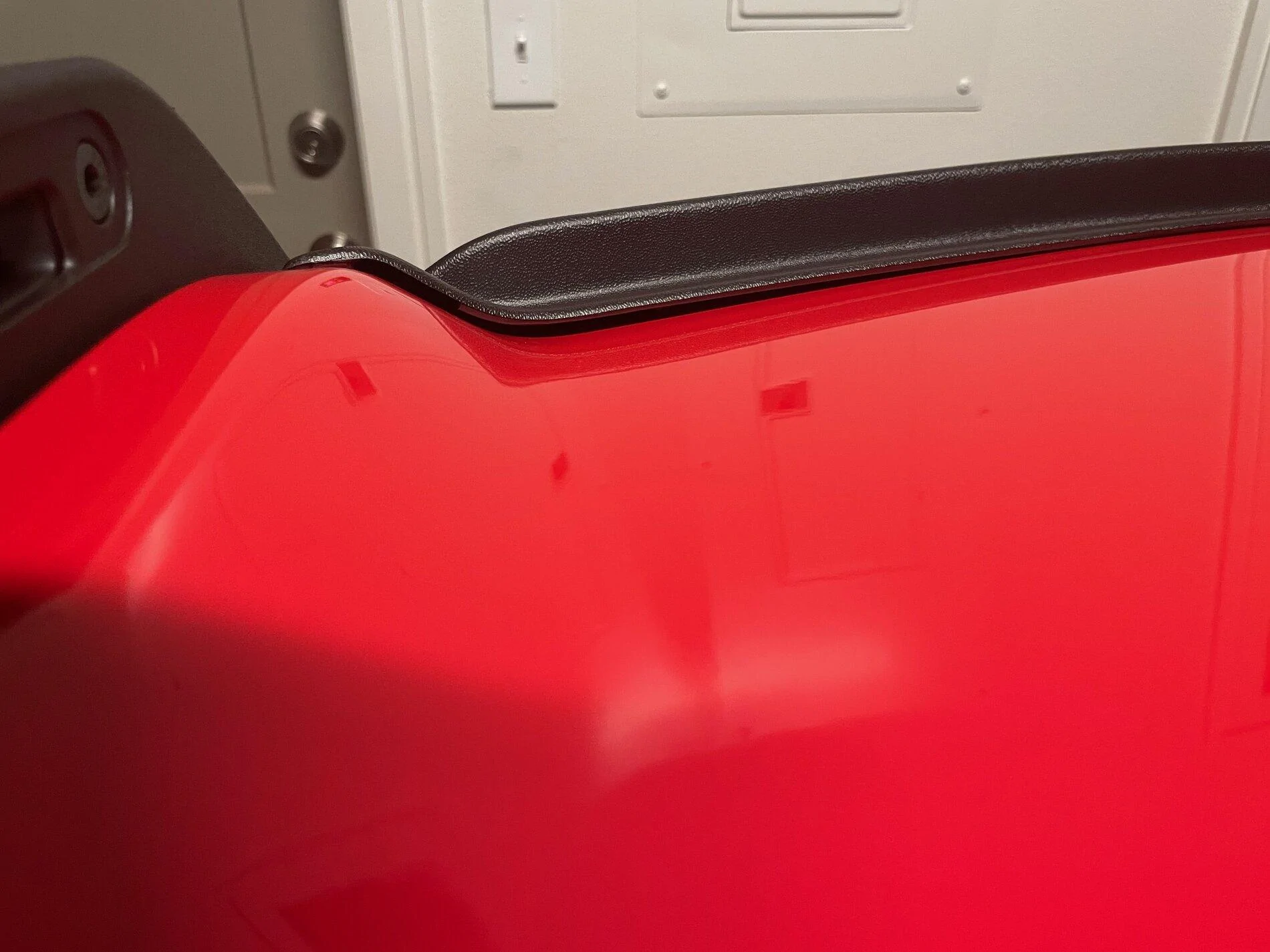

FRONT HOOD GUARD: Bought and tried to install several times but it was flexed and just wouldn't sit down straight. Considered using a head gun but haven't gotten around to it. Edges are sharp and the molding seemed a little "off" and it wouldn't sit straight on the driver side.

Hey All - been meaning to post about several things. All of the sudden we're at 3,000 miles and wanted to share a few things that may help other owners/shoppers. Picked up our Badlands back in August and immediately drove from OH to FL because we had just moved.
COMPARISON TO WRANGLER: We love them both. There are a couple things the Jeep did a little better and a couple things the Bronco did a little better. The Bronco soft top is a disaster compared to the Wrangler soft top (just our opinion). We leave the windows out all the time; they sag really bad. Our 2019 Wrangler Sahara had a sticker of $53K and our 2021 Bronco Badlands High package was $54K. The Bronco is a way better deal for what you get in our opinion. Apples to Oranges a bit since we didn't have a Rubicon. Our Wrangler had the 4cyl which was underpowered and had terrible turbo-lag. The Bronco has the 6-cyl and we're very happy that we went with the V6. Drove a 4-cyl Bronco demo and it seemed better than the 4cyl wrangler we had in terms of power, turbo lag and general responsiveness. The Bronco has more cargo space and more rear seating space but for some reason they didn't put rear vents in the Bronco like the Wrangler had. We live in south FL and have kids in the back and it gets a little hot when we're waiting in the school pick-up line sometimes. 3 Kids fit easily into the Bronco rear seats (1 toddler seat and 1 booster seat). Bronco has a strut on the tailgate that would have been nice to have on the Wrangler and also the Bronco is easier to load cargo into the rear but they didn't really give us a spot for that prop-rod that holds the soft top up back there. We are multi-generational Jeep people but we love this Bronco and are very happy to have it and intend to keep for a long time.

Great write up. Maybe I missed it, but what makes the bronco soft top worse than the jeeps? Just curious. Thanks. Your Bronco looks great btw!

How did you mark the guards and what did you use to cut them? Did you have to remove the crash bars?
Thanks! For the soft top comparison, we should clarify that the fabric and materials used are high quality and seem to be similar to the Wrangler. The issue is the locking tabs in the middle of the top that are supposed to latch when the top is half way up/down. Ours don't align and we have to slam the middle of the top down to force them into place. The hardware and amount of metal at the rear frame of the soft top seems excessive yet somehow the top is easily side-loaded and is laterally unstable which allows an inexperienced operator to easily scratch the paint on the rear roll bar. The windows look terrible and the frame has no rigidity to support them, hence the sagging rear windows. The Jeep top was easier to operate and seemed to have less metal framing and functioned better. Hopefully Ford re-engineers the soft top in the near future.

maybe some details on how you modified the flaps for some would help them out…

being a handy individual and having the guts to take a razor knife to a new set of flaps (as an example)is something I think all of us owner/operators are going to have to be or become.

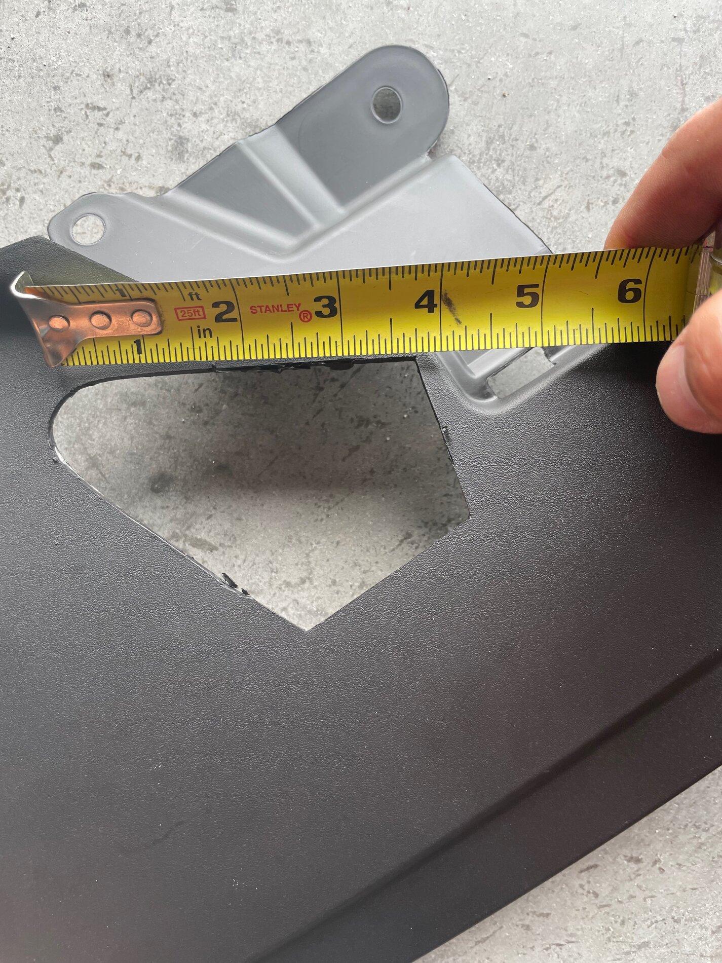

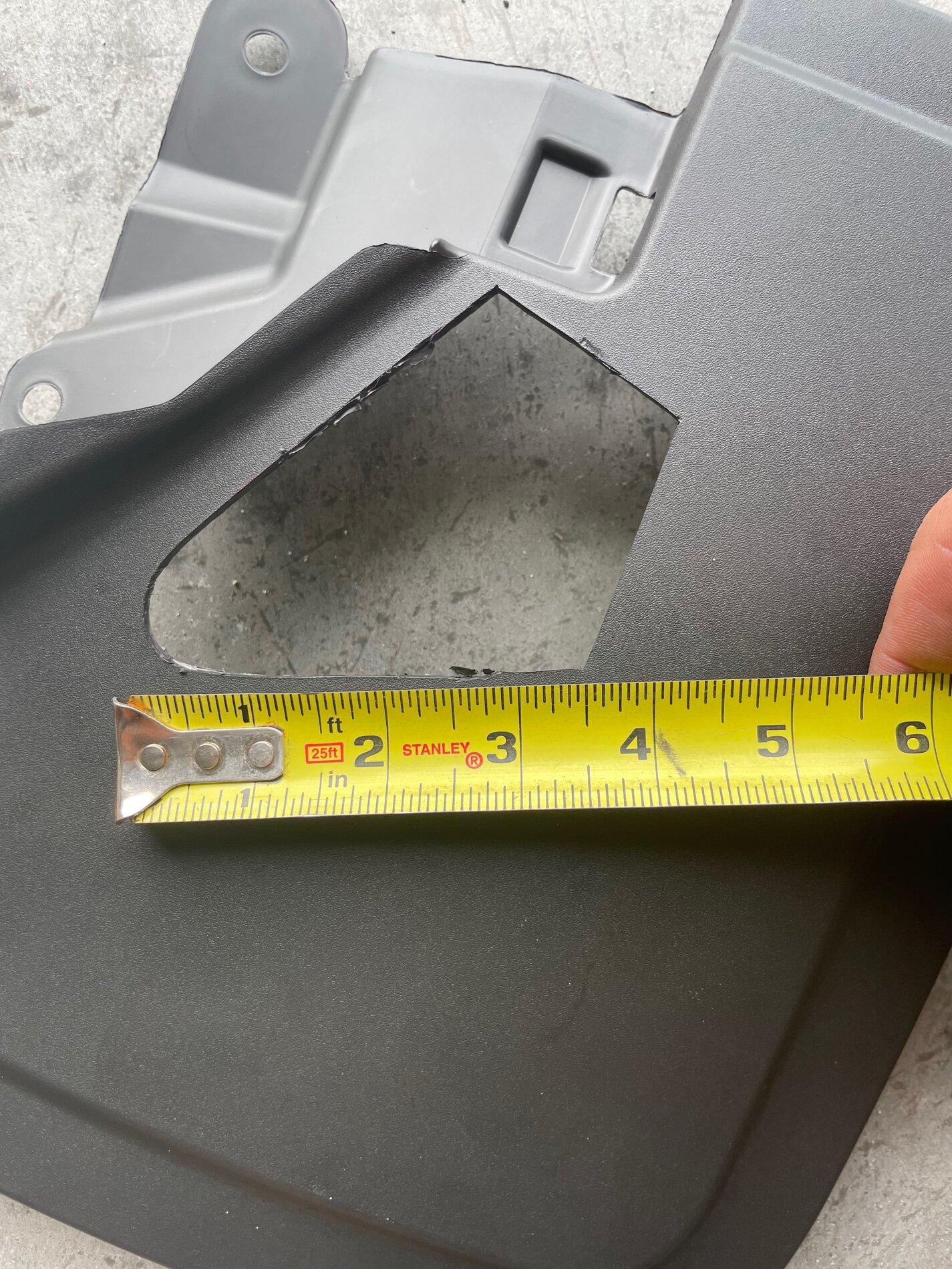

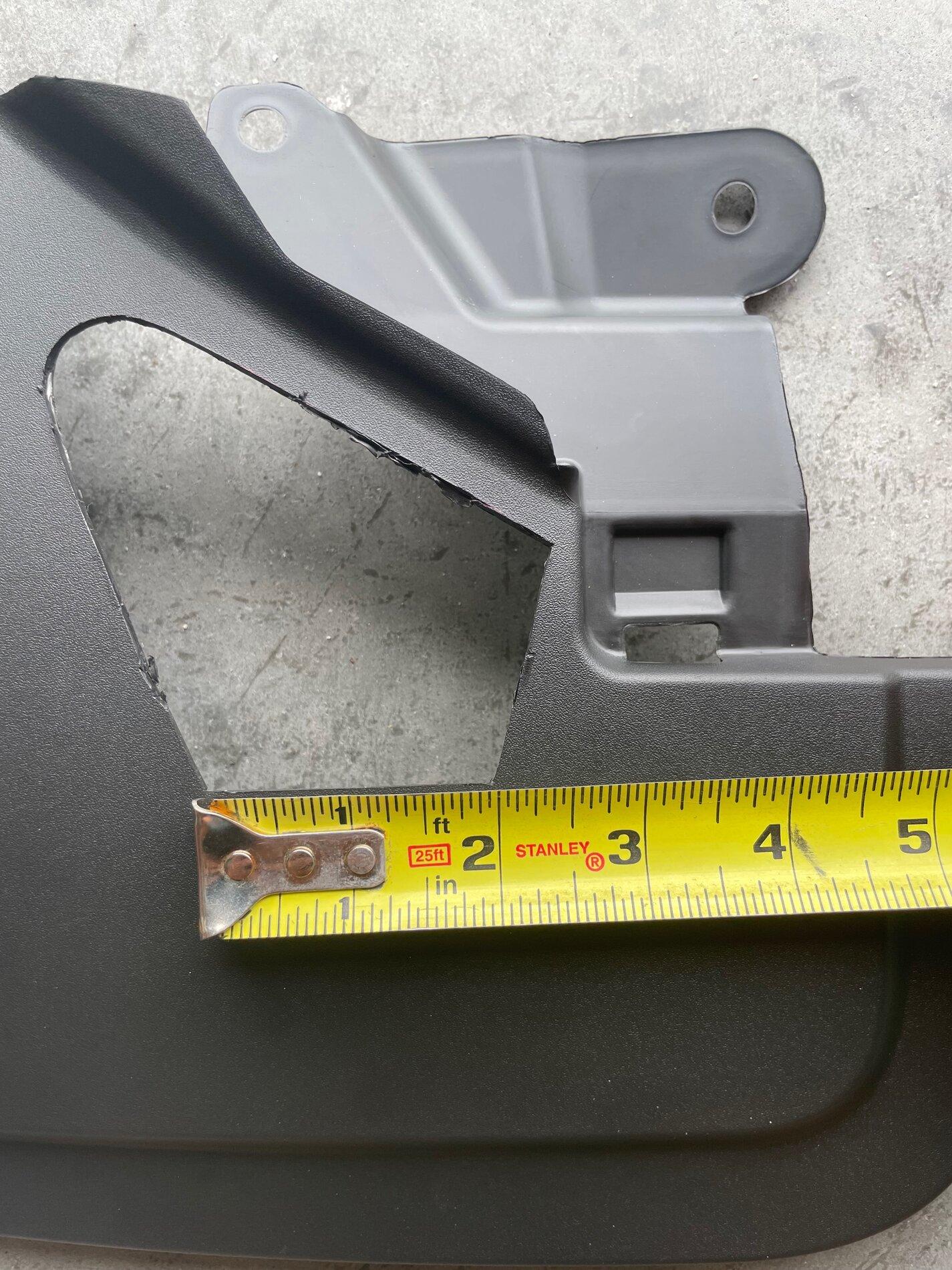

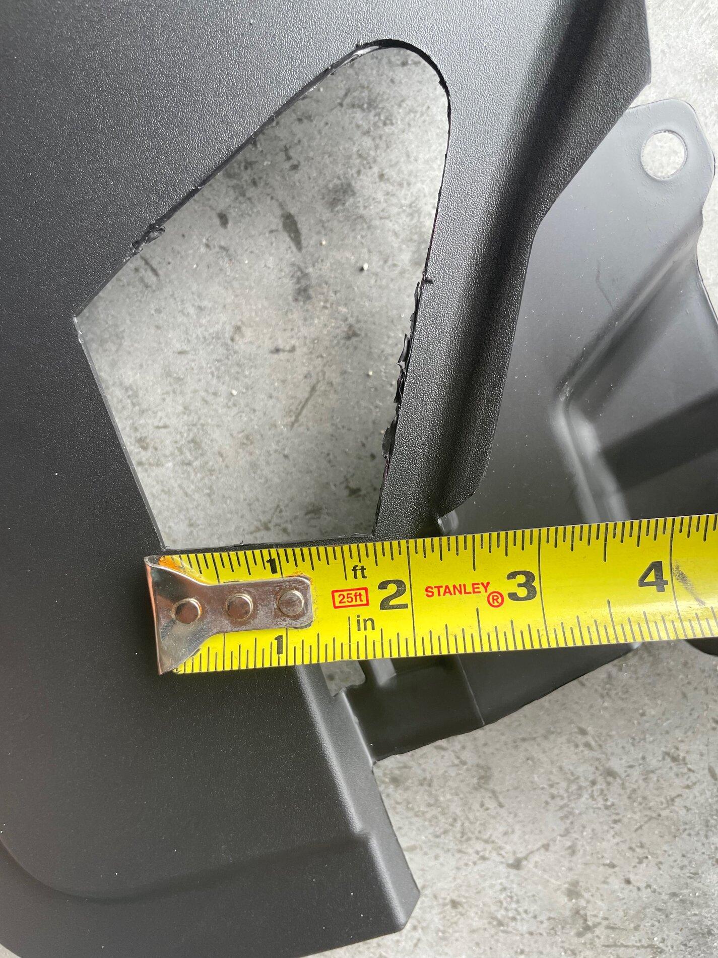

I removed the hardware that would have allowed me to install the guards if it weren't for the rock rails. Did not need to remove the crash bars (removed 1 on the first side then realized it was unnecessary so didn't do it on the other side). I used some 3" drywall screws and inserted them into the holes to try and line up the holes that the guard was supposed to mount in and also held it with my hand and eyeballed the alignment

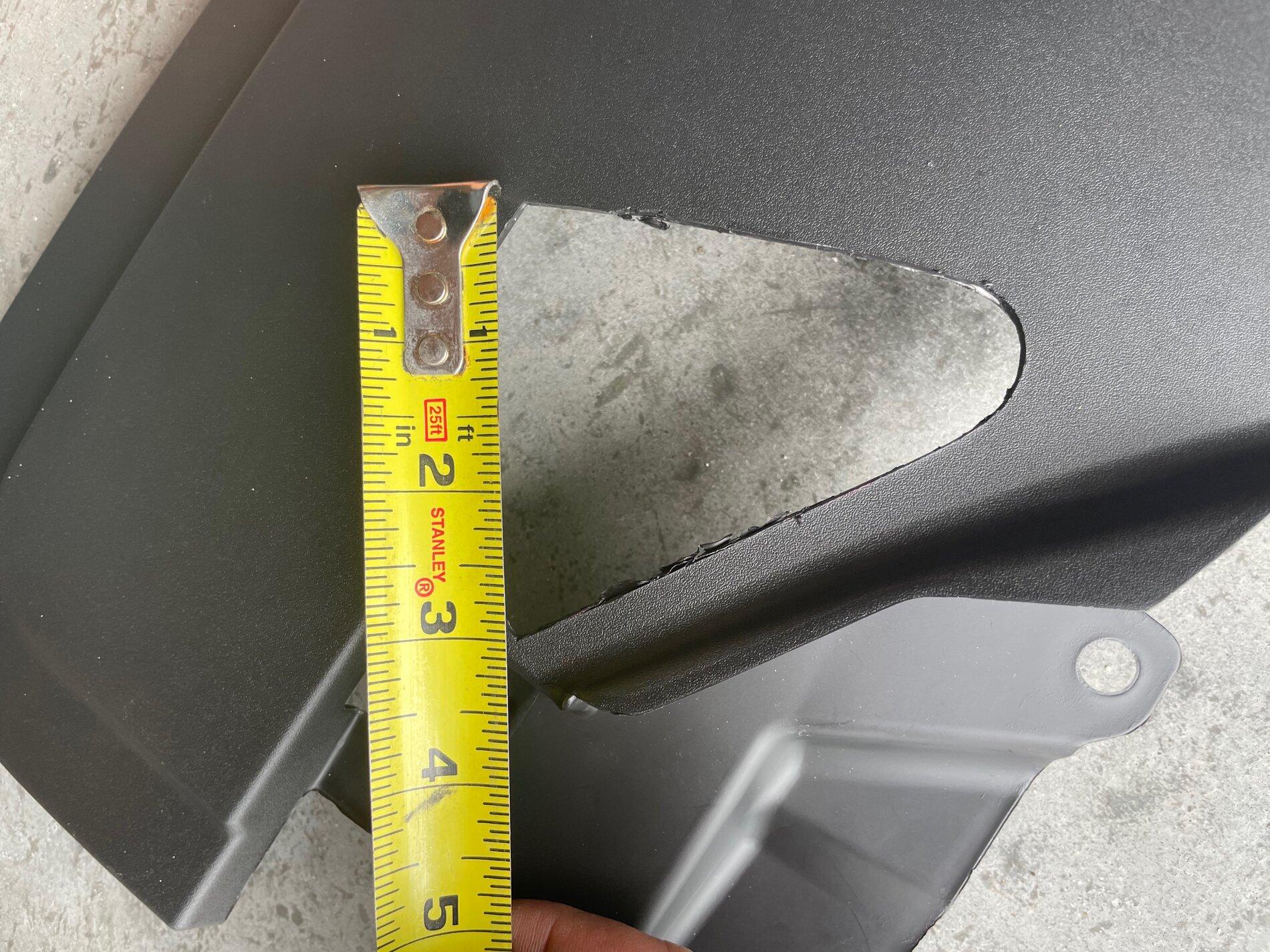

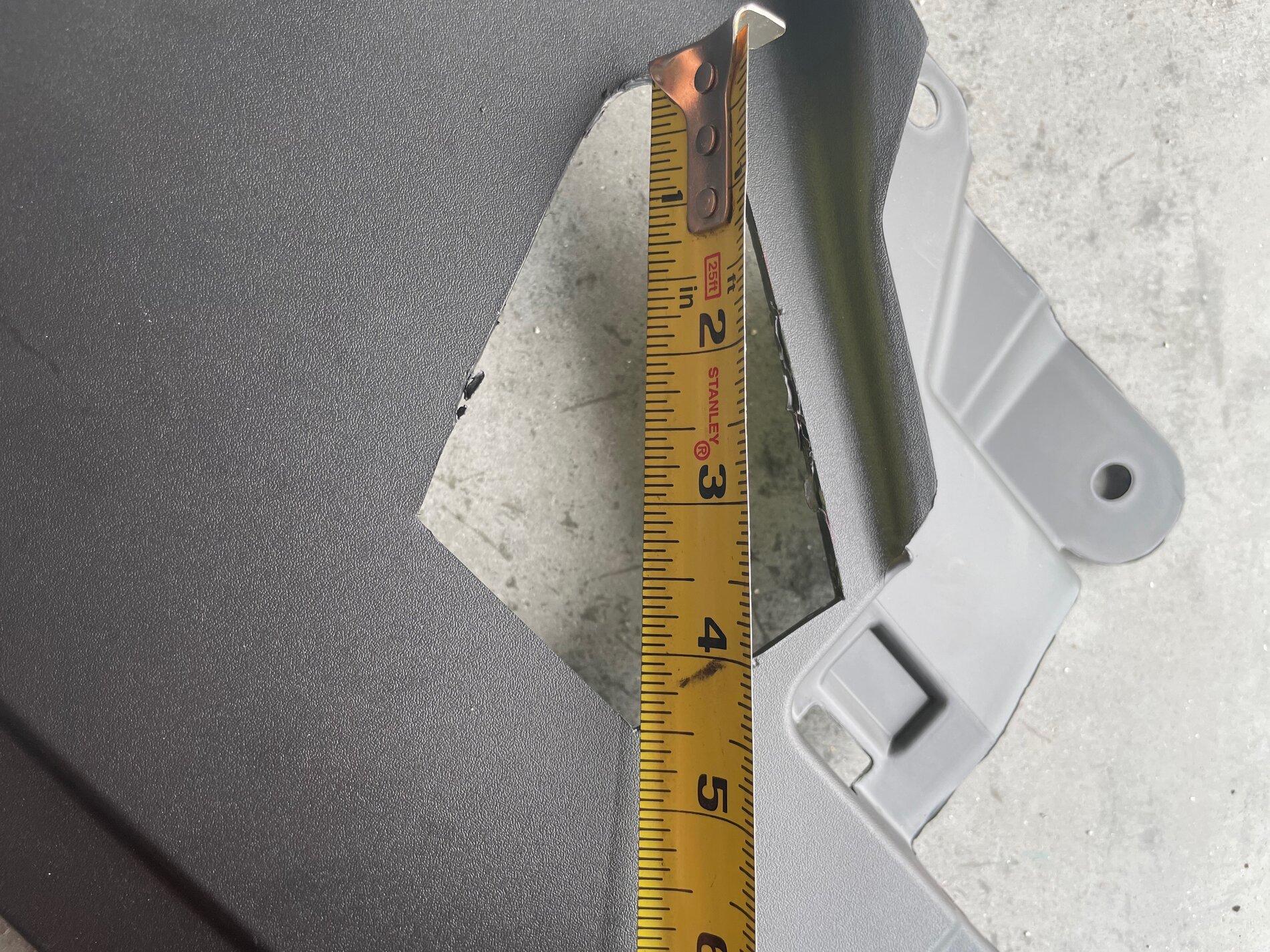

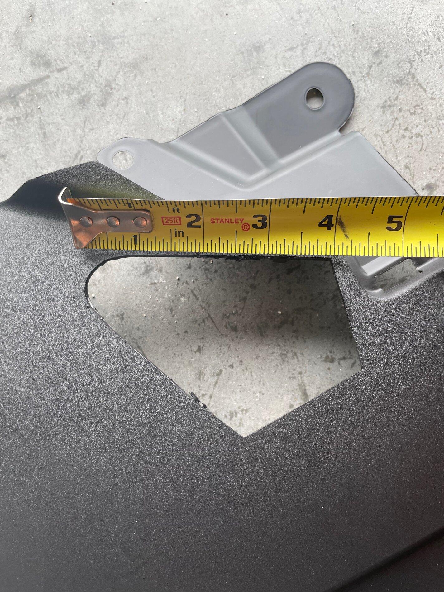

and used a sharpie to draw an outline of where the rock rail was hitting the outside surface of the splash guard. Then I used a utility knife and carefully cut and cut and cut until I got through the plastic. Probably could have drilled some holes or used a dremel and it would have been much easier and safer.
Nice thank you
Slide
Oct 20, 2020
Tn
Lx570
Thank you for the photo with dimensions of the cut out . If one of the next people to cut the mudflats that is extra handy makes a template that could be printed out please share. They would be much appreciated to those of us wanting to install these.

Did you buy and install the rear splash guards? Can they even be installed with rear bumper? Thanks!

Is there mud flaps that will fit when you have tube steps on your bronco?

Can confirm that it’s pretty easy to scratch the roll bar when putting the soft top back up. It’s possible to do on your own but just make sure you’re straight on when you start to lift as there’s lots of sharp edges.
My rear windows don’t seem to sag much but putting everything back together after it gets below 60 degrees is a chore. No different than putting the toneau (sp?) cover back on my old pickup in the cold though and I kind of expected it.
