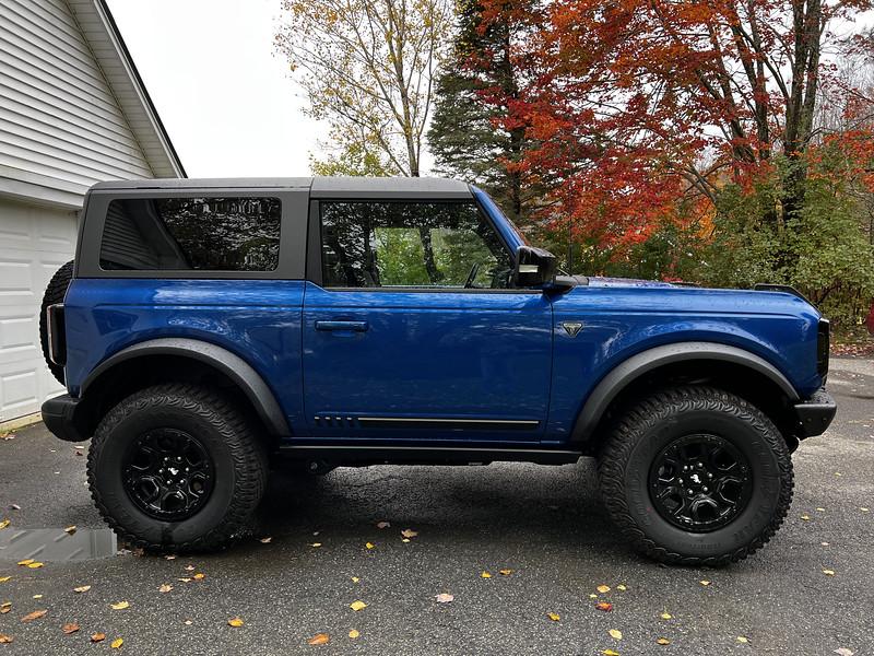

Well, I figure it's probably about time to make a build thread. One of the best things I found with my Mustang thread was how easily you can keep track of the changes you make. If the Bronco is anything like the Mustang, there will probably be a lot of changes to come. This will probably be documented in a similar way to the Mustang- with too many details and probably even more pictures. Hopefully some of what's in here can help other members.
Originally, I wanted an Oxford white, or even Star white First Edition to match the rest of my vehicles. Since white was not an option, I had to make a color change. Converted to order on 1/29, production started on 9/16 and brought her home on 10/14. A 2-door First Edition in Lightning blue with Navy Pier interior.

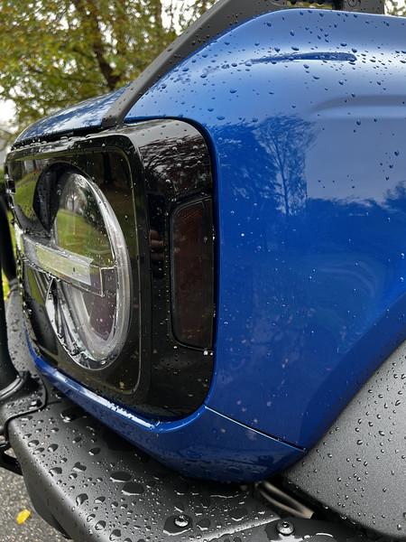

Dark blue overlays from Vortex:
Ford Bronco Terminated's Bronco FE Build w/ Wrapped White Top & Mirrors i-dqnt2Nj-L

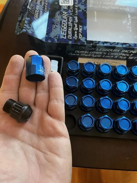

Project Kics 2-piece chromoly lug nuts:

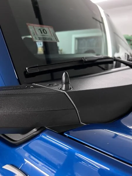

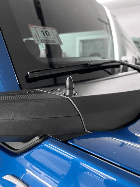

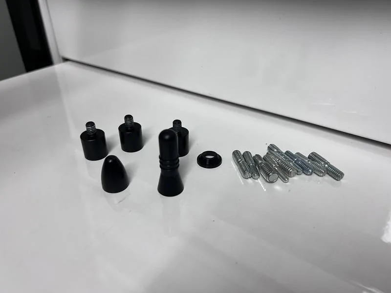

Raptor AntennaX:
Ford Bronco Terminated's Bronco FE Build w/ Wrapped White Top & Mirrors i-LGngvvw-L

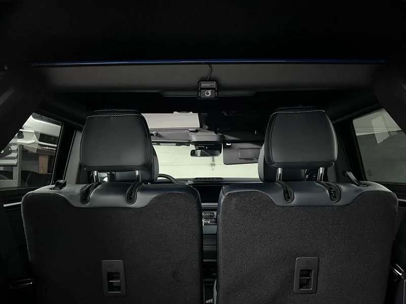

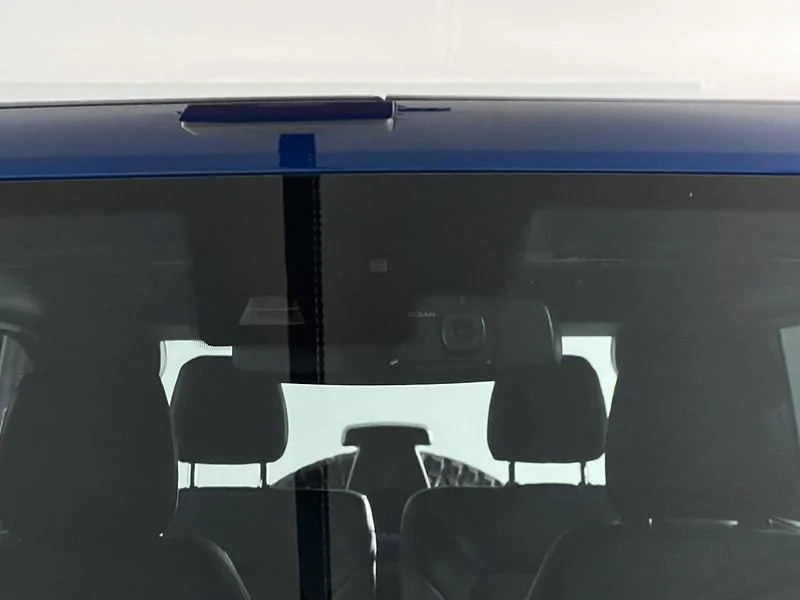

With the Bronco back, it was time to get all of the awaiting pieces on... I started with the emblems and then moved onto Screen ProTech and Grdian Nova front/rear dash cam.
Ford Bronco Terminated's Bronco FE Build w/ Wrapped White Top & Mirrors i-FnwbX5X-L
Ford Bronco Terminated's Bronco FE Build w/ Wrapped White Top & Mirrors i-Km3Rtwv-L
Ford Bronco Terminated's Bronco FE Build w/ Wrapped White Top & Mirrors i-csxt4tS-L

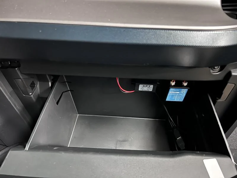

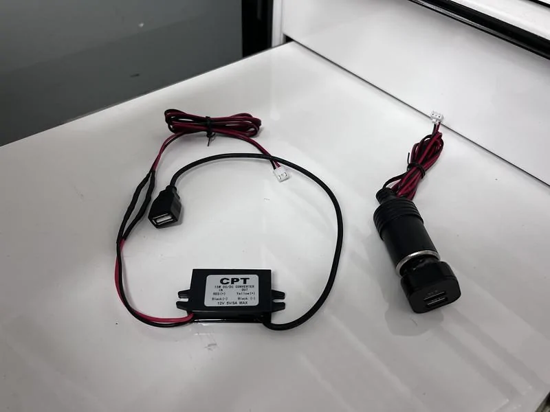

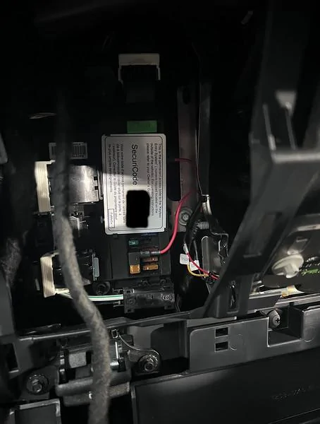

The dash cam kit comes with a hardwire kit that uses a cigarette lighter styled plug and USB adapter. For me, this just was not ideal. replaced the bulky plug ends with a simple 12v to 5v converter box. Then it was as simple as running the wiring, tucking it neatly away and mounting the boxes.

With that finished, I swapped out the lugs (some of OE lugs felt very easy to break free... I'd suggest checking torque) and wet sanded the mirror caps from 1000 through 5000 grit and polished them. Installed the caps and replaced the Xpel. Followed up with the new antenna. Lastly, I popped in UPR's BOV adapter just so I can hear some turbo noises.

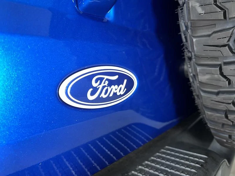

How hard was it to remove the rear Ford badge? I have a new one for mine and have yet to find a video or directions of someone taking that off. Also, do you have a link to the lug nuts? I would like to get those but in black. Thanks in advance.

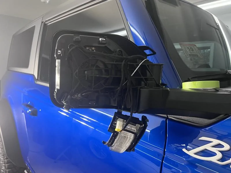

On the new mirrors I just ordered from Xpel and got the pre-cut set. Doing them wasn't bad at all, but I certainly wouldn't do an entire vehicle myself. Not enough talent for that lol

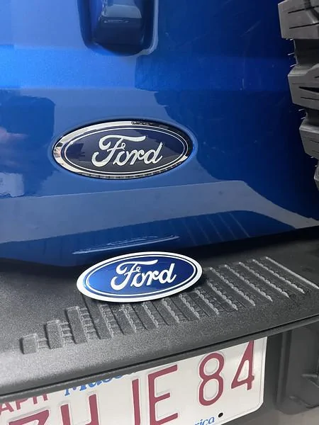

Rear badge comes off pretty easy. I just use a non-marring pry tool to lift it and a little heat to soften the double-sided tape. It does have two plastic guide pins on each side, so just be careful not to break those. You probably won't be reusing the badge, but the pin can fall into the swing gate. Don't know of any videos for the Bronco specifically, but a lot of them come off the same way- pretty sure Escape and Explorer are the same size and layout. I'd bet there's YouTube videos for those.
Picked up the lugs from Evasive Motorsports. Comes in a set of 20, so you'll need 2 sets or to try and get a few singles.

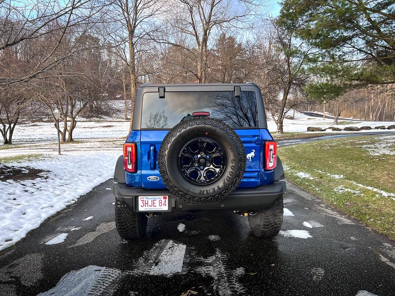

You should blank out your key code . You are showing it to the world and they find key pad and can unlock your bronco just food for thought

That may be a little tricky to do on mine… but blanking probably isn’t a bad idea

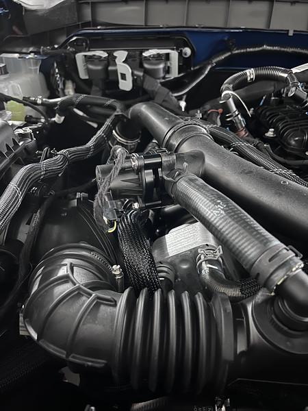

Panda motorsports sells BOV delete, remove to short hose and cap off. Wonder if it works for 5$.

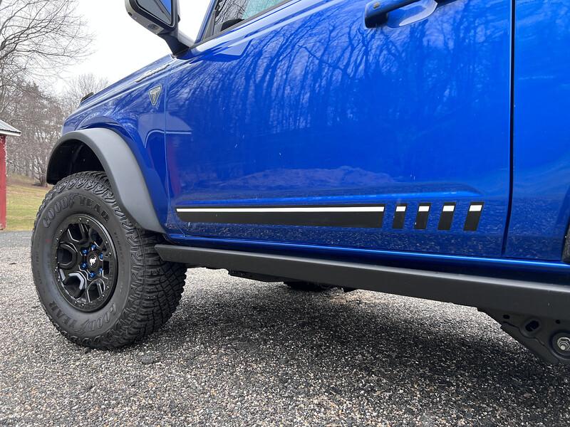

Using leftover vinyl and knifeless tape I went over the reflective silver

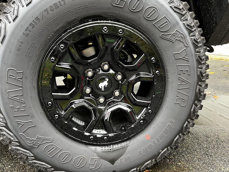

Putting the top on seemed like a good time to swap out the hardware for GPCA t-handles...
Ford Bronco Terminated's Bronco FE Build w/ Wrapped White Top & Mirrors i-VPt5kQn-L
Ford Bronco Terminated's Bronco FE Build w/ Wrapped White Top & Mirrors i-KkkLCRg-L

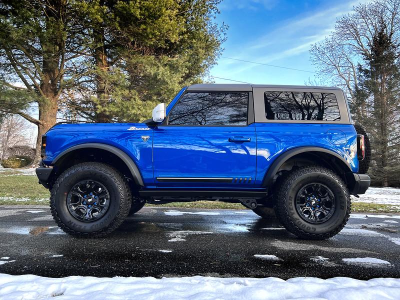

Final product:
Ford Bronco Terminated's Bronco FE Build w/ Wrapped White Top & Mirrors i-6XShsJV-L
Ford Bronco Terminated's Bronco FE Build w/ Wrapped White Top & Mirrors i-JZMb73d-L
Ford Bronco Terminated's Bronco FE Build w/ Wrapped White Top & Mirrors i-Hz2XmQw-L
Ford Bronco Terminated's Bronco FE Build w/ Wrapped White Top & Mirrors i-cpSXTgd-L
Ford Bronco Terminated's Bronco FE Build w/ Wrapped White Top & Mirrors i-TF59g7N-L
Overall I'm happy with it. Achieves that old blue/white look of the older generations. Some of the MIC texture does show through with the vinyl, but I'm okay with it for now.
