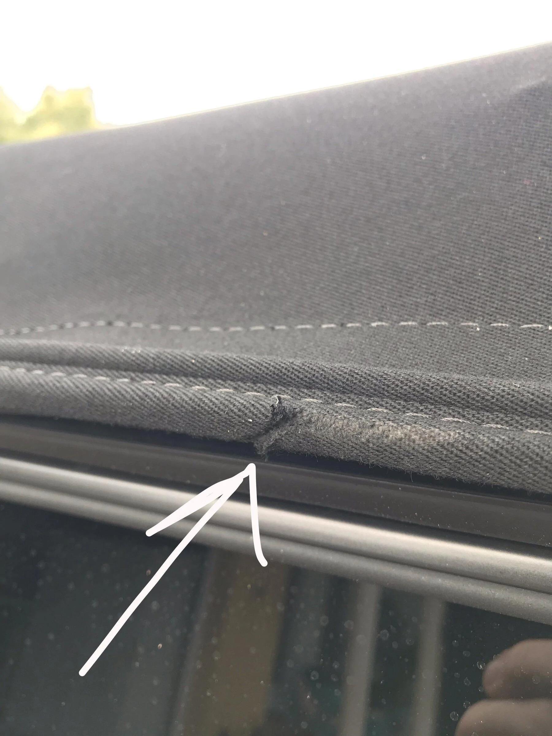

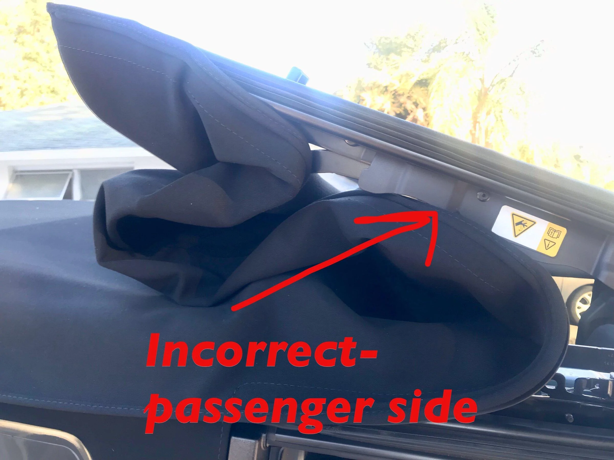

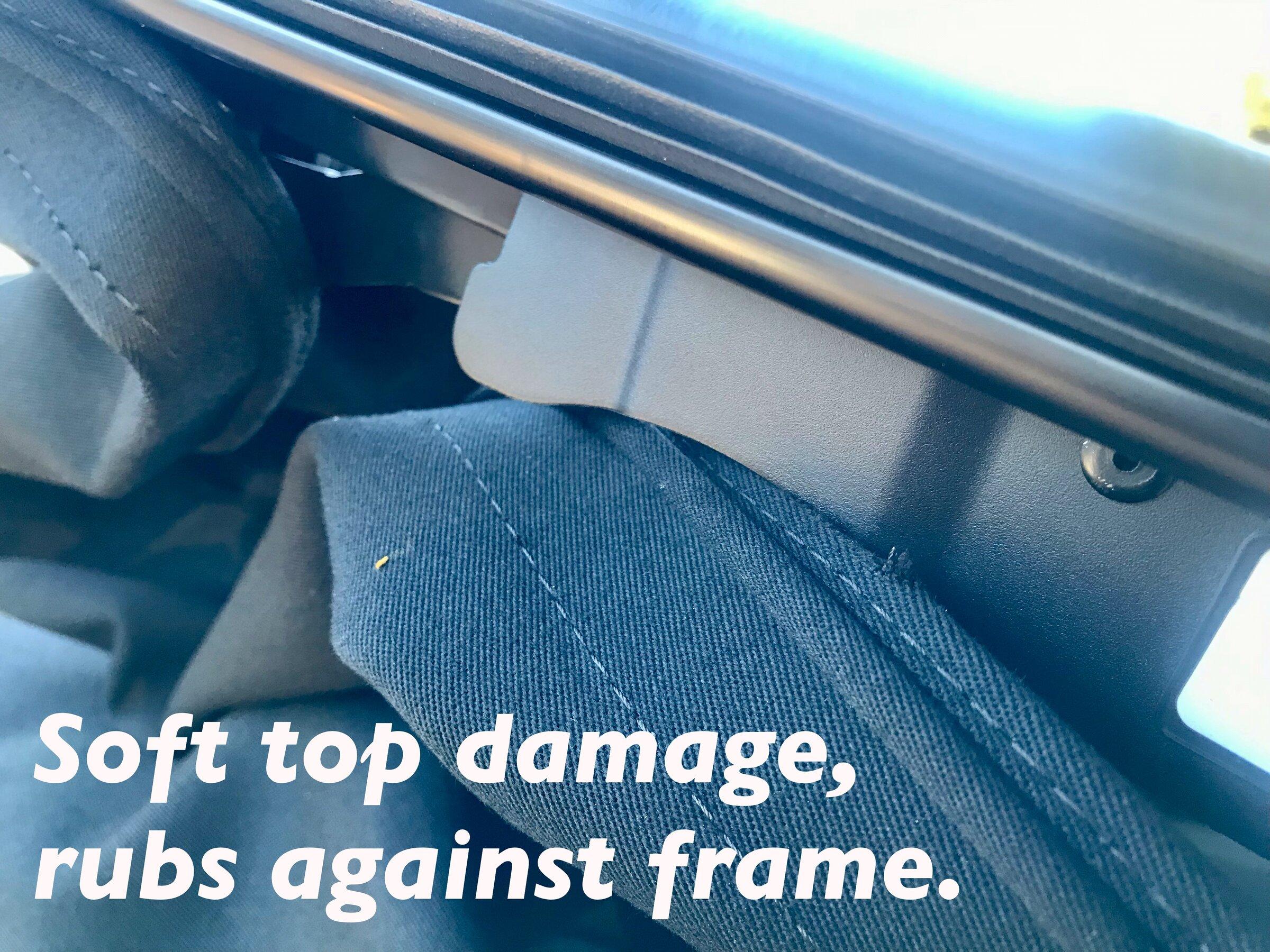

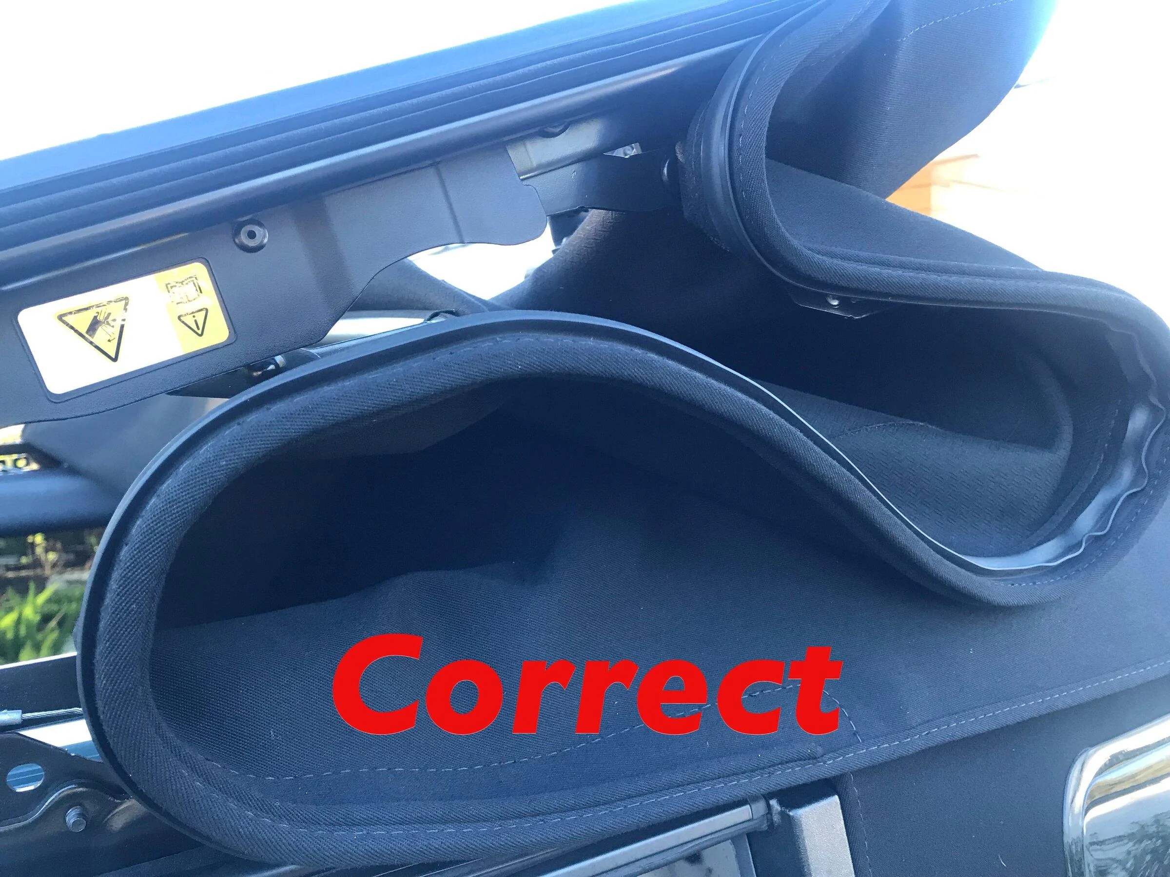

This is a follow-up regarding a post from Bronco6G member Berwolf who posted canvas failure as soft top “can fold under the frame and rub against a piece of plastic.”
I want all soft top owners to know this because the soft top on my Bronco has the same problem. I’m adding photos showing what I discovered on the Passenger side of my Bronco. YOU MUST INSPECT the roll back process and manually retract the canvas as I had because there can be an asymmetrical fabric rollback and thus rubbing which may occur against the frame. Any help from @Ford or other Bronco owners experience and feedback is greatly appreciated. Thank you for your time and I hope this helps everyone.

When I was selling jeeps, this is that we taught all new buyers to do when flipping soft top back.
Yeah I’ve never owned a Jeep before but now I know . Live and learn. Might be something for Ford to let dealerships know about .

Manual dressing of the top is common on many convertibles, especially when new. Once they break in, they behave better, and will usually settle into the proper position on their own.
