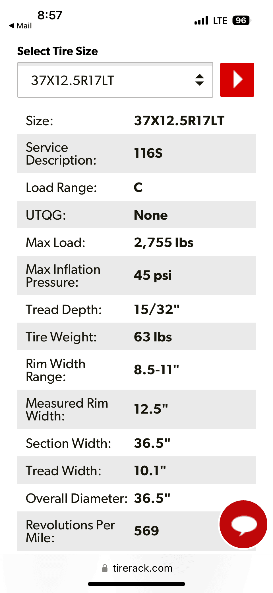

Toyo ATIIIs have a 35/12.50/17 with a C rating.

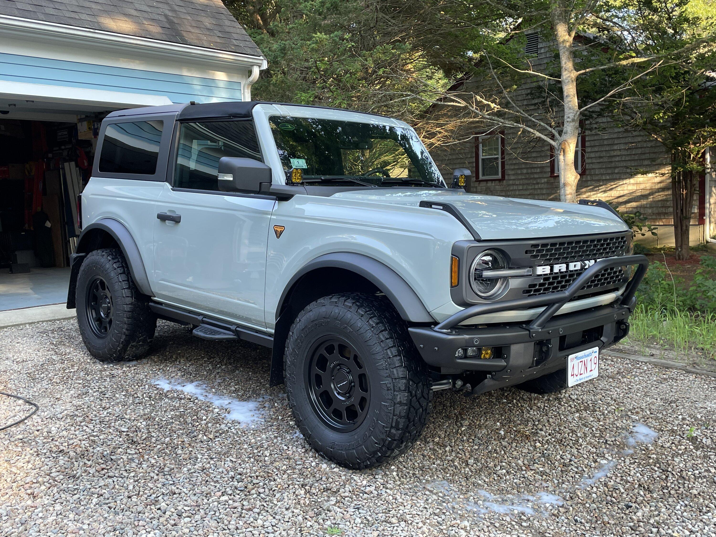

I have 35 cooper discoverers load E. Load E tires on bronco imo are fine,air pressure less and ride is great. I run mine at 25psi. Did chalk test and was perfect. Had these tires on another vehicle too. No noise or hum. Lasted 60k on my f350. I couldnt find any load C that I liked. Air pressure is key or you will knock your teeth out. Lol

I picked up a set of the new hybrid Falken Wildpeak RT's, 285/75/17 load range C. The 35x11.50 also comes in a C range. Road noise is minimal and so far I like the handling on and off road.
