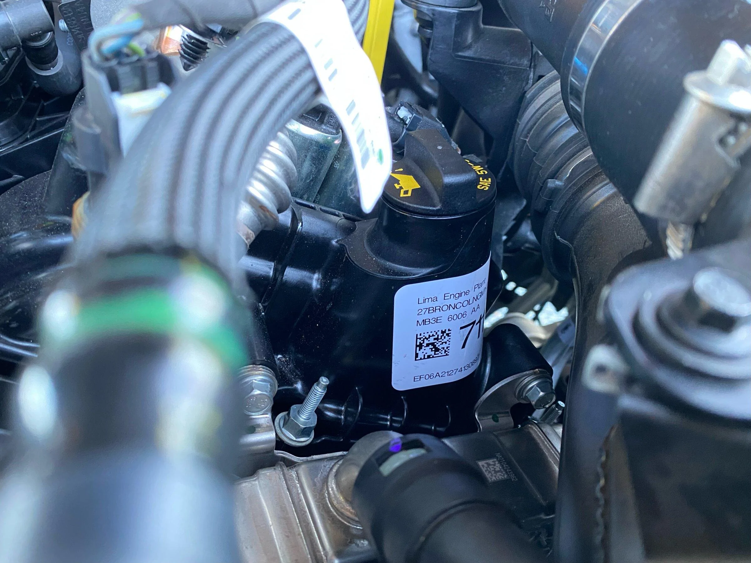

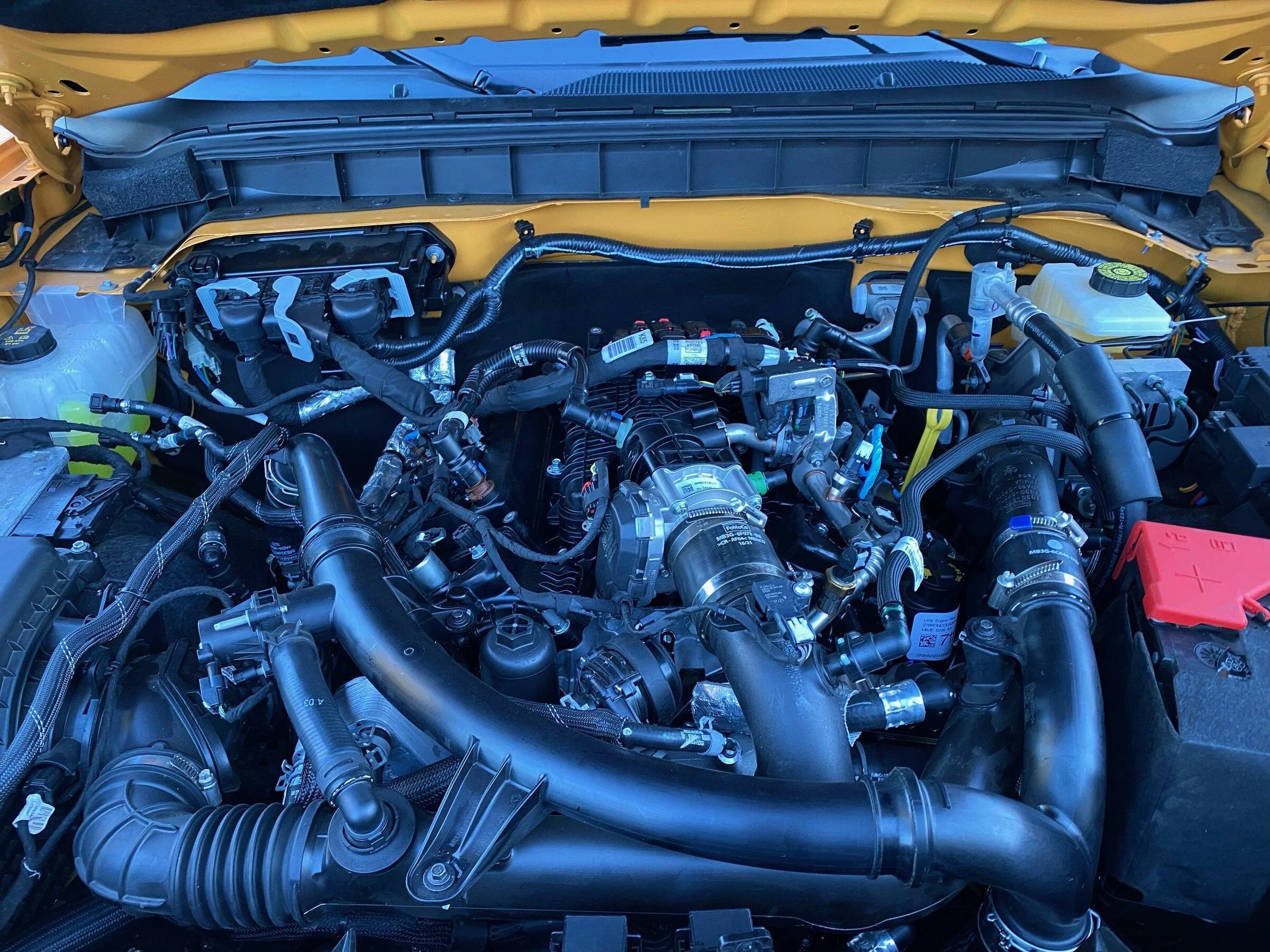

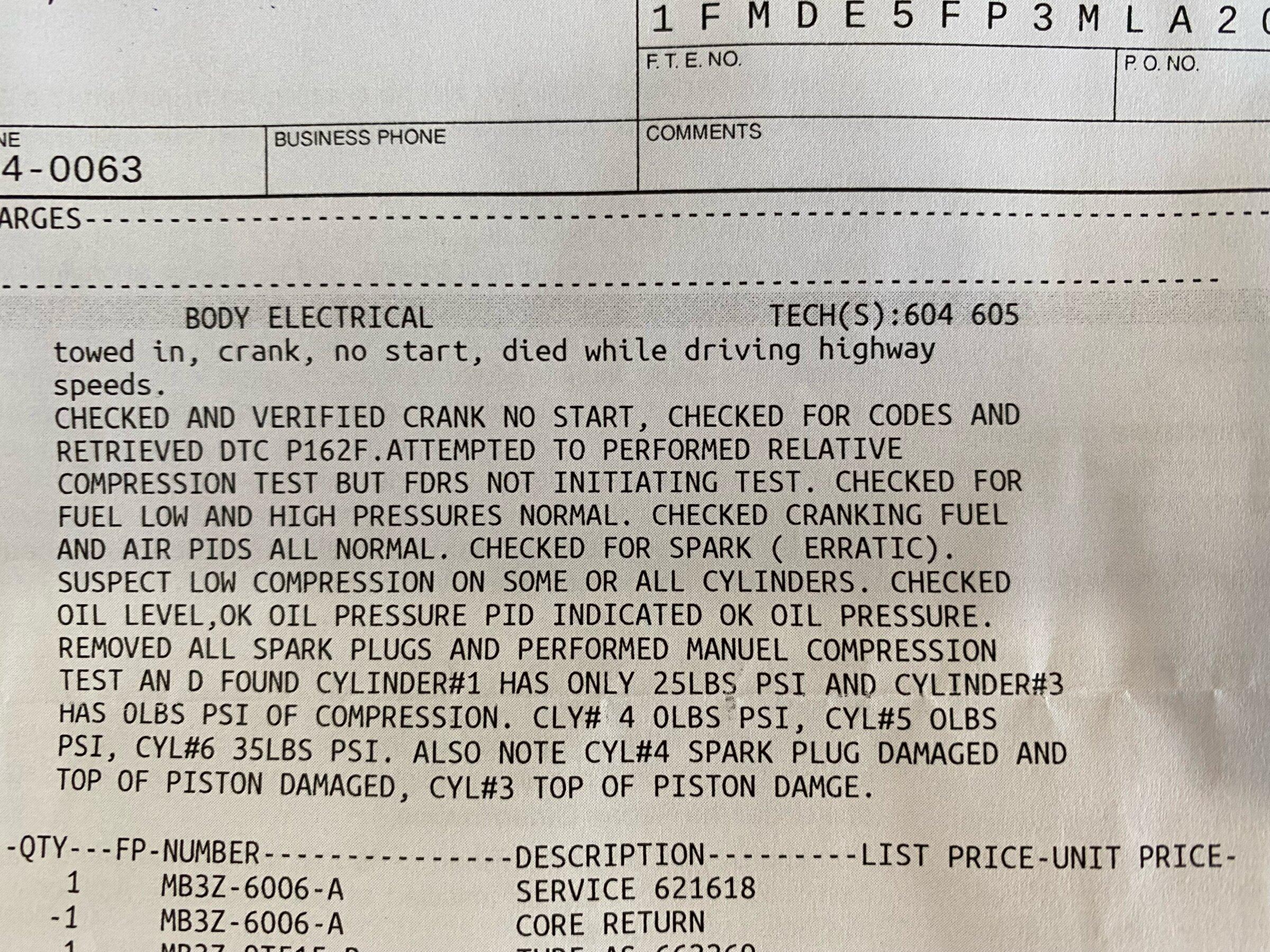

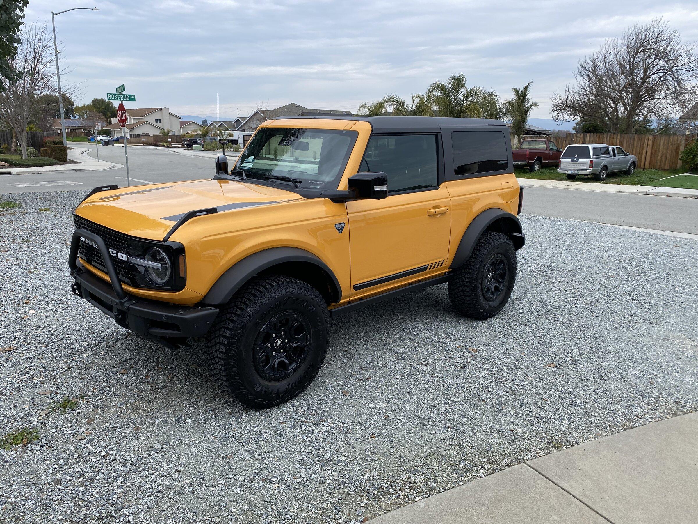

several folks have contacted me to show pics of the new engine. Adding them below. (She is still running great too!)
It took 40 days but my Bronco is back home!
On 12/23, the engine died and it needed to be replaced (read original thread).
Today, 01/31, I got her back! I've only driven about 30 miles today, all seems good so far. I will be taking her to my local OHV Park tomorrow to giver her a proper shakedown!
Ford Bronco After 40 days, my Bronco is back home after new 2.7 engine replacement (for dropped valve)! bronco diagnostic
Ford Bronco After 40 days, my Bronco is back home after new 2.7 engine replacement (for dropped valve)! bronco home
Ford Bronco After 40 days, my Bronco is back home after new 2.7 engine replacement (for dropped valve)! bronco new engine 1
Ford Bronco After 40 days, my Bronco is back home after new 2.7 engine replacement (for dropped valve)! bronco new engine 2

Glad you're back on the road!

Wow. Not related to the dropped valves??

Glad to hear! From the report looks like it actually lost 2 cylinders.
Looks like #'s 3, 4 & 5 to me. ;)

It took 40 days but my Bronco is back home! On 12/23, the engine died and it needed to be replaced. Today, 01/31, I got her back! I've only driven about 30 miles today, all seems good so far. I will be taking her to my local OHV Park tomorrow to giver her a proper shakedown!
Congrats, happy for you...
