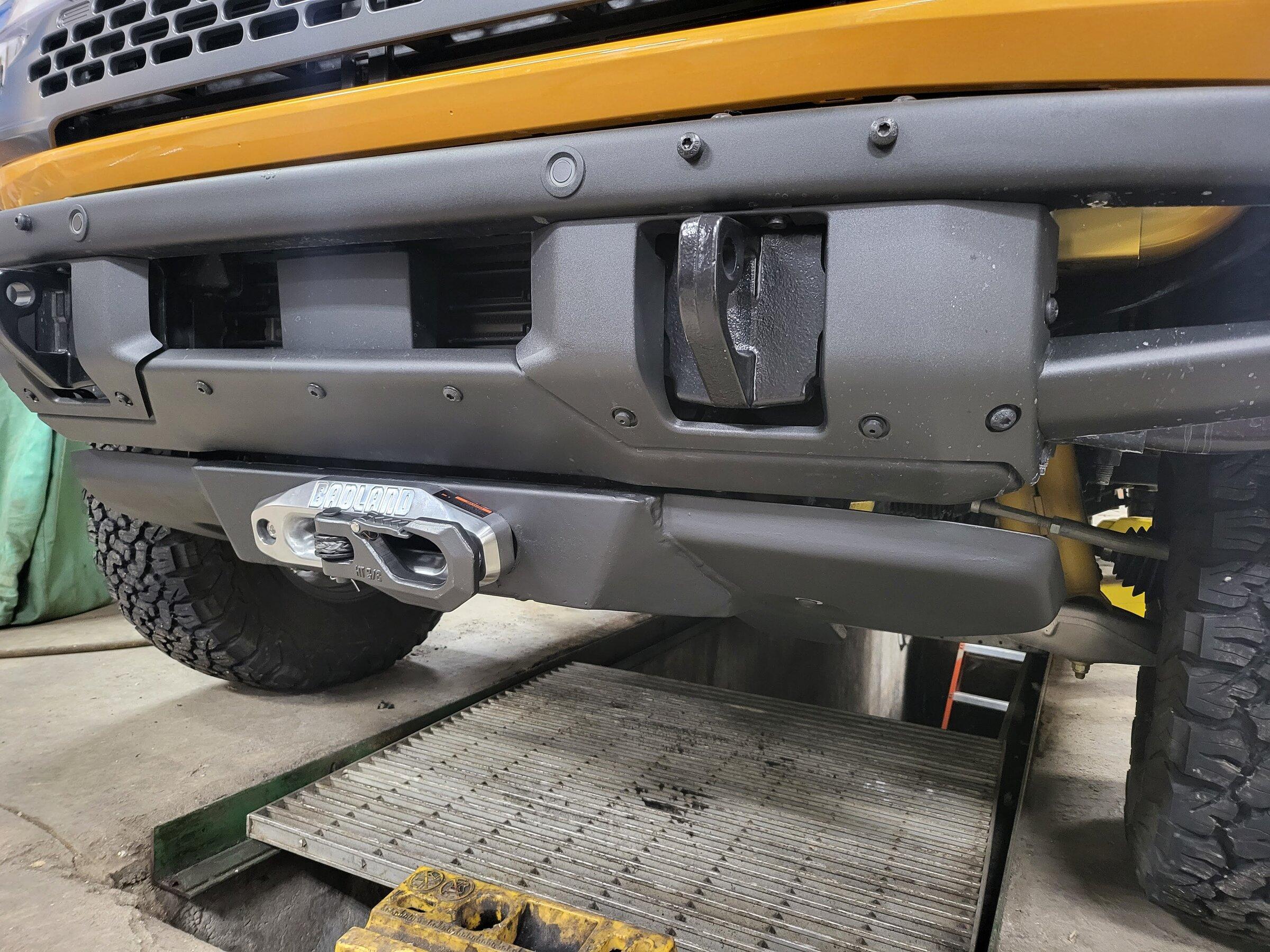

Originally posted a few pictures of my install in the "What did you do to your Bronco today" thread and had quite a few questions so thought I'd post more in a thread of its own.

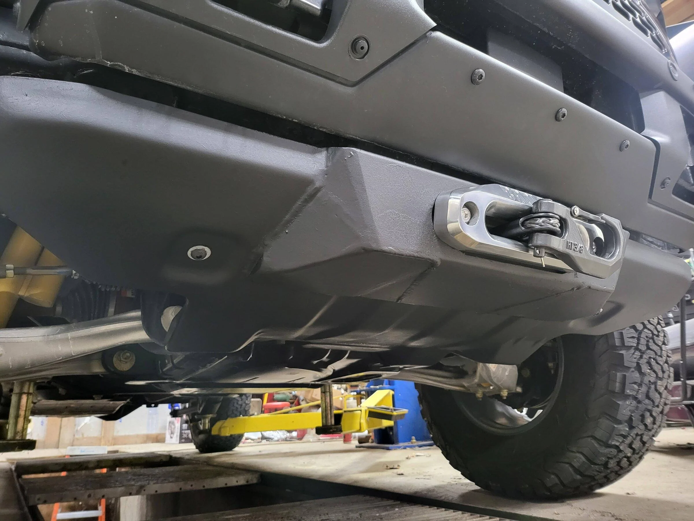

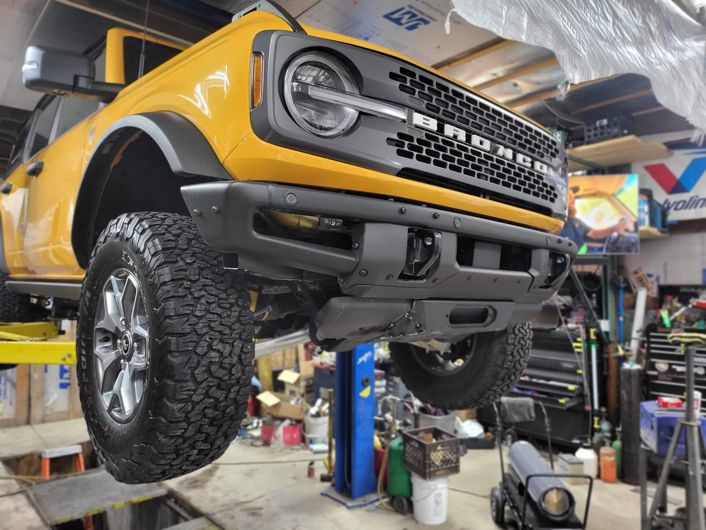

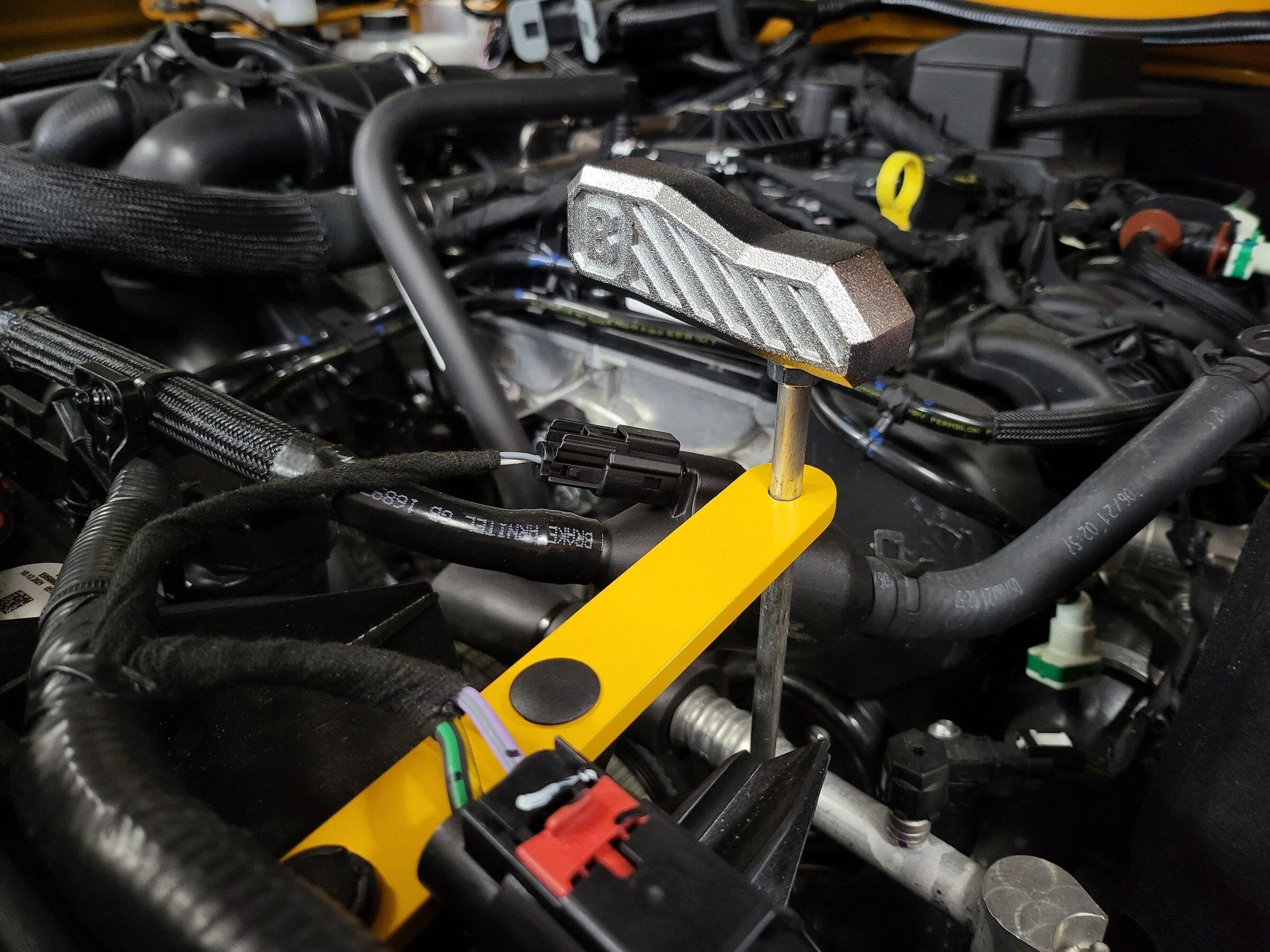

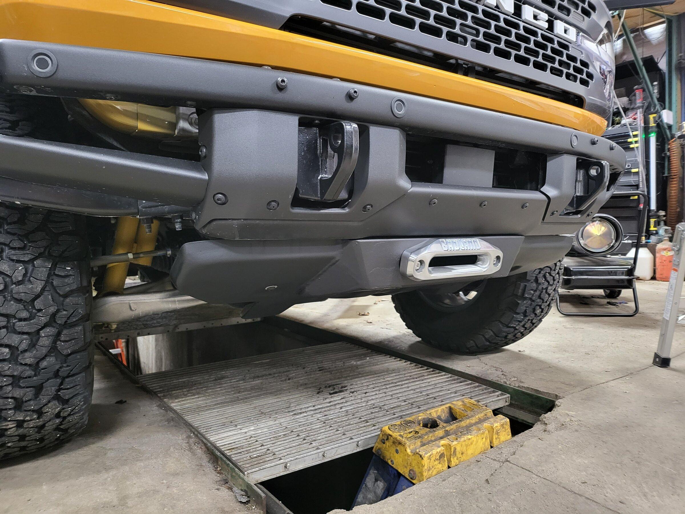

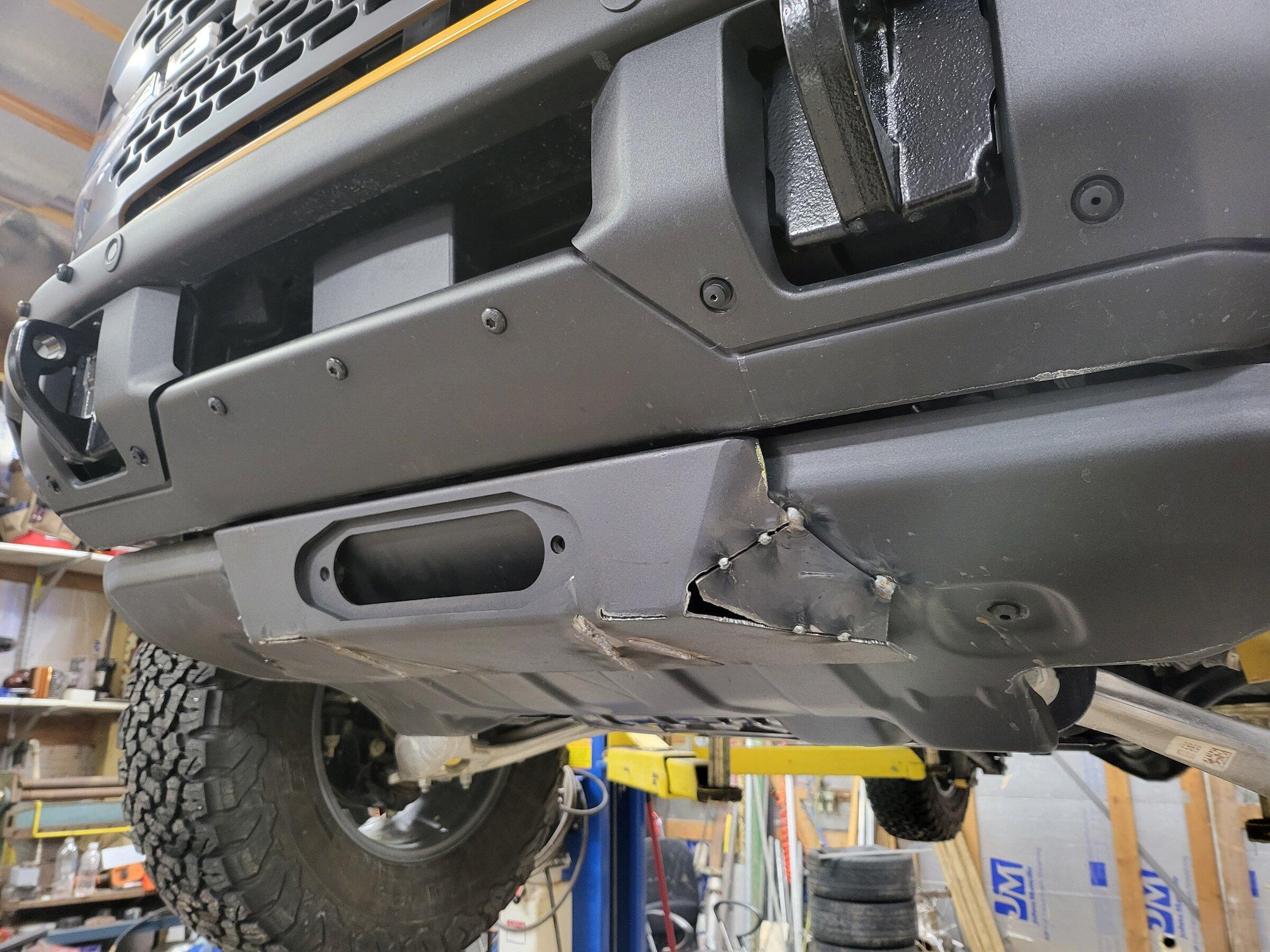

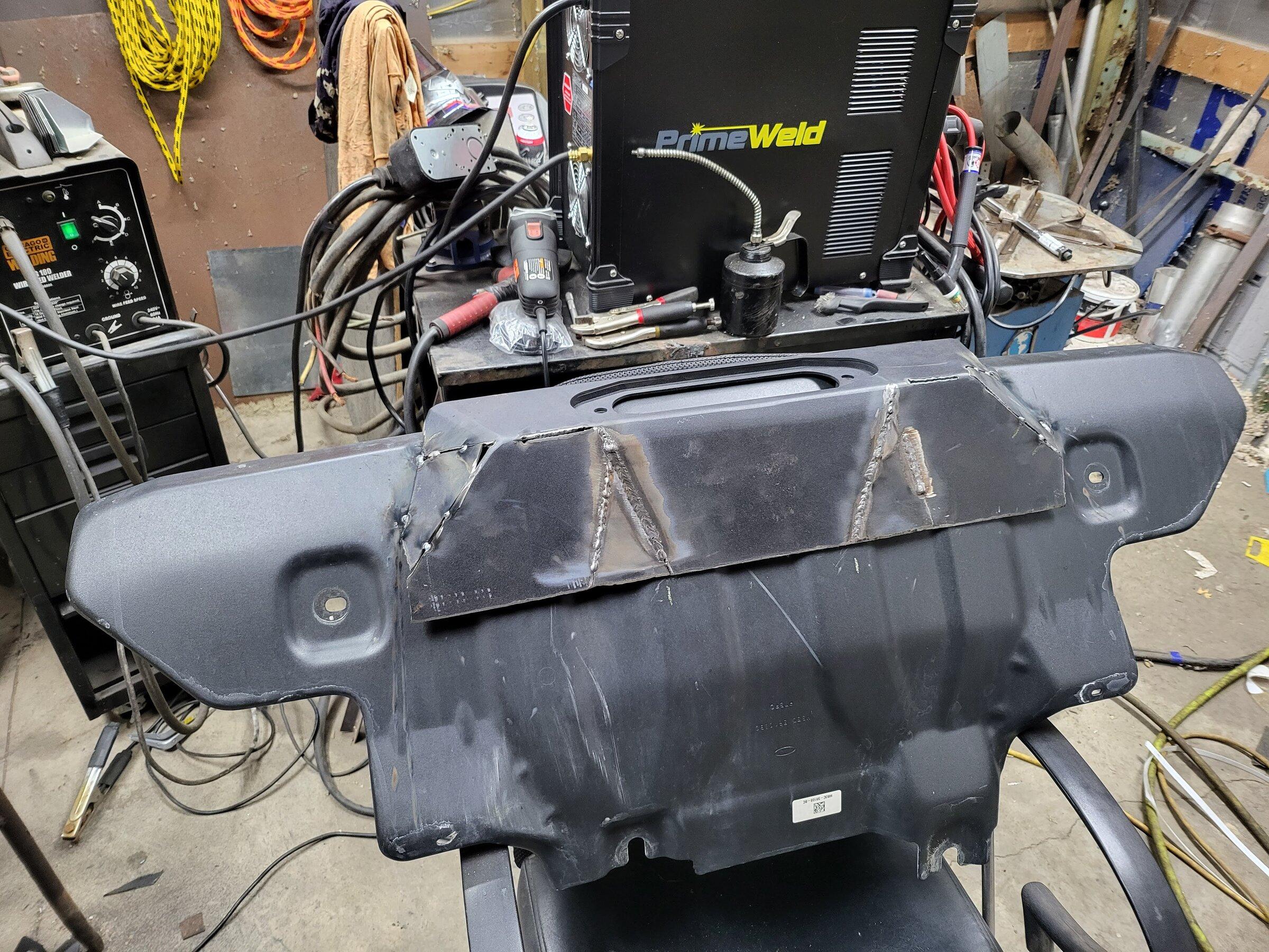

So I went in a slightly different direction than what I've seen others go with my Rough Country Hidden Winch install. Mainly, how I modified the clutch release lever to make it easily accessible. As for the modifications made to work with my Mod Bumper, I morphed the RC skid plate into the BL skid and everything bolted right back up with a small spacer on the front two skid plate bolts. Went with the 12K lb. Badland APEX winch and thought I might have to remote mount the control box but everything fit nicely. So far have been pretty happy with how it all turned out.
Ford Bronco My version of the RC Hidden Winch install - 2.3MT Badlands Mod Bumper 20220208_021651
Ford Bronco My version of the RC Hidden Winch install - 2.3MT Badlands Mod Bumper 20220208_021718

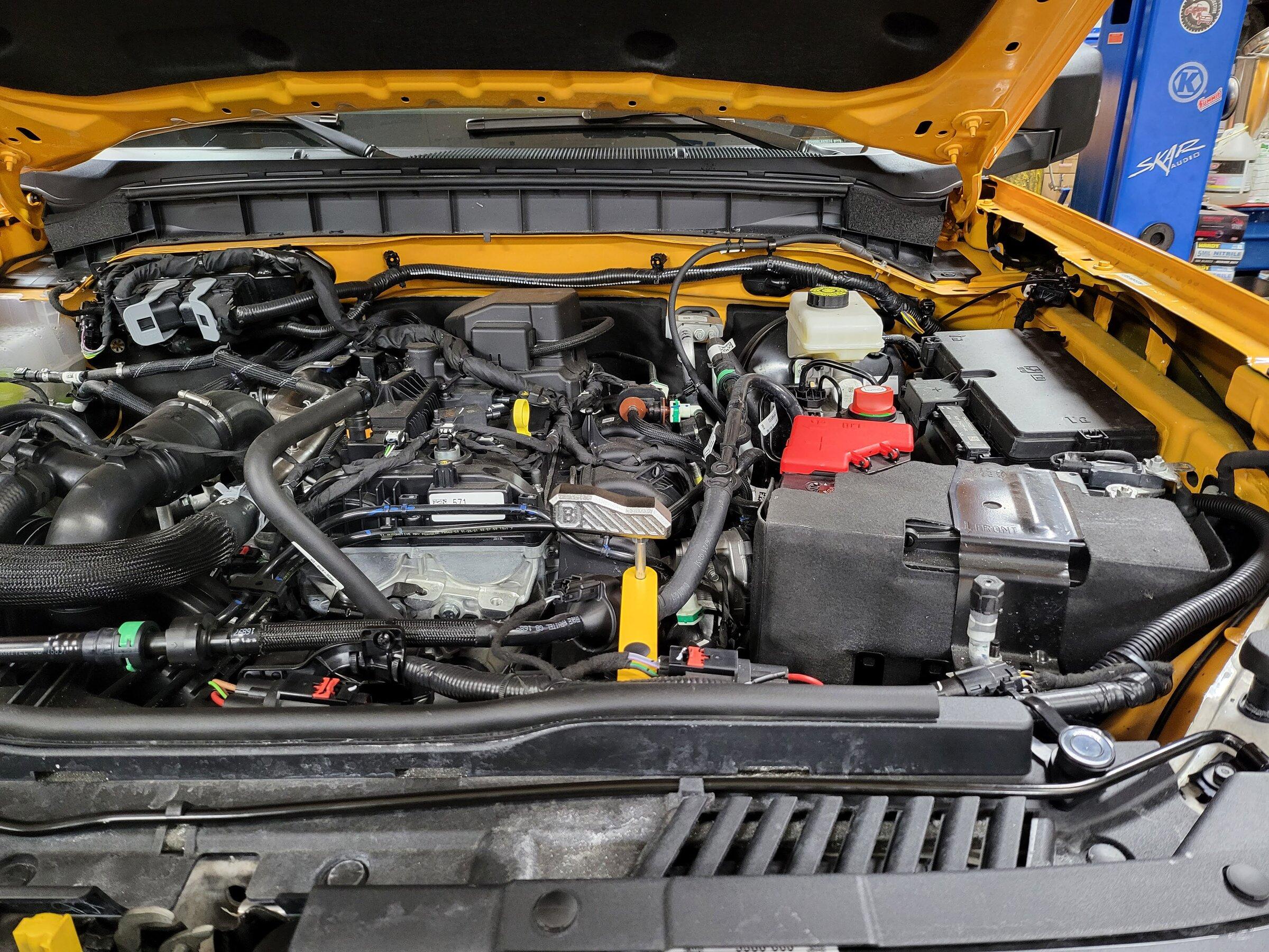

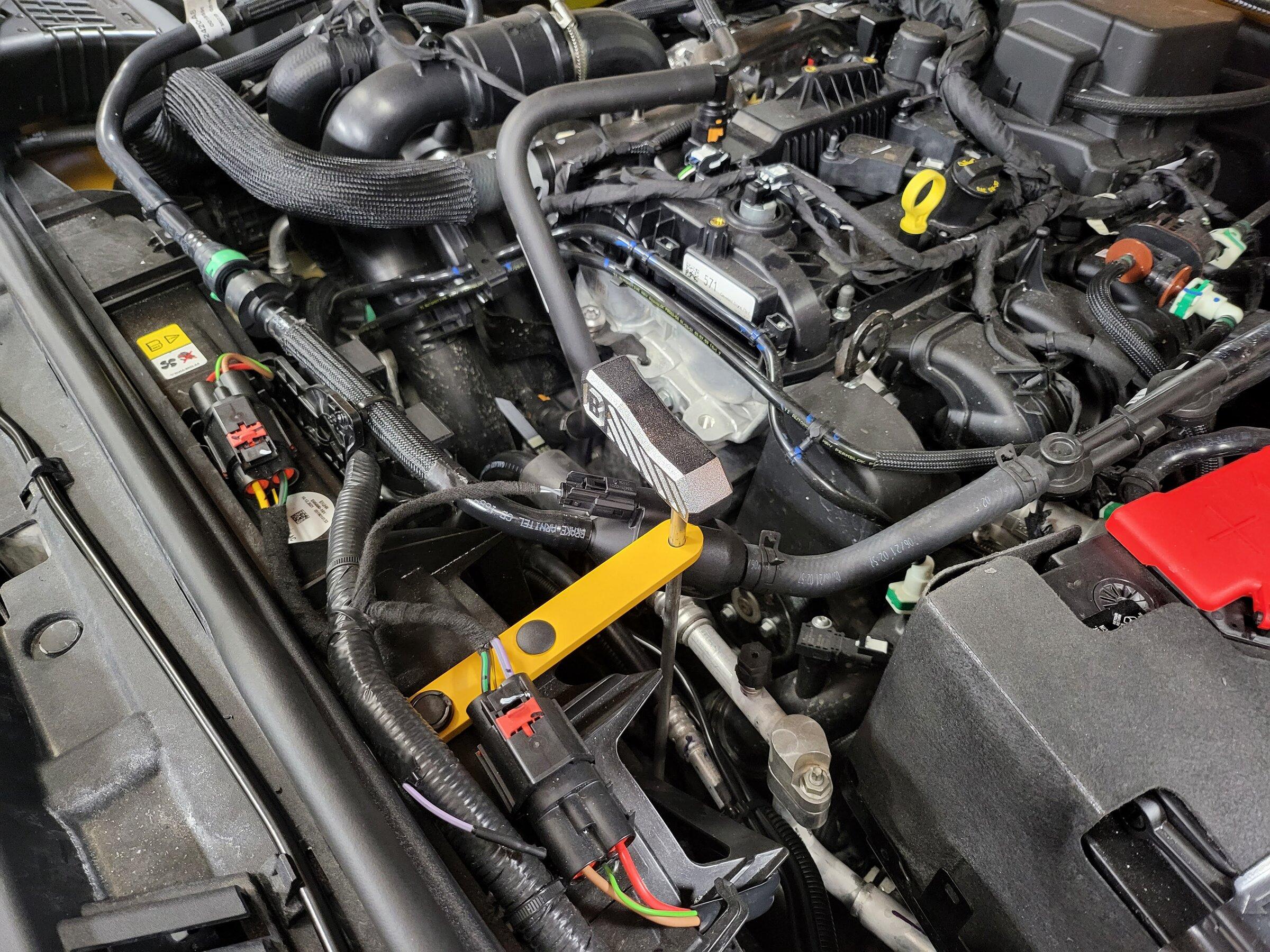

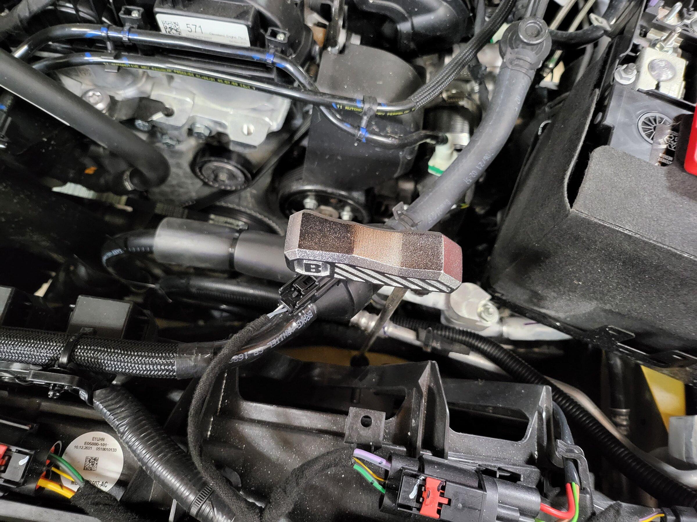

For the clutch lever I was able to cut the handle in half and drilled and tapped the now separate top and bottom halves for a 5/16" aluminum rod and a jam nut. I actually tapped it M8 for some flanged nuts I already had. The lever actually lined up perfectly with the radiator cross brace so I drilled a hole through and passed the rod through it I then made a stabilization bracket for the top. There was an existing hole in the top of the fan shroud that lined up nicely and I drilled another for an additional mount point and used plastic push retainers for an OEM look.

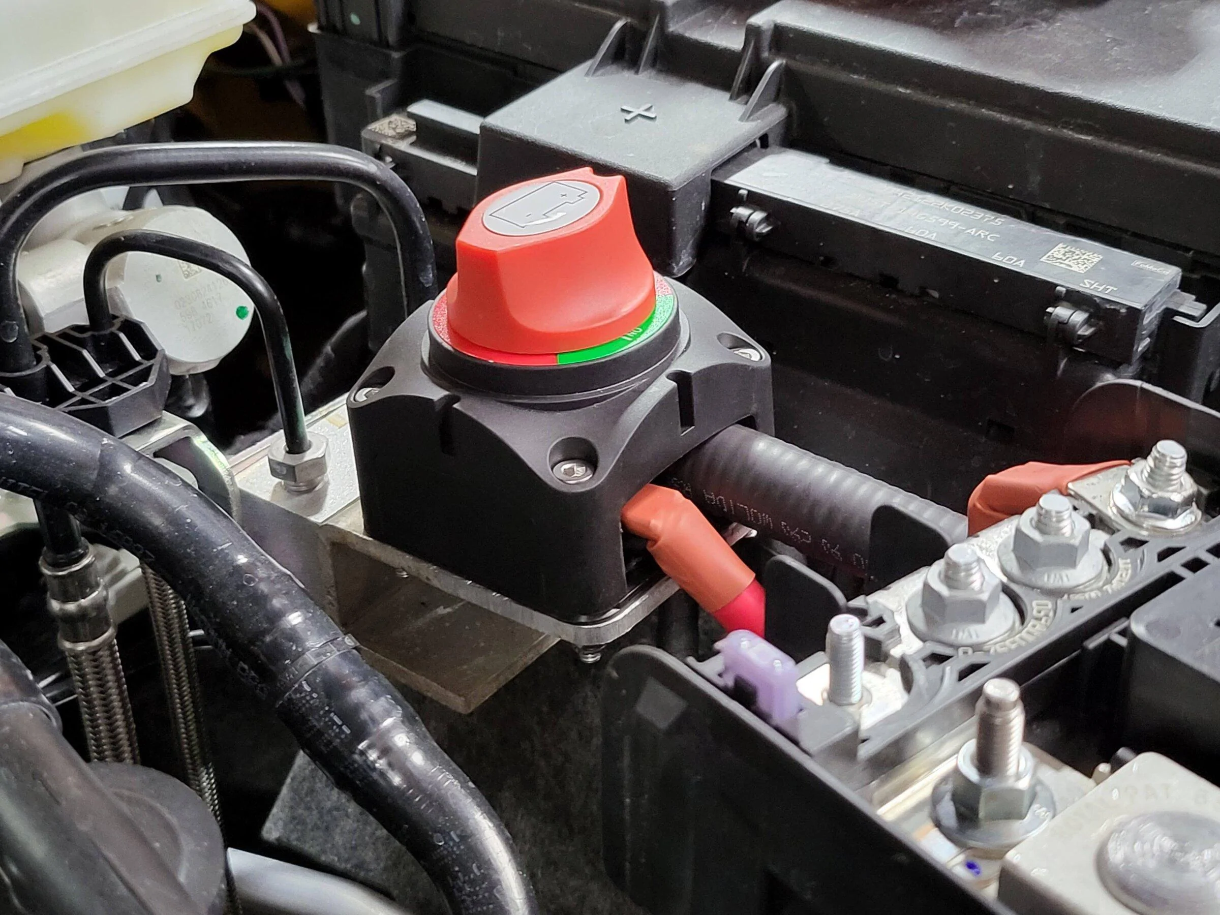

There was also a perfect spot for the winch main power disconnect. A quick aluminum bracket and an M8 bolt secured it to an existing brake line distribution block bracket.

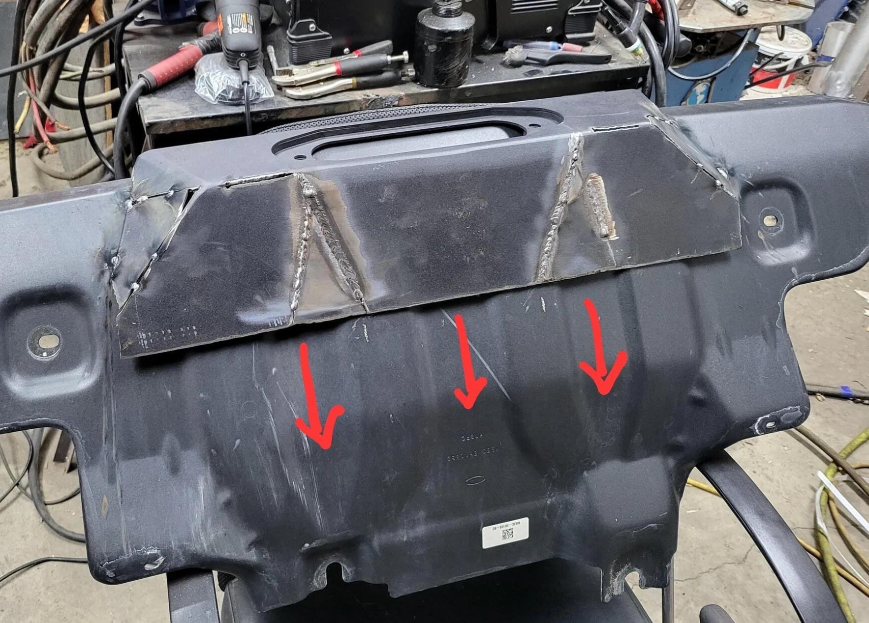

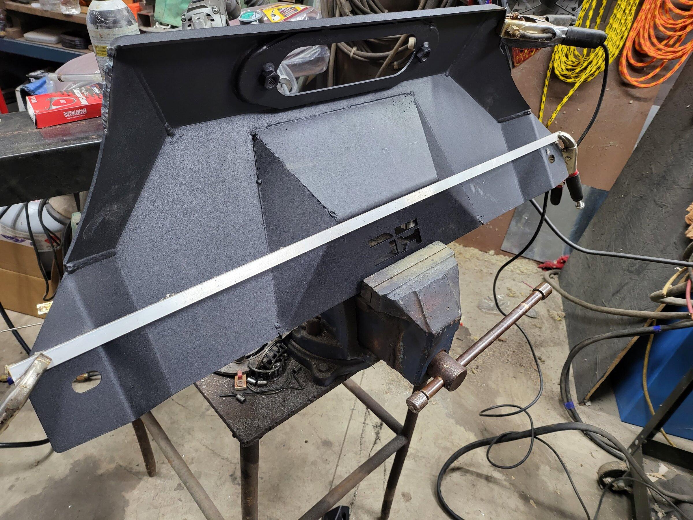

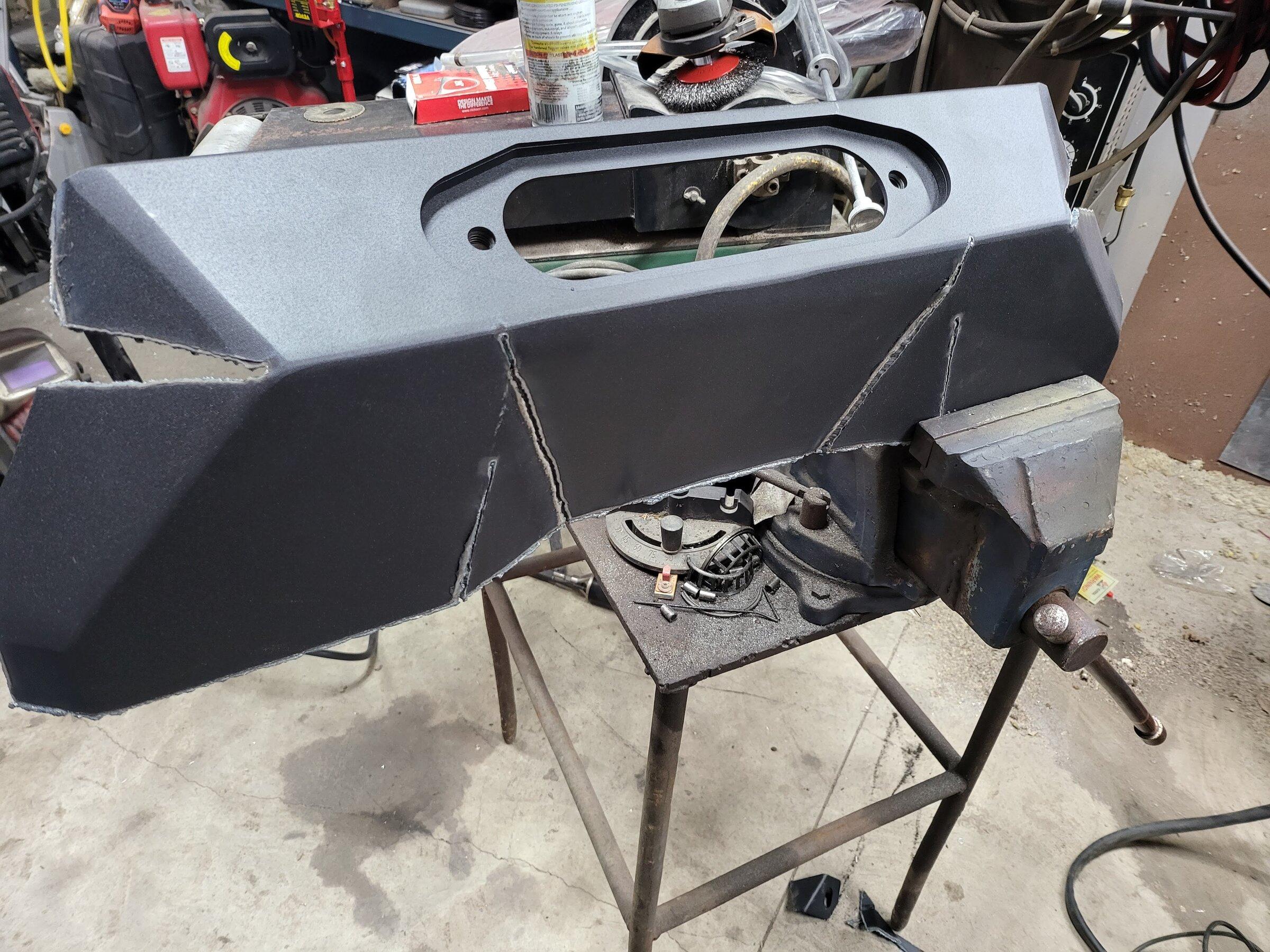

Lastly are some pictures of the modifications I made to the RC skid plate. I cut off the portion that had the "RC" cut into it and then flattened the different angles to make things more streamlined. I then show where I mocked everything up to get the front hawse fairlead at an angle I liked.

Little bit of grinding, primer, Rust-oleum Wrinkle Finish and a satin black top coat and it matched the factory finish almost exactly. I called it complete!

Read my mind there! I purposefully didn't weld the rear section of the RC skid for that same thought process as shown below. I'm sure it will still collect stuff but hoped it would maybe help.

Curious about one aspect - the extended handle you have for the clutch release. I had an idea of how I wanted to do this, but when I looked at it I realized that the centerline of the existing handle is under that crossmember, and so I would need some kind of "offset" solution for it. How did you overcome that?
