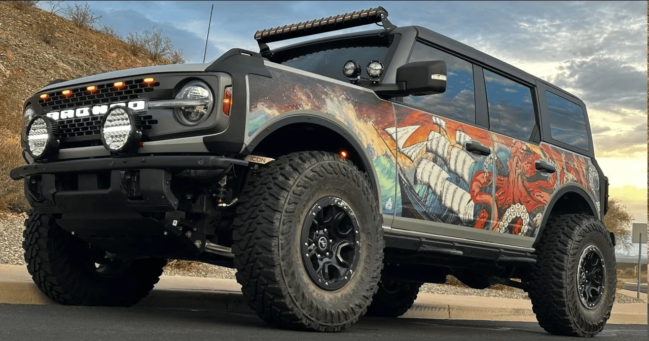

This is a Bronco on true 37s, 3" Icon Stage 6 lift, Fender delete, JKS max clearance kit, HOSS 3.0 steering upgrade, custom bump stops, trimmed rock sliders etc.. I still rub with 1.5" spacers on the wheels.

Thanks! My Bronco is named 'The Intrepid' after an unfortunate quick sand incident, so I went with a pirate themed armor set. I absolutely LOVE the way it turned out.
My passenger front quarter panel has a nice dent right above the wheel well arch for jumping it to test after the lift and finding out that the factory bump stops were still about 1" too short.
I'll try to find a photo.. Long story short, I 3d printed some custom bump stop extensions out of a durable rubber and its been fine since.

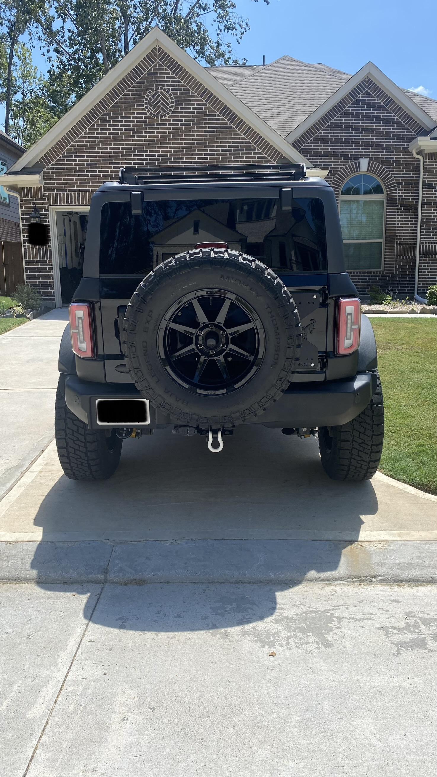

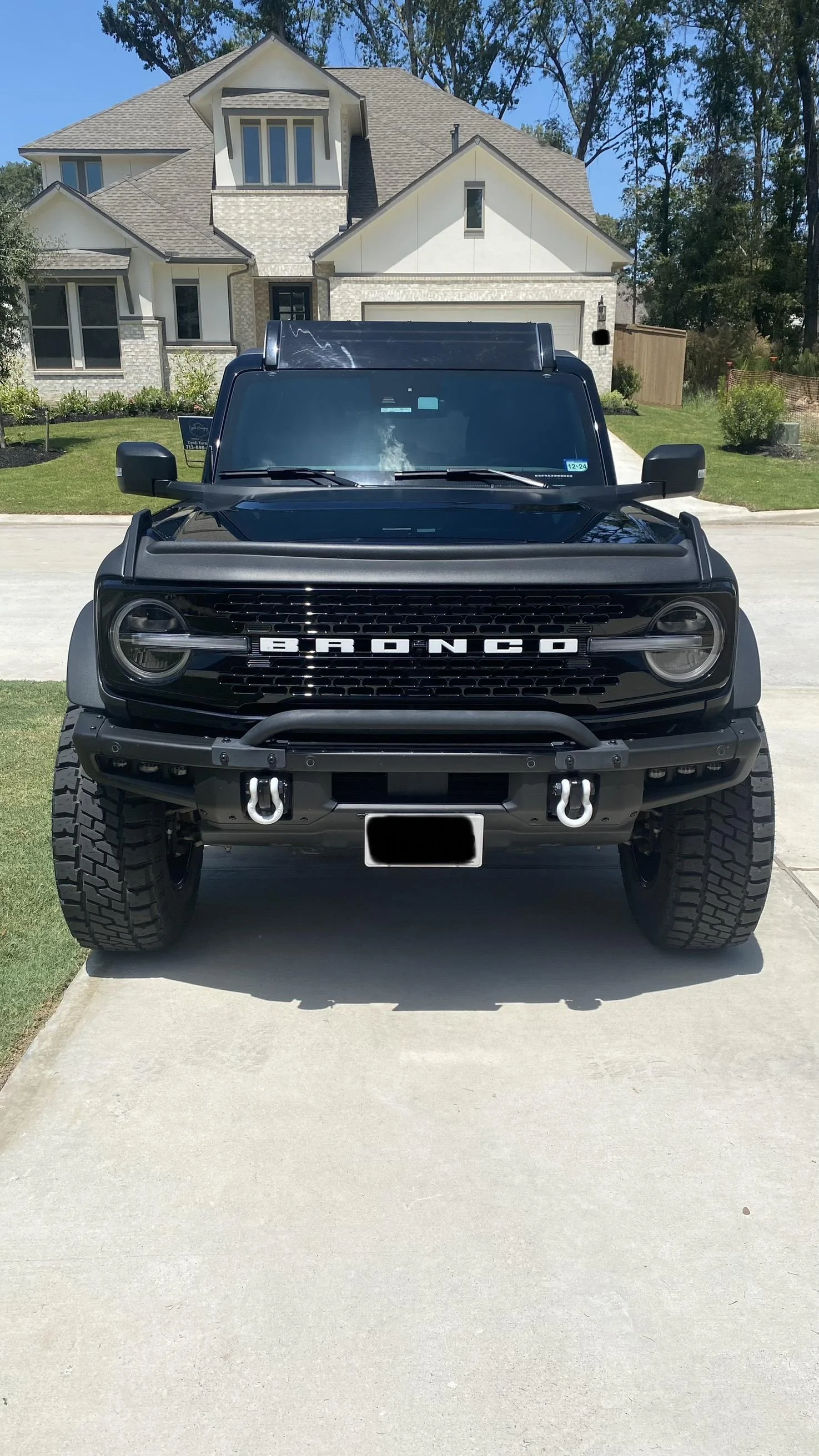

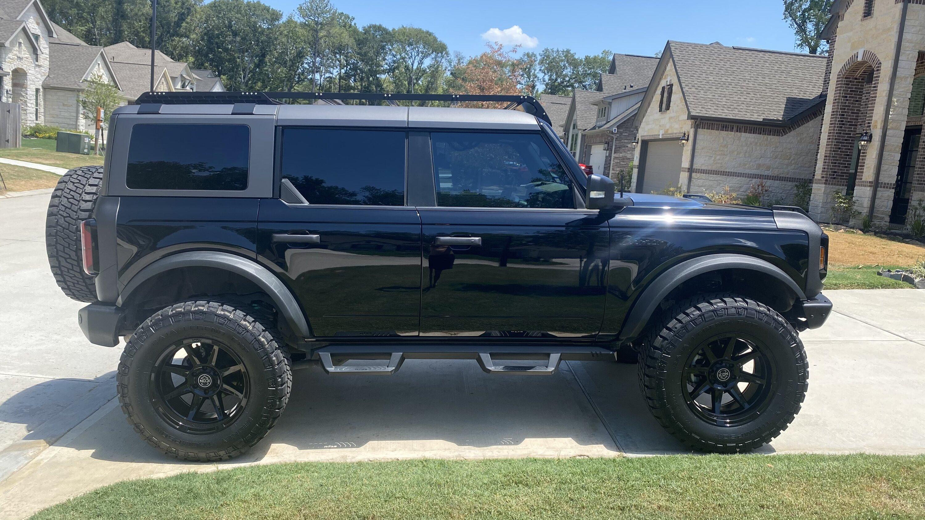

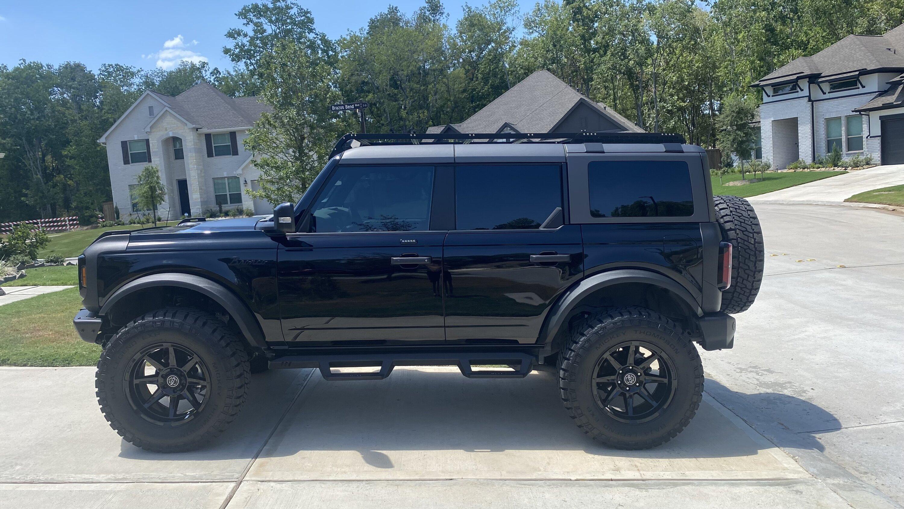

’22 Wildtrak, Eibach coilovers, +3” vs stock, MT Legend EXP 37x12.50R20, ICON bandit wheels (-24 offset). Removed the plastic stupidity on the back of the front wheel well and added Rokblokz mud flaps to protect the sides (not shown). No rubbing, on and off road.
Ford Bronco 37's without lift on 2023 Wildtrack Sasquatch? IMG_4738
Ford Bronco 37's without lift on 2023 Wildtrack Sasquatch? IMG_4739
Ford Bronco 37's without lift on 2023 Wildtrack Sasquatch? IMG_4742
Ford Bronco 37's without lift on 2023 Wildtrack Sasquatch? IMG_4741
