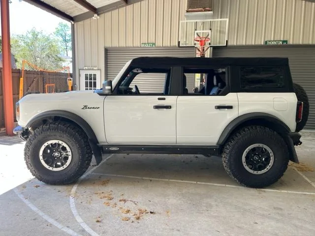

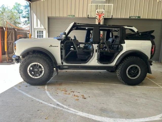

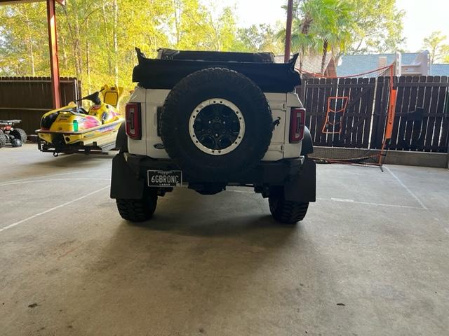

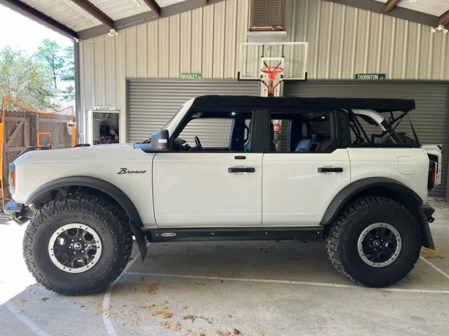

So with the 1 3/8 front and 1 in rear no spacers had 0 rub on KM3s 37x12.5r17s

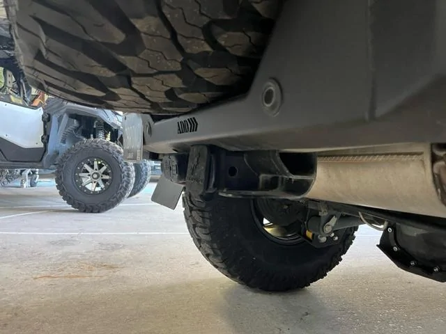

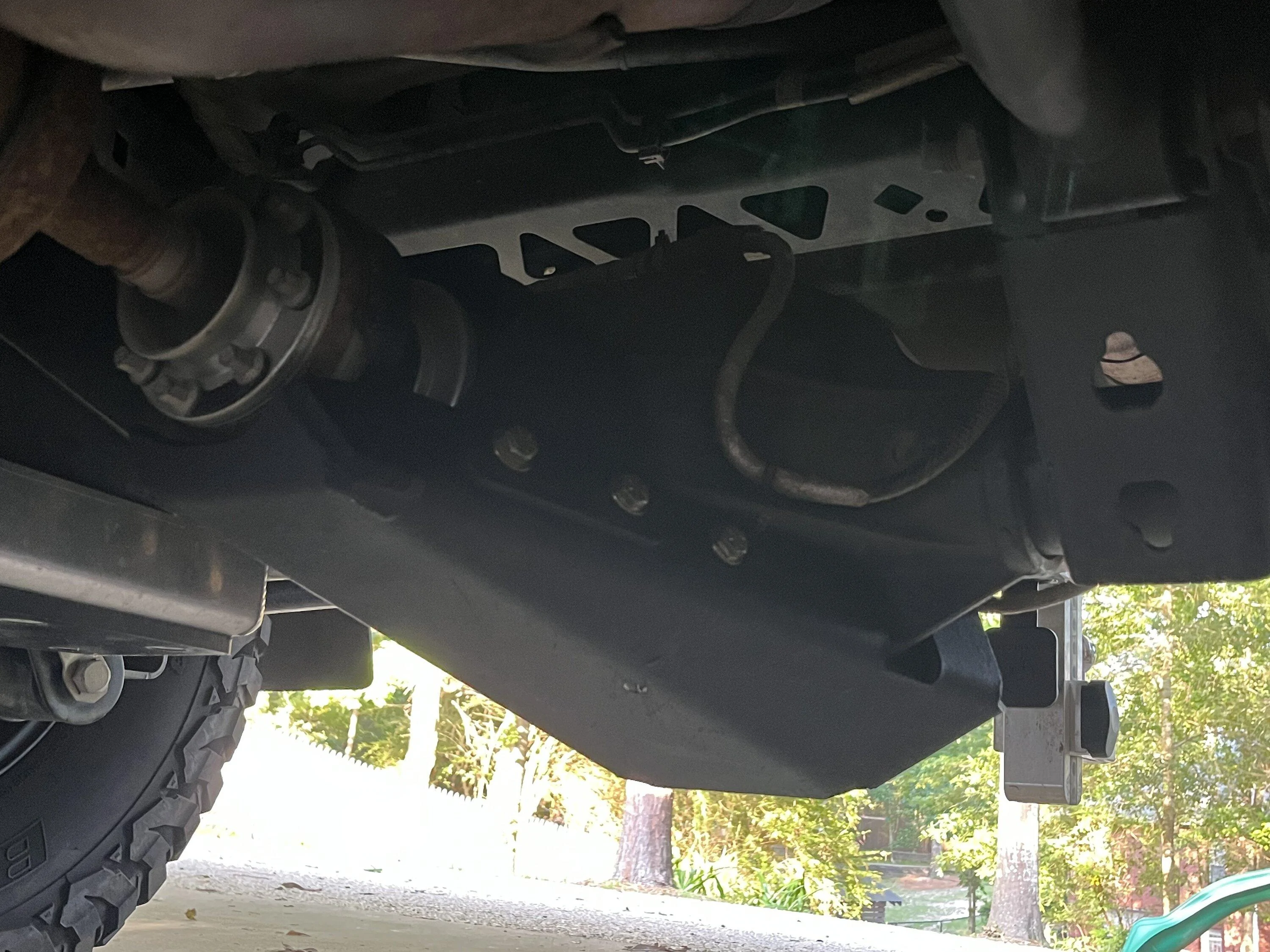

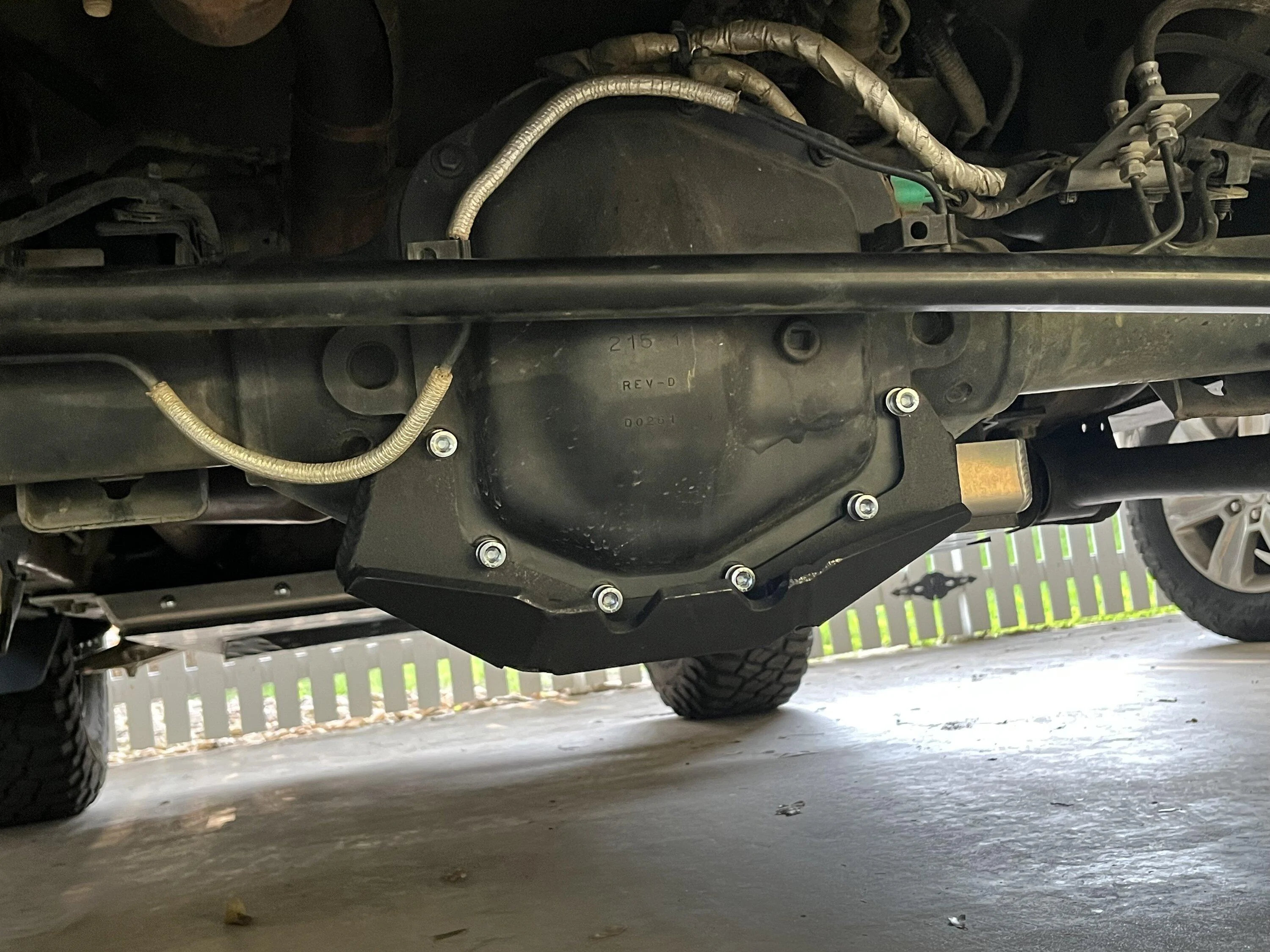

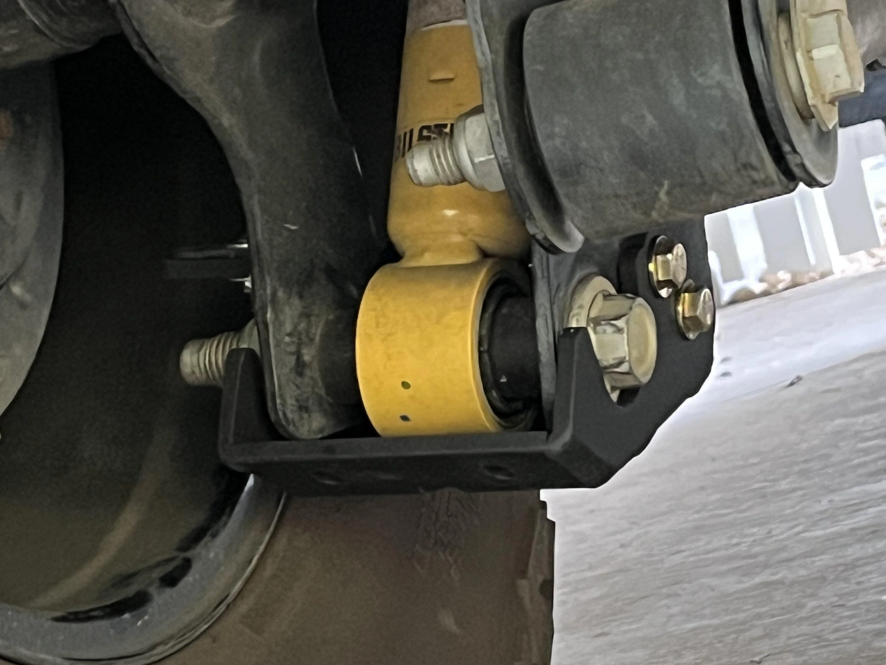

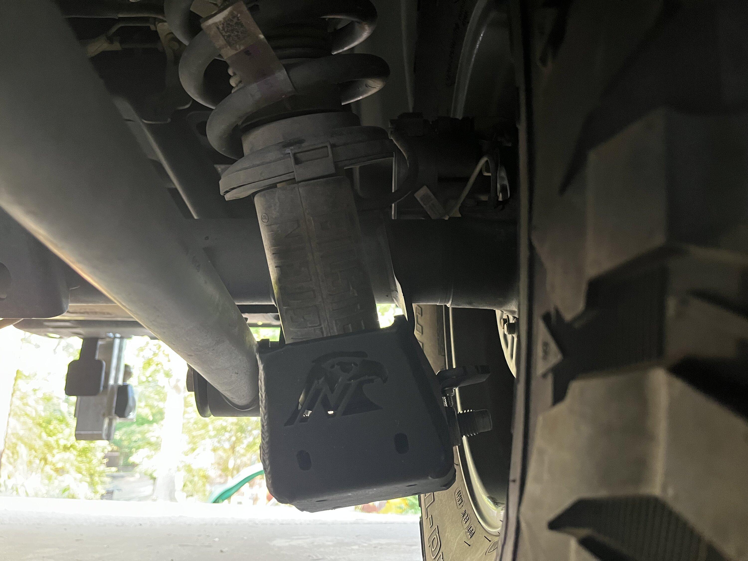

Installed Next Venture Motorsports rear diff skid and rear shock skid plates. I like both and I didn’t even use the lift. Pulling the rear tires would have saved me maybe 10min but have another car on the lift so just not worth it. They have nice videos on their website on how to install also.

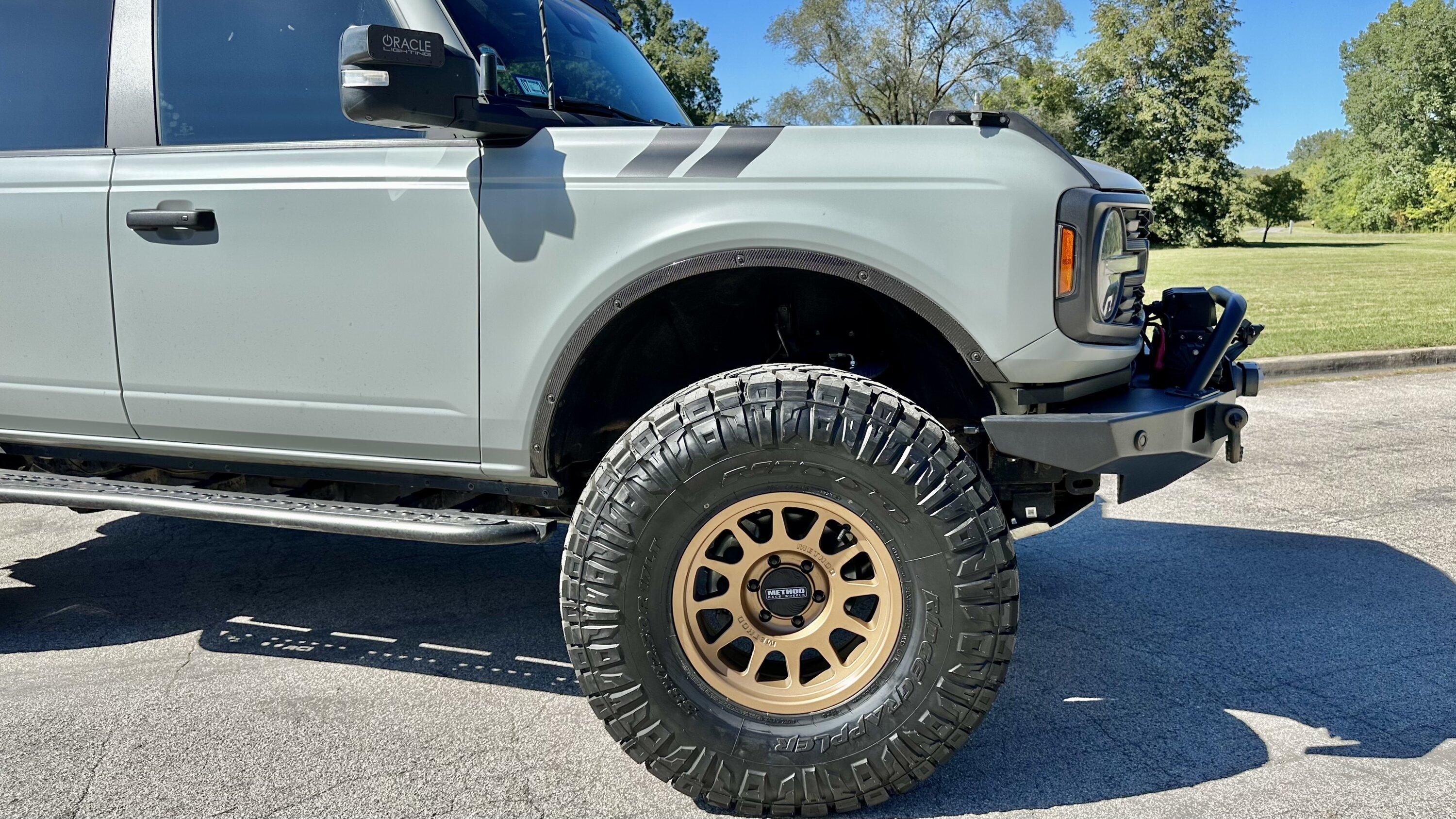

Simply put 40s will 100% require you to lift outside of the finder well...
I'm curious why this is. First of all amazing work and thank you for this in-depth walkthrough of not only fitting 38s but also the 37s build. With the 38s you have on now, what would be the next hard part to be hit by the tire if you continue to go up in size? Would a slight body lift as you go up in tire size solve the problem or would you hit something like the body mount, requiring more suspension lift to clear?
40s are huge they just won't fit they would hit everywhere. You have to keep in mind the idea is to keep the tire tucked in. Keeping the tire tucked in is say you are using the hole in the finder. Amy bigger you will start hitting the body when you turn look at my pics. Now you can lift out of the fender and put 40s all day but working inside the fender is the hard part. My original plan was 39s that measure 38.5 they may fit and I'm sure they do mall crawling but with swayer disconnected man I just think it's not worth the 1/4in lift.

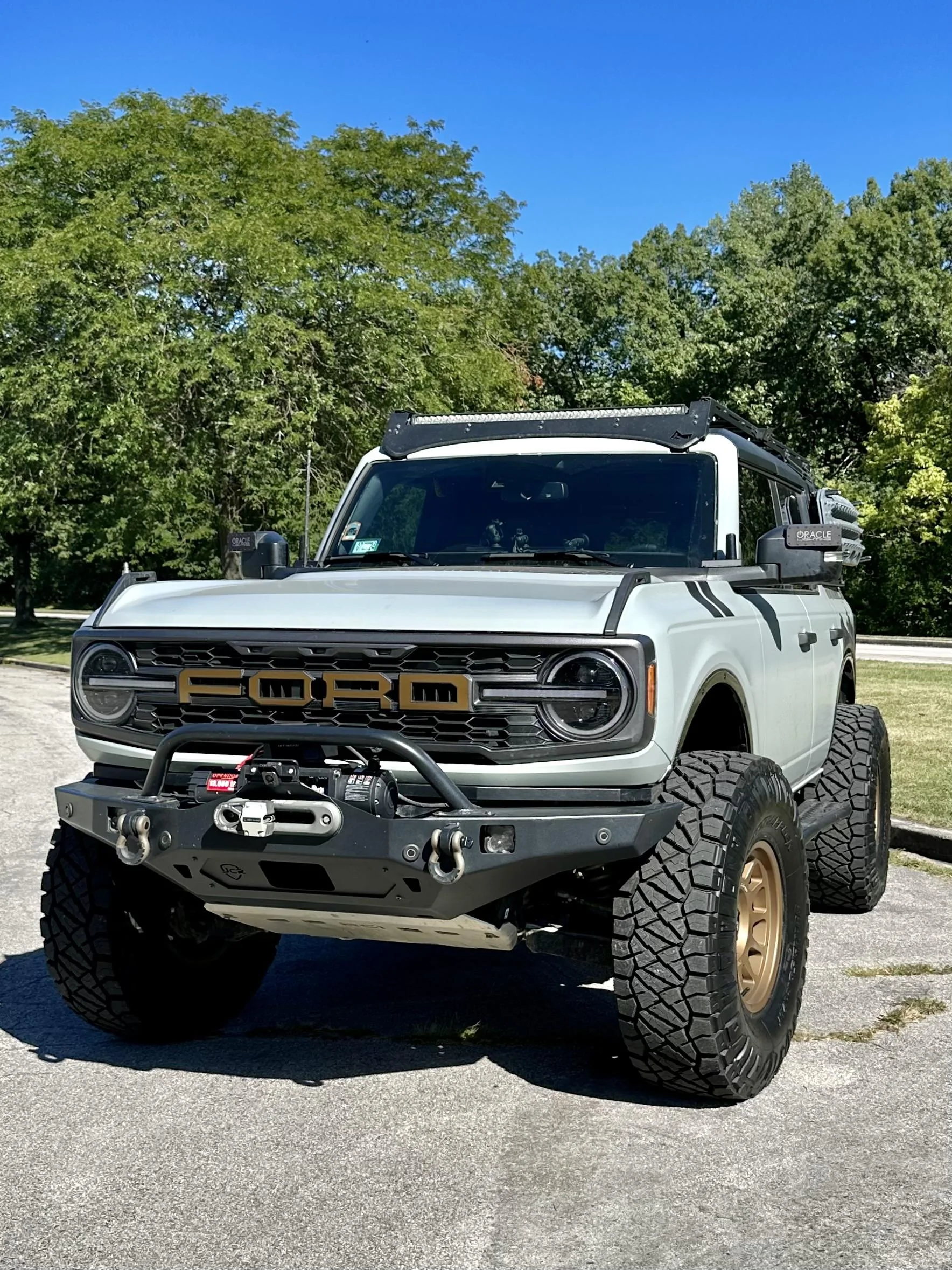

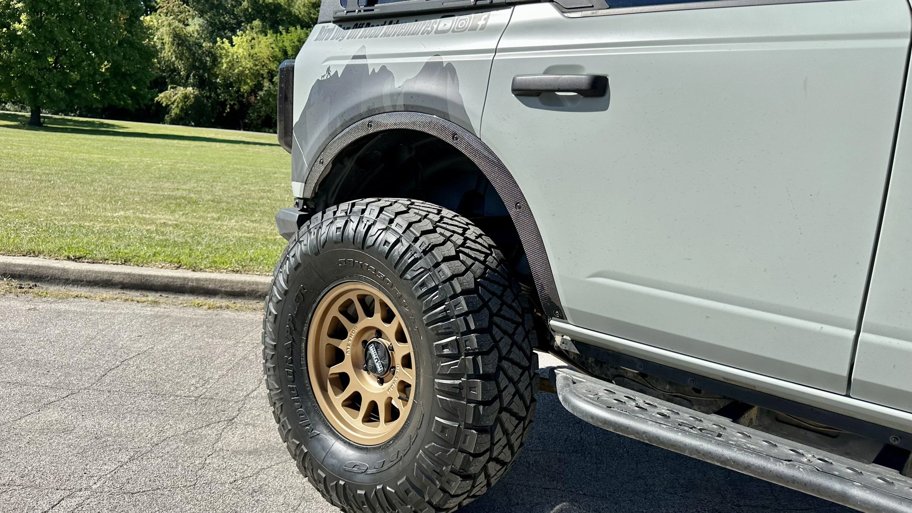

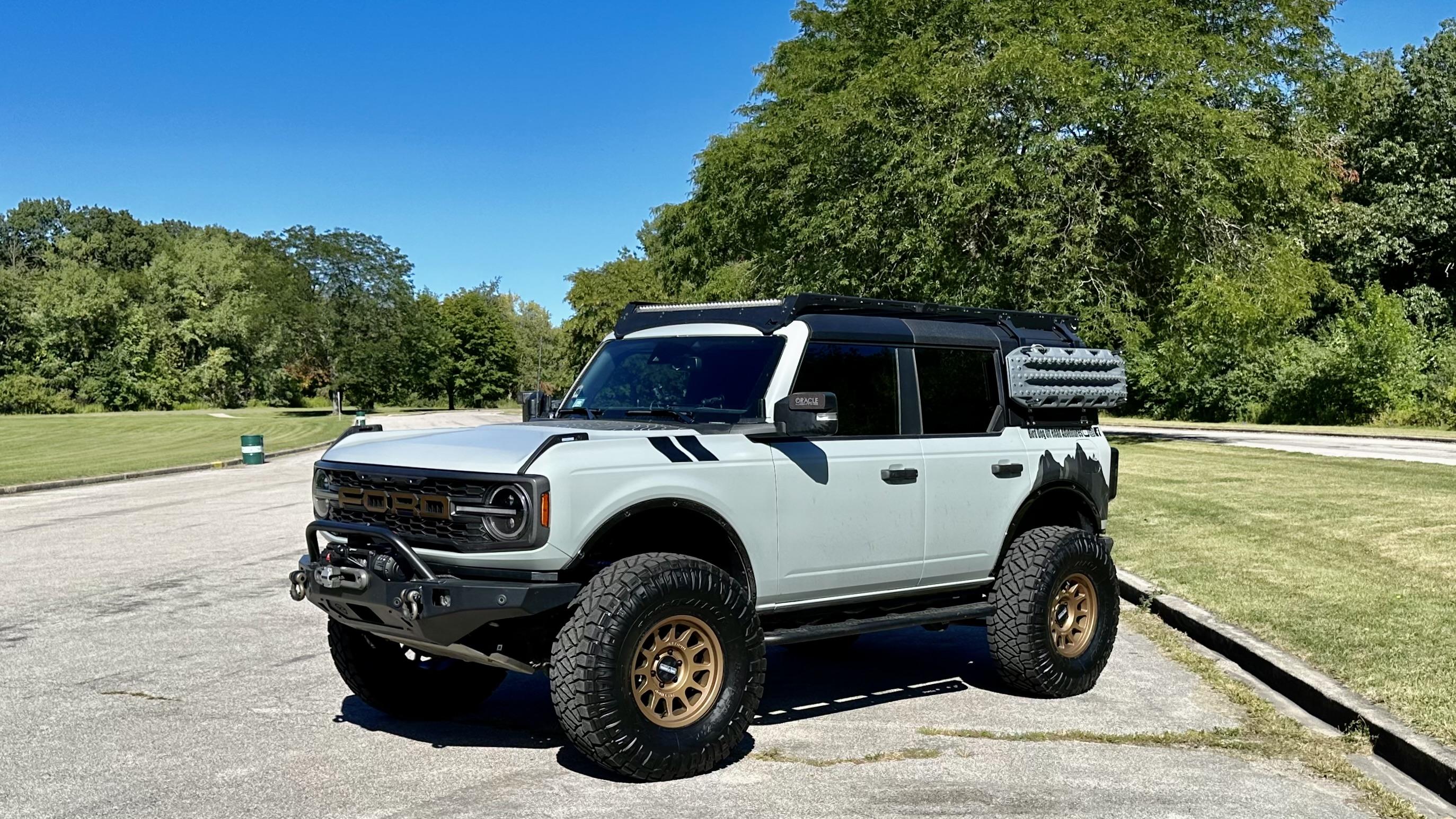

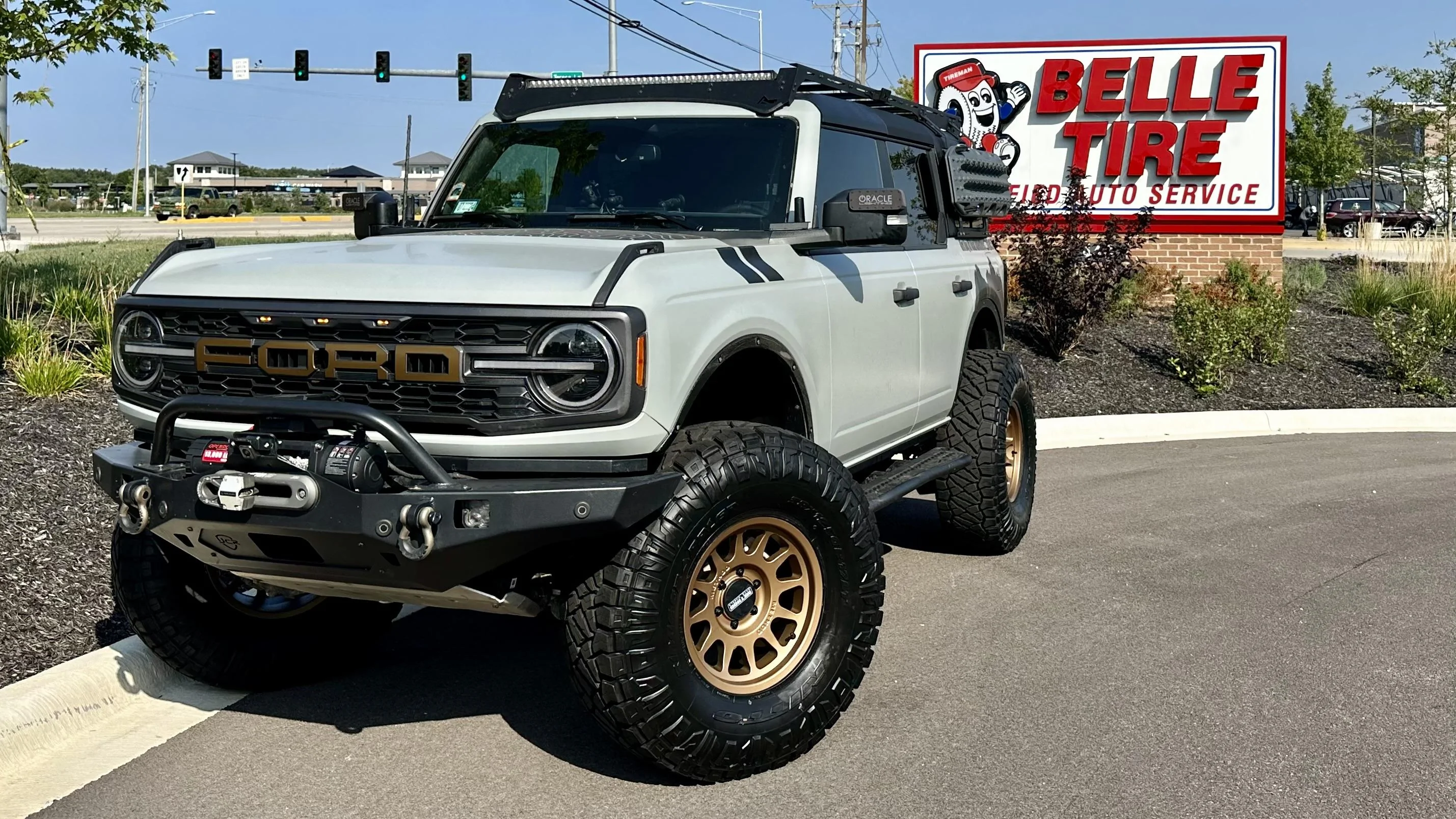

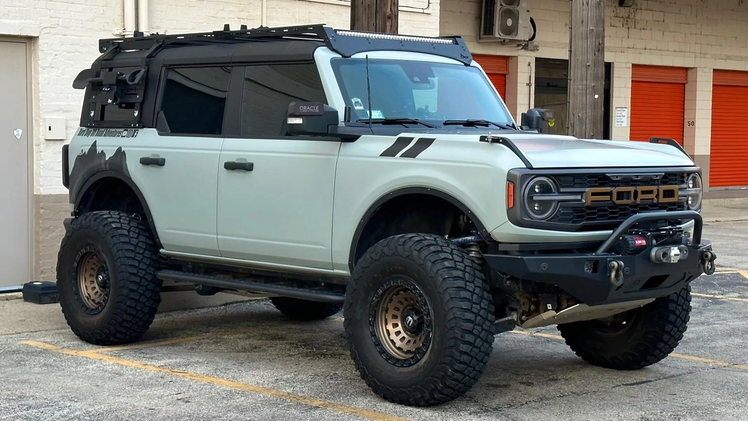

Great write up! I've been running those 37" KM3s for a while now and the noise is getting pretty loud. I just ordered the Nitto Ridge Grapplers in 38x12.5r17 for my 2021 Badlands. I have 3" over Sasquatch lift from the RadFlo coilovers and I have a 1.5" body lift as well. Also running the JKS Max Tire clearance kit and wheels are the Fuel Zephyr in 17X9 with -12 offset. So I'm hoping for a rub free experience, but you never know until they get on. Also have the BroncBuster Steering rack housing and bushing with Icon tie rods.
With my total lift, my KM3 37s look a little small. Like I skipped leg day, lol.

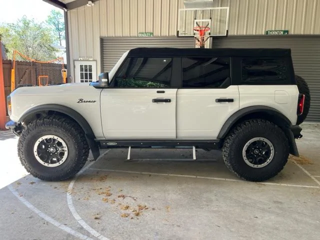

Just would like to add that Patagonia now comes in a D rated tire google it this will last longer as a street tire. When my daily 37s go out this will be what I make my daily 38s at. Right now the 38s are just my Offroad tire.
Milestar Patagonia M/T-02 38X13.50R17 D/8PLY
I will be adding these in a week as my new daily so I'll let you know how they ride and any issues with my setup. I plan on not riding with the spacers we will see how it goes. Any questions or pics needed just let me know.

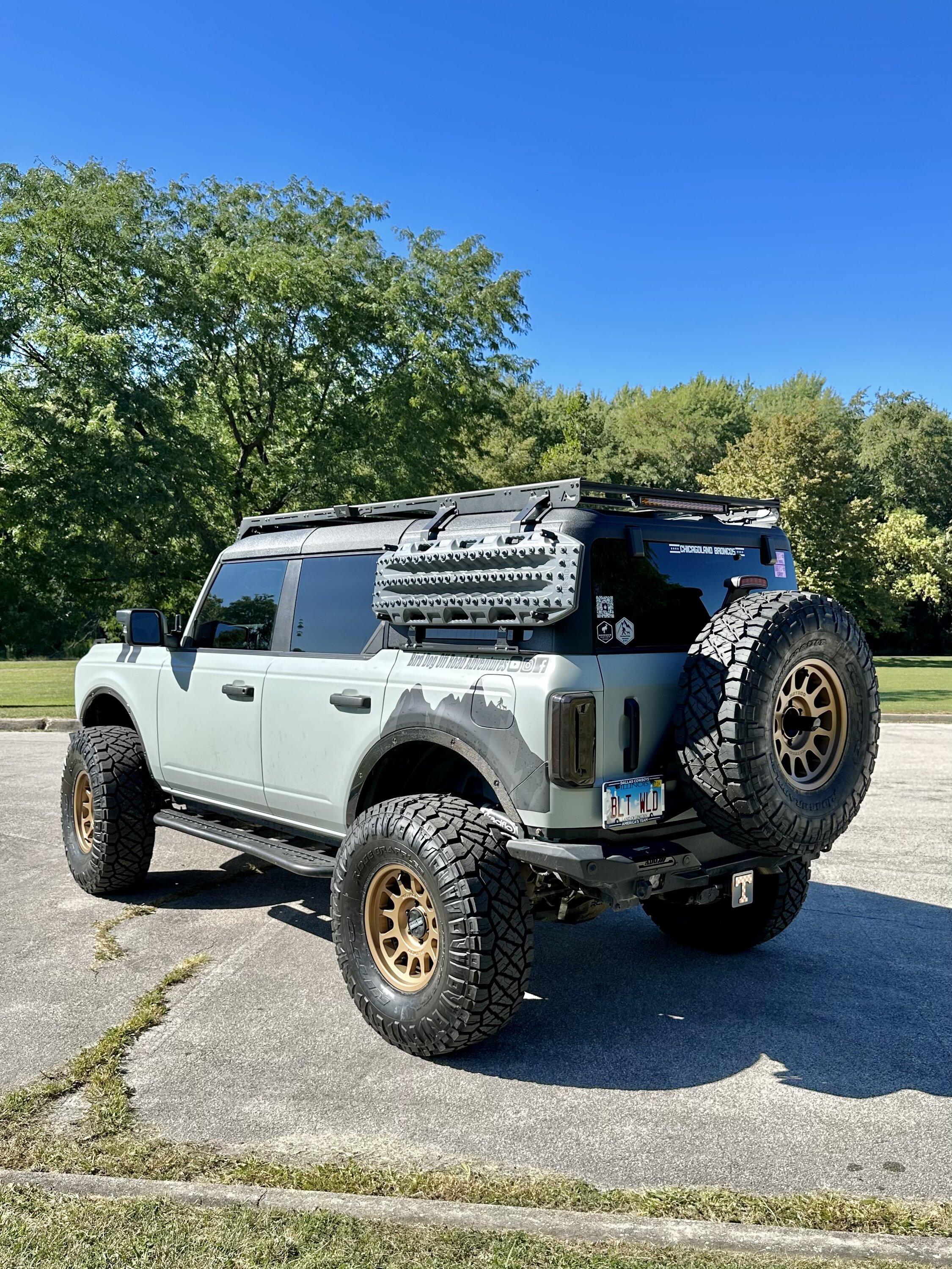

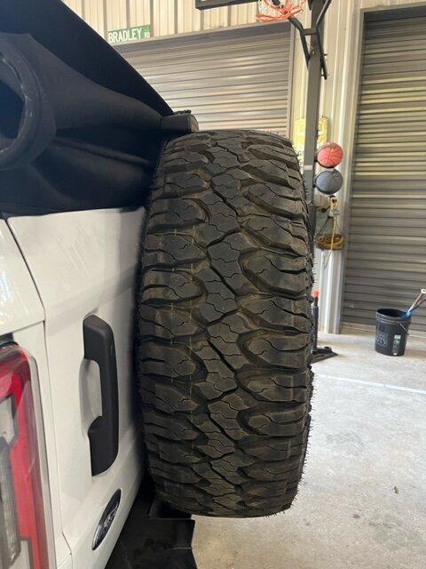

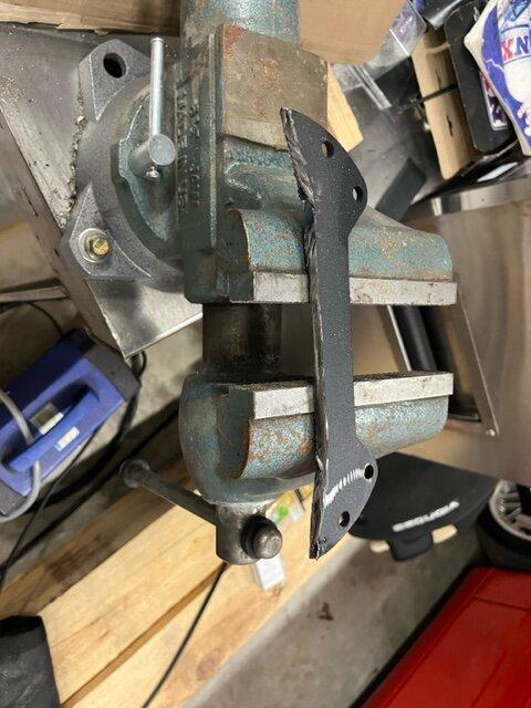

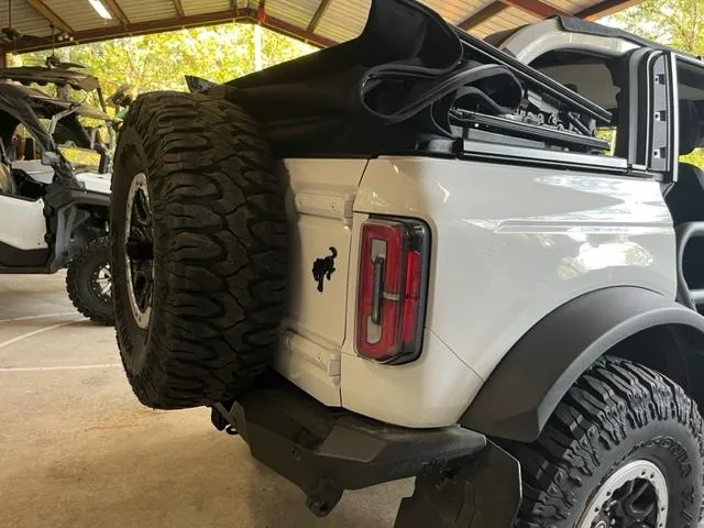

OK, so 38s I knew they fit BUT the question was the spare. ADD bumper came with a 3rd brake light bracket. At first I needed a 1in spacer due to that 3rd light bracket hitting the tire. I cut part of it off and then didn't need a spacer its like a perfect fit. See pics

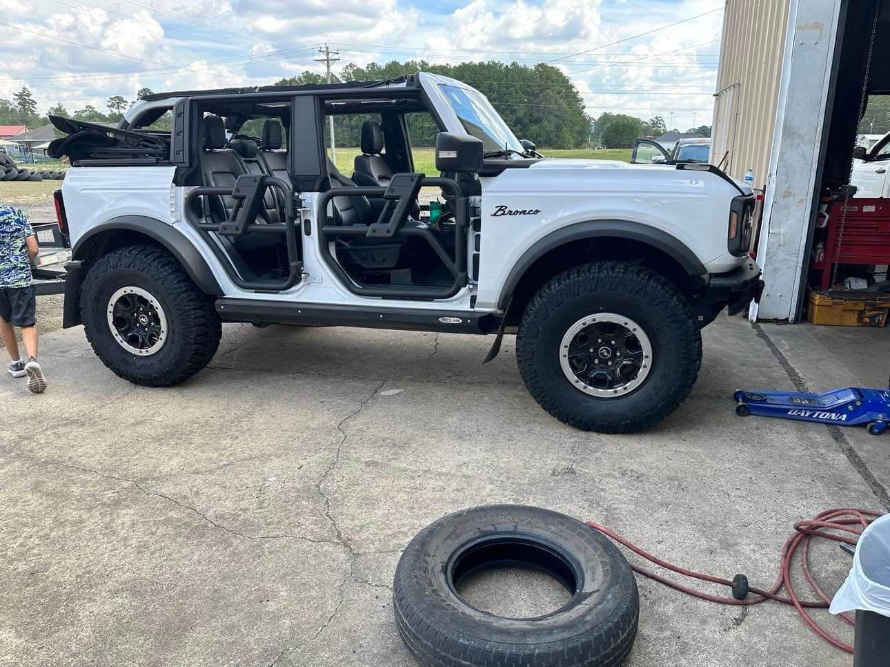

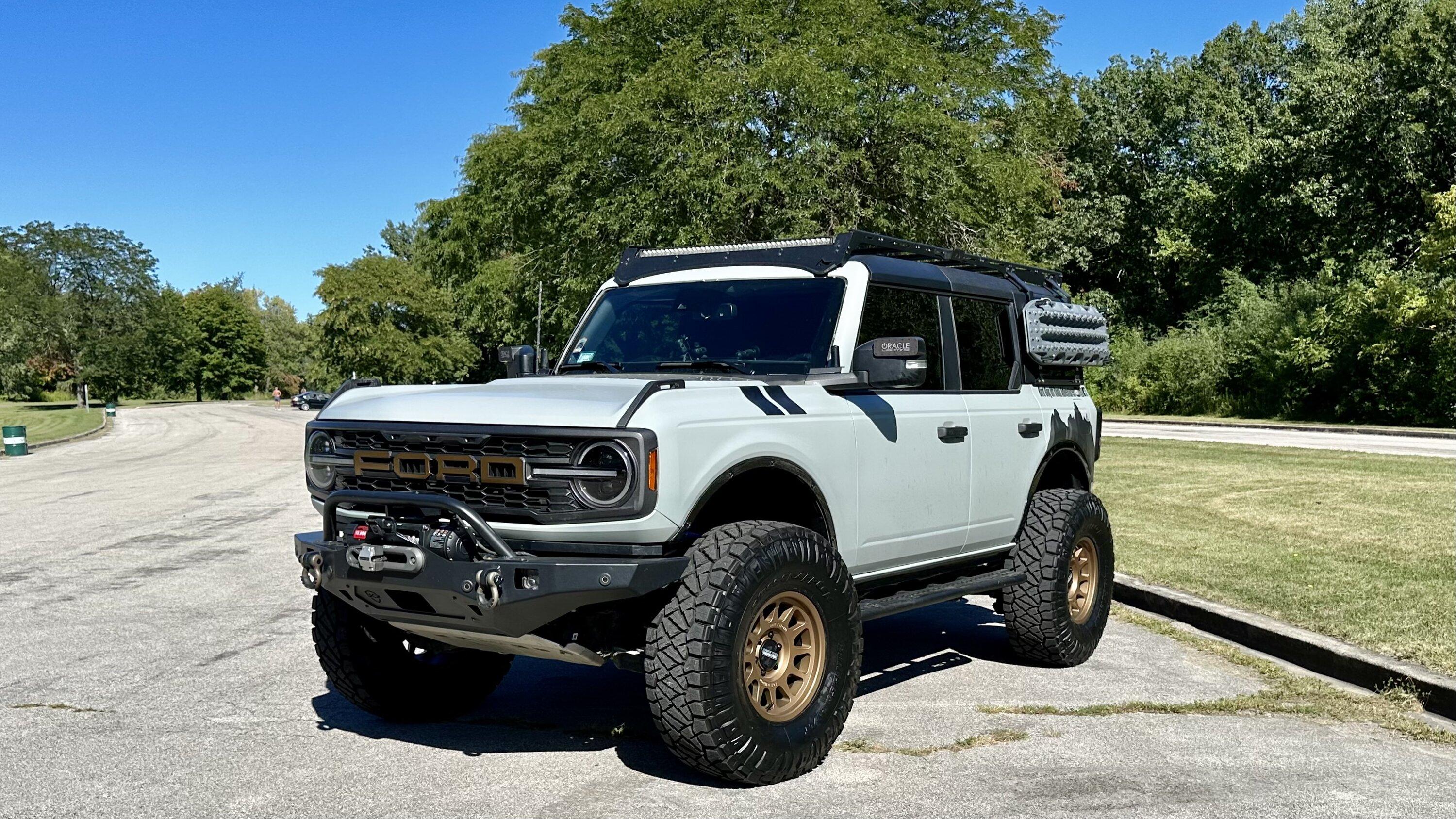

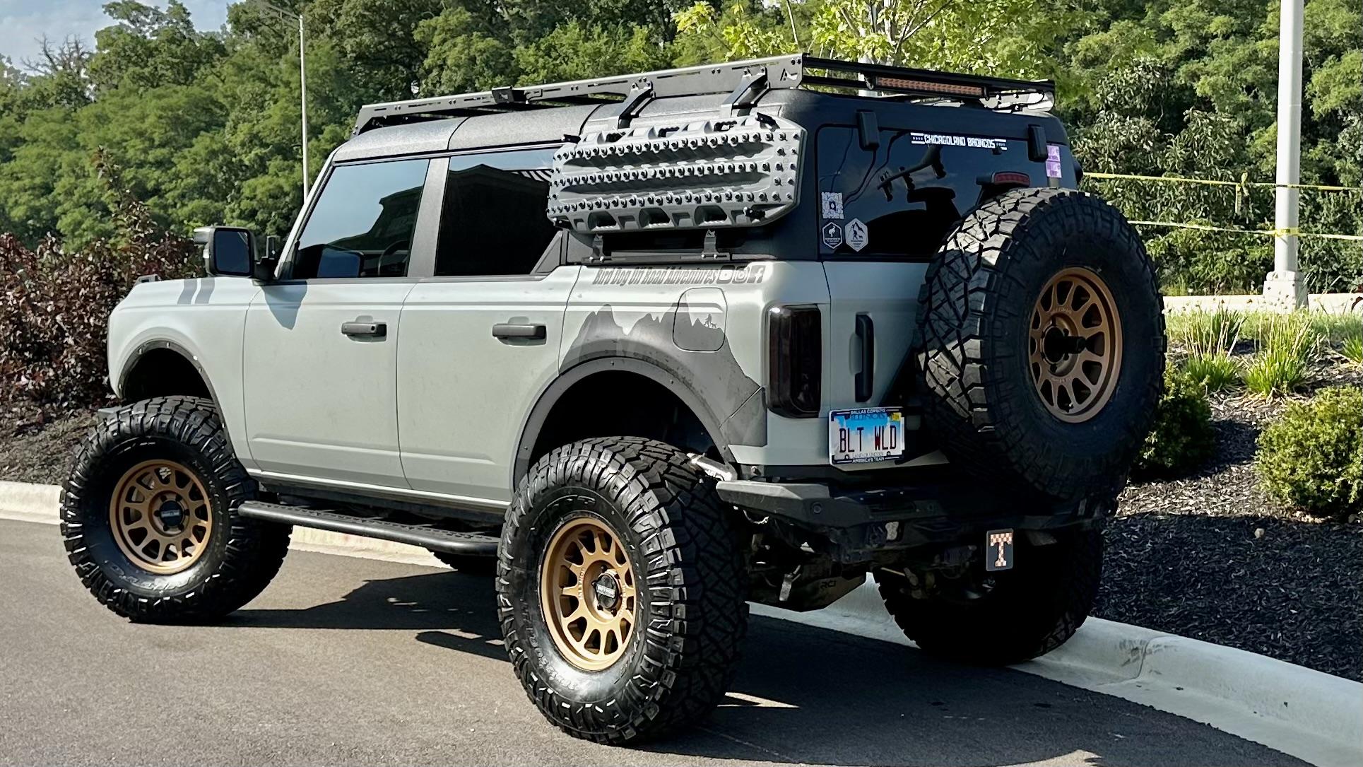

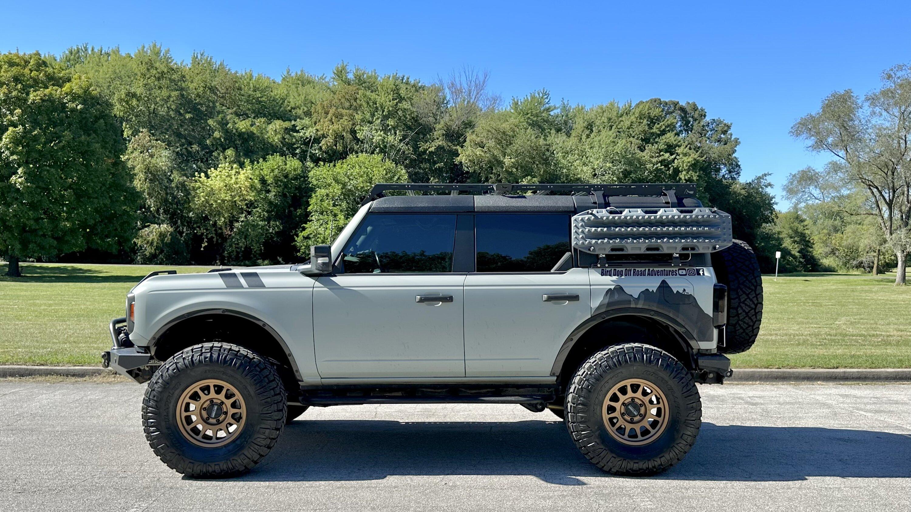

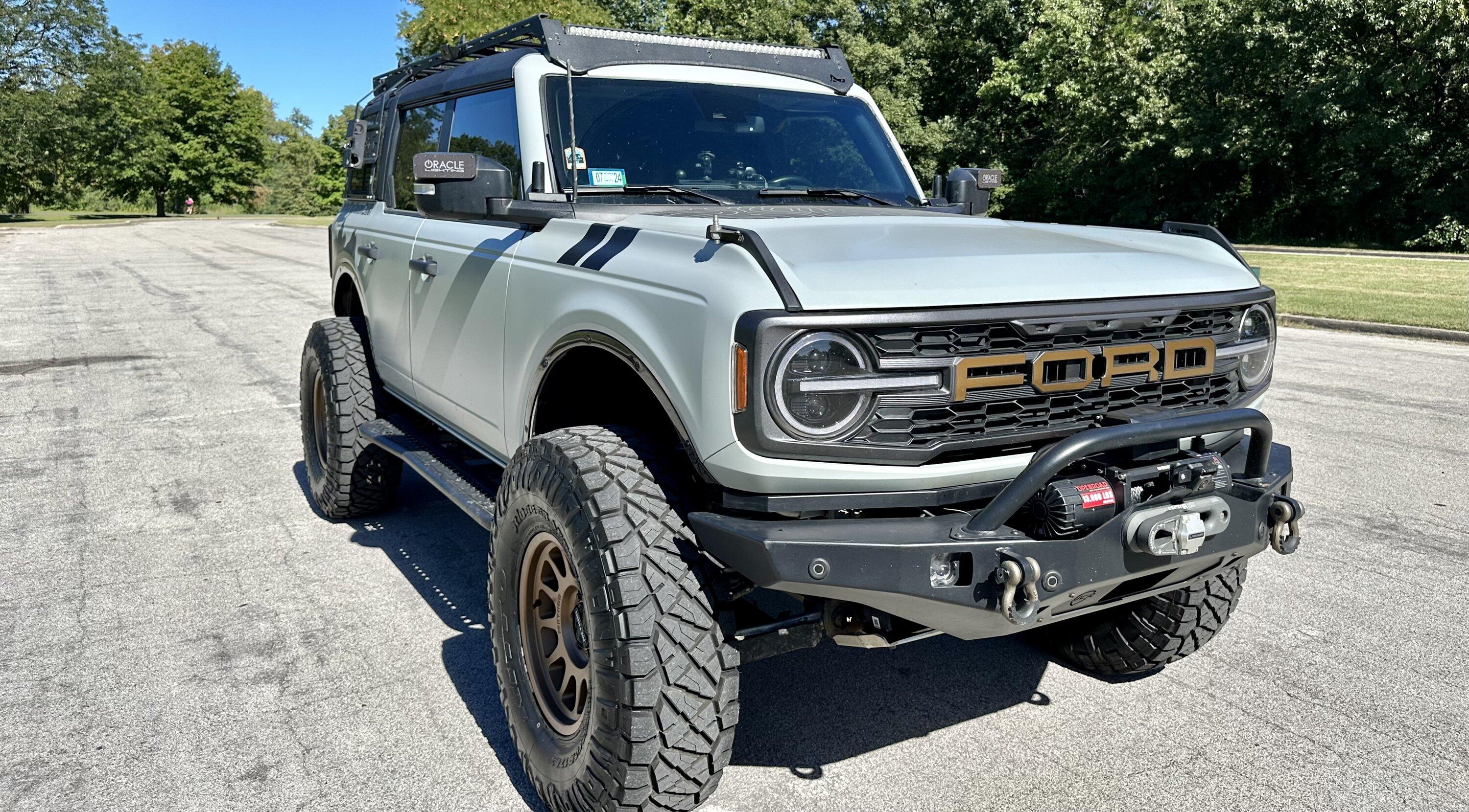

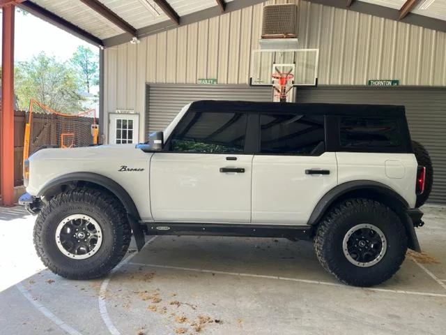

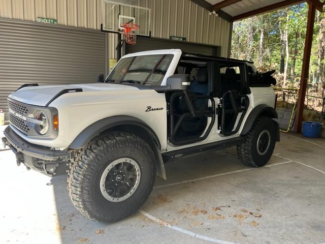

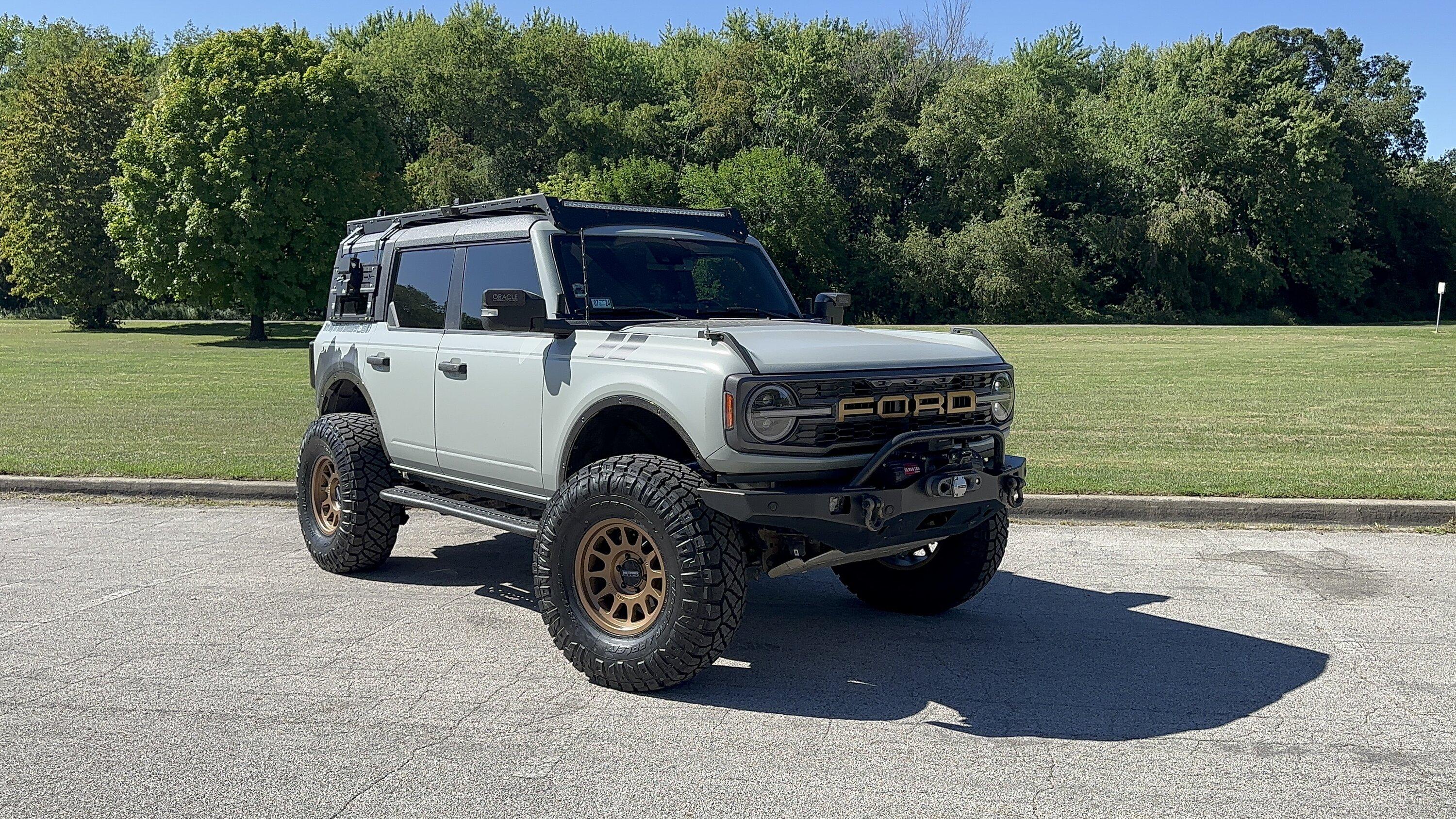

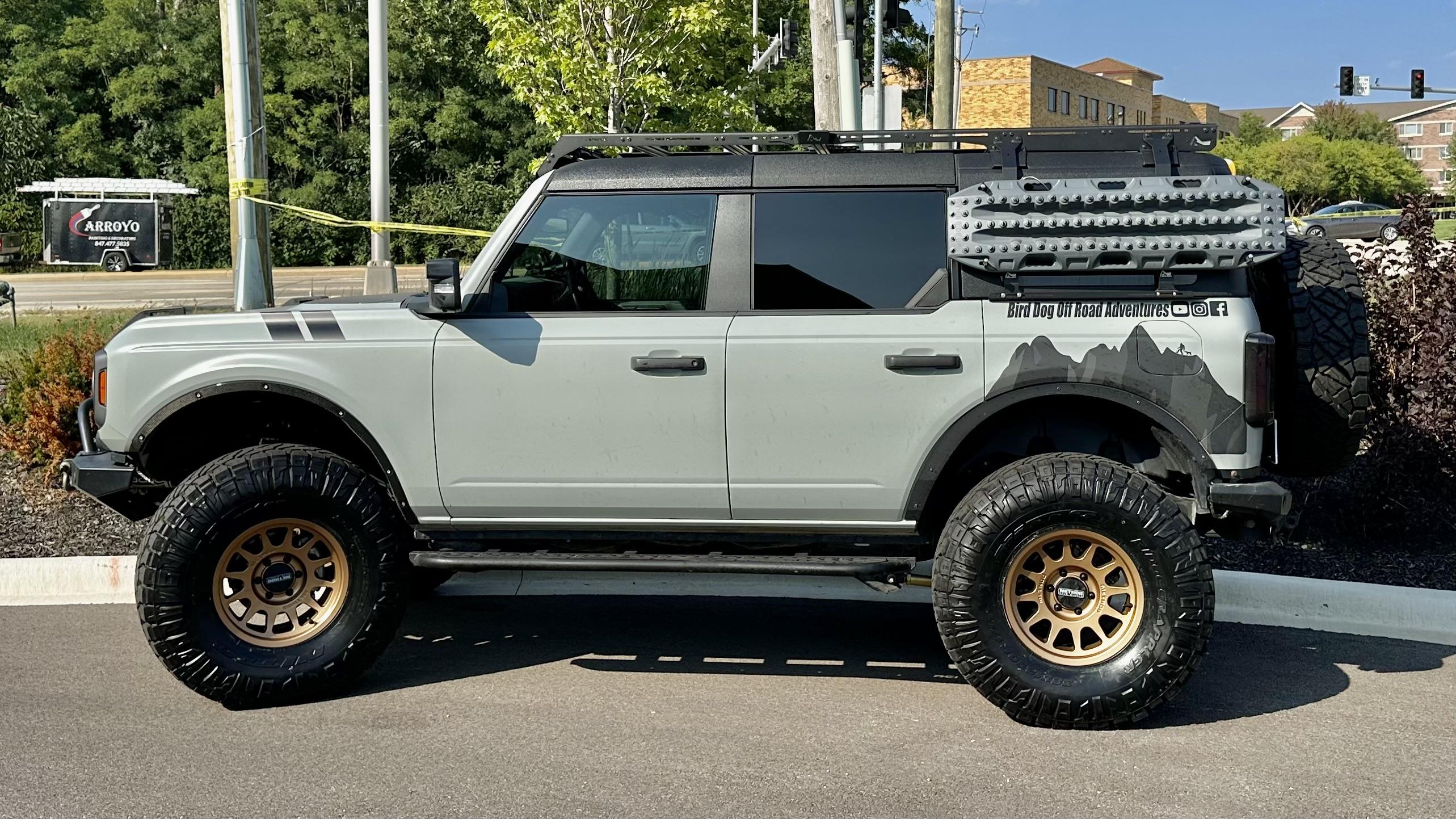

Took the tube doors off and put the doors back on for the winter. Took a few pics to show it in different looks. (This is the 38s I ride year round now)
Ford Bronco 38x13.5r17 Patagonia M/T Sasquatch Badlands 2in Lift/Build Thread Round 2 IMG_3556
Ford Bronco 38x13.5r17 Patagonia M/T Sasquatch Badlands 2in Lift/Build Thread Round 2 IMG_3557
Ford Bronco 38x13.5r17 Patagonia M/T Sasquatch Badlands 2in Lift/Build Thread Round 2 IMG_3560-1
Ford Bronco 38x13.5r17 Patagonia M/T Sasquatch Badlands 2in Lift/Build Thread Round 2 IMG_3562-1
Ford Bronco 38x13.5r17 Patagonia M/T Sasquatch Badlands 2in Lift/Build Thread Round 2 IMG_3563
Ford Bronco 38x13.5r17 Patagonia M/T Sasquatch Badlands 2in Lift/Build Thread Round 2 IMG_3564
