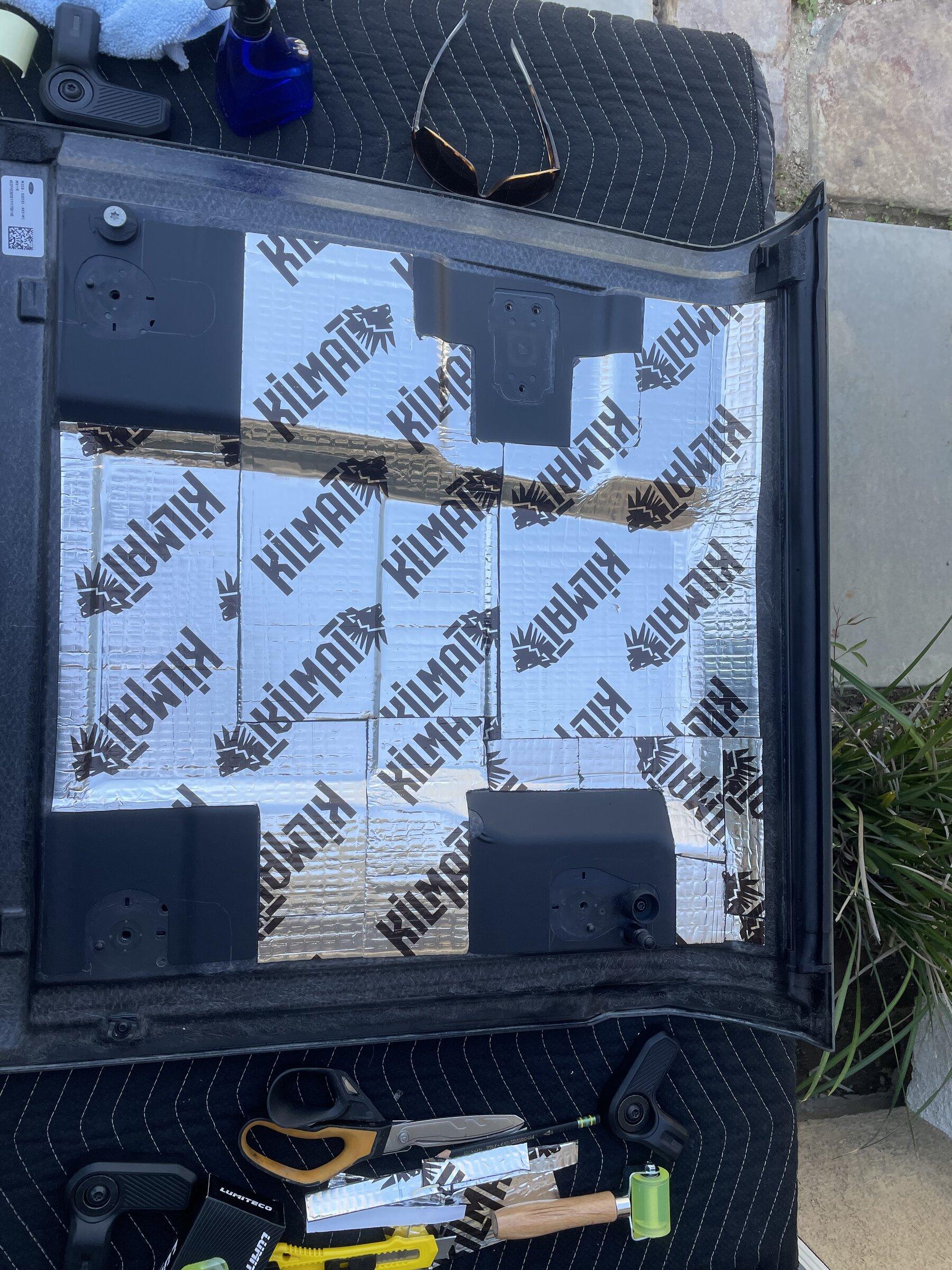

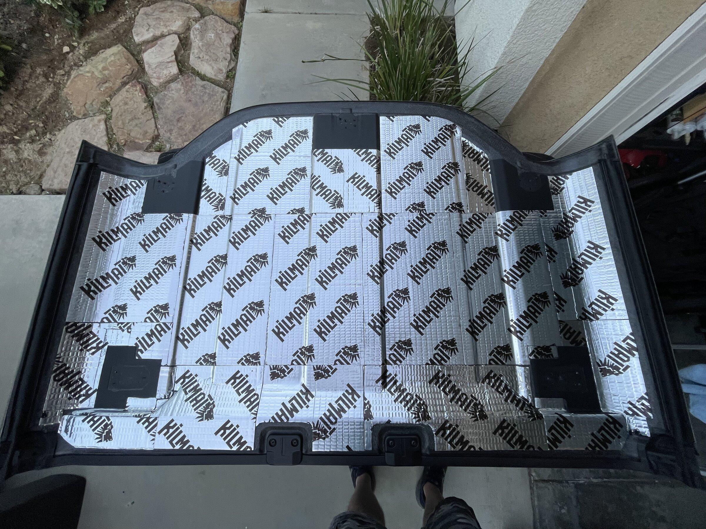

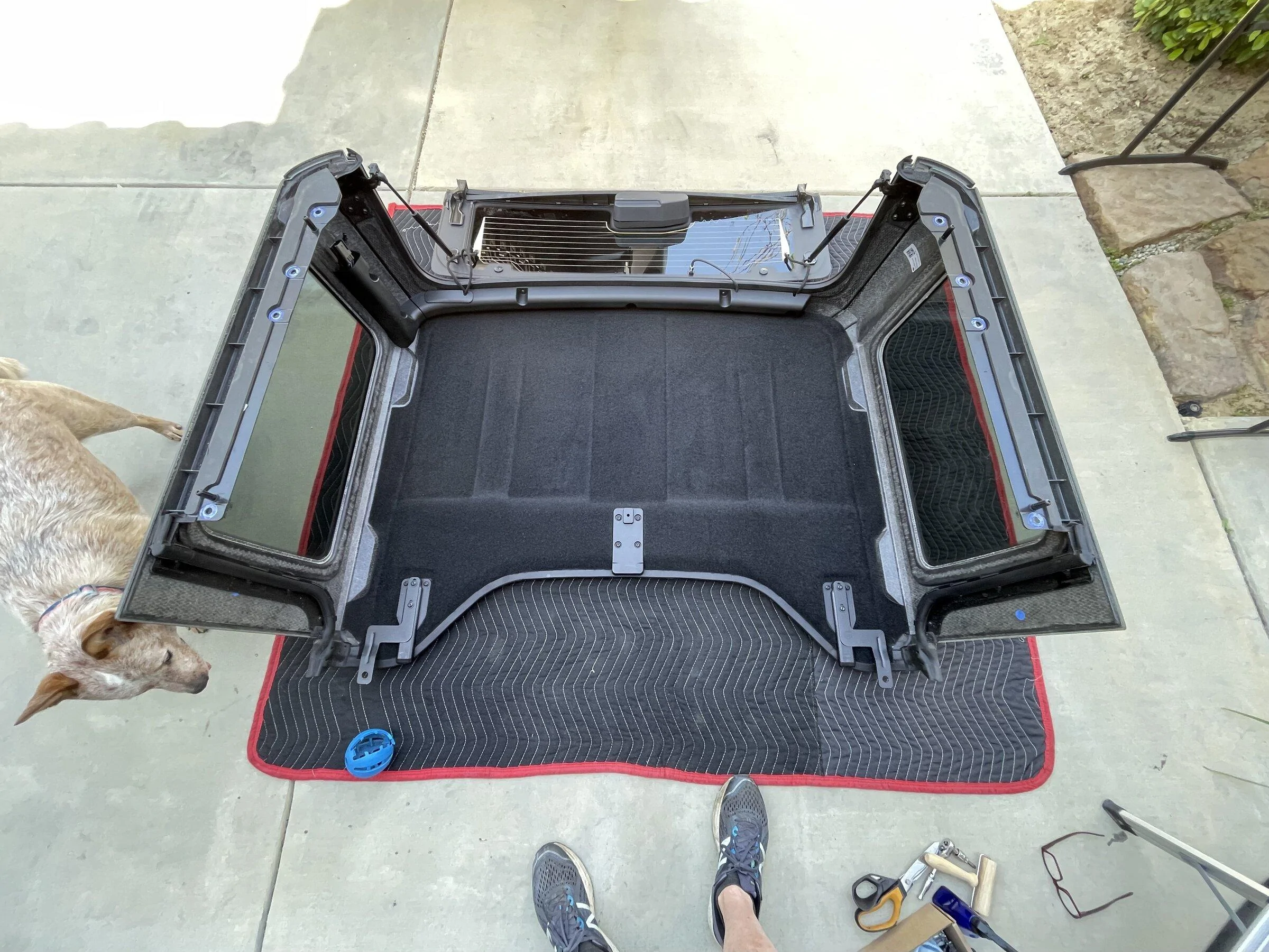

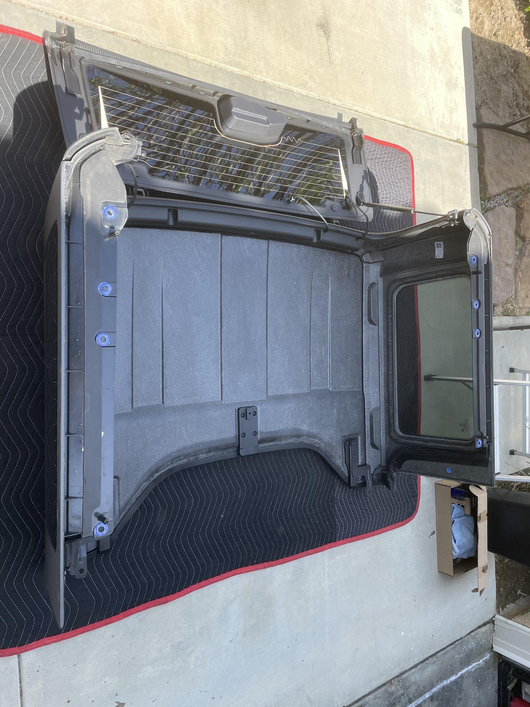

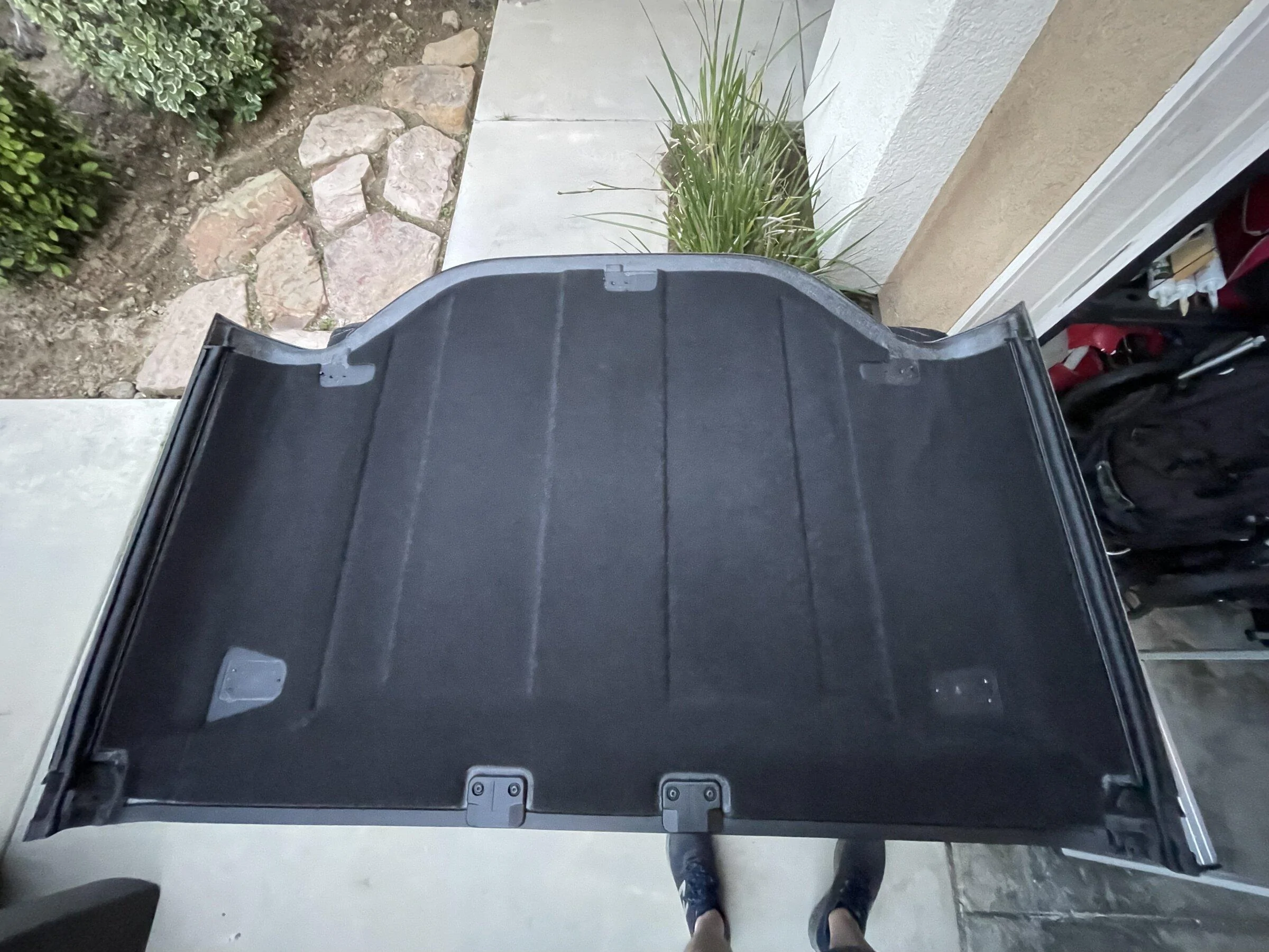

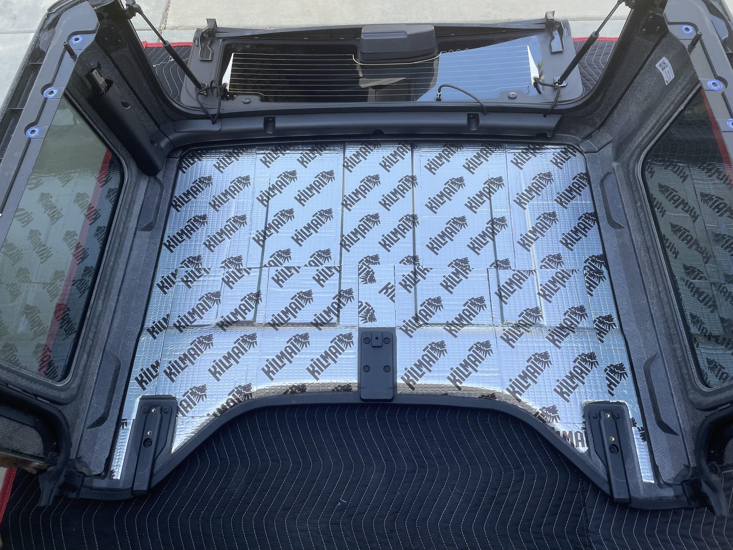

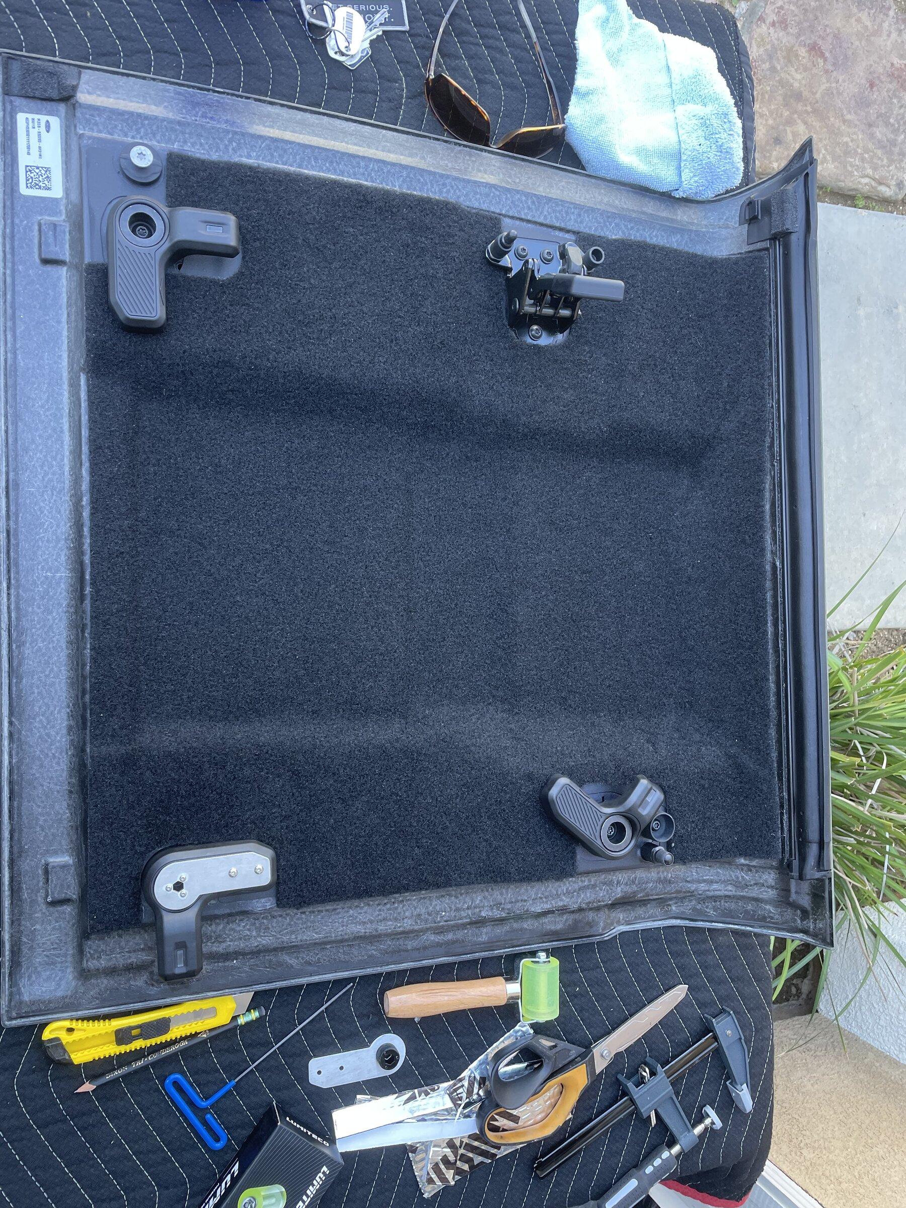

When I took delivery of my Bronco it didn’t have the hardtop sound deadening package installed. Somewhere this got missed but Jeff at Galpin made it right and got the package delivered. I’m kind of glad it wasn’t installed as this gave me the opportunity to take advantage of a raw untreated top.
Based on a lot of people mentioning how little difference there was between the soft top and the hard top regarding outside noise I decided to add some Kilmat. And this weekend was beautiful so I started and finished that project.
I did each panel one at a time. First I removed all the latches, then laid out the factory liner, then I checked for clearance of the latches swing which led me to the areas I chose to not add treatment. Too thick under the latch and it would interfere with the throw of the latch. Next I thoroughly cleaned the entire area with isopropyl alcohol and a microfiber. Noting the interior is somewhat rough so using a cloth that wouldn’t shed or leave residual fibers was pretty important. I then hand laid each piece with the backing still applied, formed them to the contours by hand and used my thumb nail to crease in the areas I would trim. Pulled the Kilmat and cut the unneeded areas with some shop shears.
Then I laid the piece down and reformed it paying close attention to the depressions, edges and contours. I used a roller to finish each piece and made sure they were super tight. Once the entire roof section was sound deadened I would recheck the factory head liner for any overlaps to avoid having any deadened hanging out exposed. I then recleaned the surface of the entire panel with the alcohol. Next was to peel and lay the factory liner. I had noted where rack piece needed to line up so I just took my time and employed the help from my wife for the two larger sections.
Overall I’m super happy with the results. I couldn’t really put numbers down for the interior sound decibel difference but it’s substantial. Yes the roof still has a notable air flowing sound from the seams, but it’s less than it was. And I no longer feel like I’m in a tent while in the Bronco which is about what the stock hardtop sounded like. Next I will probably deaden the entire interior while I upgrade the stereo.

So I just drove again, the second trip, and noted the deadening has worked actually better than I was thinking this morning. I was driving on the 101 and started to really appreciate it. Even the ever present wind from the seams noise is down substantially. Now I can hear the tires and I really didn't notice them before. I can listen to a fairly quite podcast at sound volumes about half or maybe only two-thirds what I had to put it to before the mod. on the highway at 75 mph I have the volume at 10 and in town it's at 8 and that's with a really quite podcast containing old news interviews. I actually think it's almost as quite as the wife's Honda Pilot.
This is a really simple mod for any do it yourself. And the material doesn't cost much. I only bought one box for the entire roof and I din't use it all. I wish I could've left the top off. It's amazing like that. But I had work to do and leaving gear in the back isn't so great. Plus I wanted to see if that effort amounted to anything. I highly recommend the mod. I'll update this occasionally if I note any issues.
