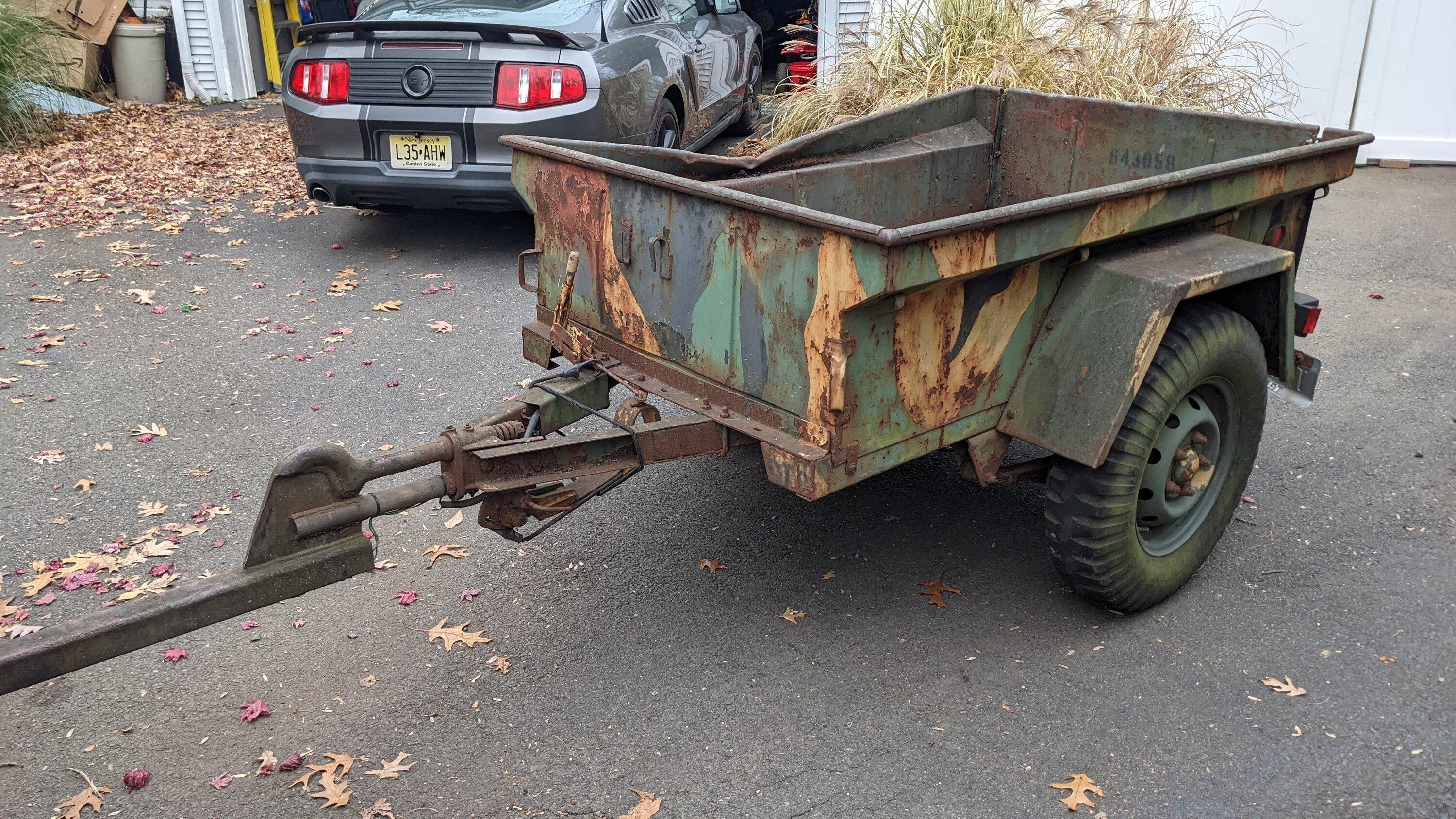

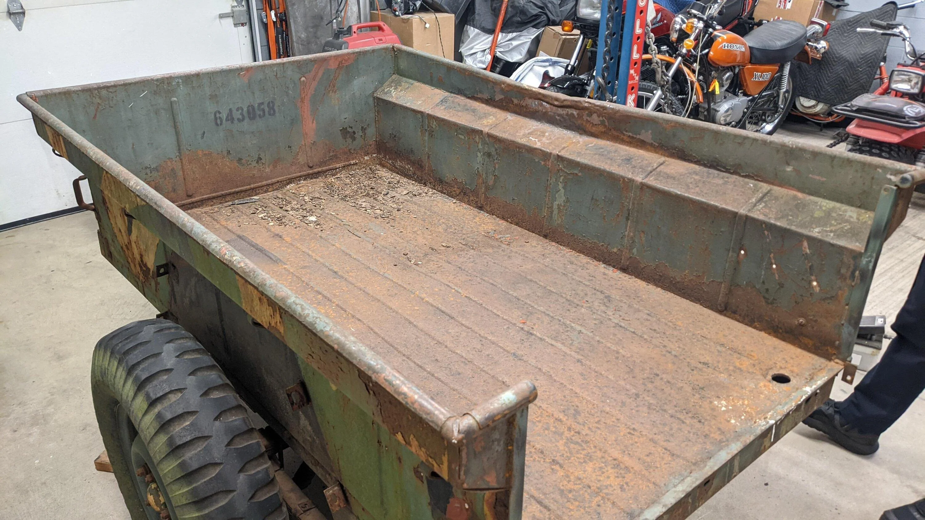

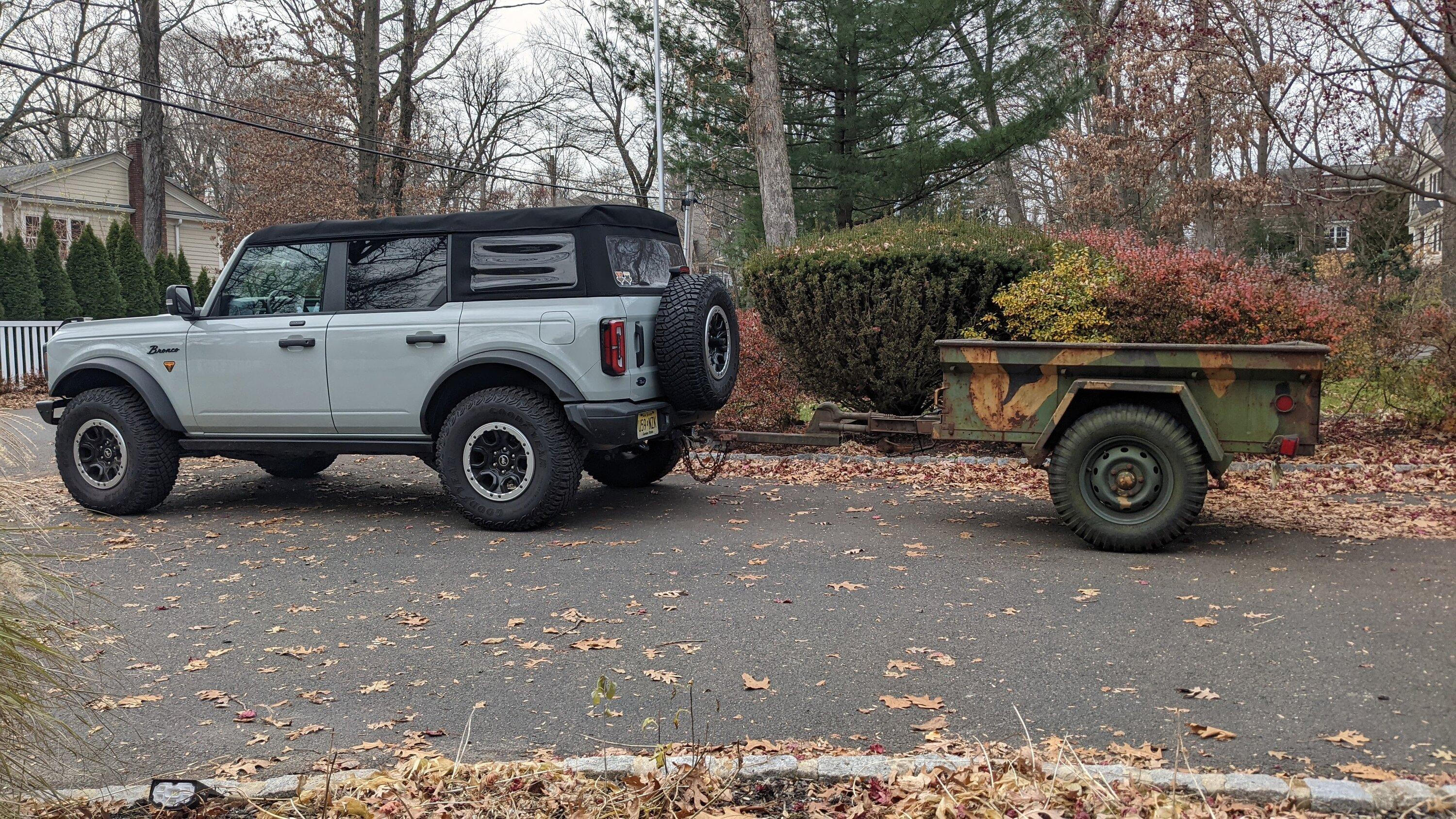

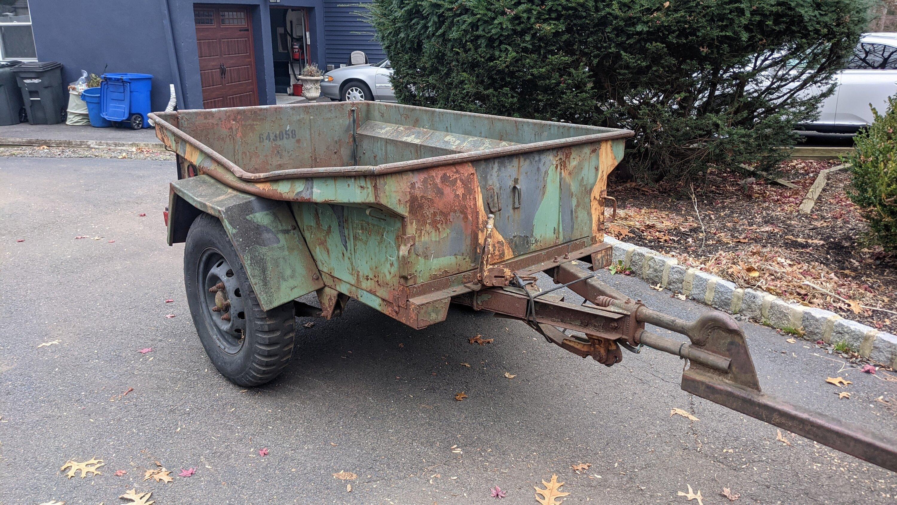

I started with a Vietnam era (I think, might be earlier) M416 Army trailer. This is what it looked like when I bought it. Cost me $225.

Took a chance with the damage but it's going to be used off road. Won't hurt so much when I scratch it lol. Got the dent taken out best I could for $100.

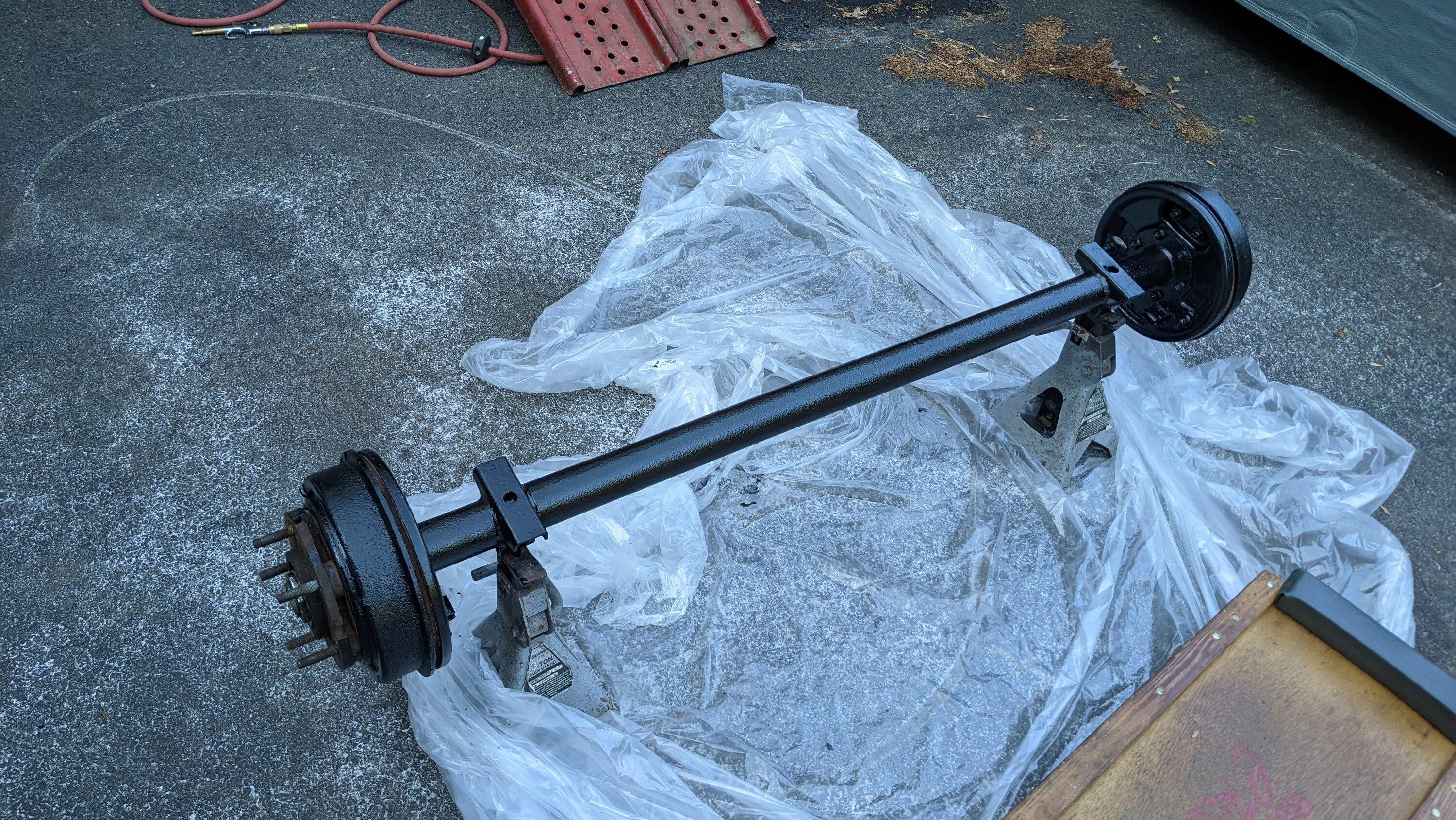

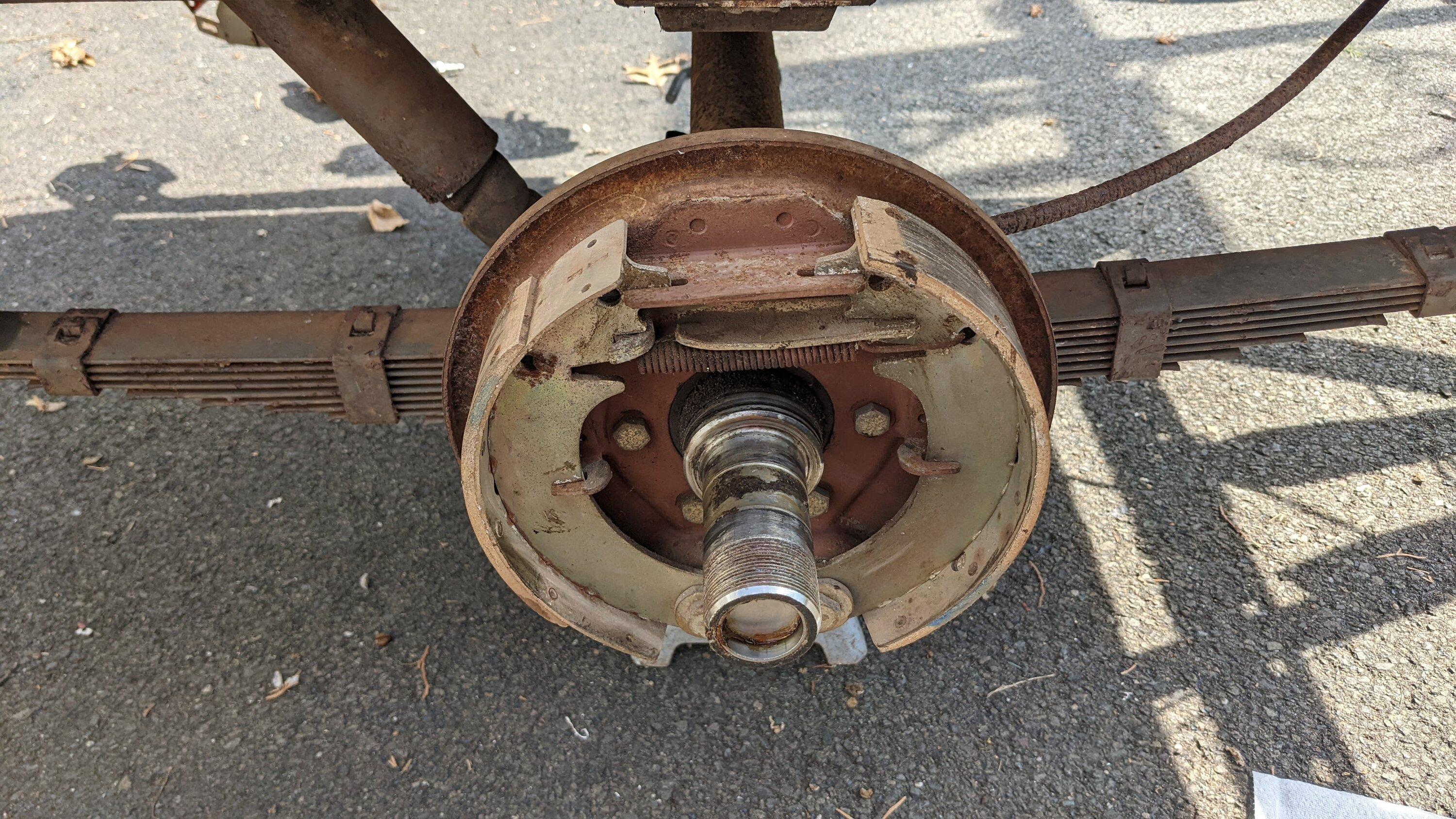

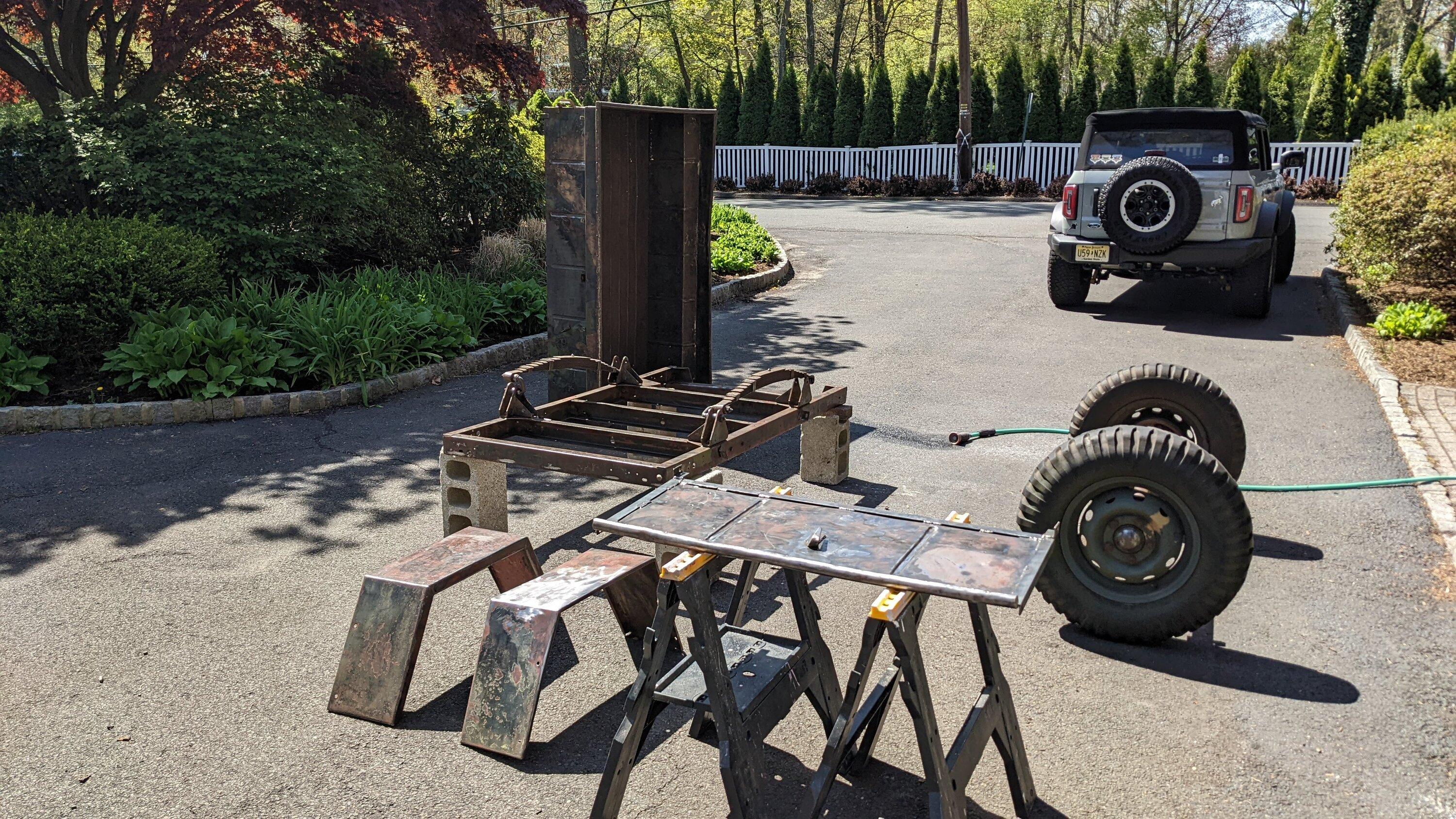

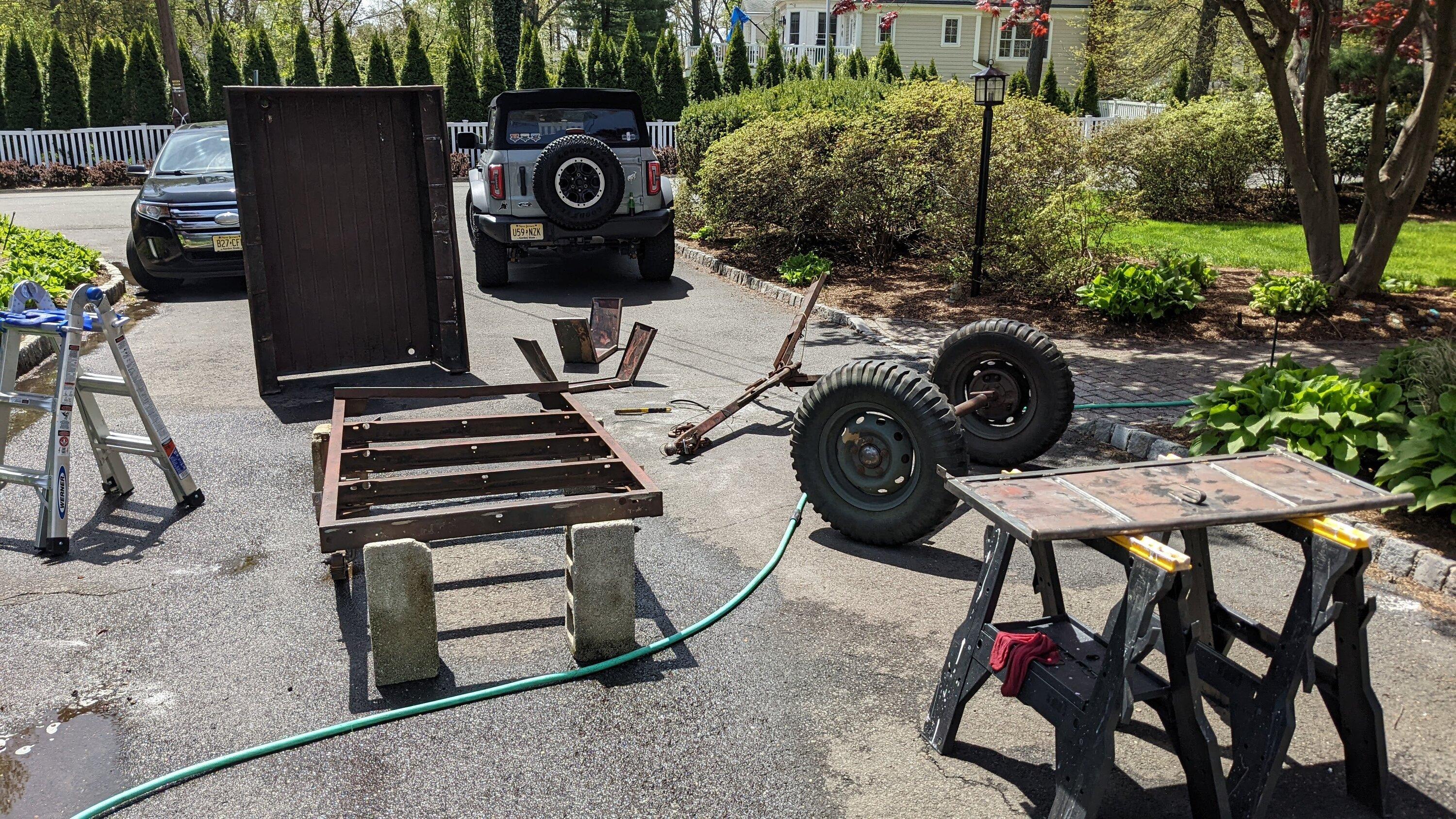

Stripped everything down to basic parts. Stripped paint and rust and I redid the wheels with new bearings and races.

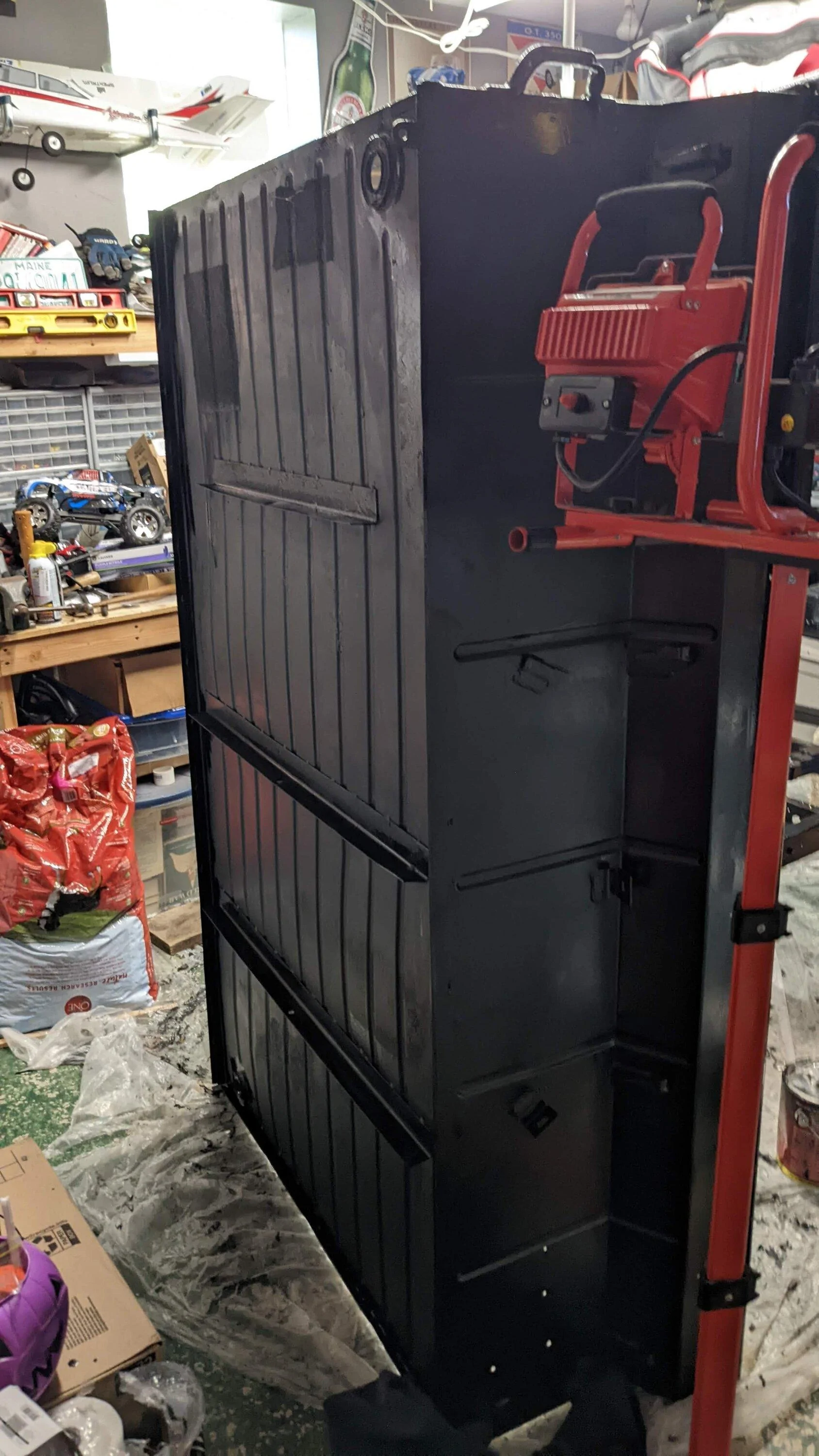

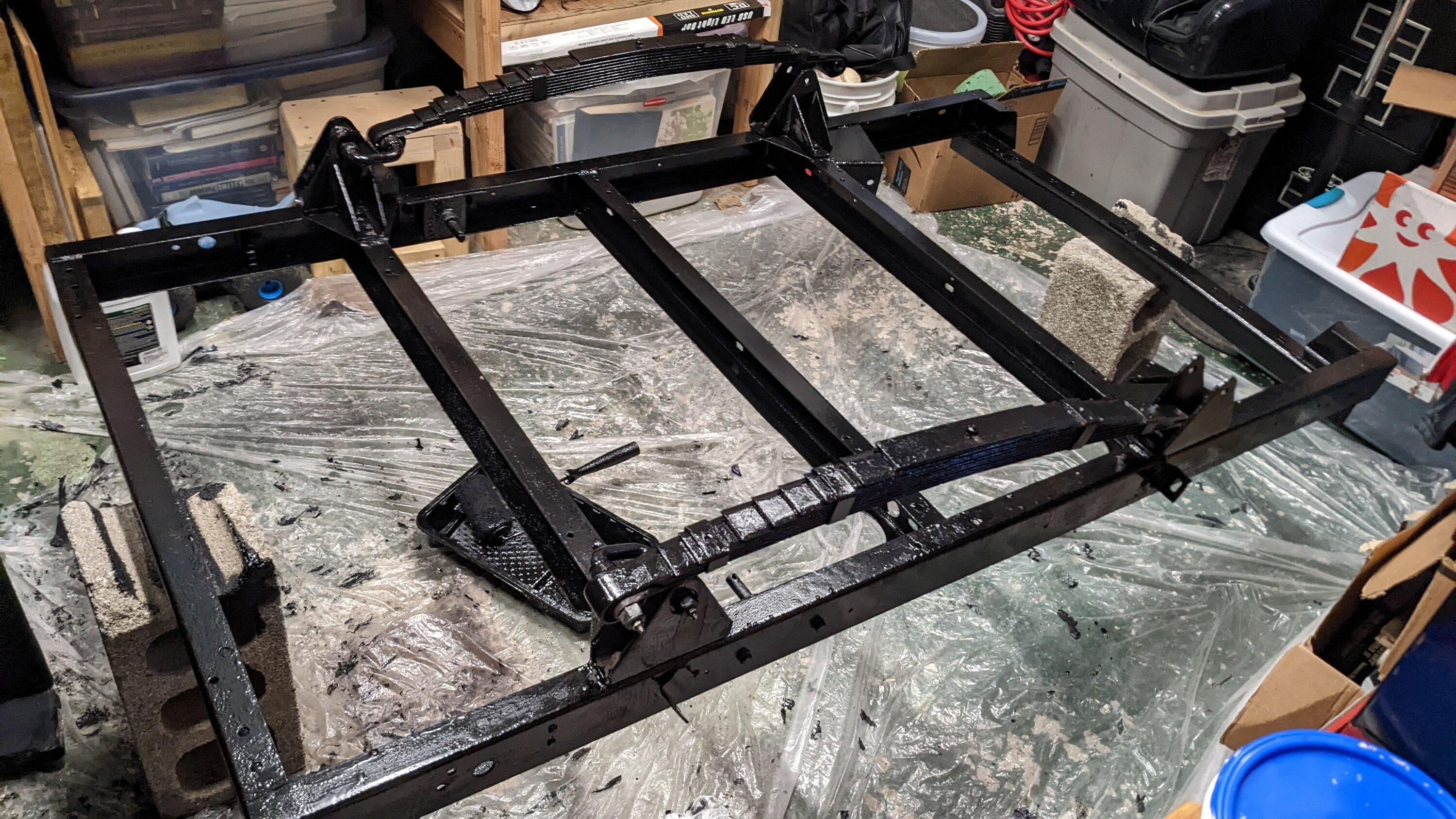

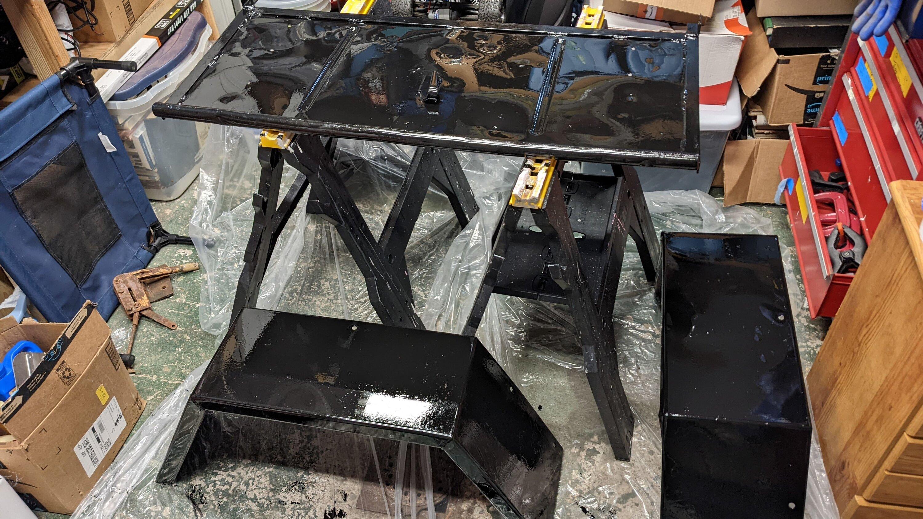

Then I degreased and scrubbed everything and prepped the metal with etching solution. Next was to coat everything with POR-15.
Ford Bronco My Bronco and matching Cactus Gray M416 overlanding trailer custom build PXL_20220515_214310193
Ford Bronco My Bronco and matching Cactus Gray M416 overlanding trailer custom build PXL_20220515_215021035
Ford Bronco My Bronco and matching Cactus Gray M416 overlanding trailer custom build PXL_20220506_183113287
Ford Bronco My Bronco and matching Cactus Gray M416 overlanding trailer custom build PXL_20220515_214258049

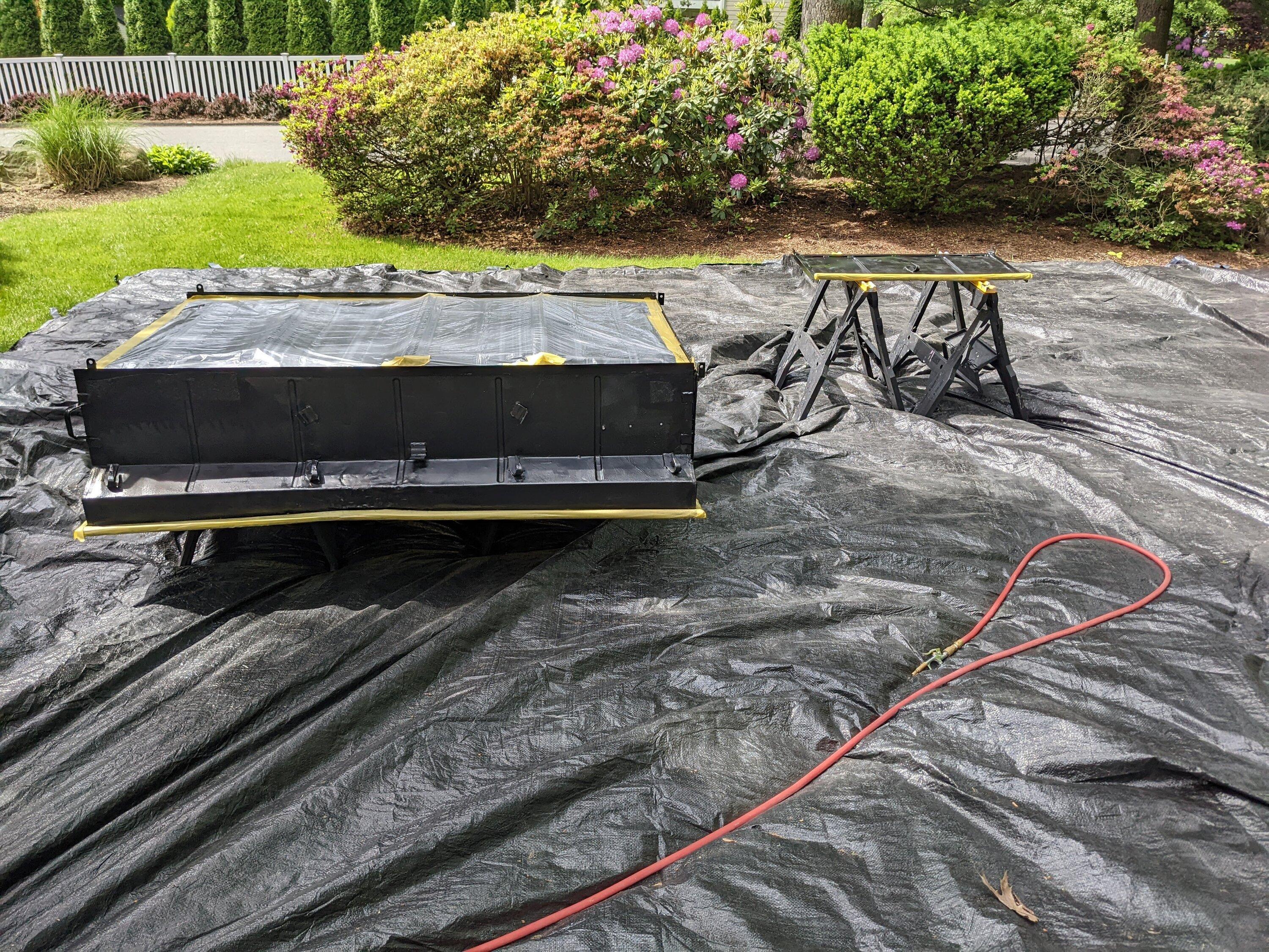

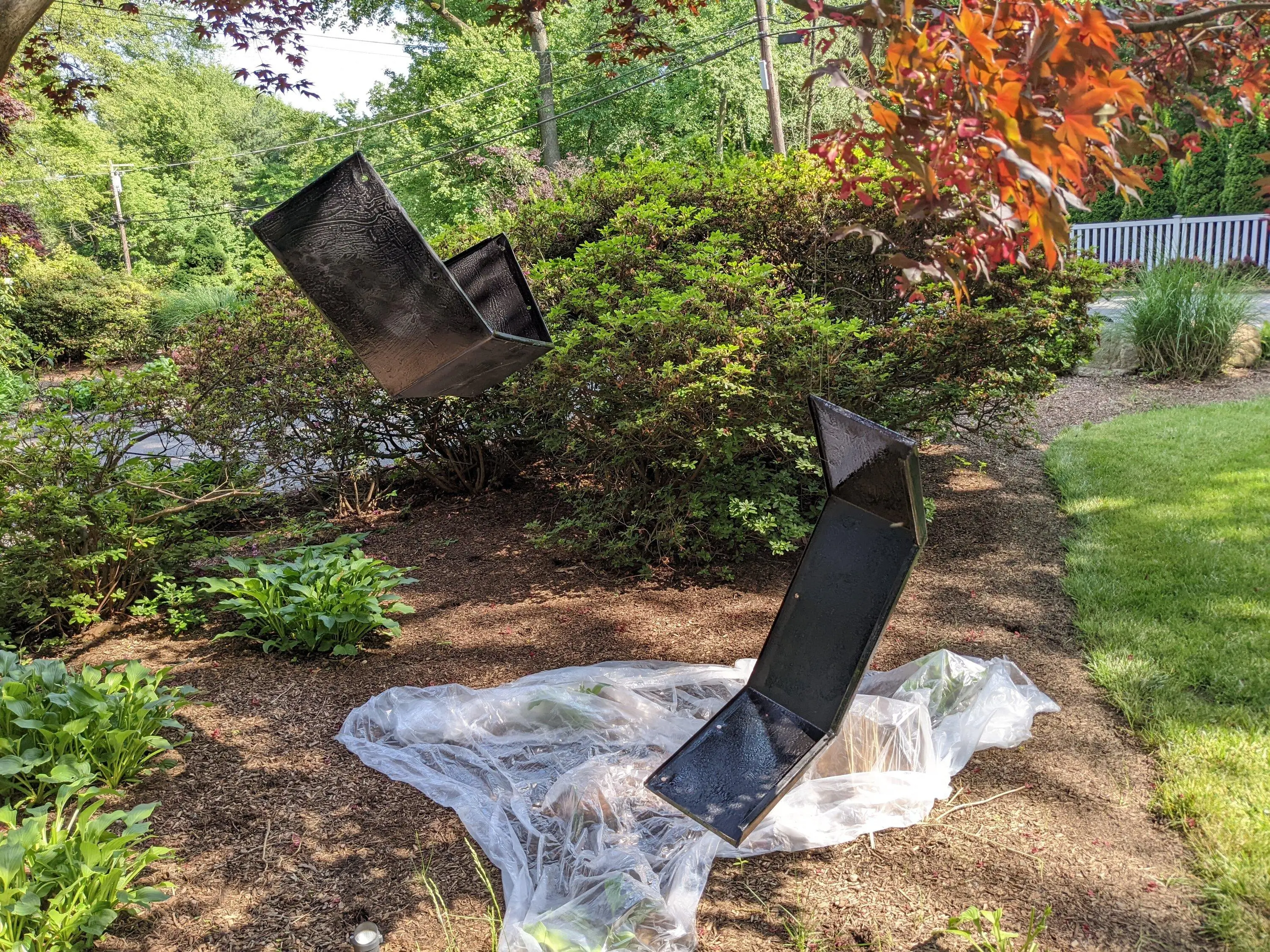

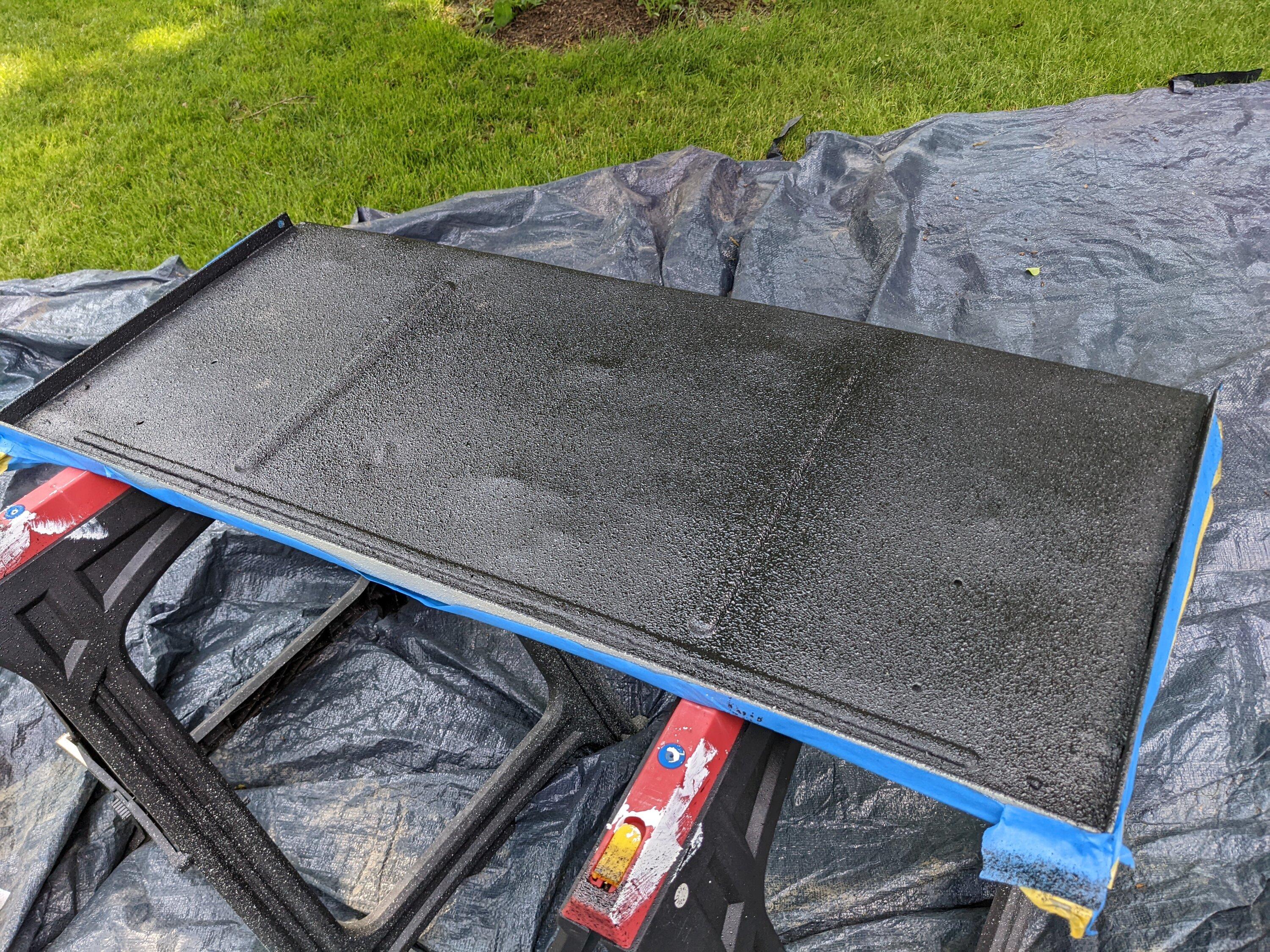

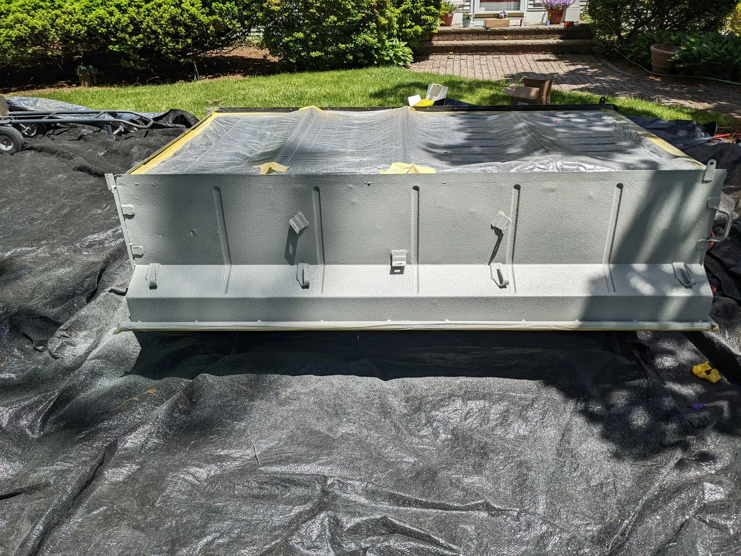

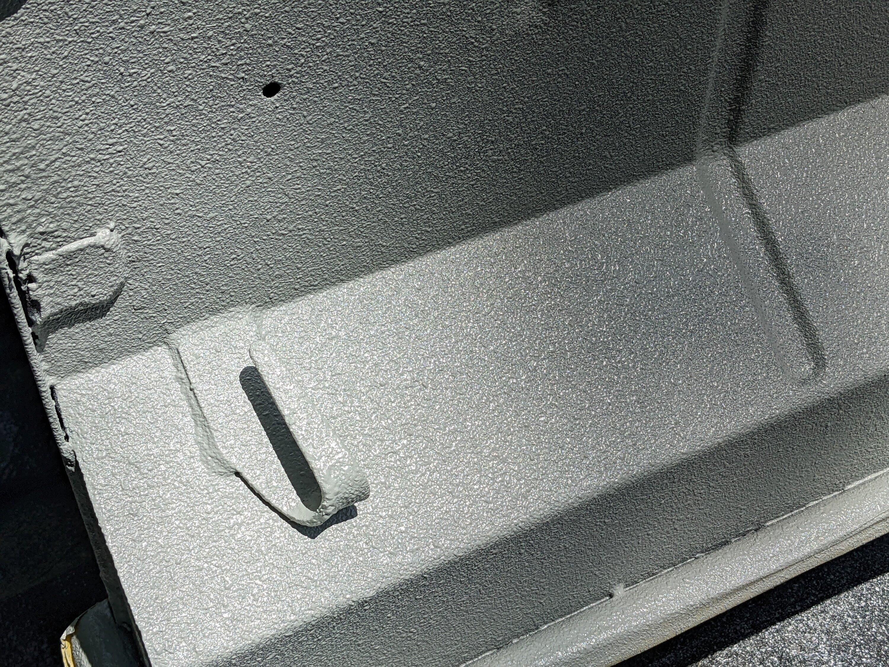

Then I painted the trailer with Raptor Liner. I did a two tone color scheme, matching cactus grey for the outside and black for the frame, bed and fenders.

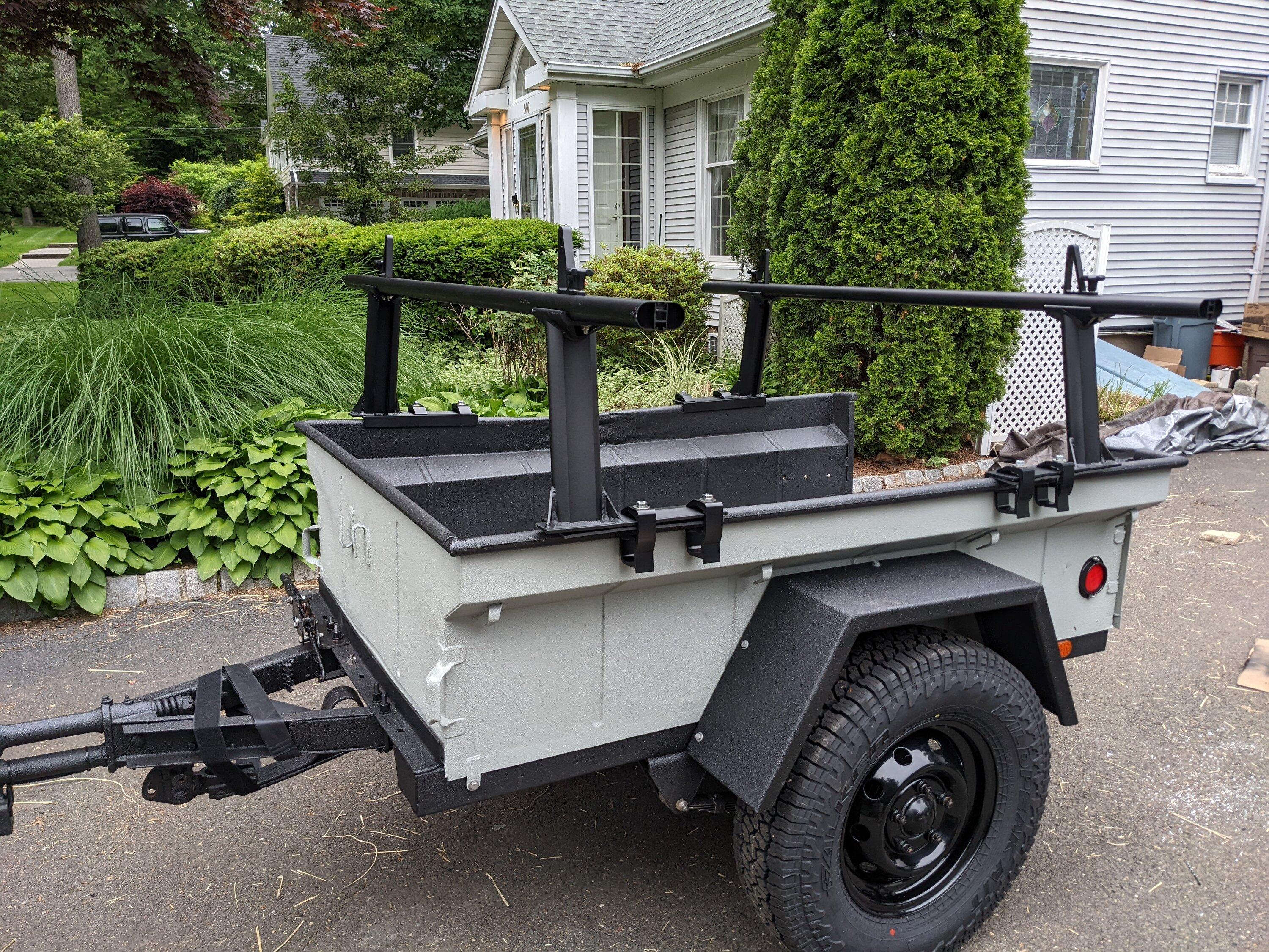

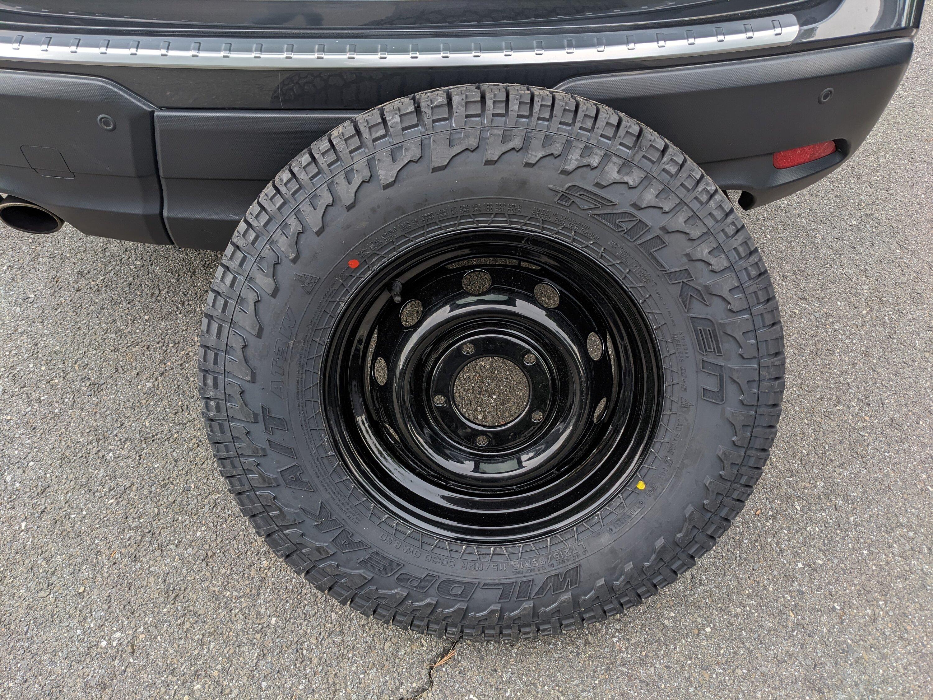

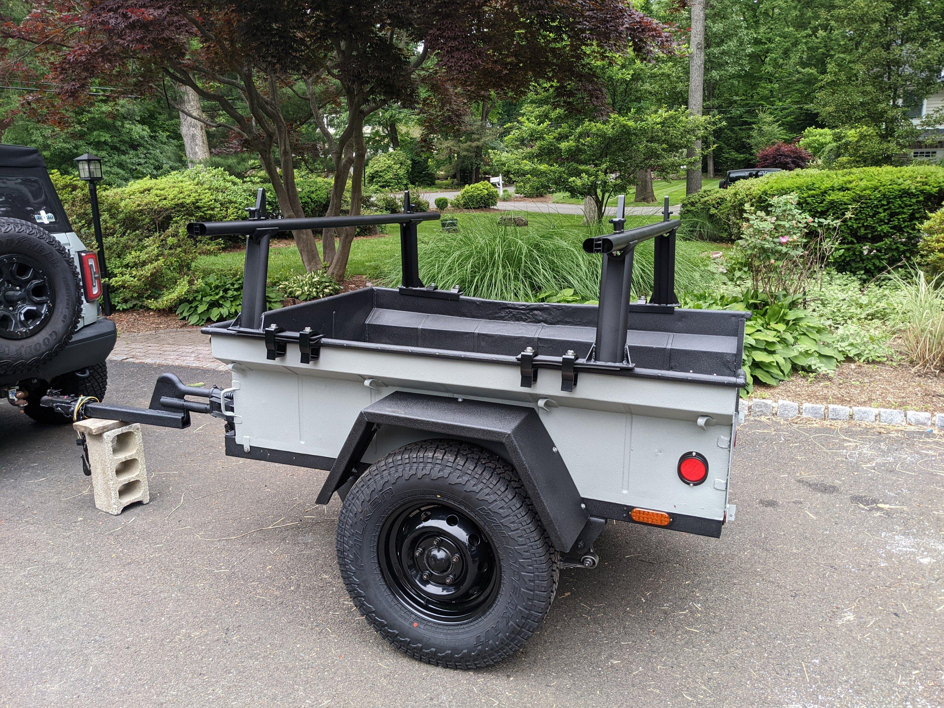

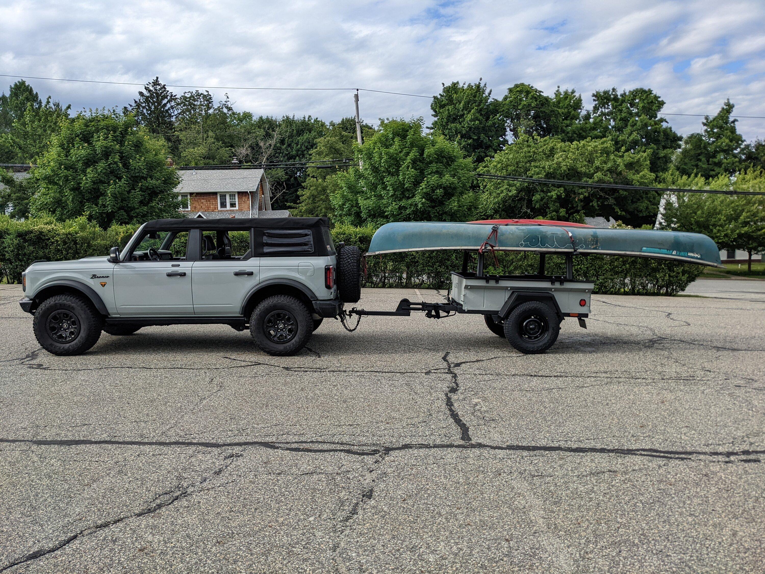

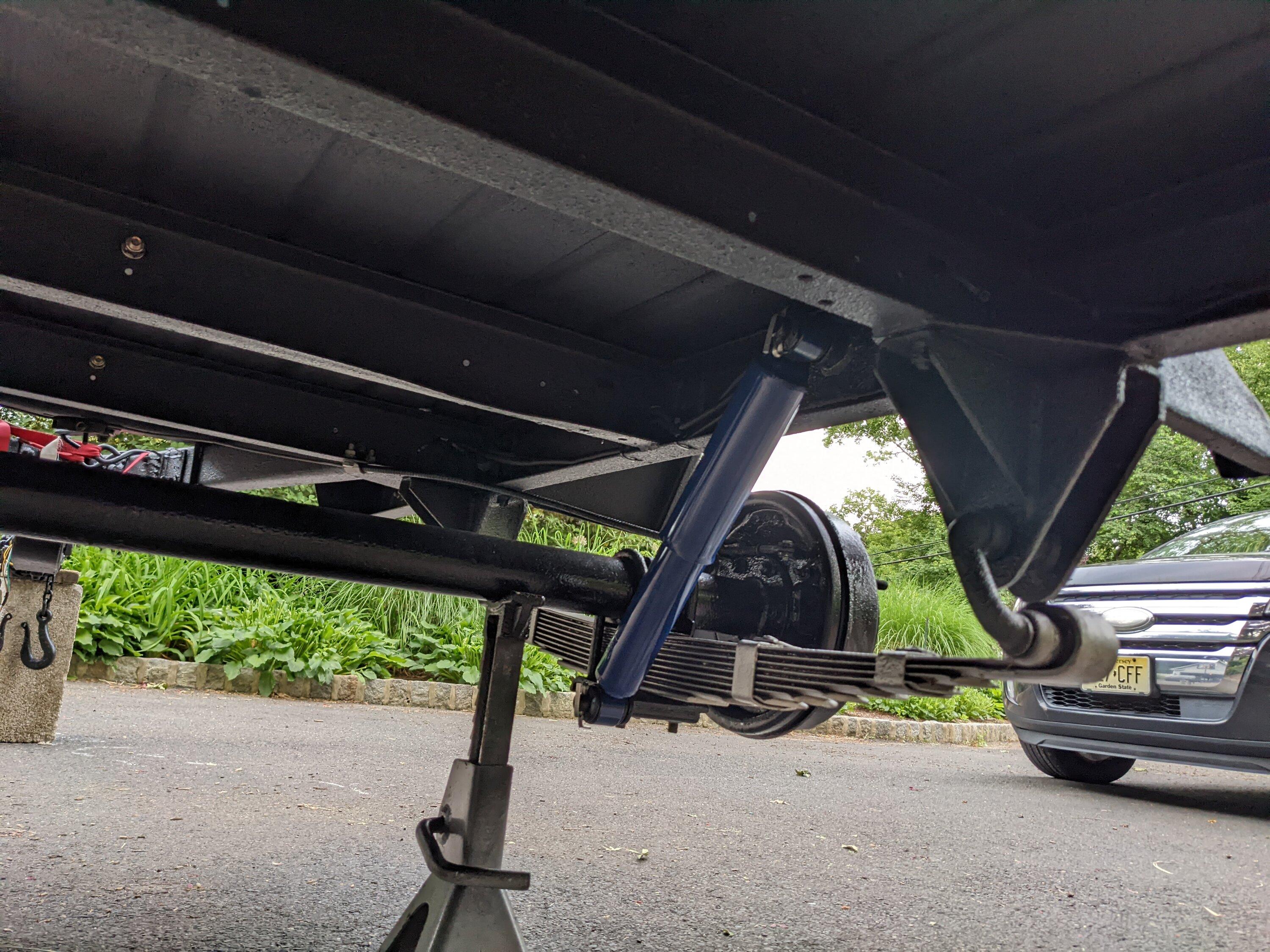

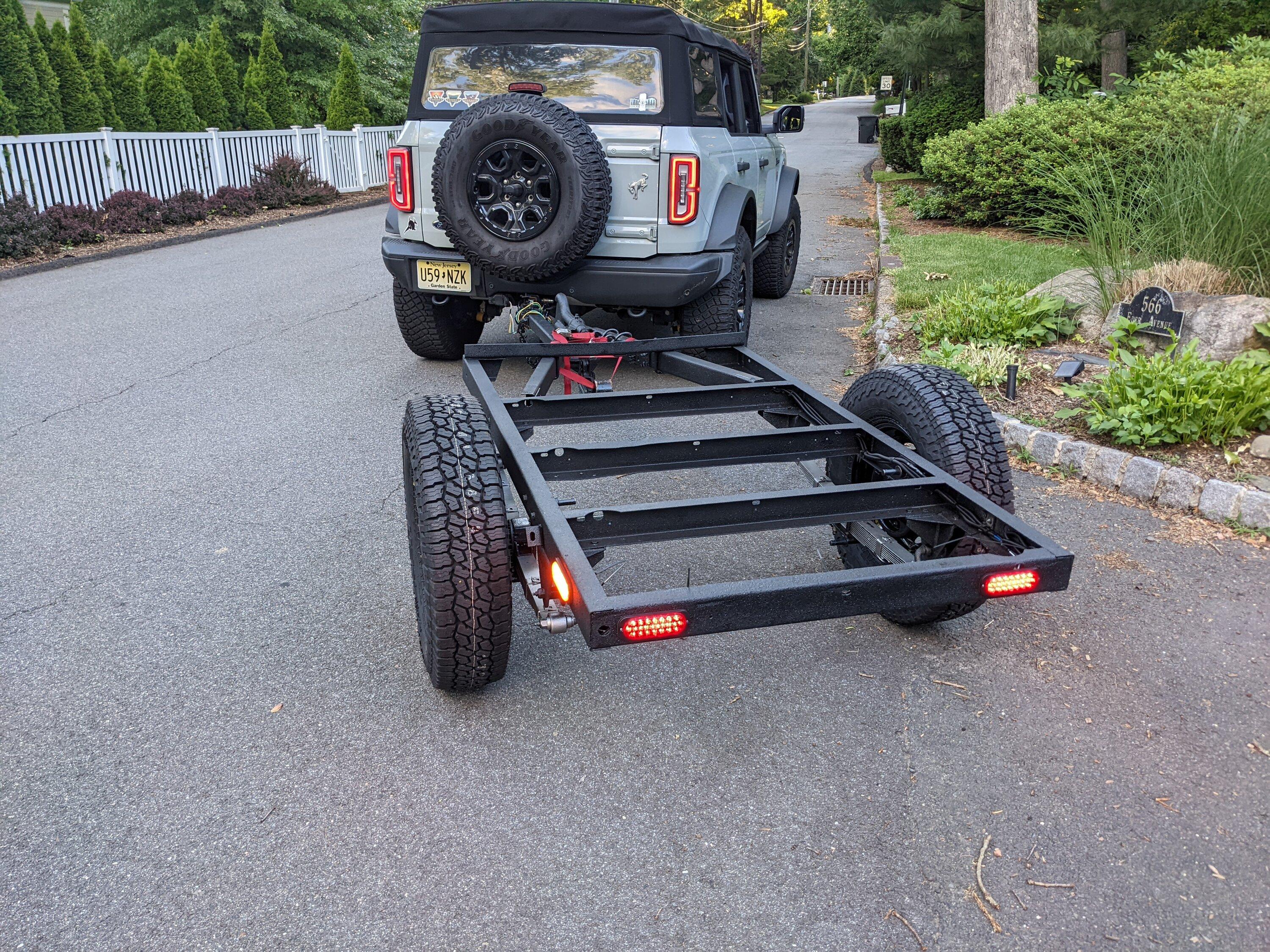

Then it was time to put everything back together. I got the original wheels powder coated black and mounted a set of 215/85/16 Falken Wildpeaks on them. They are basically the same size as the original 16x7.00 tires.

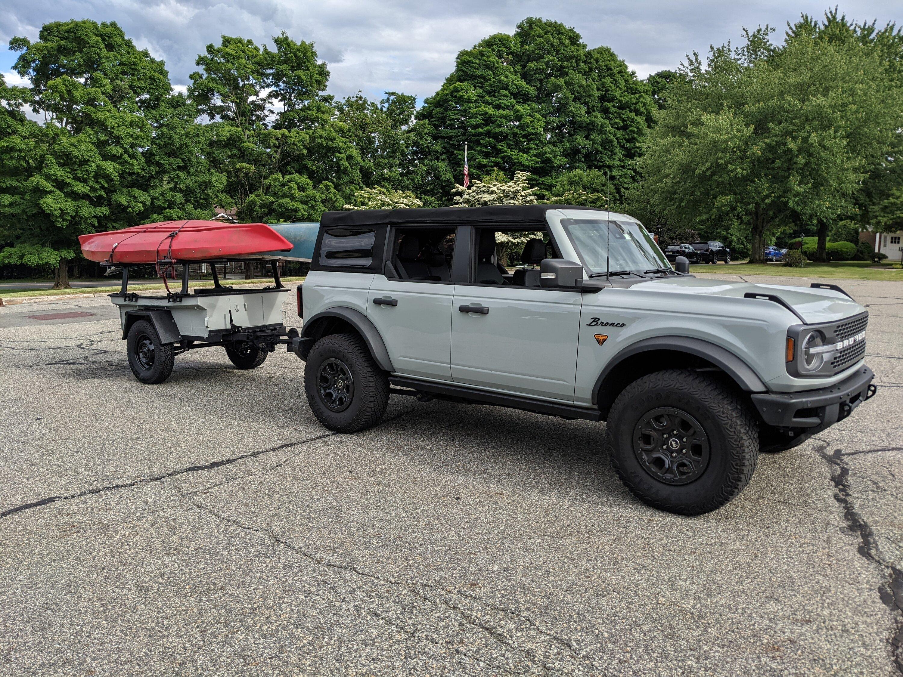

Assembled everything and I even got the original hand brake working again! I love this thing. I installed a bed rack. For now it's going to hold my kayak and canoe but eventually I want to add a roof top tent.
My future plans include a box with battery, solar panels and lights. Maybe a refrigerator and compressed air. Also want to add a water tank with some kind of kitchen setup that will fold down. Maybe some recovery tools. I'm open to ideas as this is my first attempt.

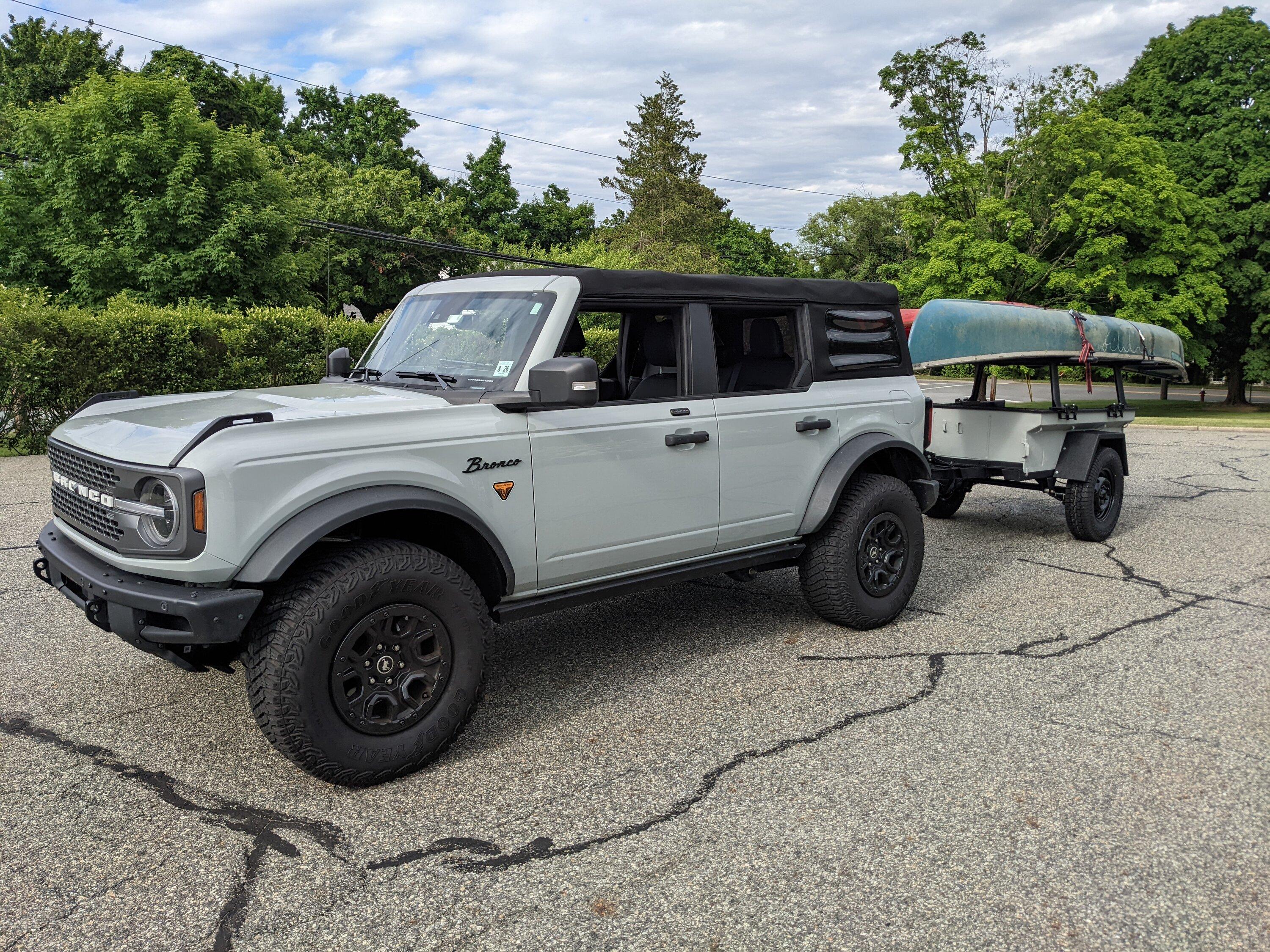

Looks awesome. Be careful with that canoe placement, looks like it's going to scrape your spare wheel when you go in/out of a driveway
Yeah it's close but clears. Even still, I have an 18 inch extension that I will probably use.

Best kind of project, the unique one you do yourself! Nice work! Please explain those trailer brakes a bit more! They look like a form of surge brake, that engage when the trailer surges forward against the tow hitch. Commonly found on boat trailers. But you also mention a hand brake? Please elucidate!
