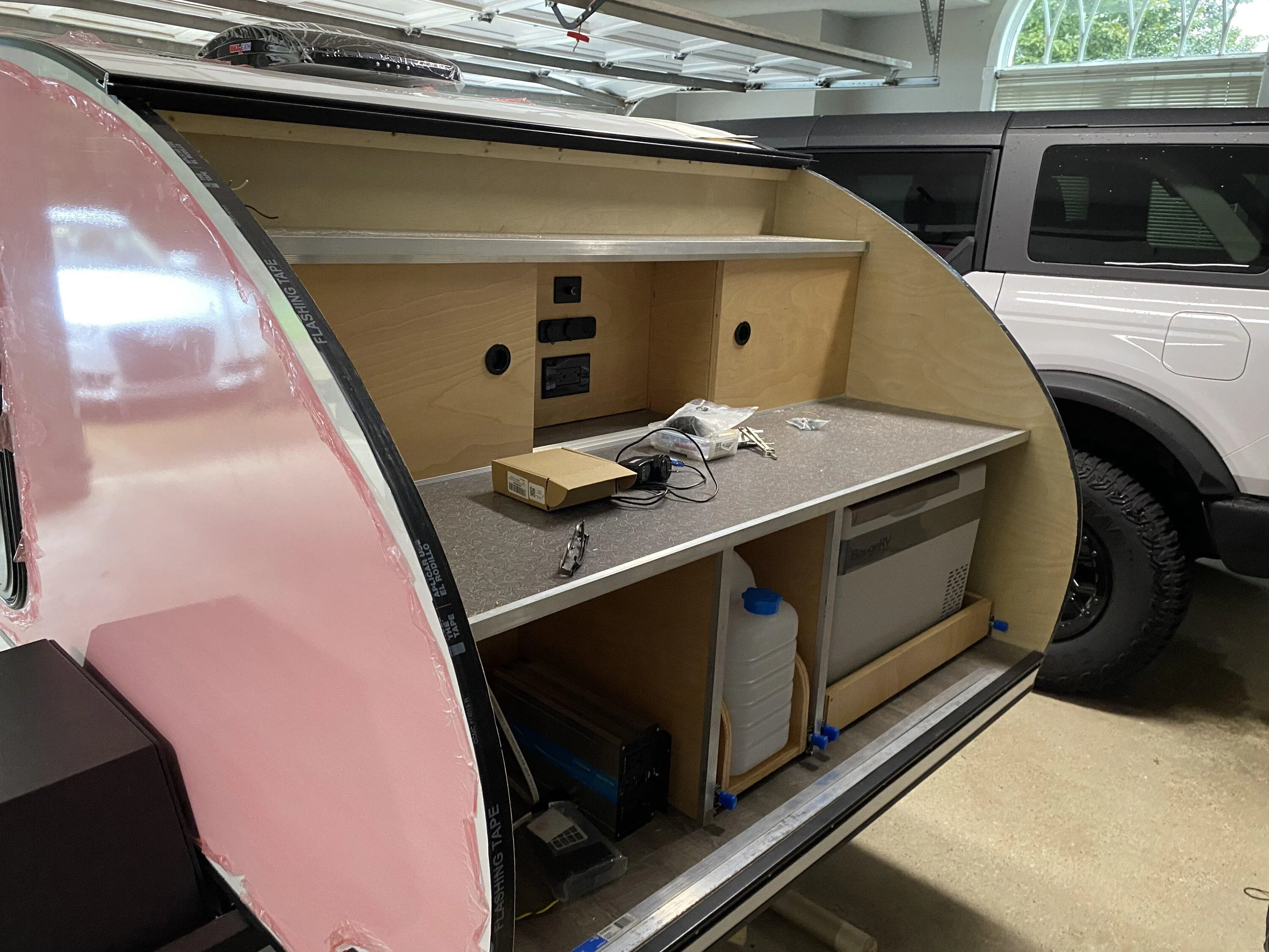

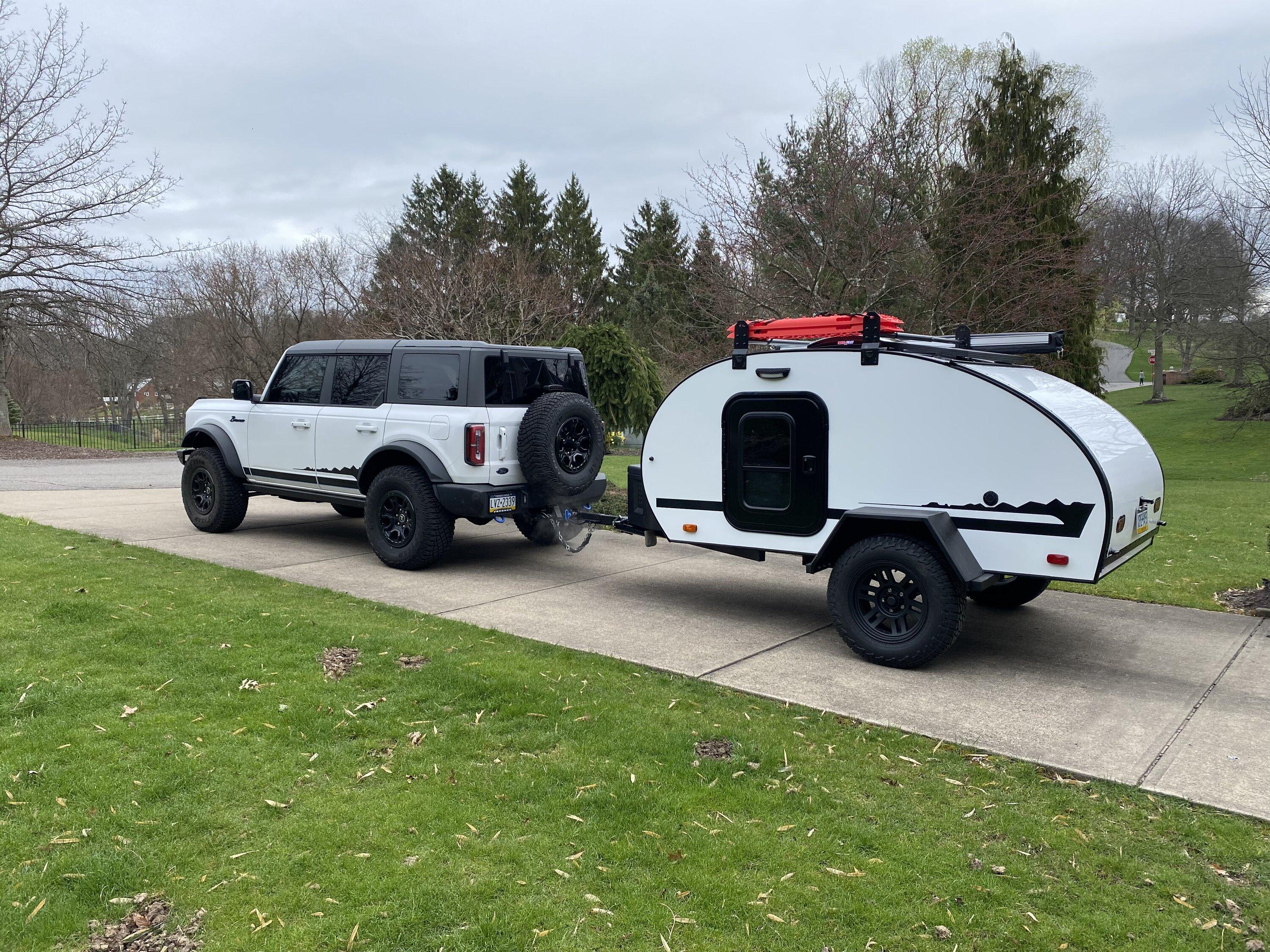

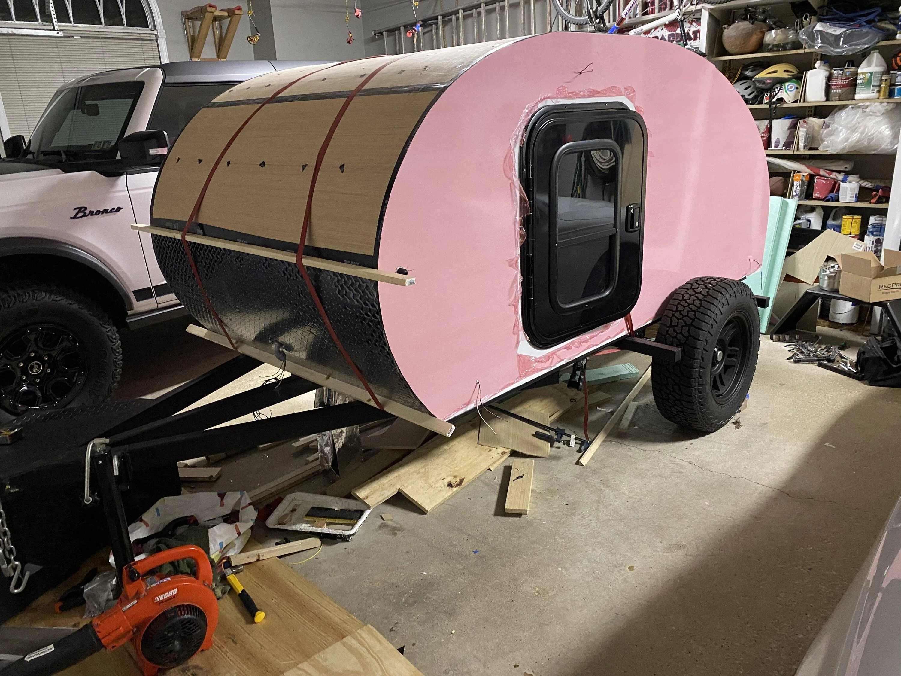

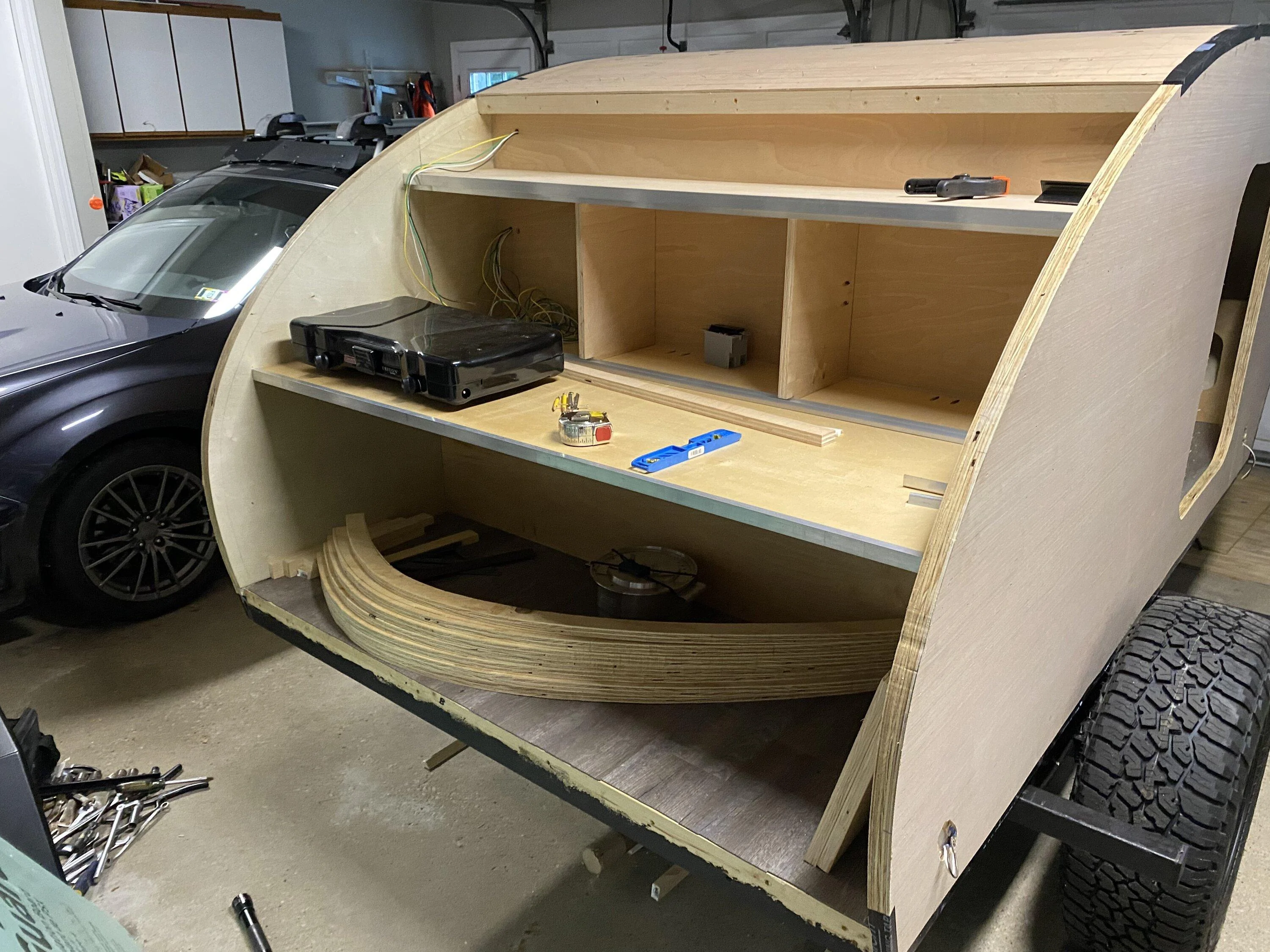

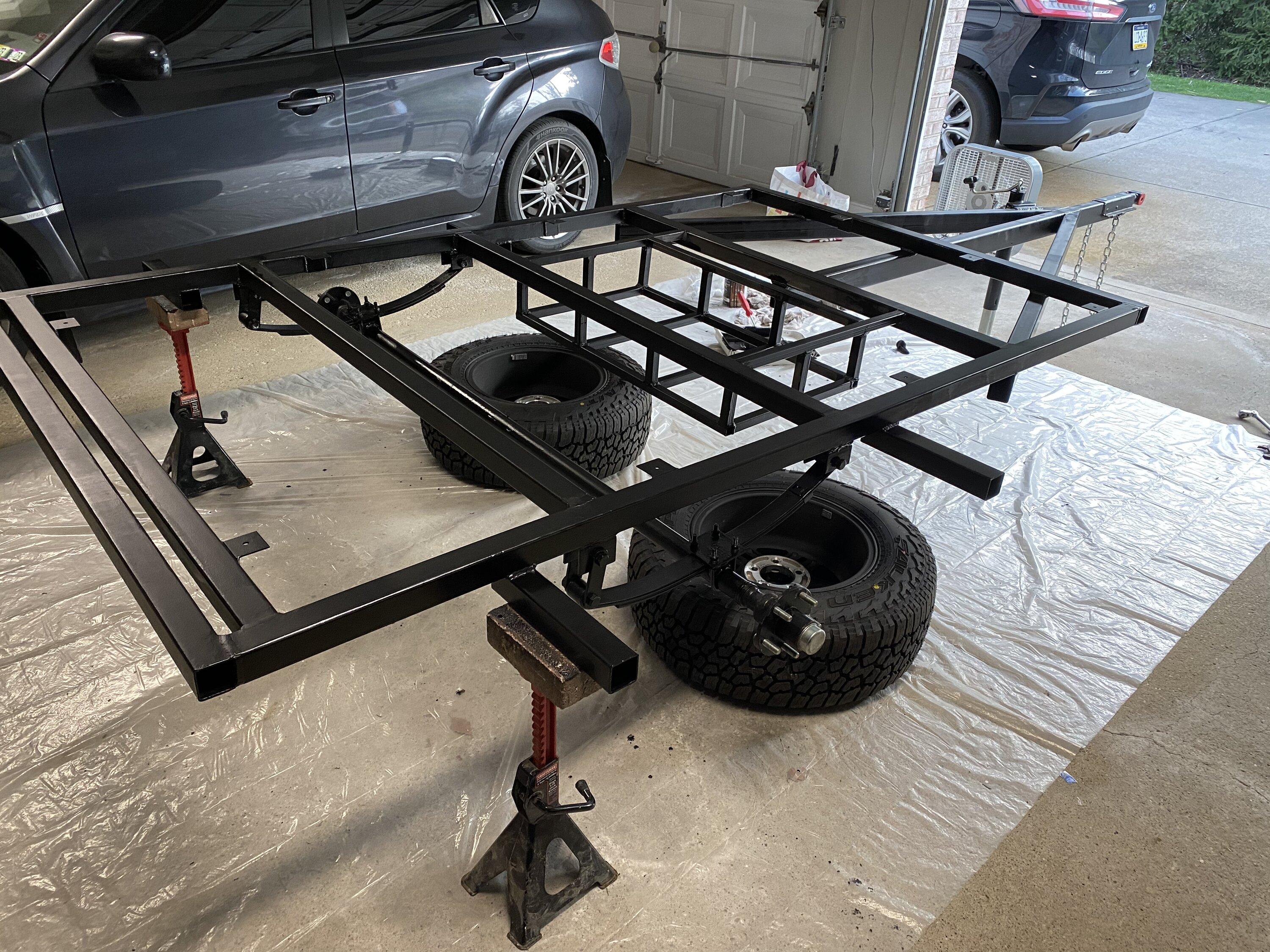

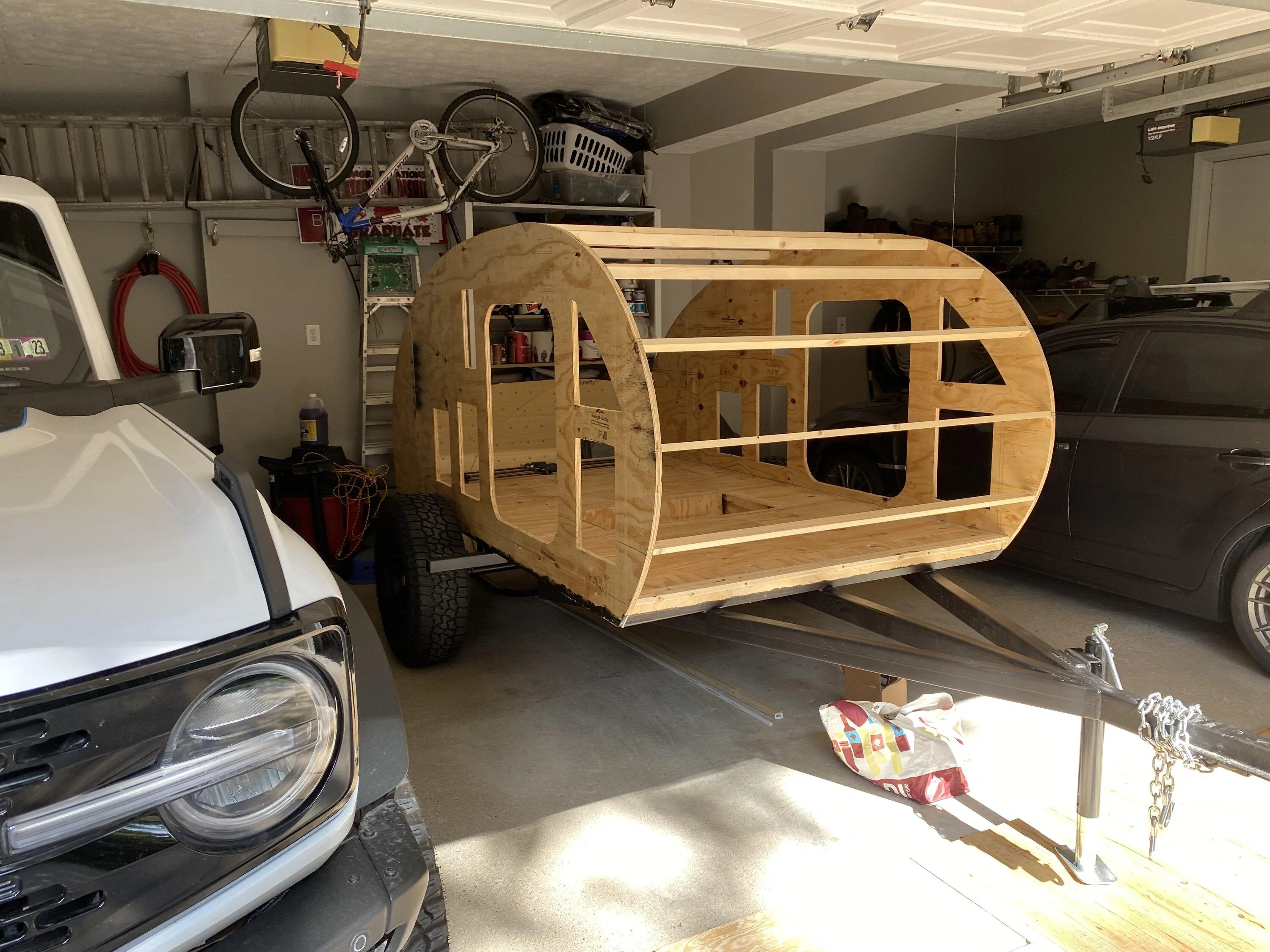

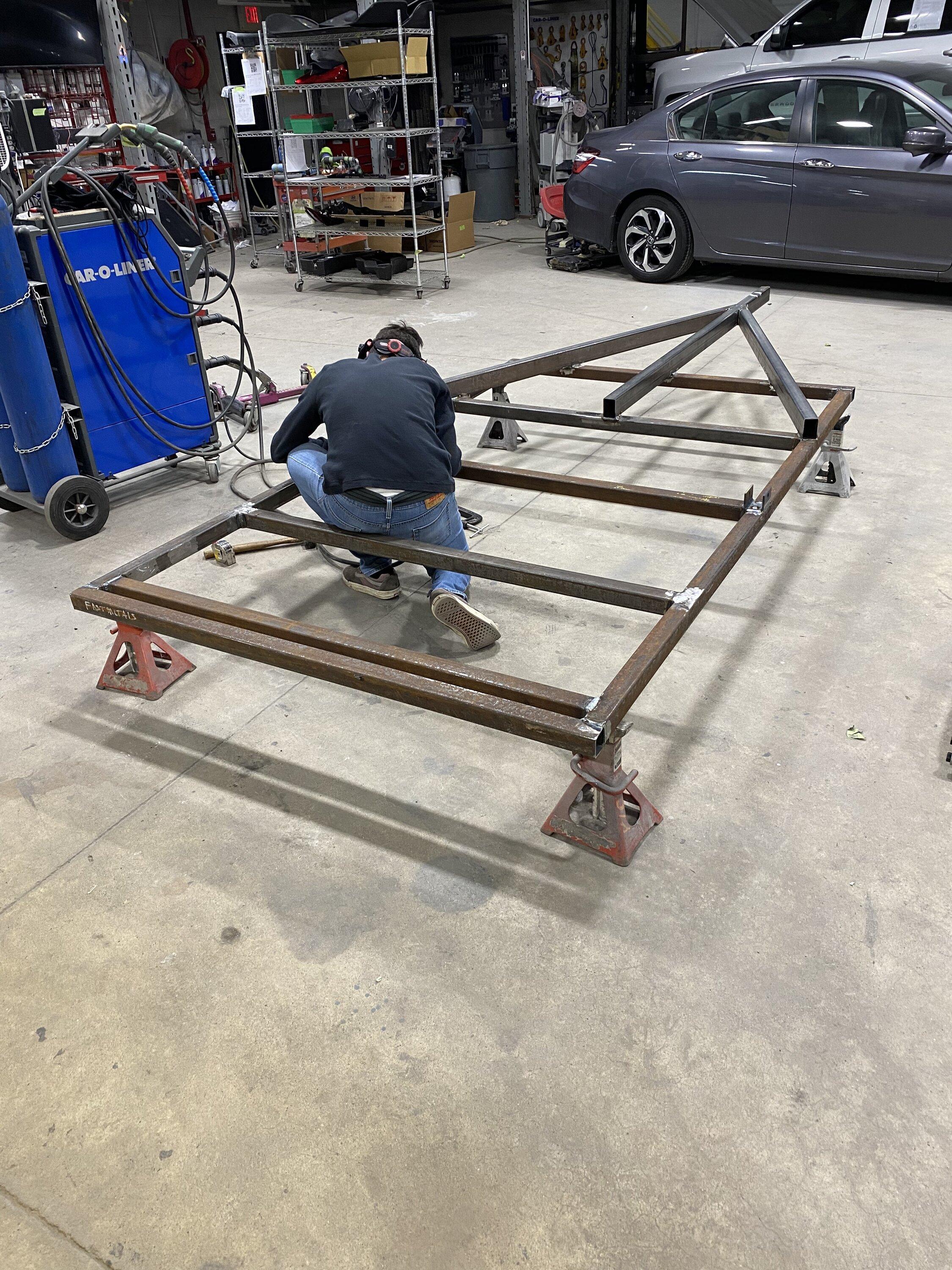

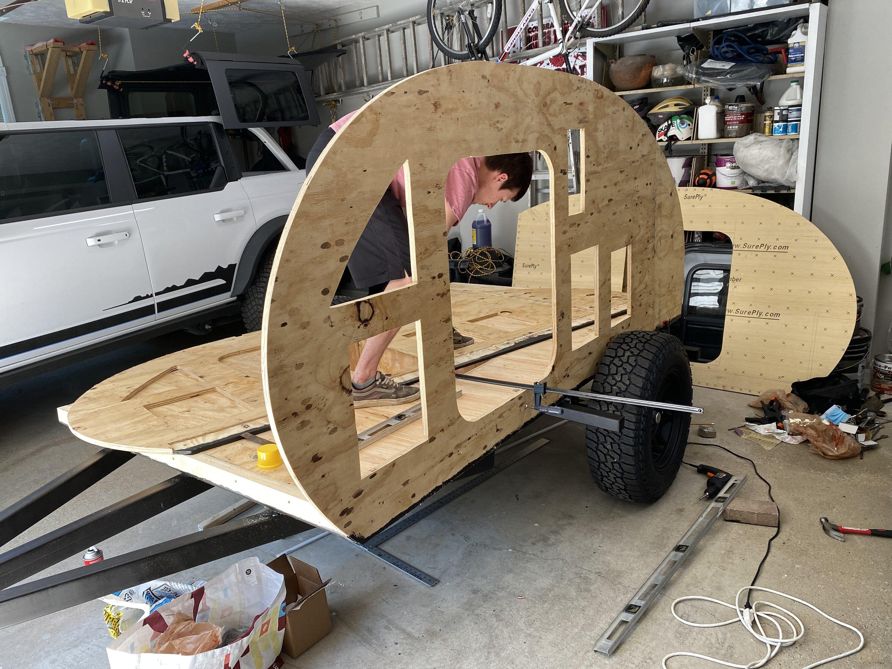

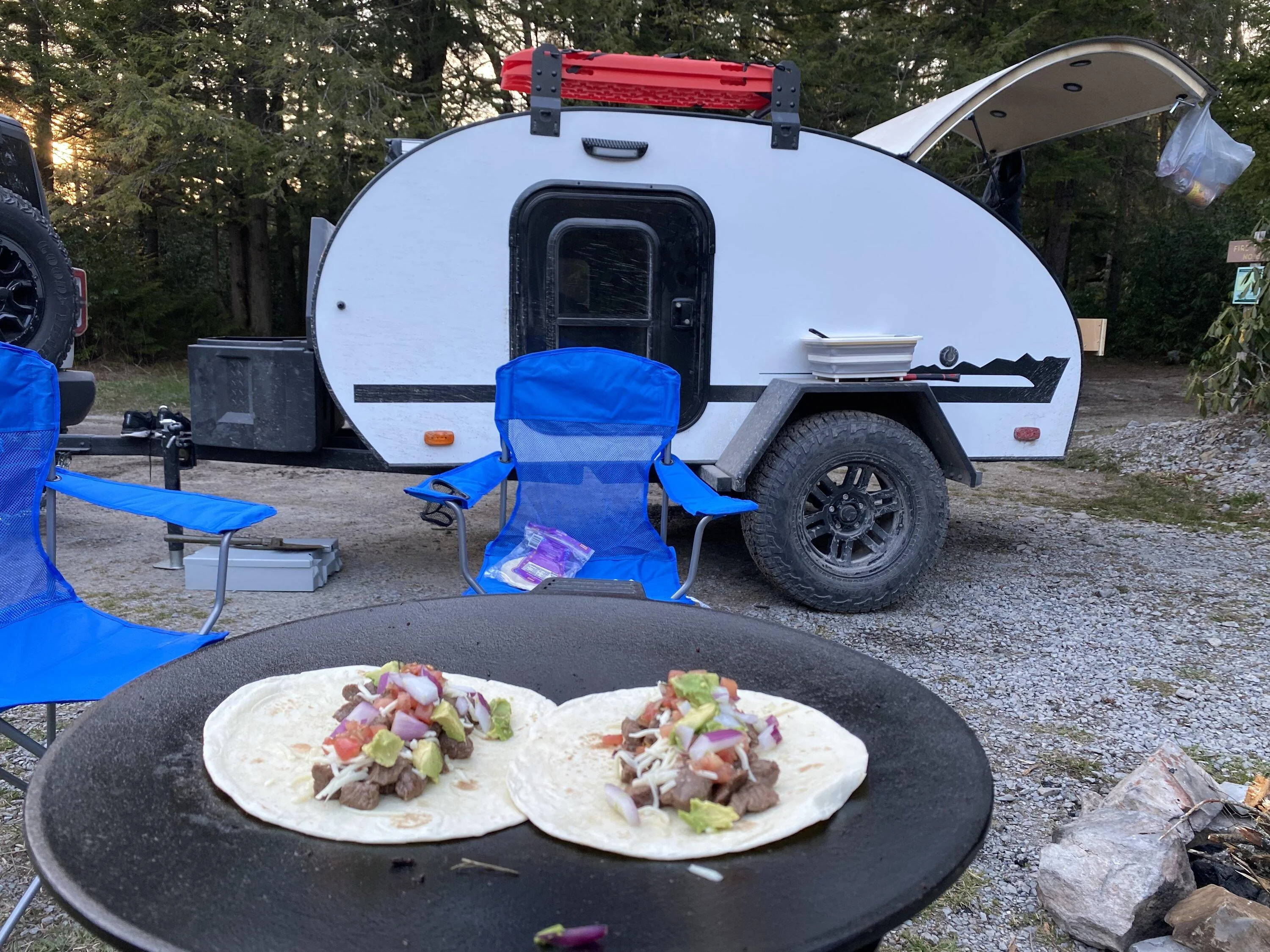

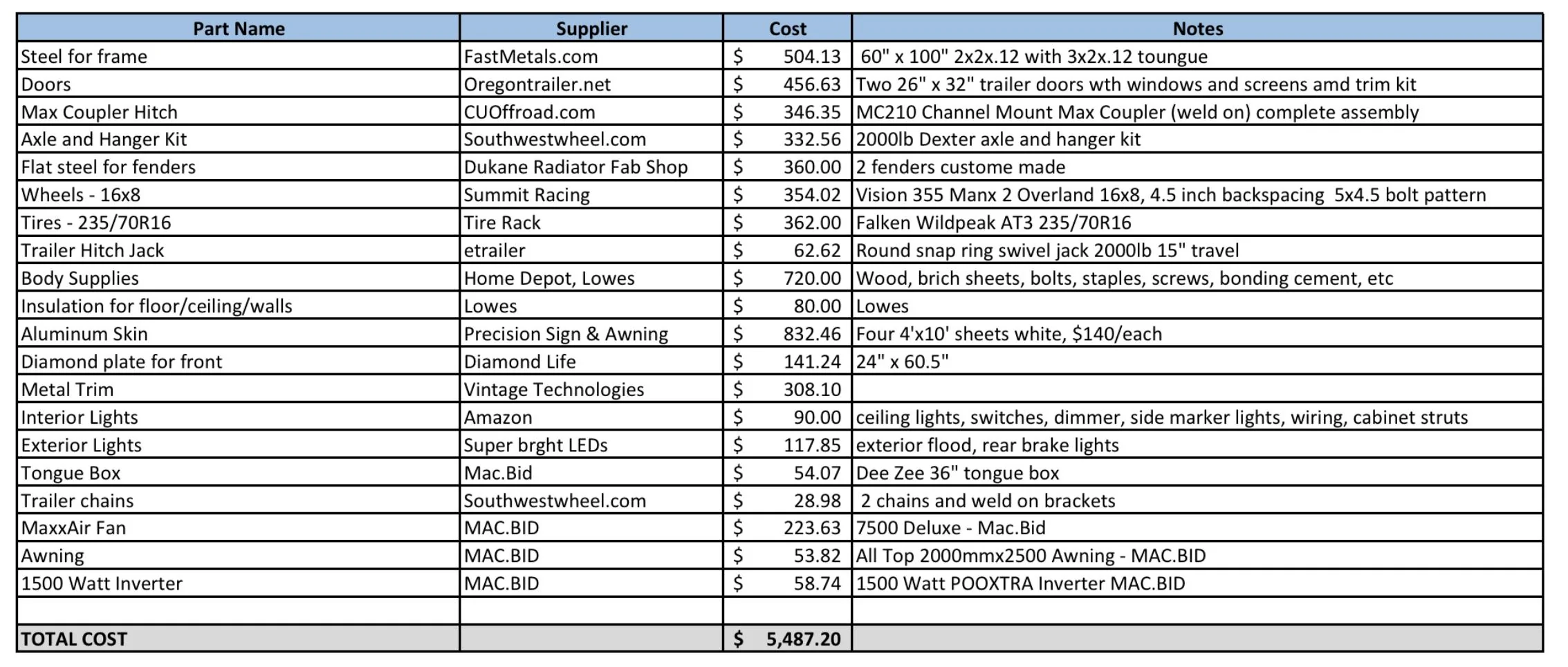

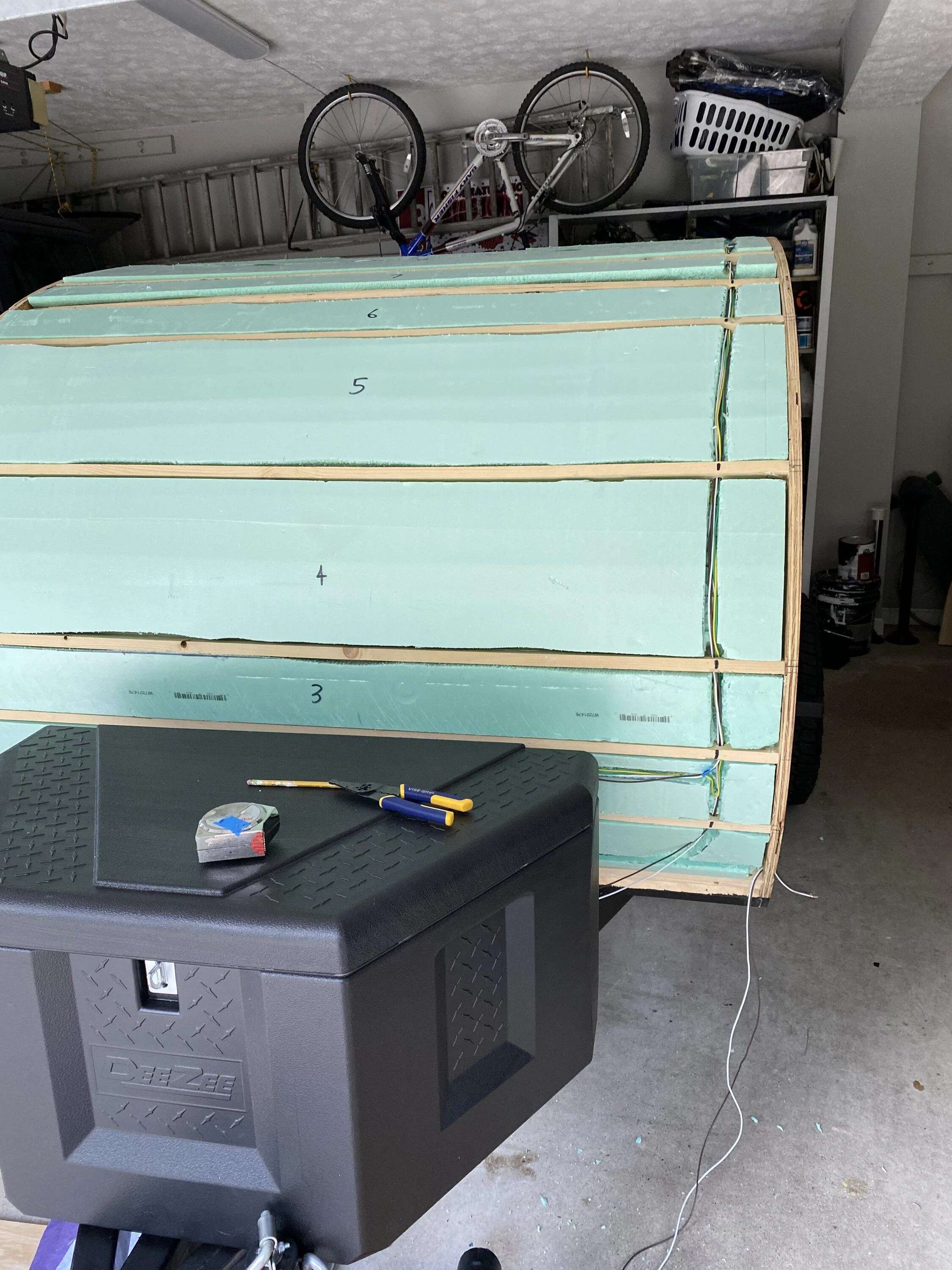

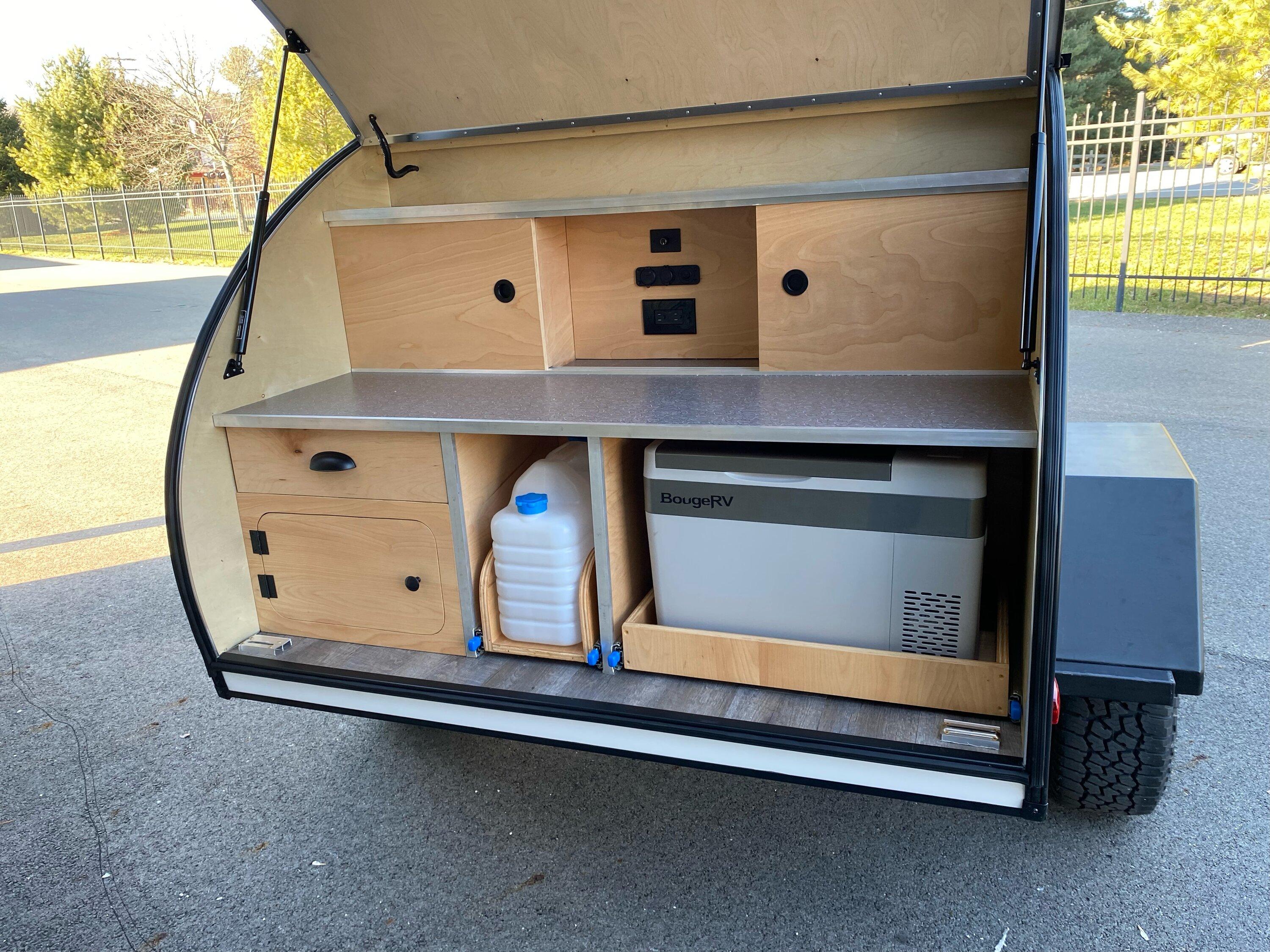

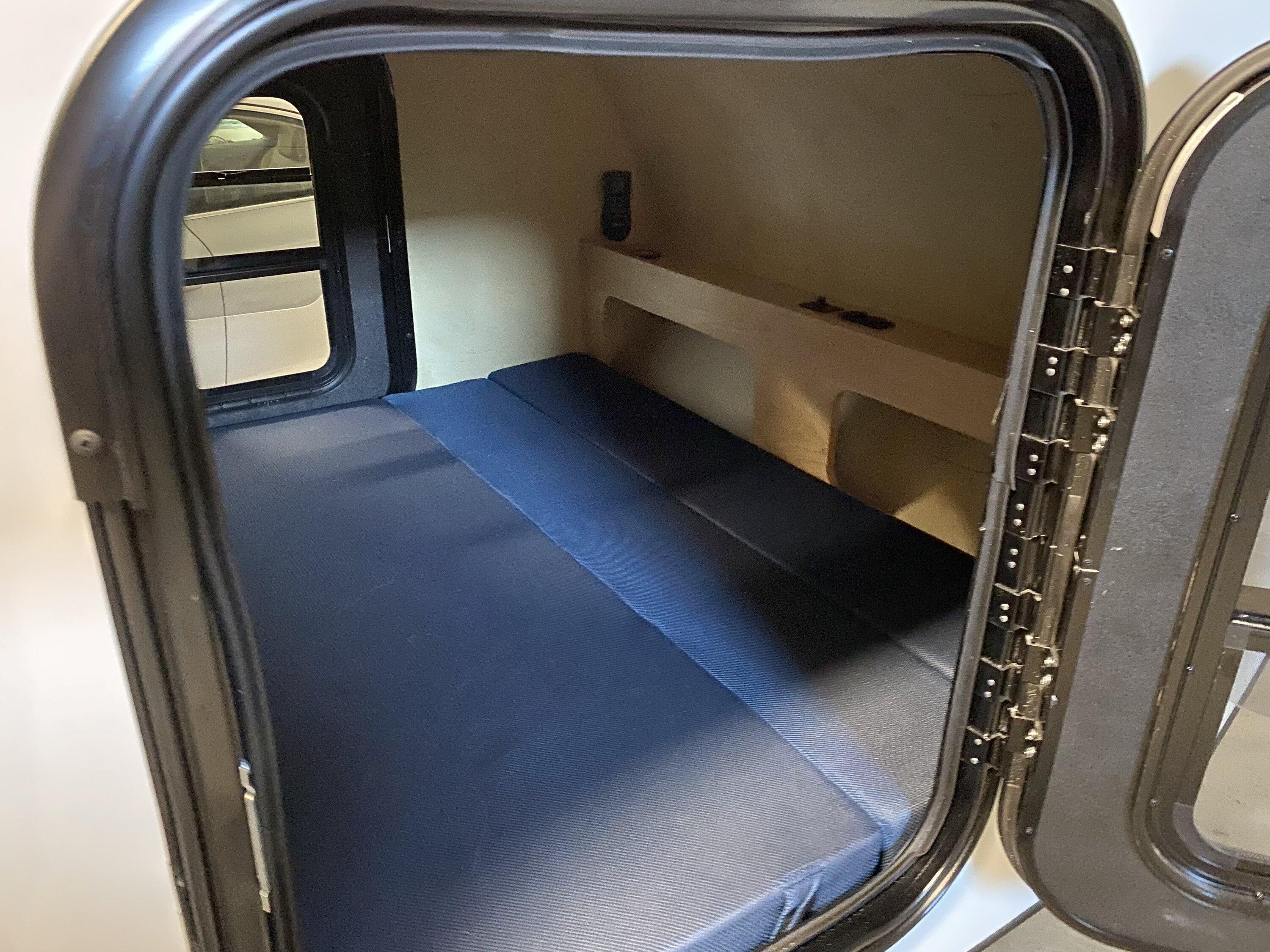

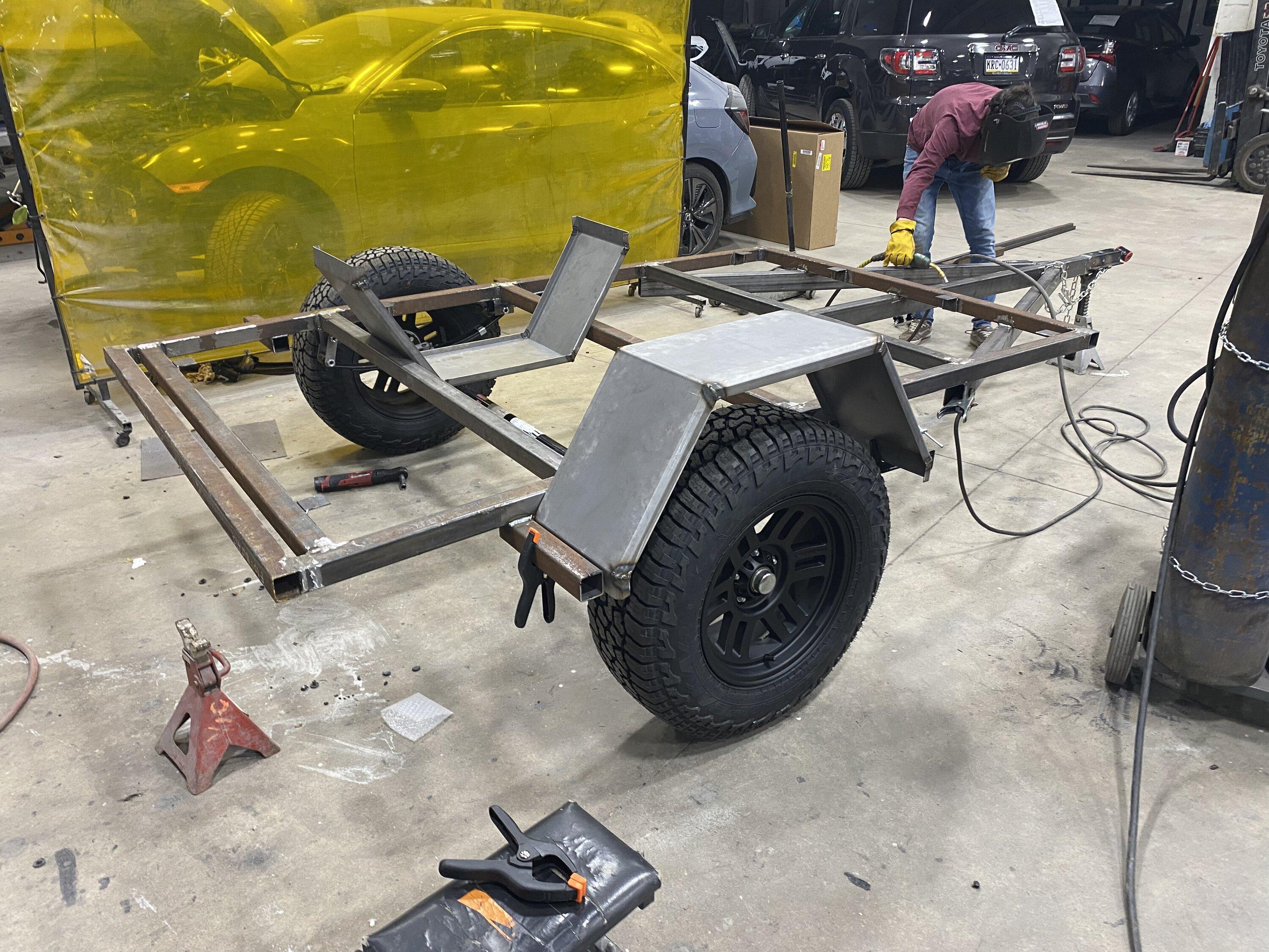

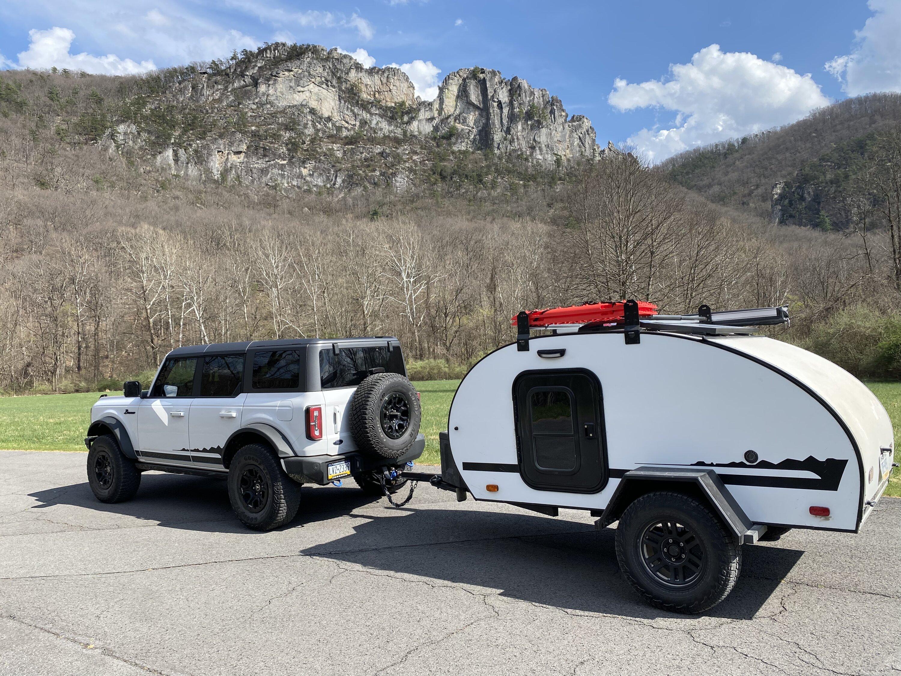

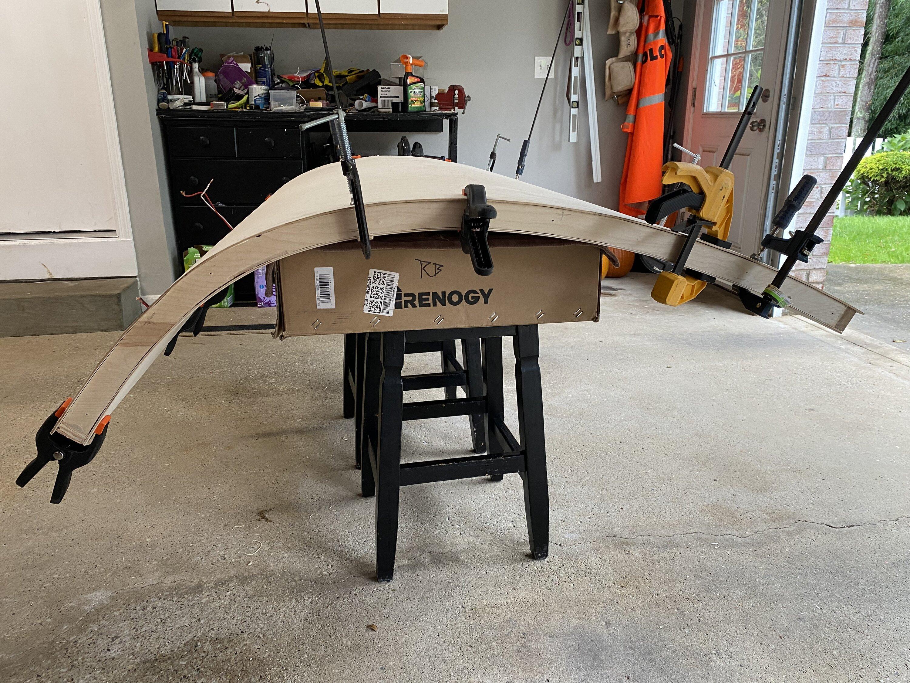

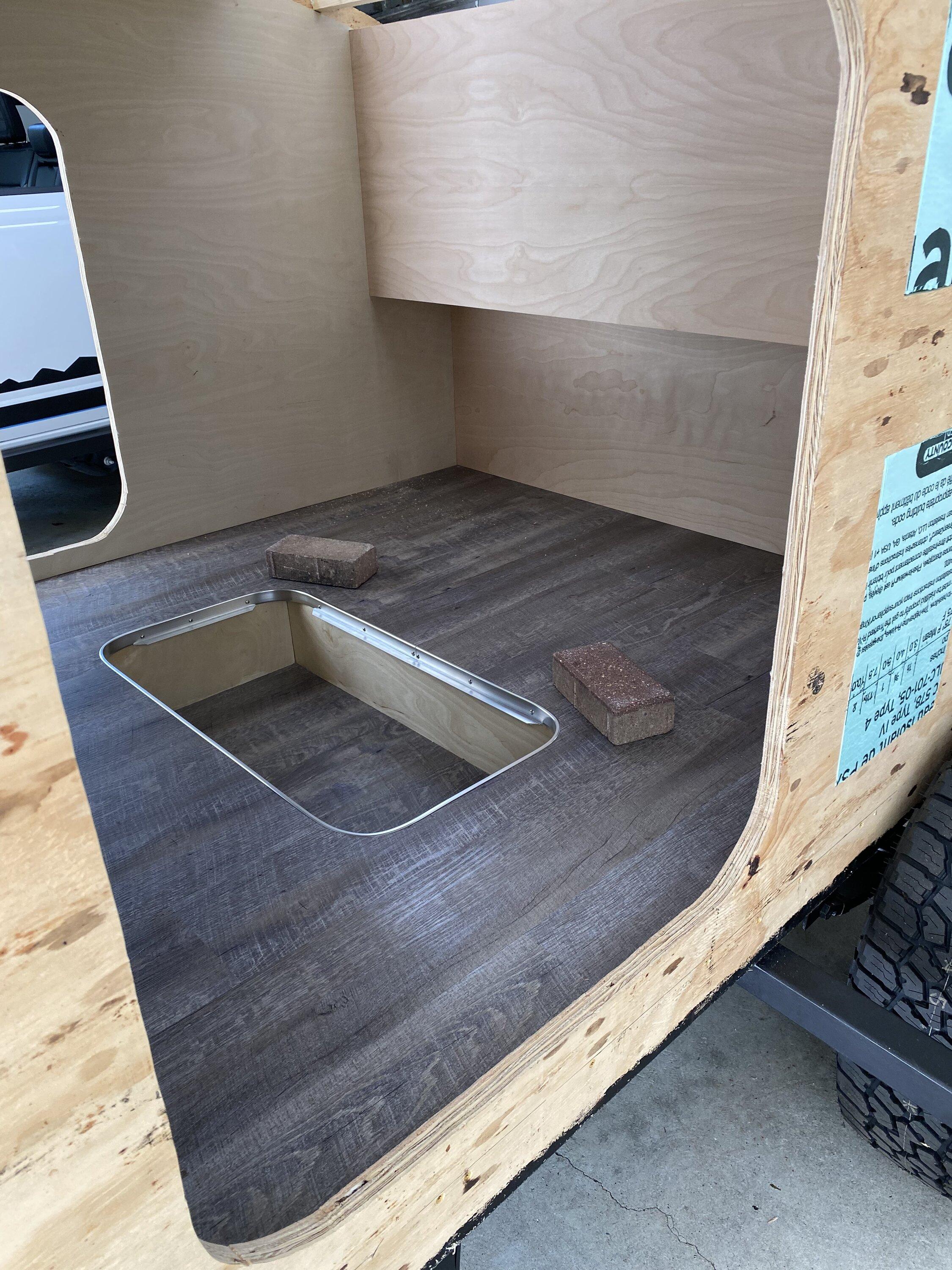

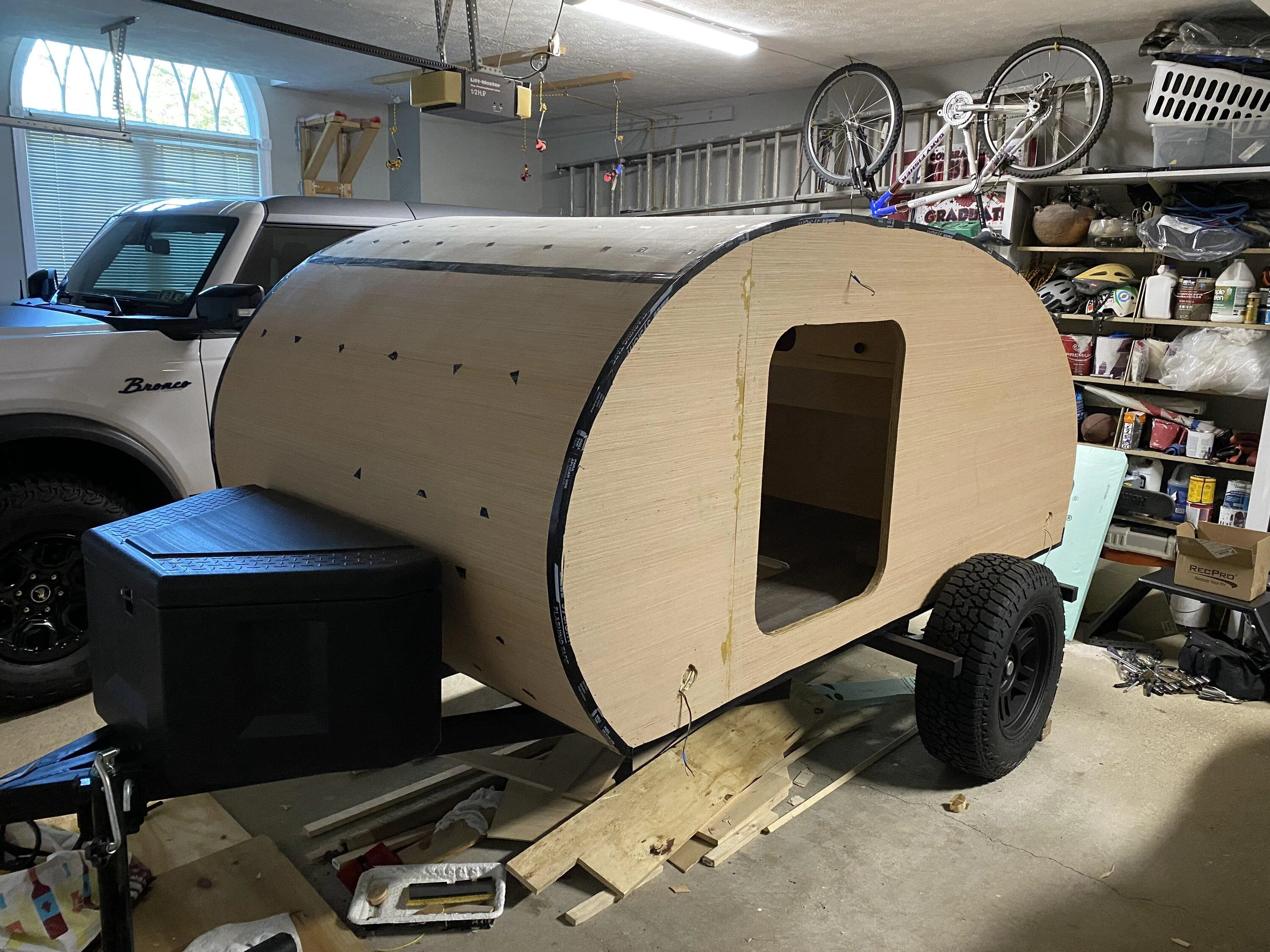

Hello B6G - I got my 2021 Wildtrak back in November of 2021. We love exploring the outdoors and camping so about 3 months after getting the Bronco, my son and I decided to build a teardrop trailer. My son’s an engineer and we’re both pretty handy so we decided to build instead of buy. Unfortunately we both have day jobs so it took us about a year, weekends and odd nights. But it was blast and something we enjoyed doing together. Now we get to use it. Below are the specs and what we did and some pics.
Empty weight is 1400 lbs. Cabin is 9.5’ x 5’, total length with tongue and hitch is 12.5’. Has queen mattress which folds to couch, roof rack, awning, solar, inverter, lights/fan, full electric and galley area with fridge, water and storage.

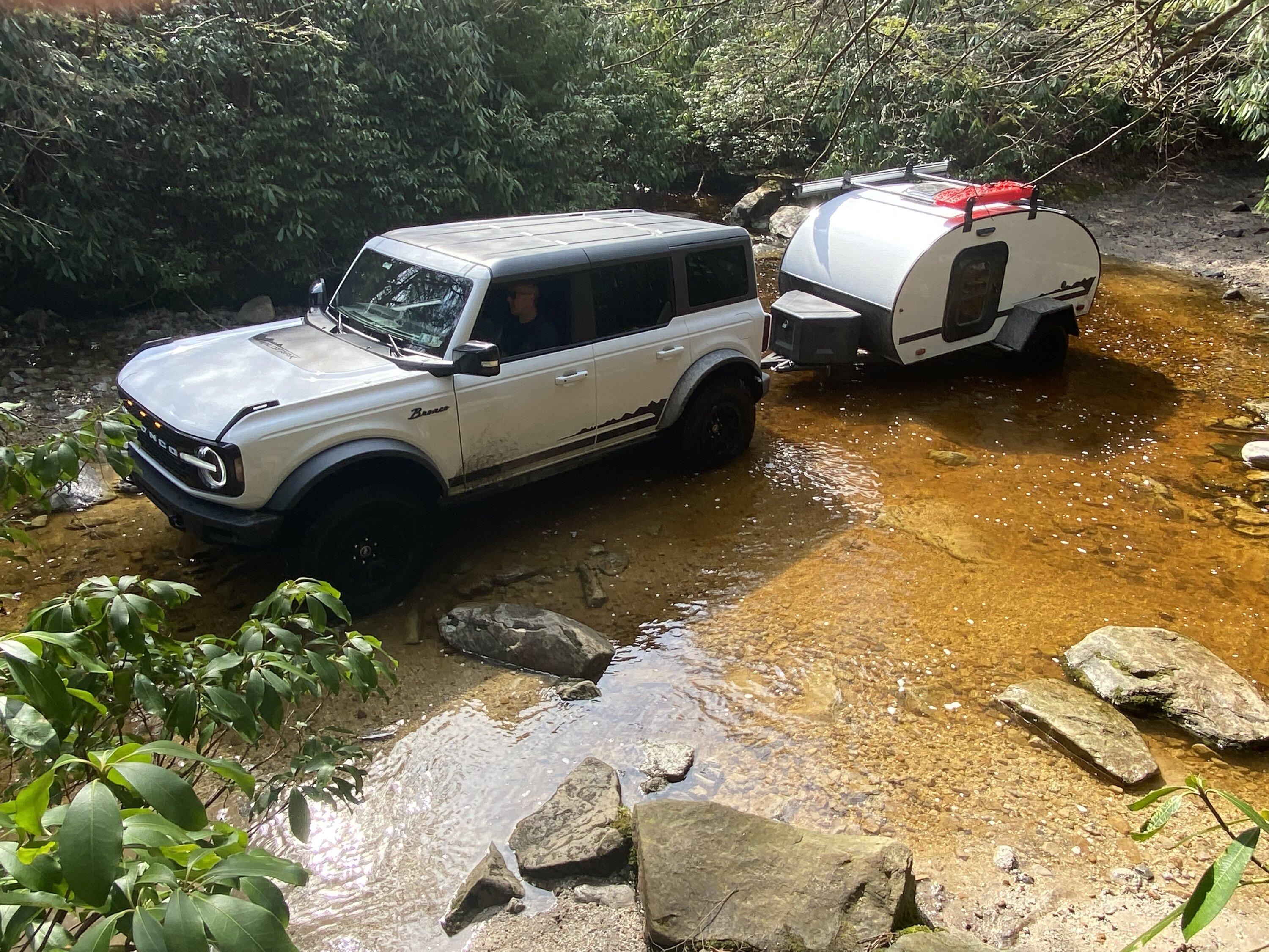

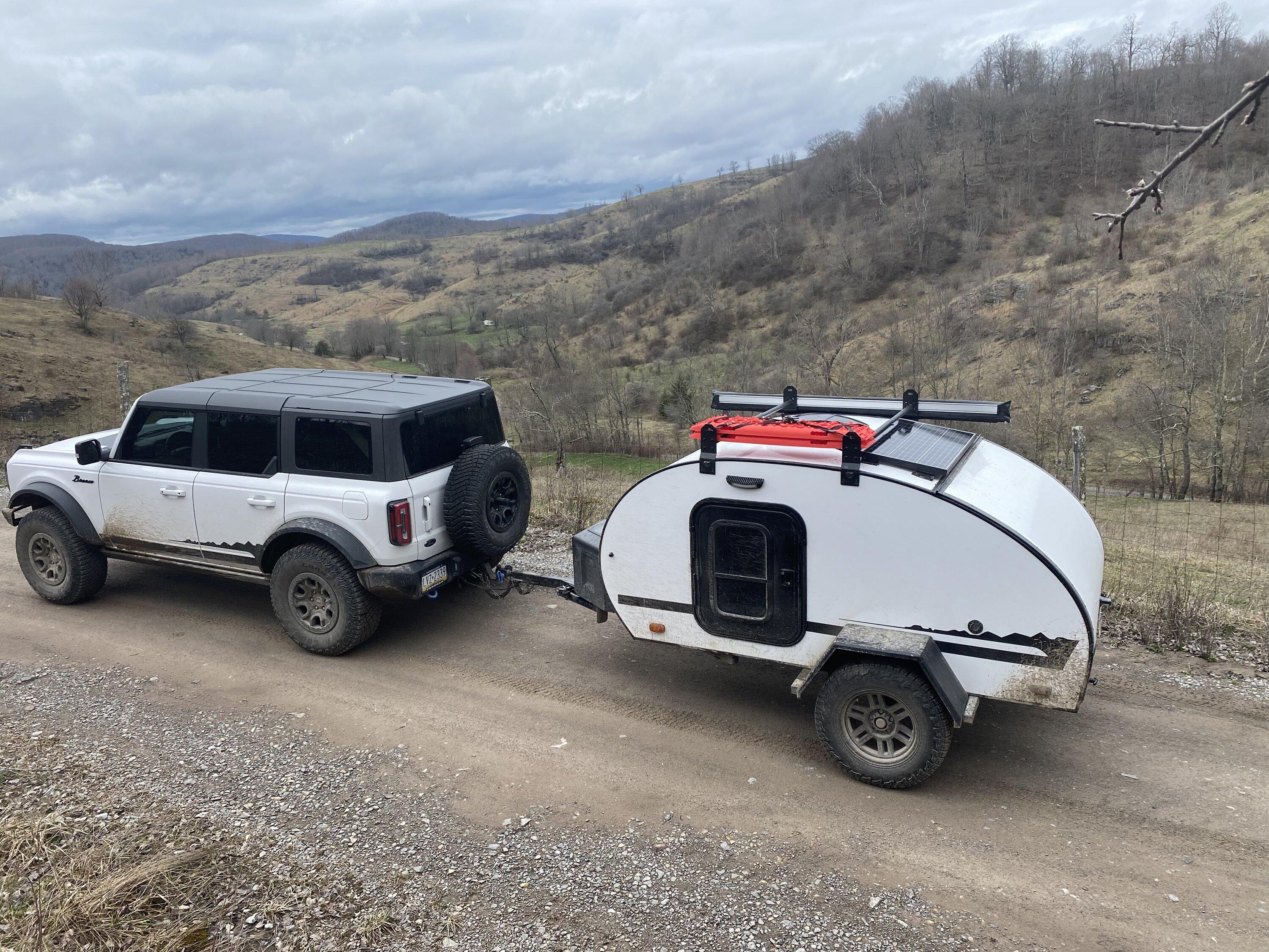

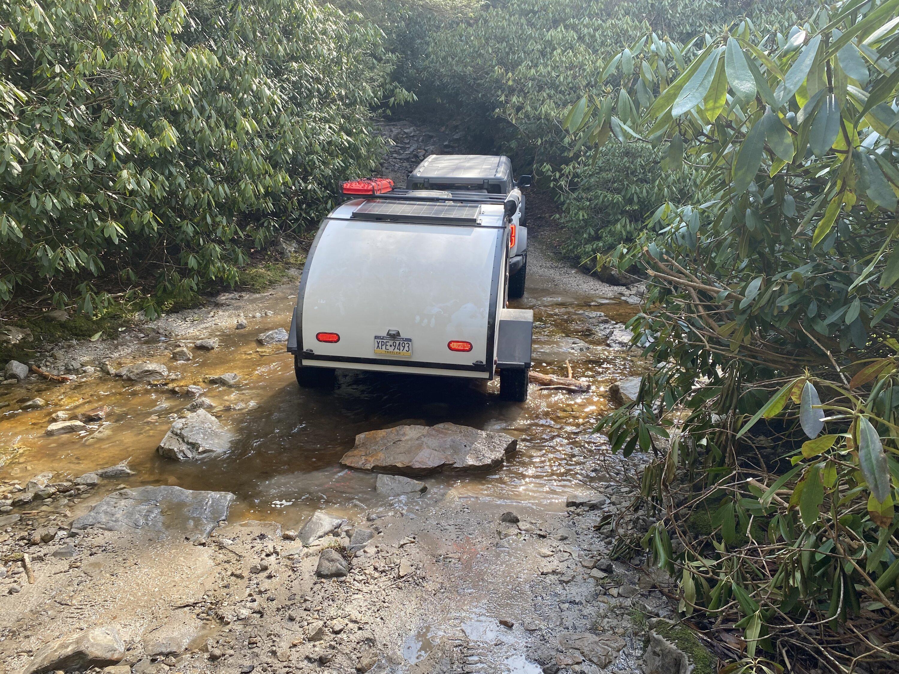

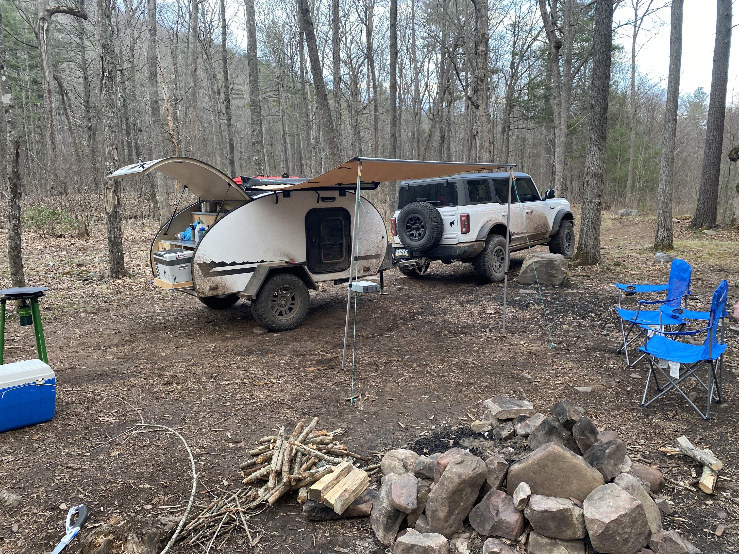

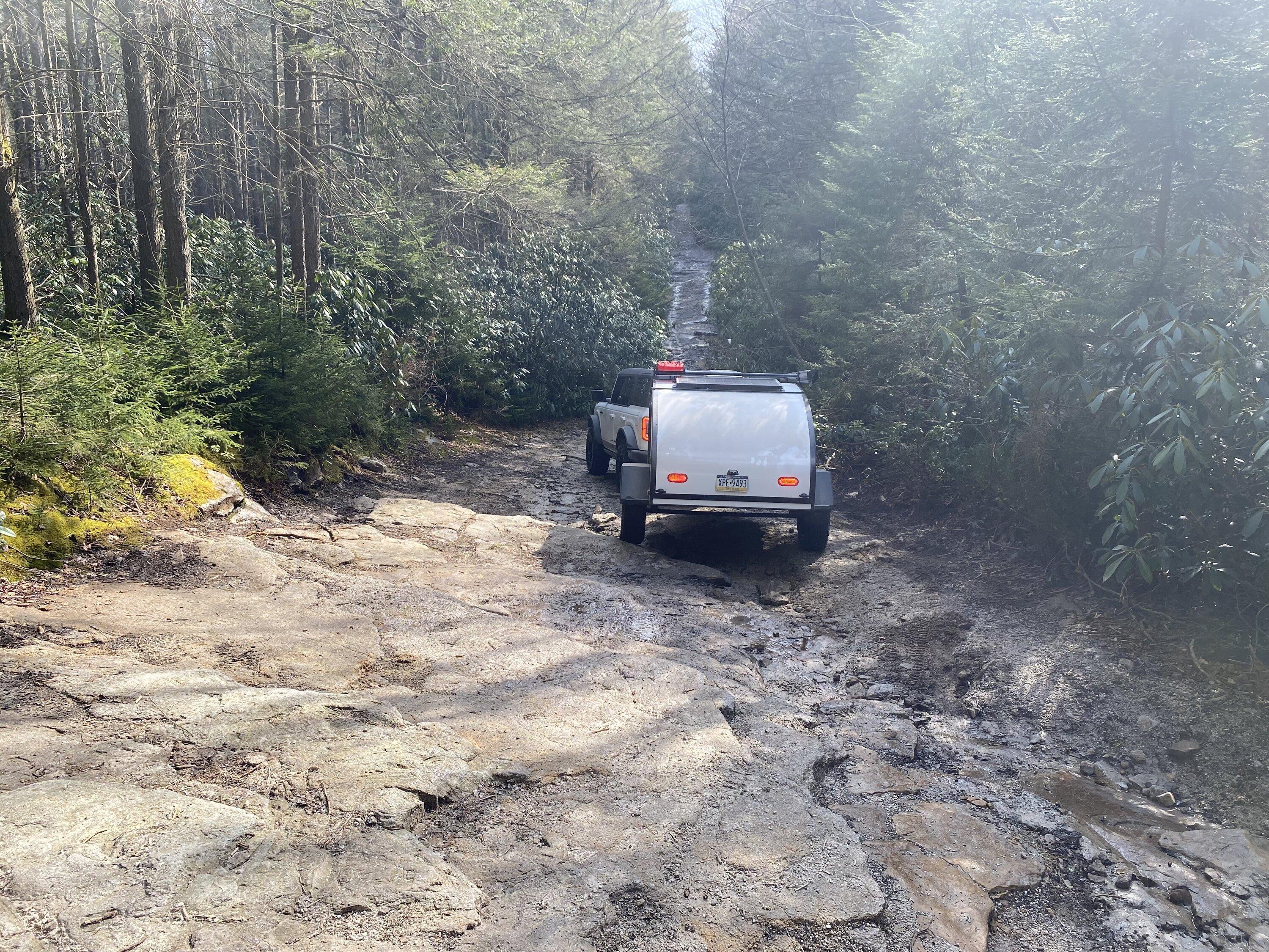

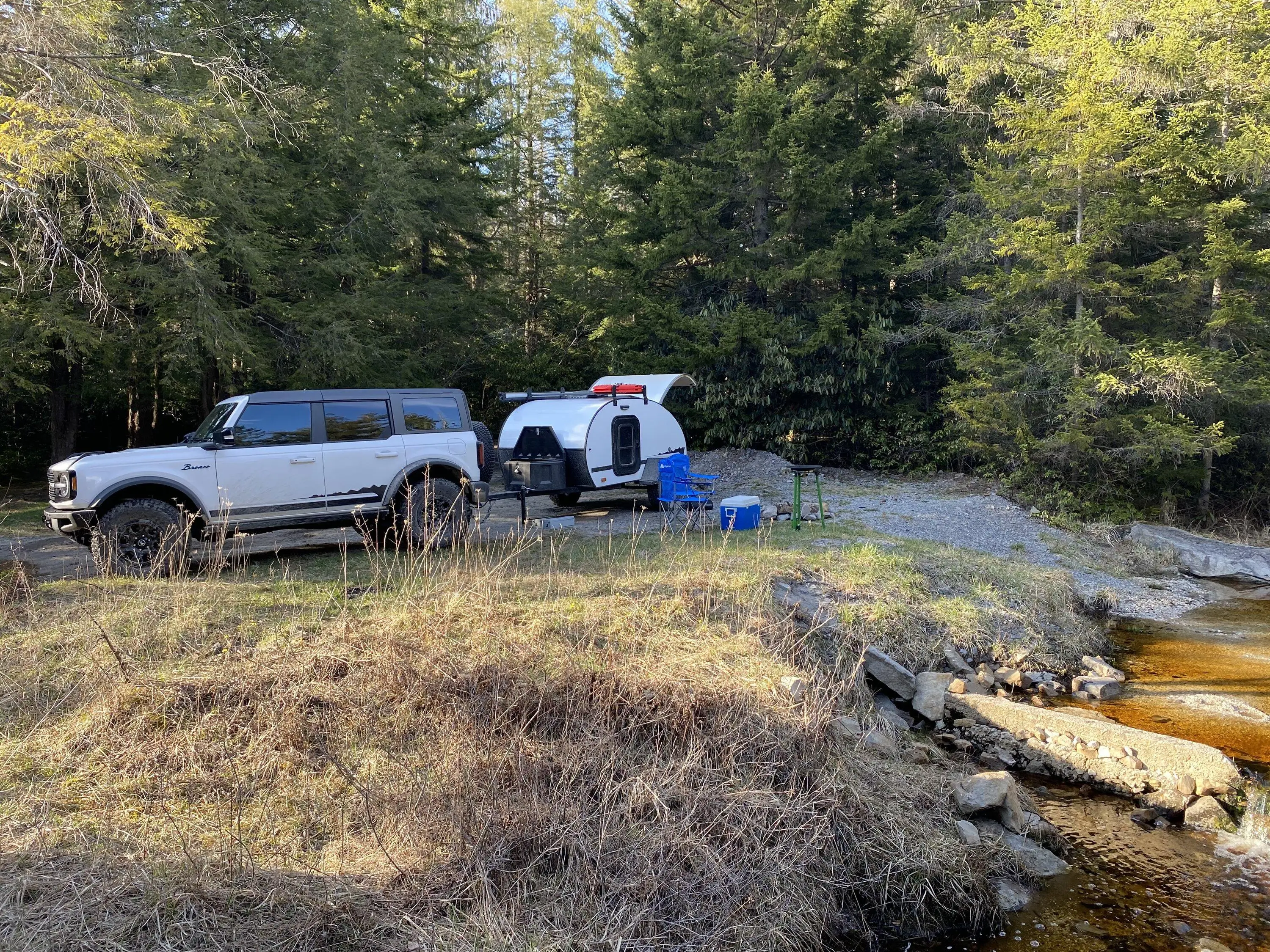

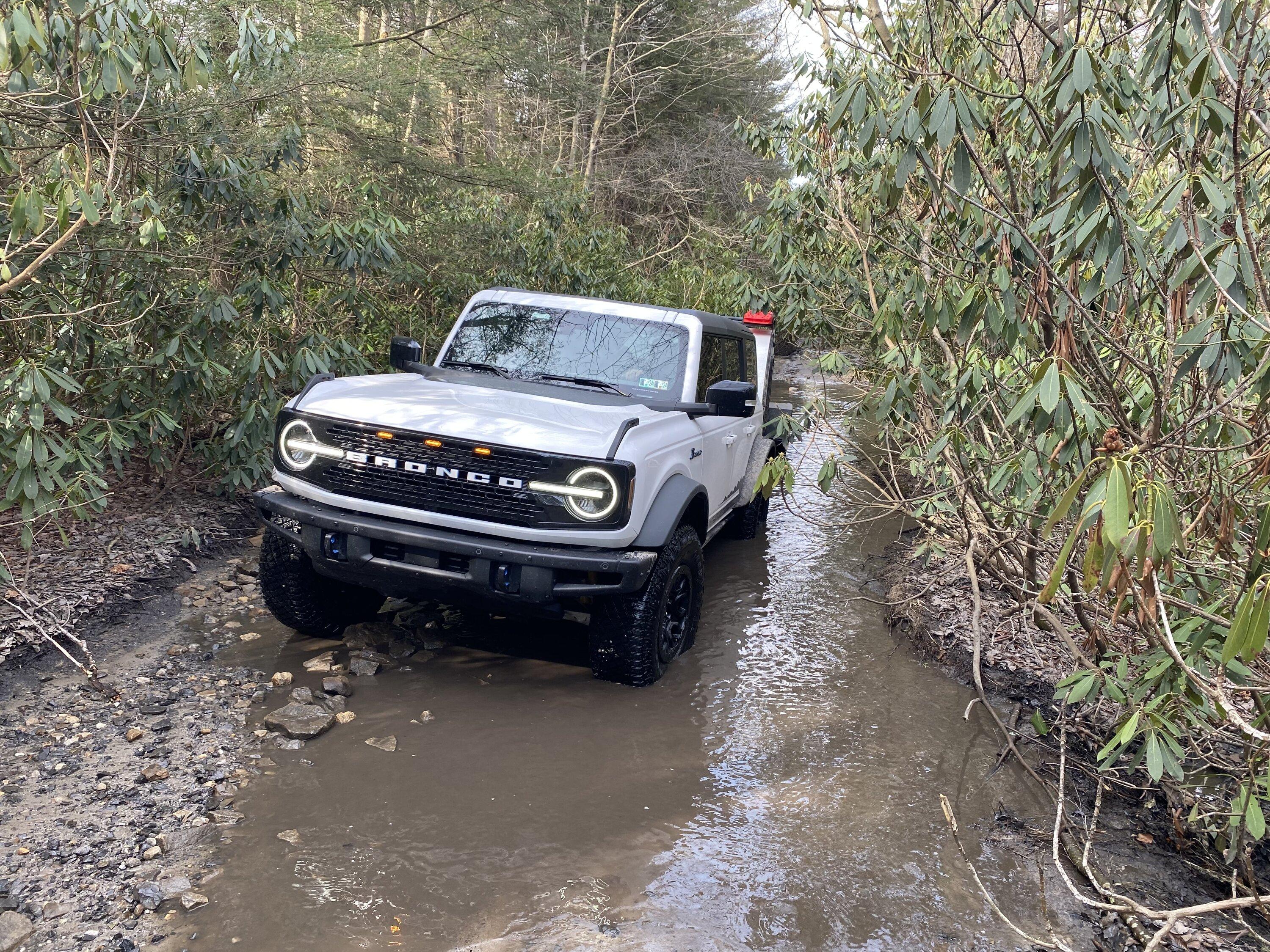

So, for our maiden voyage we spent 5 days and 4 nights in the Monongahela, Shenandoah, Washington and Jefferson National Forests in WV and VA. This trip was awesome and we truly field tested this thing. We did 700 miles total and at least 300 were off road trails and Forest roads. This thing did amazing and we bounced the crap out of it. We explored, climbed fire towers, went in caves, hiked and climbed mountains and camped in only dispersed back country areas. We are now planning our next trip, hopefully out west.

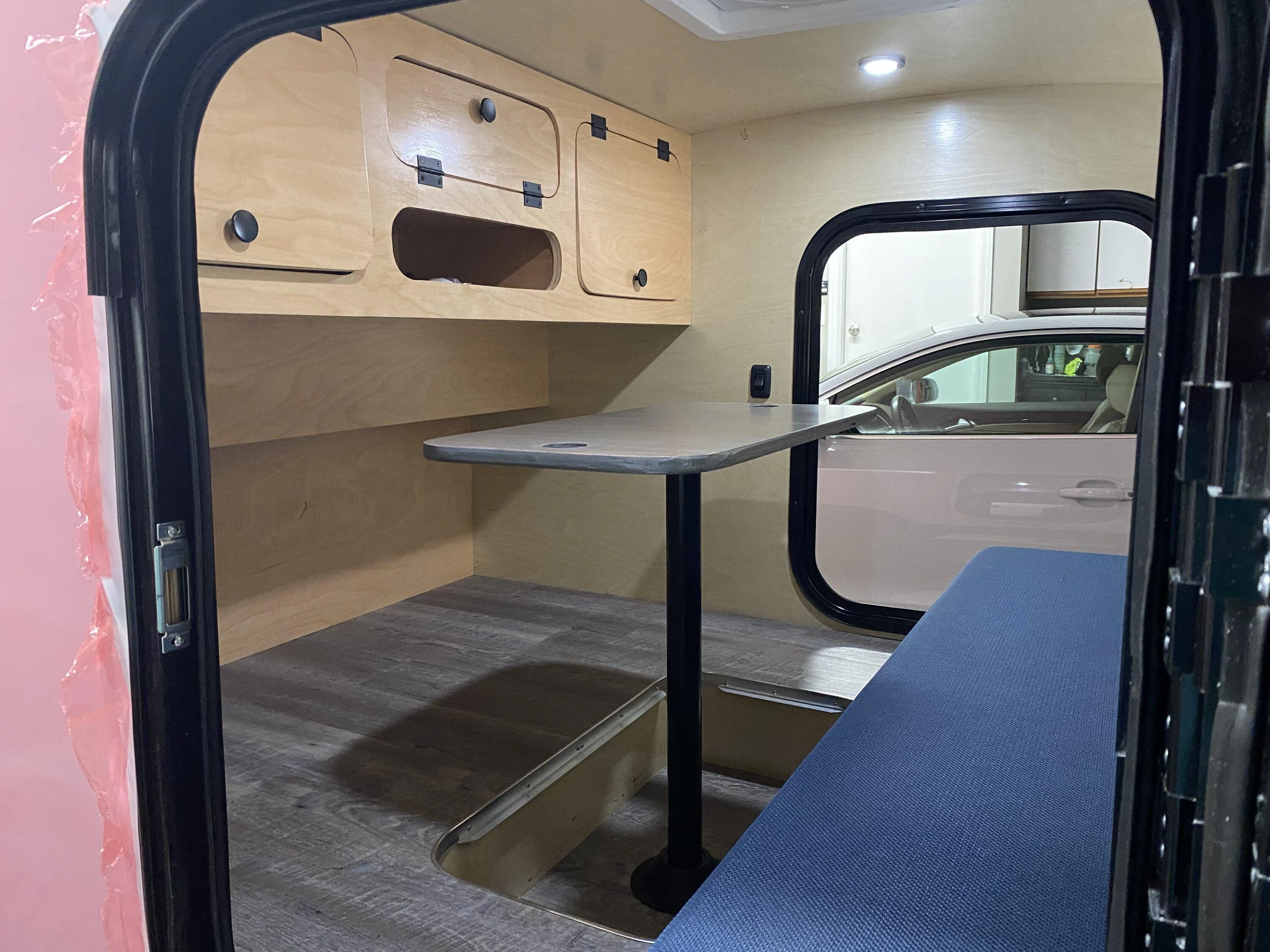

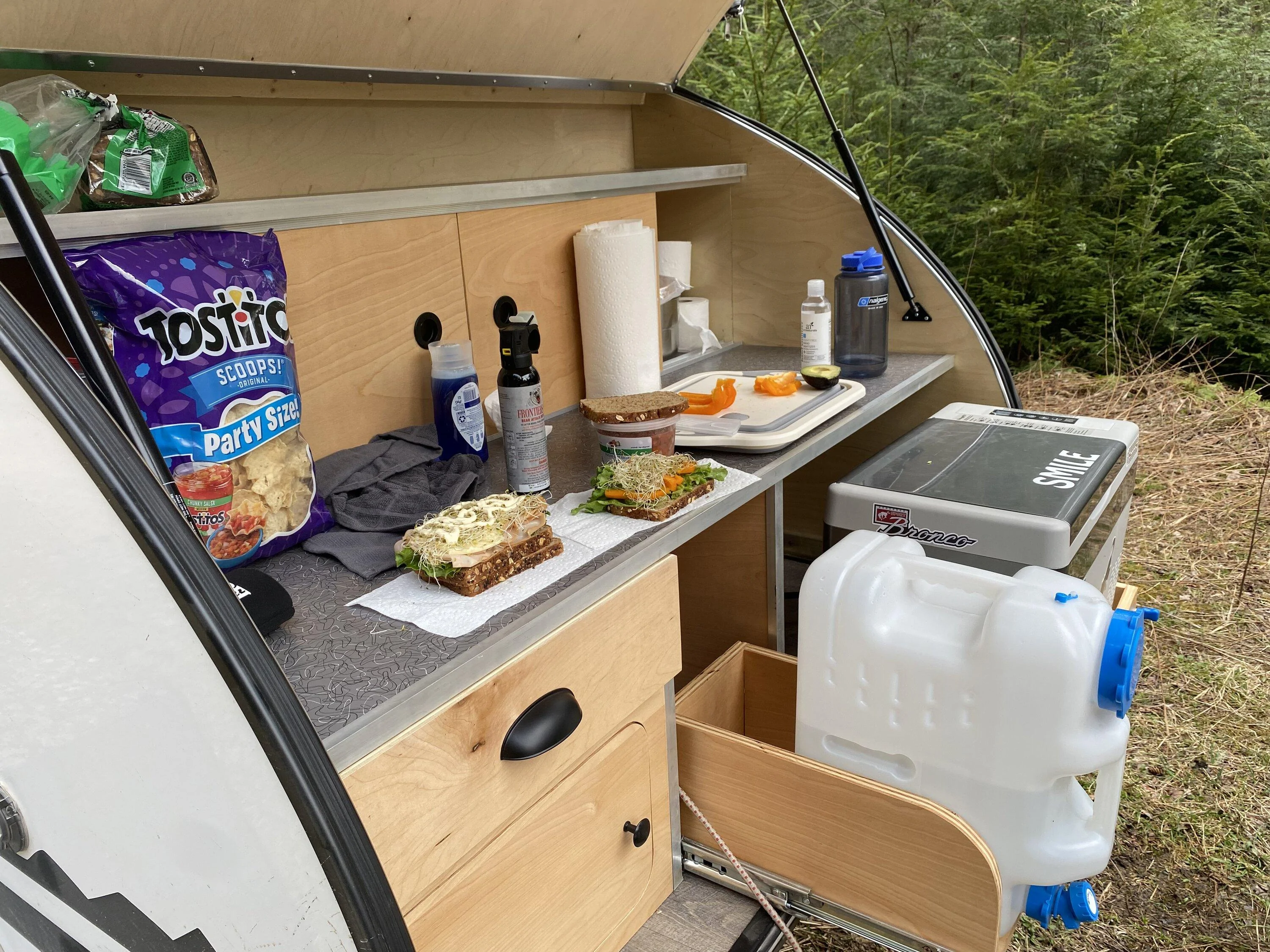

Incredible build, like the table inside. I just came back from a road trip with my tear drop and f150. Way to go.
Yeah, the table and compartment under the cabin is great. We finished the frame and then we saw one online with the pop up pontoon boat style table and we said, we gotta add that, so we did.
