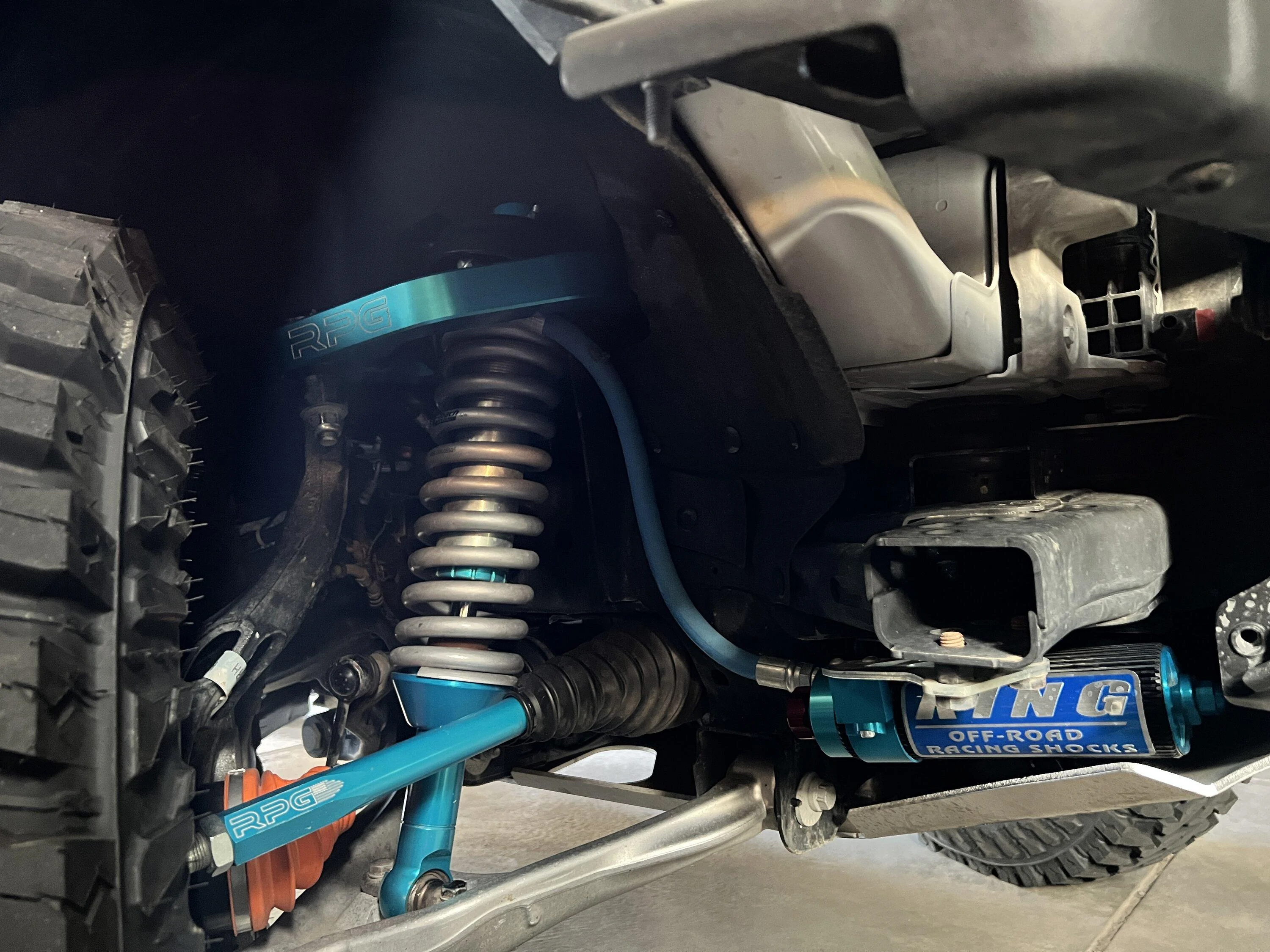

FYI, another RadFlo user mounted his reservoirs similar to yours and was rubbing them on full lock. Not sure what wheel / tire combo he was running but something you may want to double check.
Edit. I am not sure his new mounting location is any better.

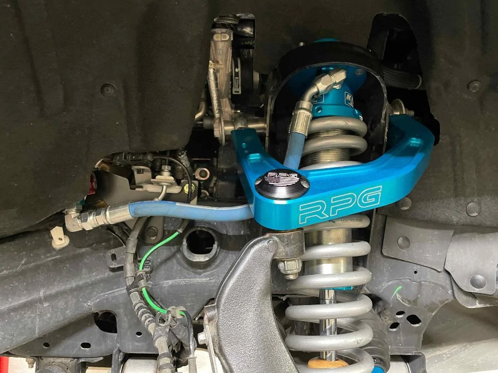

I have the King adjustable coil-overs and had the external reservoirs mounted behind the front bumper similar to the Radflo. I've since relocated them to the rear of the vehicle tucked in behind the wheel well liner, similar to how Fox does their installation. I had no clearance issues with 35's w/ 0mm offset wheels. However, ran into an issue when upgrading to 37s. There is also the added risk of damage by rocks/obstacles at approach.
