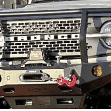

and exposed cable???
Their design makes the fairlead the most forward part protecting the cable from rock rash.
Some clarifications, sorry I was not more clear before.
The video had an attachment point fail, because they used the wrong type of attachment. Even if one only had the syn rope loop attached to the subpar drop hitch the exact same thing would have happened.
By exposed, I mean to weather, not impact. And, that is a stock photo of the bumper I have ordered; I would never run exposed syn cable like that. In 4ish months when my bumpers arrive I'll post a pic below..... I was hoping no one would notice that!
