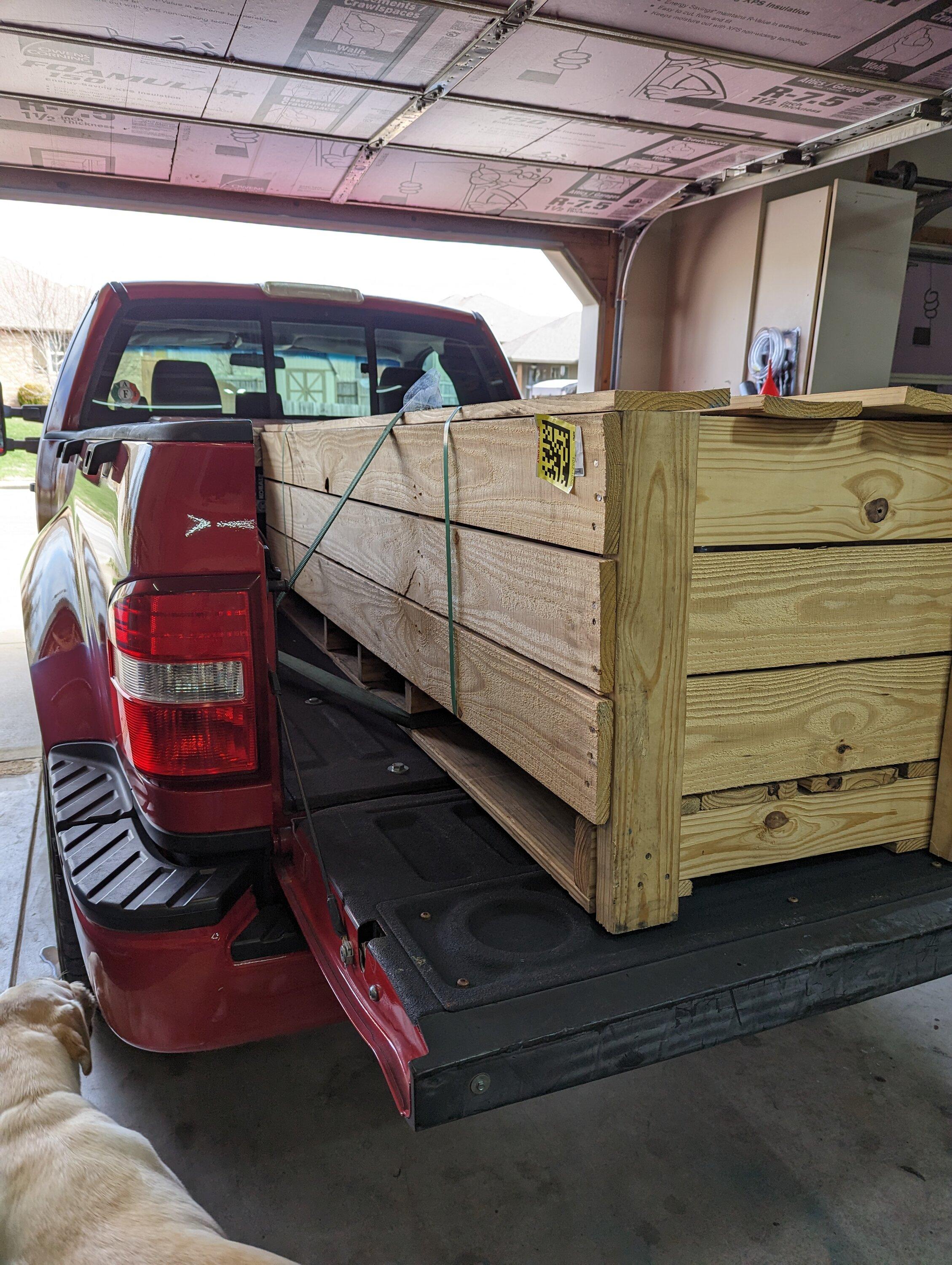

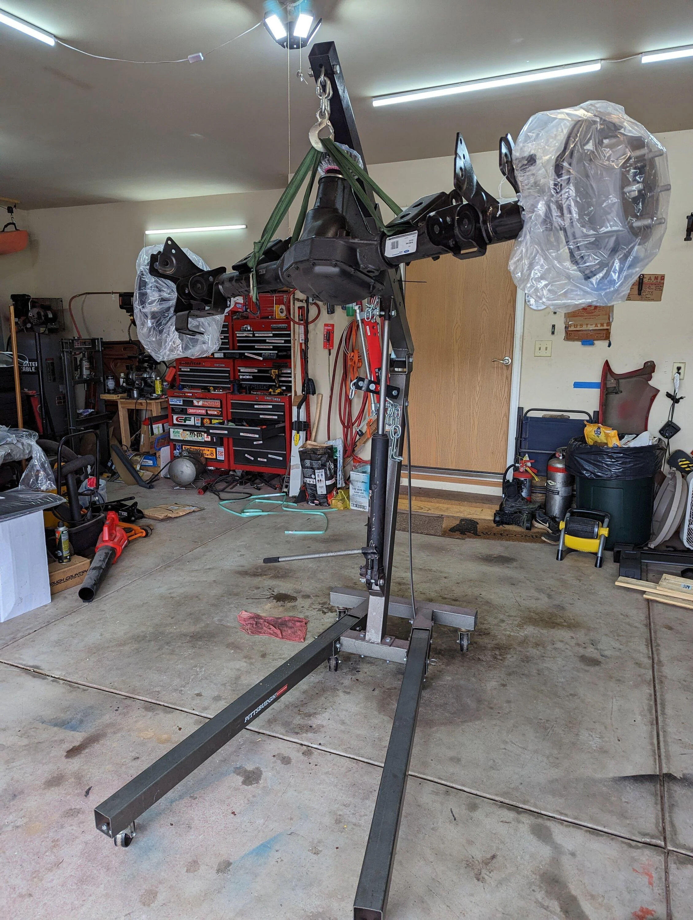

I ordered my axle online and had it delivered to my dealership for pickup. With the help from a forklift we were able to slide it into the bed of my 1/2 ton and off I went. Being that I live in the city I didn't have access to any machinery to help me unload the axle when I got home. I did have an engine hoist so I used that to help me unload the axle from the crate.

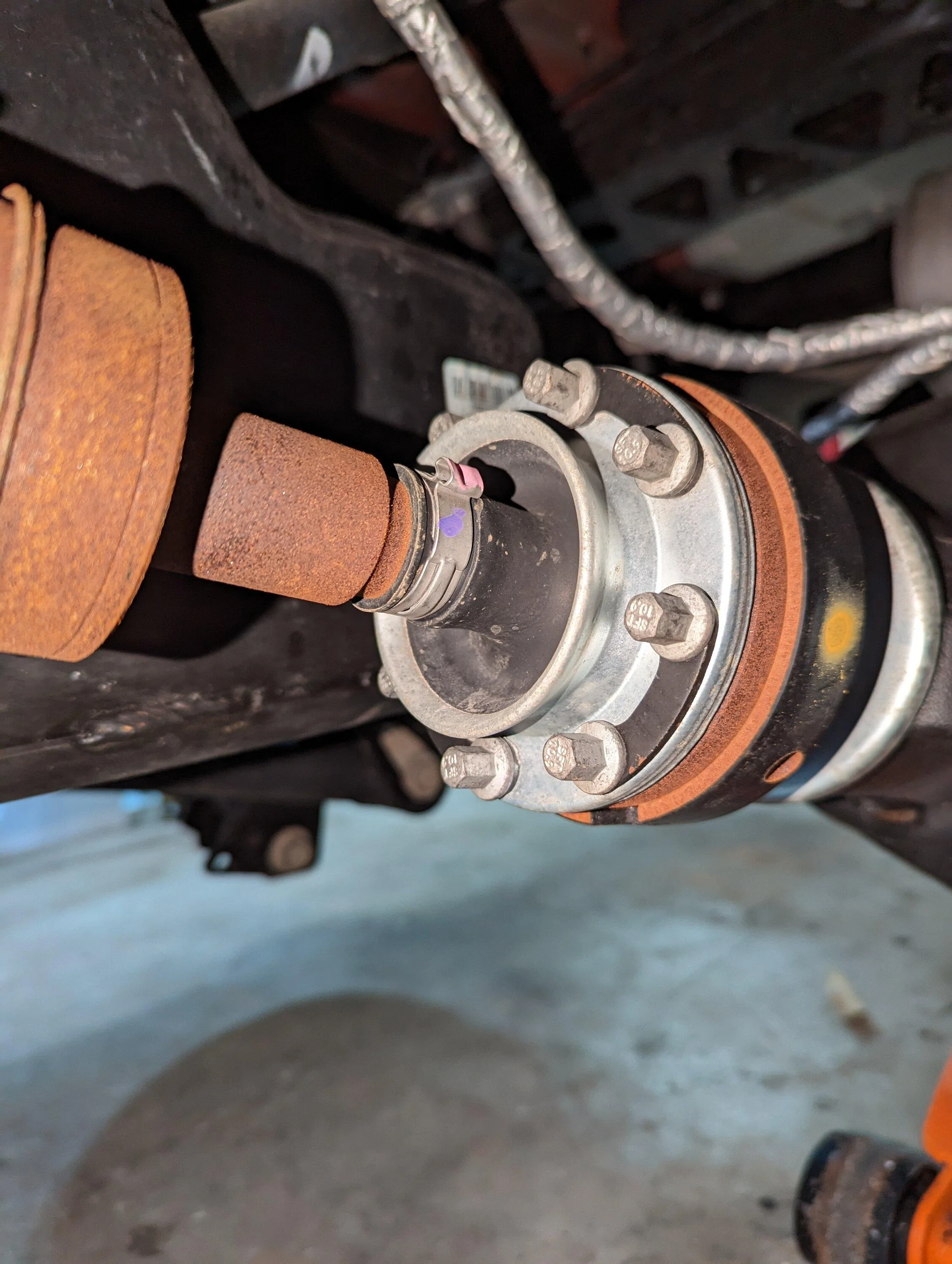

Next was unbolting the drive shaft, which was a bunch of bolts through a flange on the axle. Ford recommends that these bolts be a one time use and after the swap I tend to agree. I will provide a link for the bolts here: https://tinyurl.com/3ufv48c8 Once unbolted I again used a string of zip-ties to hold the drive shaft out of my way.

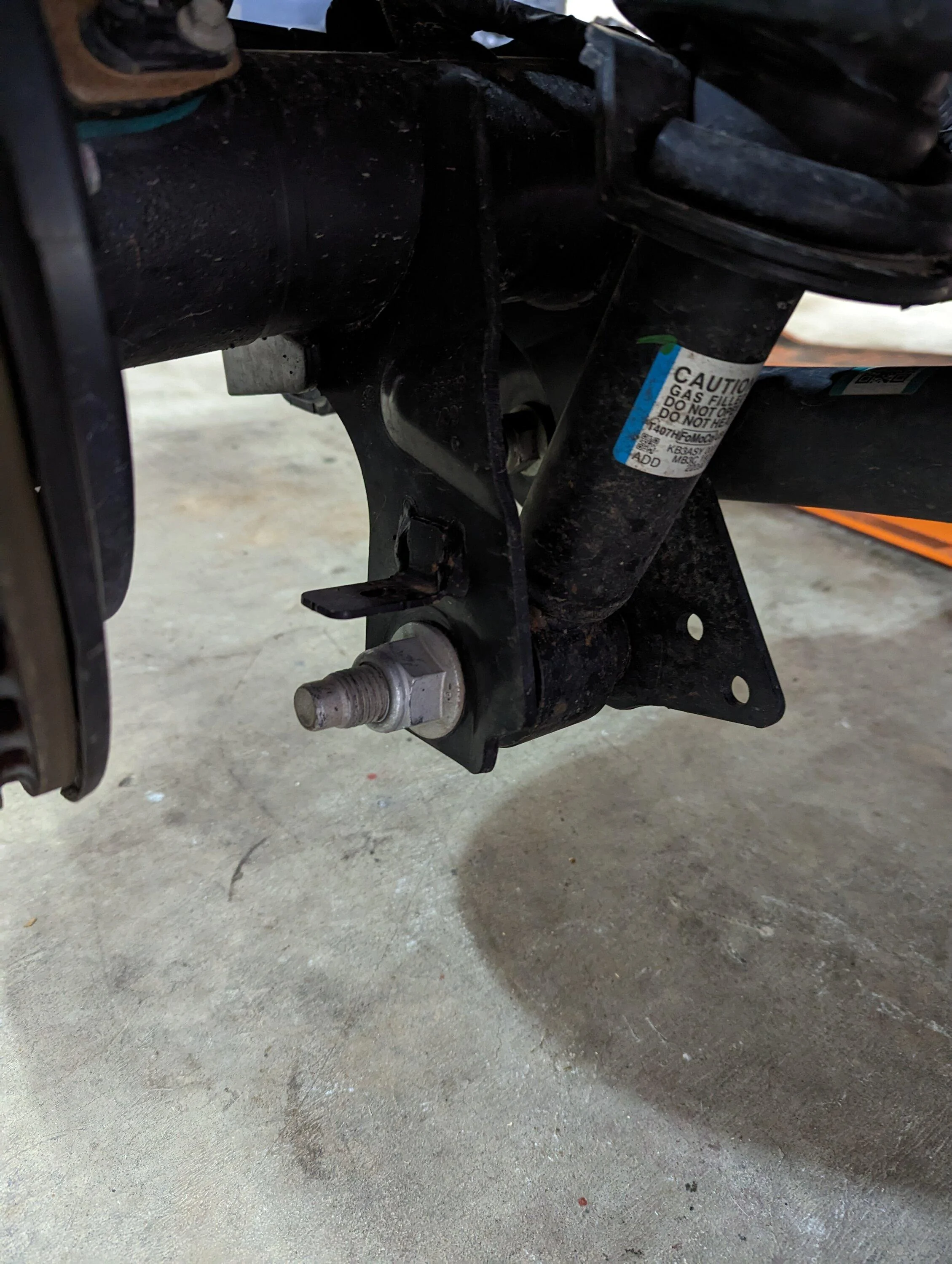

Again using a jack to support the axle, next came the worst part of the swap. Anyone who has done a suspension lift on their Bronco knows that the lower shock mount bolt is torque to 10 million foot pounds and can be a pain to undo. Ford also appeared to change up the design of the nut holding said bolt as I have seen videos of the nut having a "flag" to help hold it while you turn the bolt. Mine did not have that flag so I had to hold the nut while I turned the bolt. If you have an impact I recommend using it here, removing the brake rotor splash shield to gain access. (The right angle "L" above the nut is there to hold the "Flag" and keep the nut from spinning. As you can see my nut doesn't have the flag.) The nut is a 30mm. I only remember that as my set didn't have a 30mm and I had to make the obligatory trip to harbor freight to get one.....

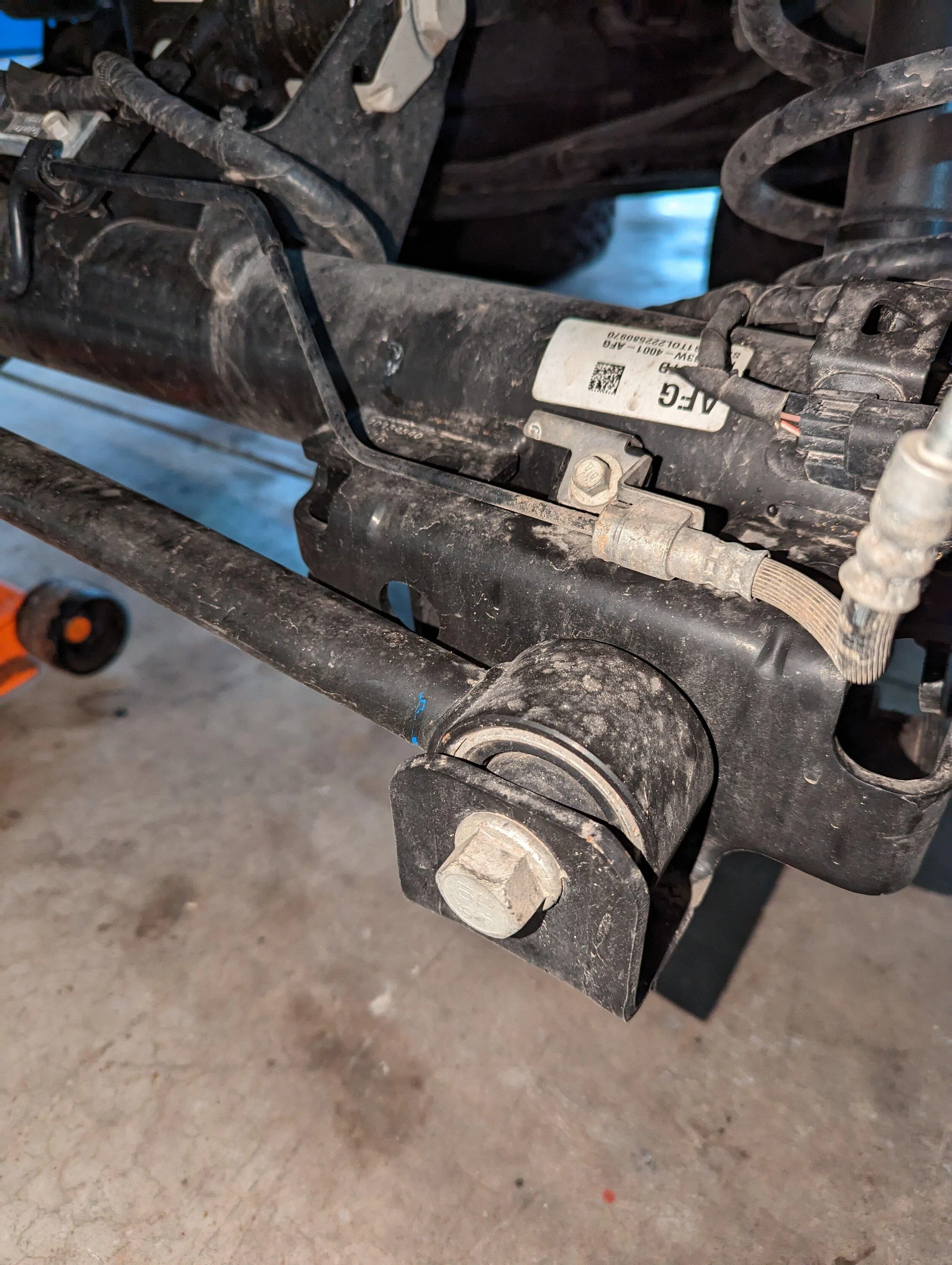

Once you have the shocks undone, the weight of the axle should be resting on the jack. I then un-bolted the trac-bar/pan hard bar what ever you want to call it. The nut is captured so it makes it pretty easy to unbolt. The axle may shift when you undo this bolt so be ready for that. On a side note, when you go to reassemble, this link might not line up with the new hole. Use a ratchet strap from the mounting point on the axle to the frame of the truck to help pull it back over into place.

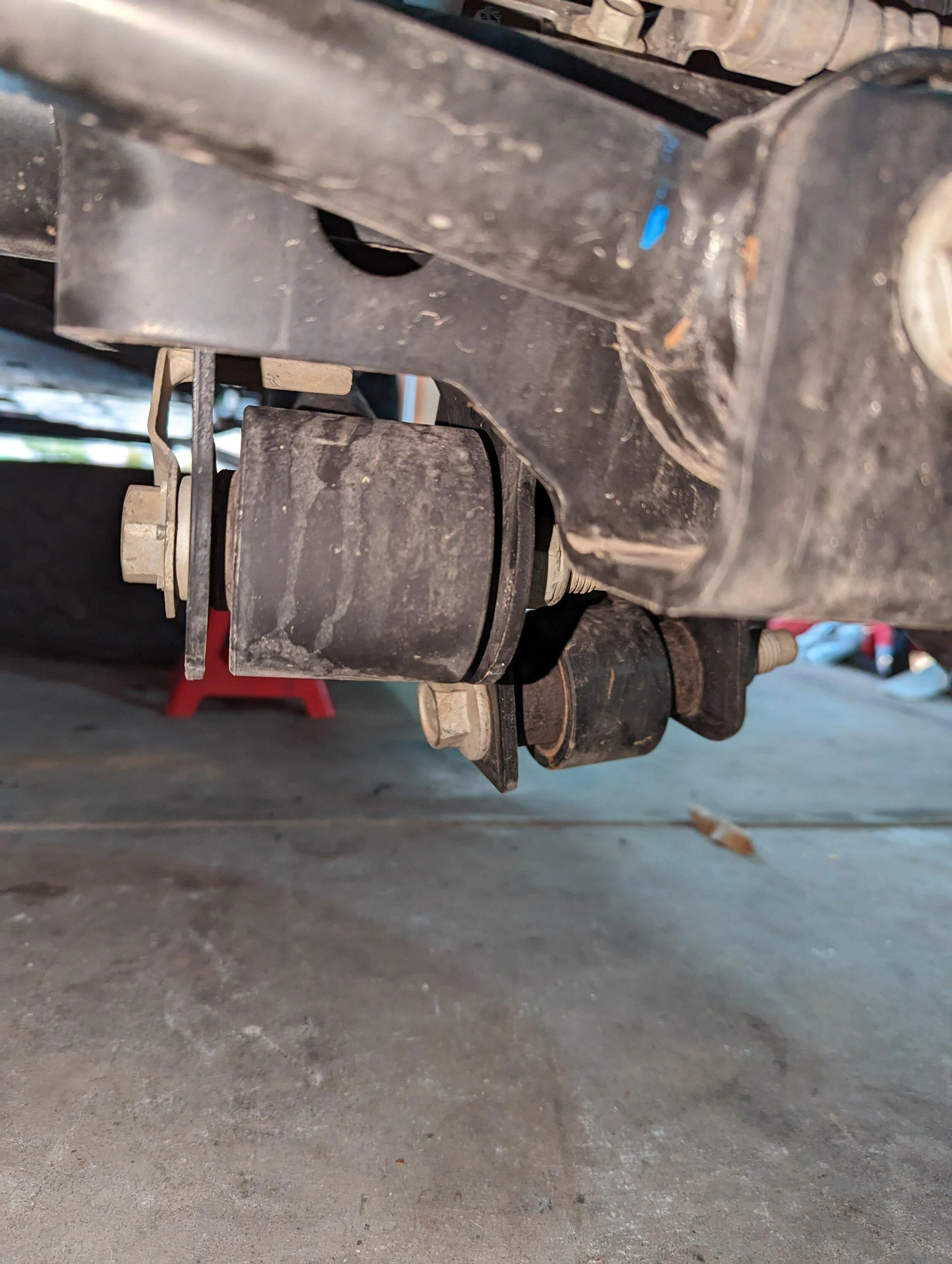

Finally comes the lower control arms. Once these are undone the axle should be ready to be lowered out and removed from the truck. If you were going to put a lift on you rig now would be the time as the rear suspension is all free hanging and easy to get at.
That is really all there is to it. Installation is simply the reverse of removal. It pays to have a buddy there to help guide the new axle back in under the truck and help line up bolt holes. A hammer and an alignment punch comes in handy getting the first few started.

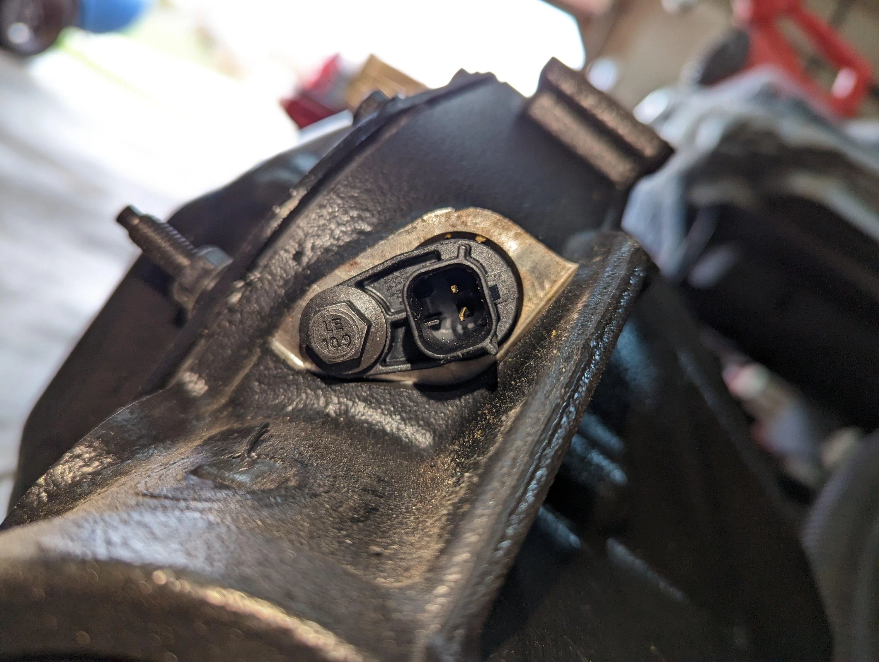

I have the factory AUX switches so I wired mine up to run off AUX 6. Using an AUX switch means you are in manual control of the locker, so it is up to you to turn it on and remember to turn it off when no longer needed.
If you refer to one of my other post about adding an E-locker, @Bmadda did an excellent job measuring out the voltages and how the computer modulates power to the axle. I was (and still am) tempted to find a way to emulate this using a custom circuit, but for now I am using 12 volts like a few others who have added their own locker. See that forum post here: https://www.bronco6g.com/forum/threads/need-help-with-my-eld-swap.69395/#post-1857568

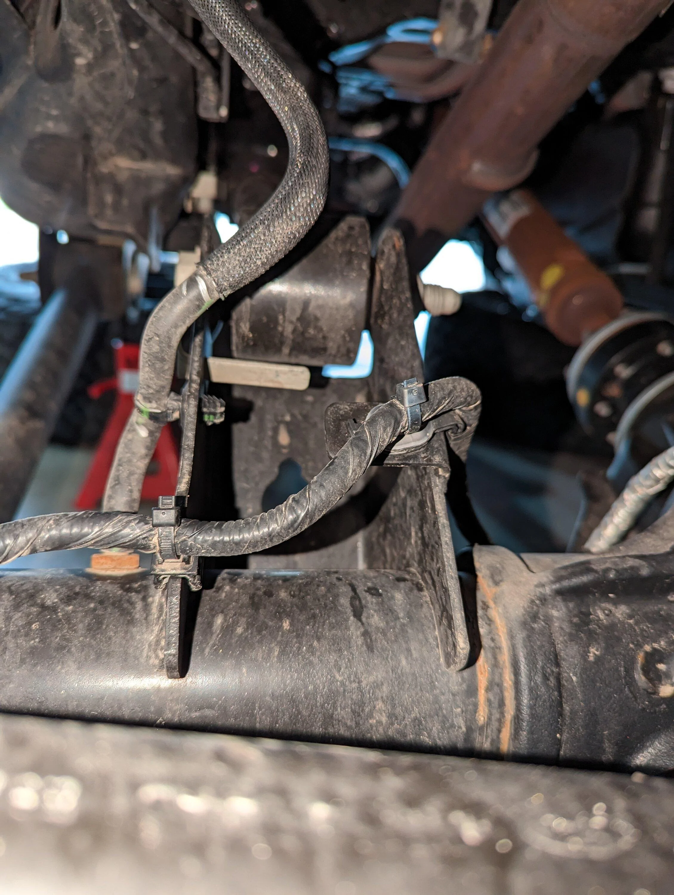

As for routing the wires I ran them down along the frame zip-tieing them in a wire loom to the factory wiring harness. When the wires approached the rear axle I wrapped the loom in heat shielding like Ford did from the factory. There is a lot of room between the wires and the exhaust so this might not be necessary, but Ford did it so I figured I probably should to.
The hardest part of the swap for me was locating the correct pigtail to plug my wiring into the connector on the axle. Fords part website is pretty buggy for me and not the easiest to use. But for those that want a new pigtail it is part number: WPT829 It is close to $70 dollars new which is ridiculous. So if you have a local pick and pull or salvage yard near you go and get a pigtail for a hood ajar indicator off of a mid 2000's Ford Focus. I got mine from a '04 and it cost me $8.
