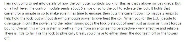

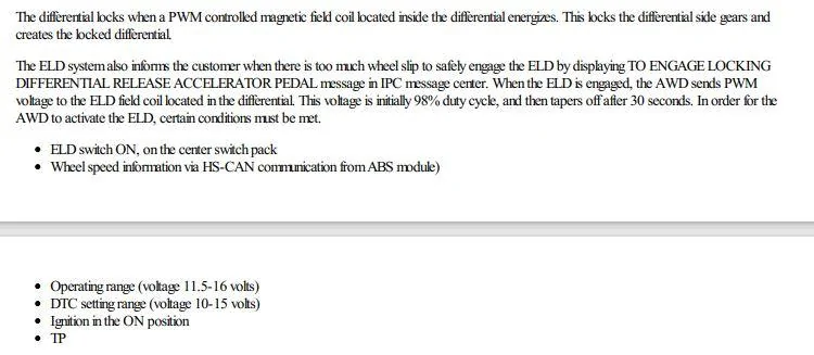

I am currently swapping in a factory rear ELD into my base model (Non-Sas) 2-door. I plan on wiring the locker off of my AUX switches, but after reading every thread I can find on the swap, and a page out of a factory service manual I found online, it appears that initial power is sent to the diff. and then reduced to save wear and tear on the solenoid.
I am looking for someone who either has access to Fords tech specs and can find me the exact voltages that are sent to the diff. or someone who is willing to craw under their Bronco with a factory ELD to back-probe the connector and measure the voltage for me.
Who here is wiling to be the hero us Non-Sas guys need? This is the final step in my swap, and I would like to have all the info before I do a write-up for the rest of the guys wanting to also do this.

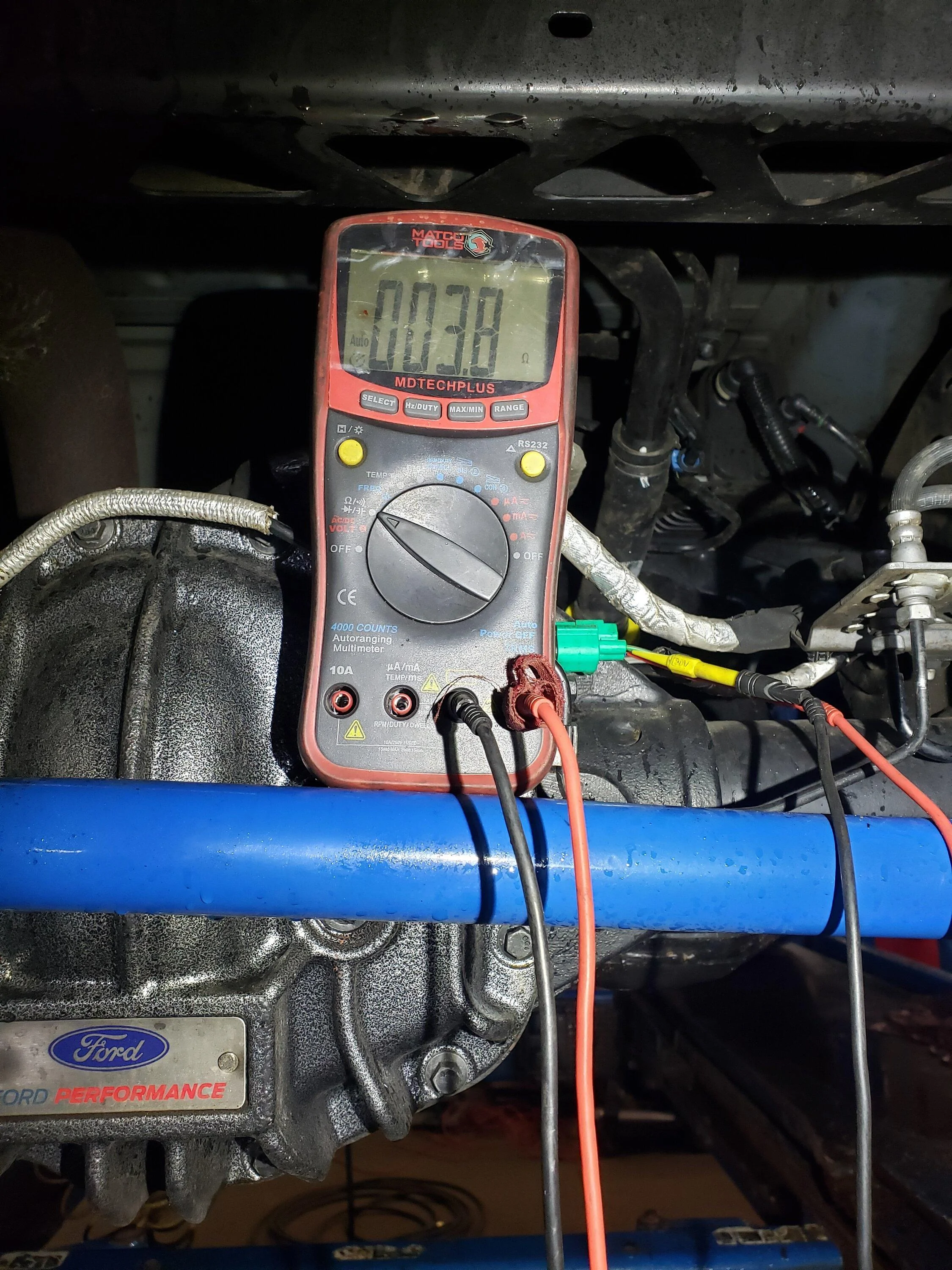

This post piqued my interest, so I did a little testing. BU/OG is + and GN/BN is -. If you were wiring it yourself that wouldn't matter, but for testing the OE system it does. 1st, to check i had backprobes in correctly, and because I know my locker works, I checked resistance key off:
Ford Bronco Need Help with my ELD Swap 20230325_134016

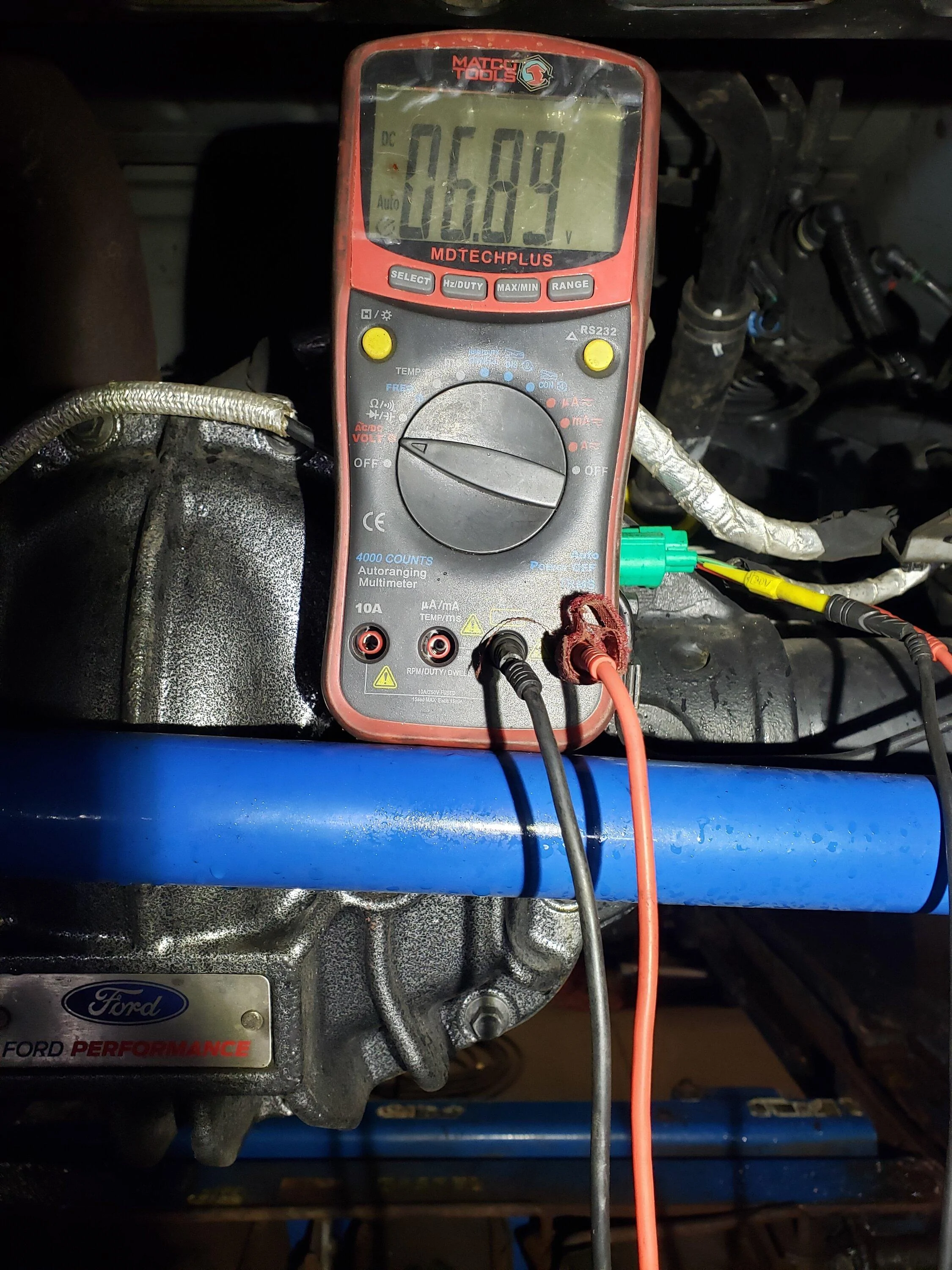

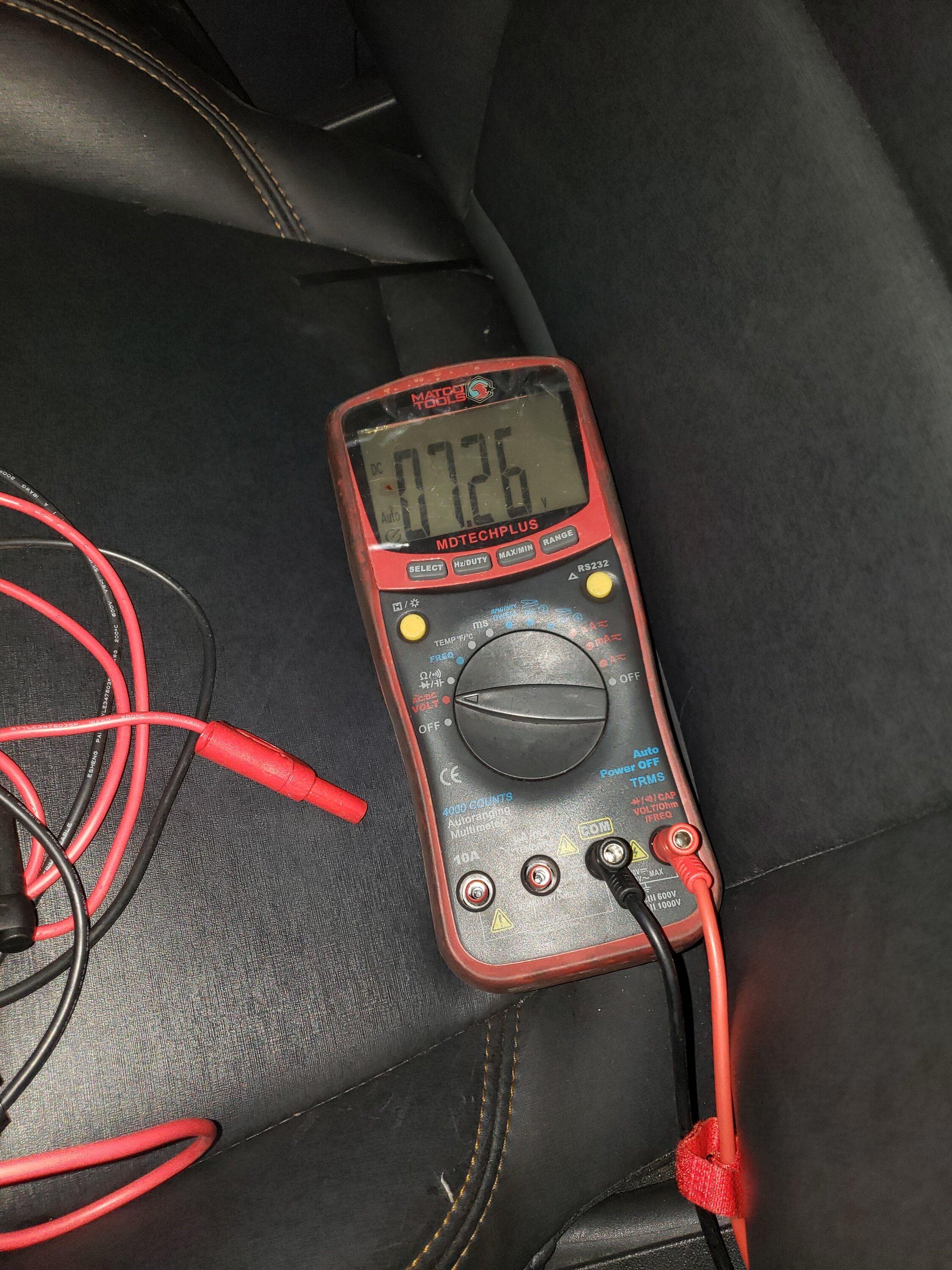

Next I started it in 4H normal, and turned rear locker on. I still had my DVOM under the vehicle and it took me a bit to raise it back up, but when I got back there it read this:
Ford Bronco Need Help with my ELD Swap 20230325_134345

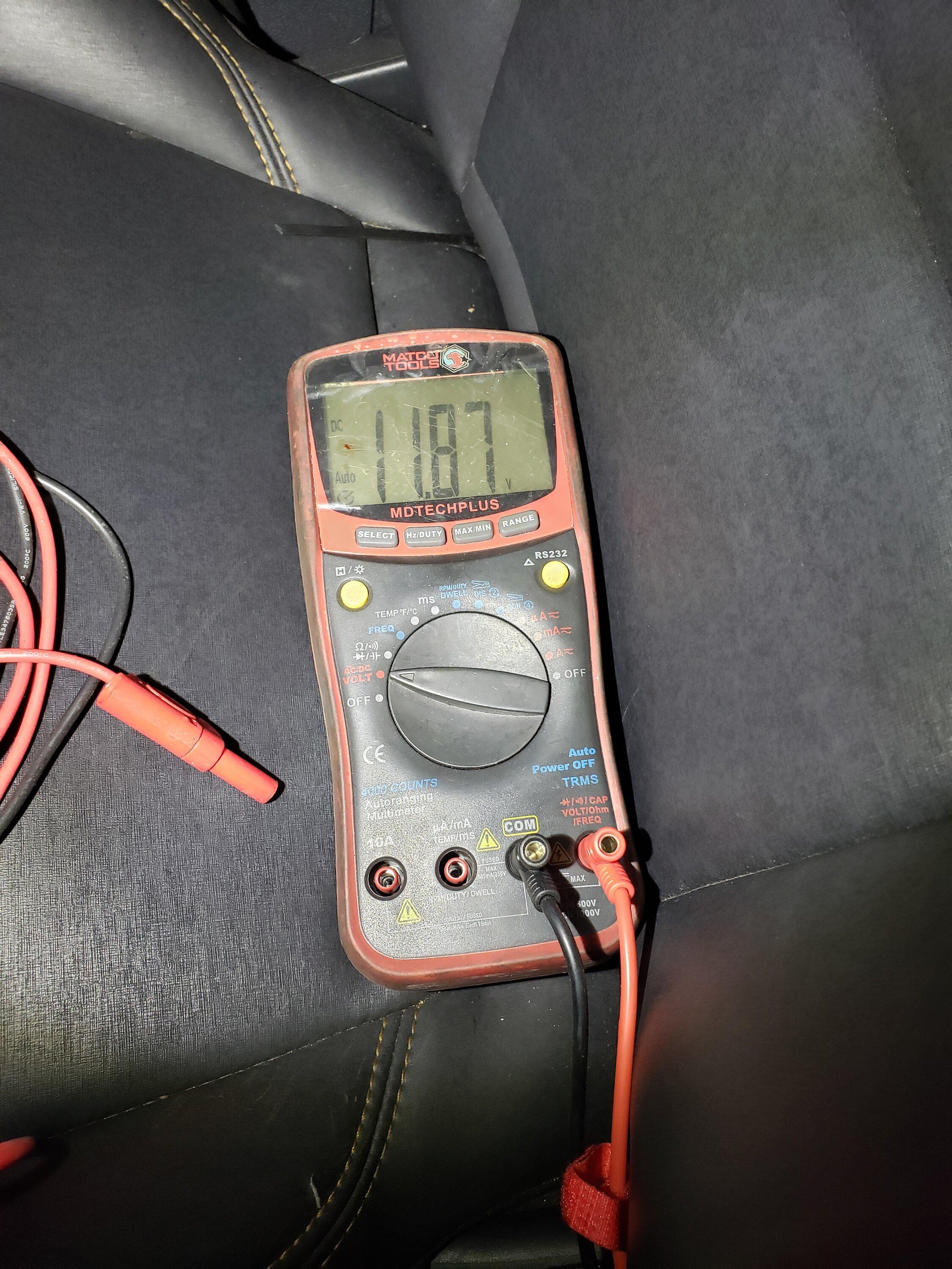

Next I went and found some longer test leads so I could see what happens from the driver's seat:
Ford Bronco Need Help with my ELD Swap 20230325_135339
Next I watched for it to drop to around 7V like it had before. It did, but it took what seemed to me like quite a while:
Ford Bronco Need Help with my ELD Swap 20230325_135407

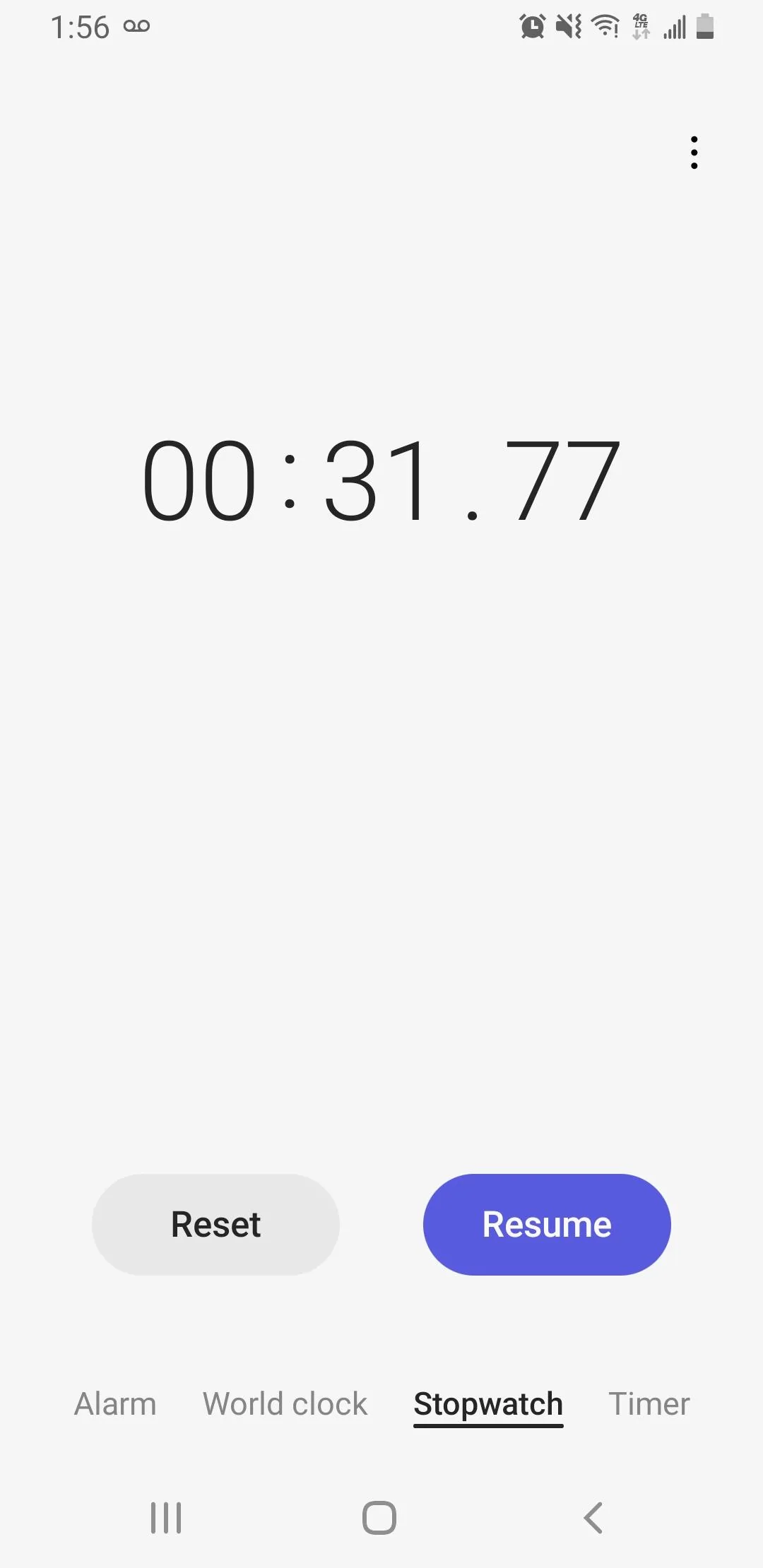

Next I decided to try to time the "event" on my phone. It was awkward trying to start the timer and press the button simultaneously, so I started the timer a little before, and had a little reaction lag after...I would guess the correct time would be 30 seconds:

Holy. Crap. You sir @Bmadda went above and beyond what I was looking for. I have spent the last three hours searching Ford's tech service site for that exact info to no avail. If it wasn't such a long drive from Missouri to Wisconsin I would buy you a couple packs of beer!

It just so happened that my Bronco was in the shop on the alignment rack when I read your post! We had a pretty good snowstorm today, so I came in to work to plow the lot. I parked the Bronco inside so it would be out of my way while plowing and it was still sitting there when I took a break for lunch! I agree w/ @orion above that the unit will probably work just fine on switched B+, but your original question was in fact completely correct! I have been pondering how to convert some of these features to full manual control, because we have seen computer errors happen on the trail and get folks stuck. Fun to learn!
