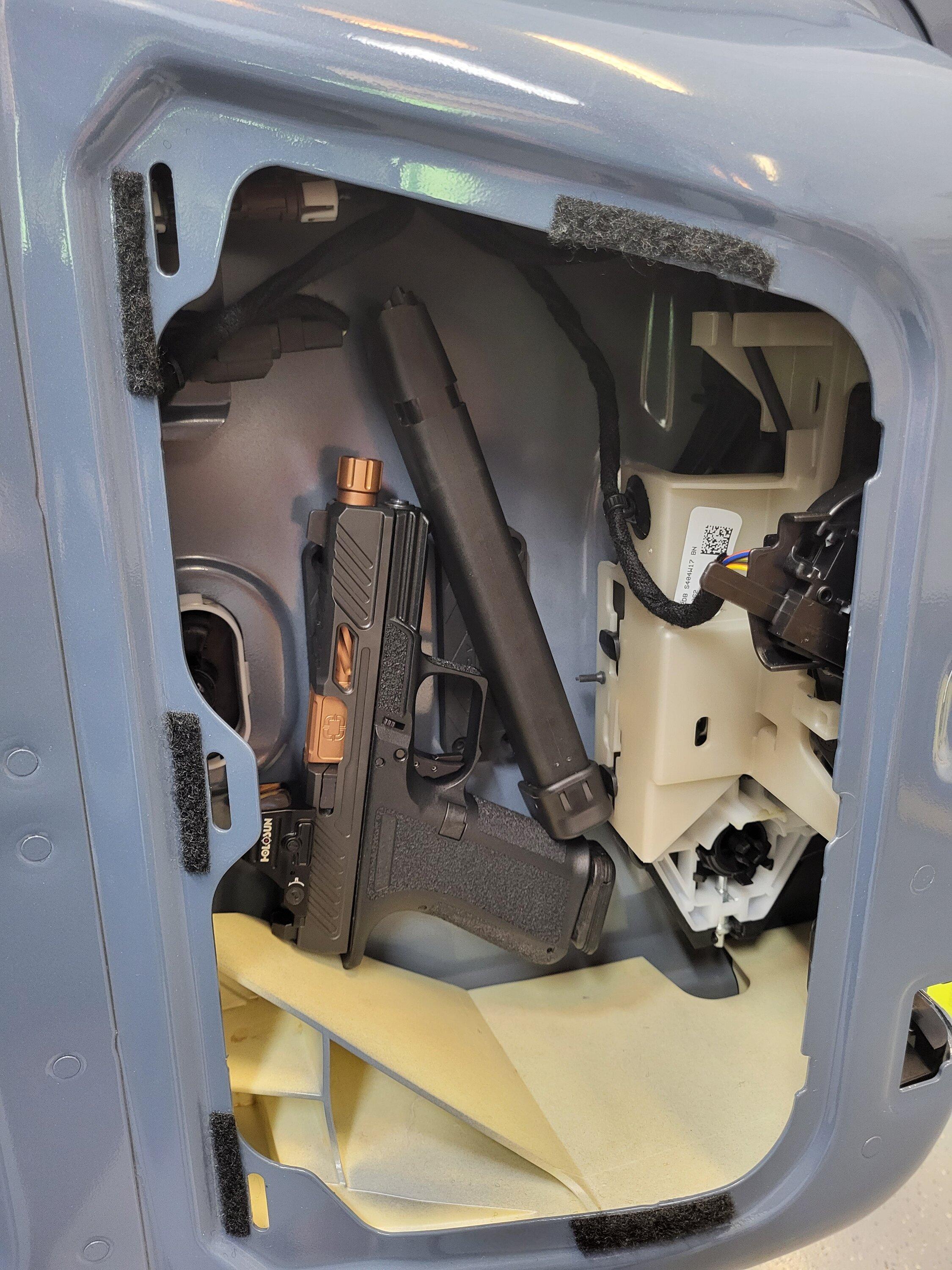

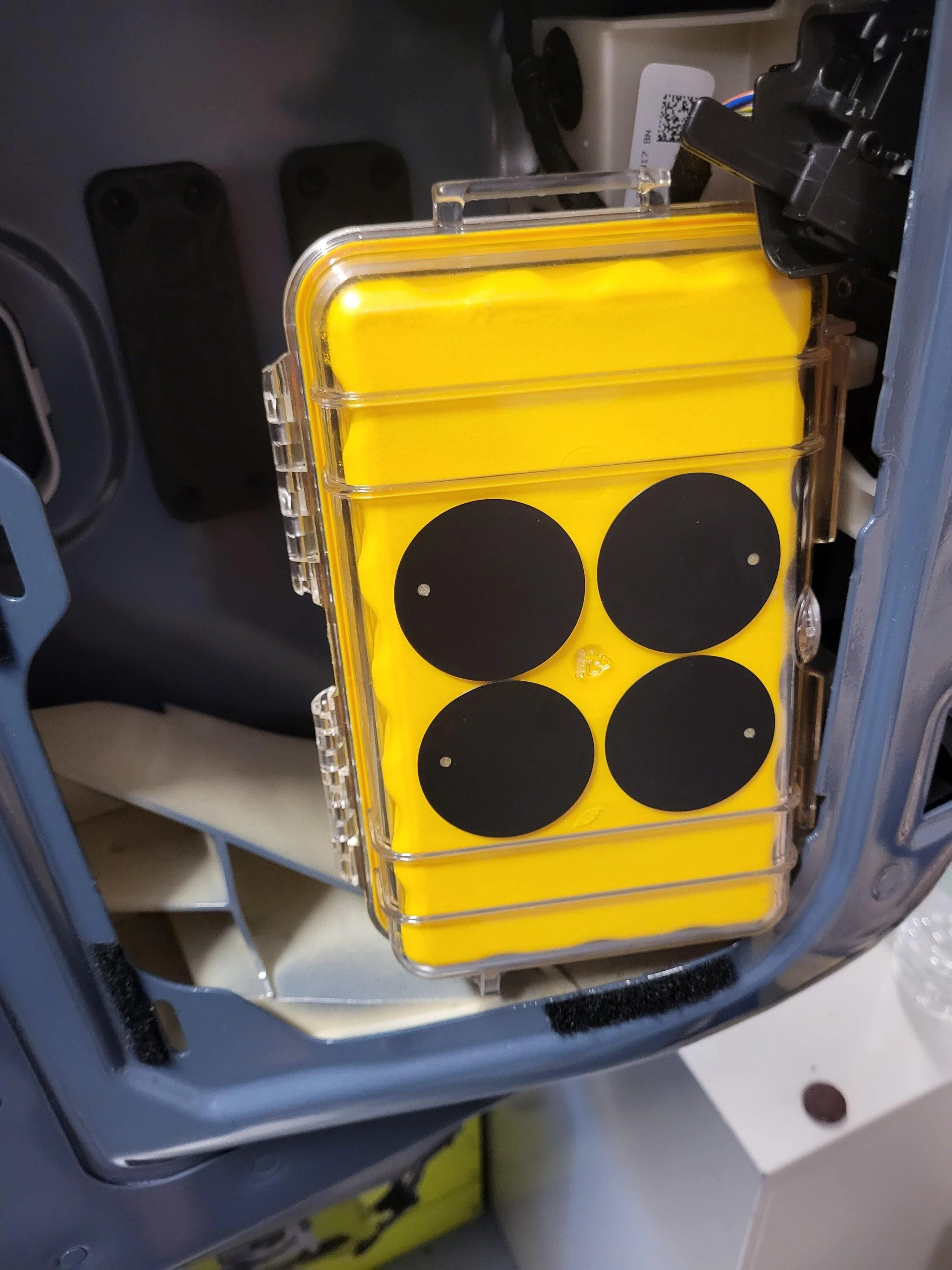

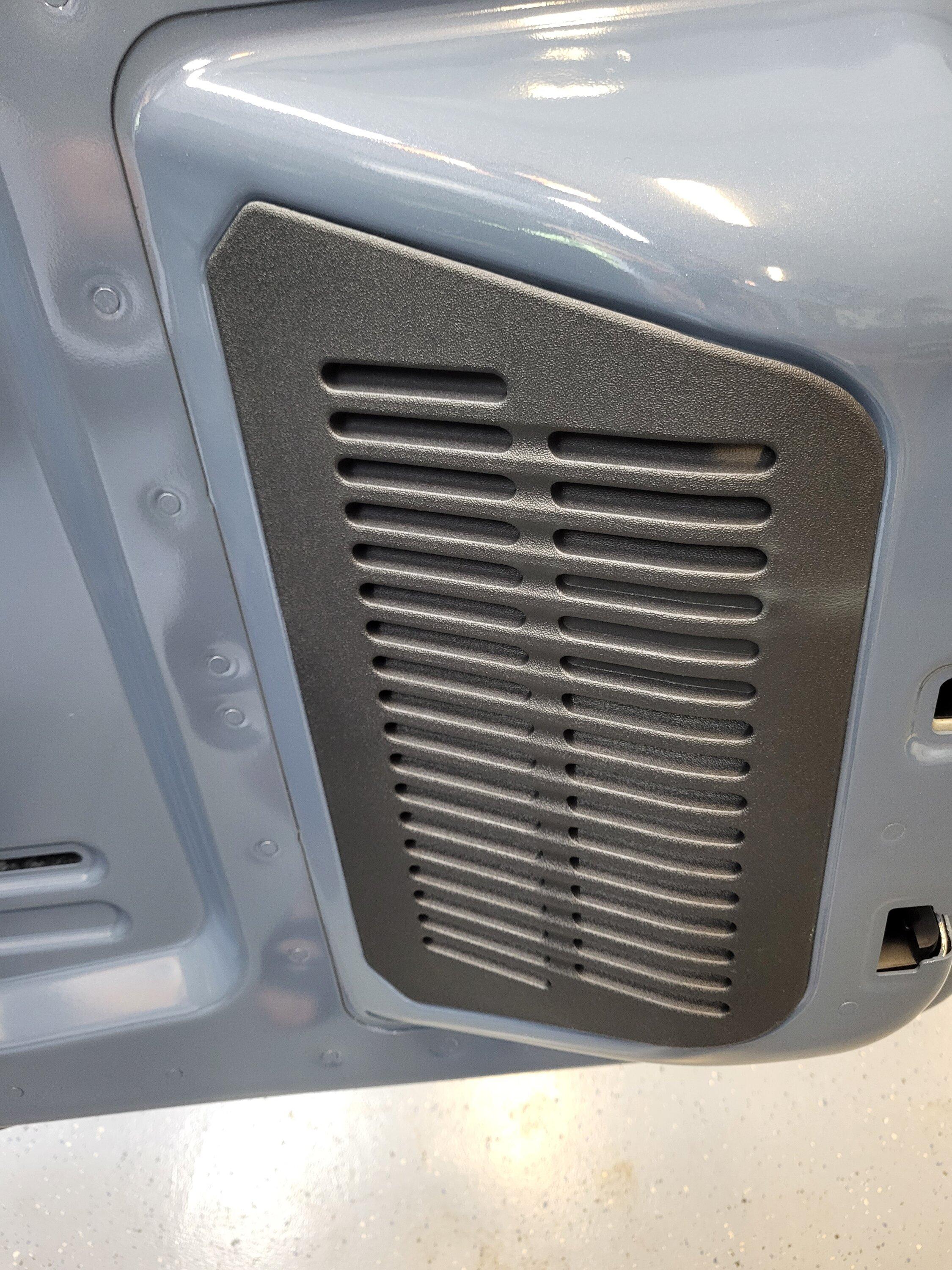

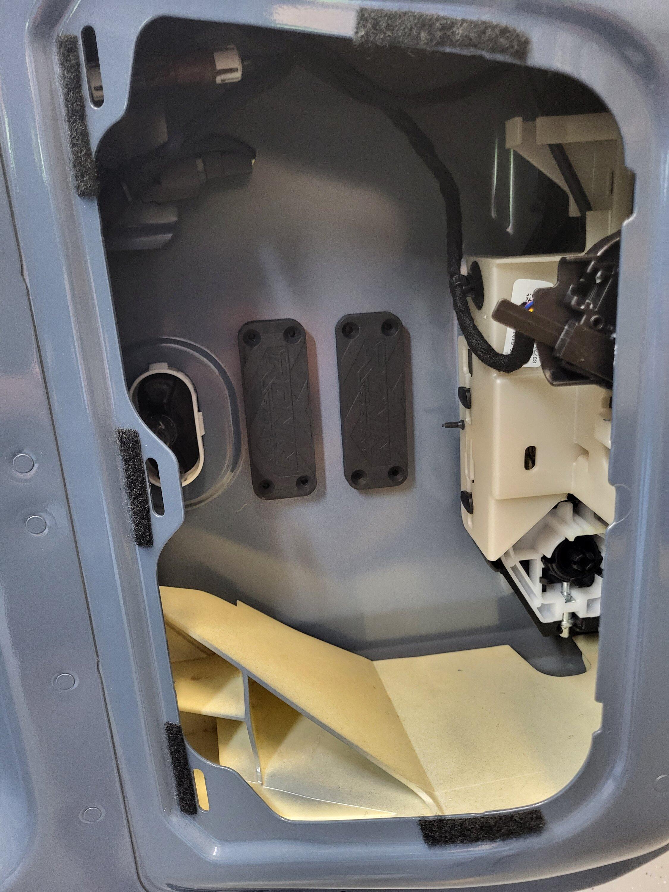

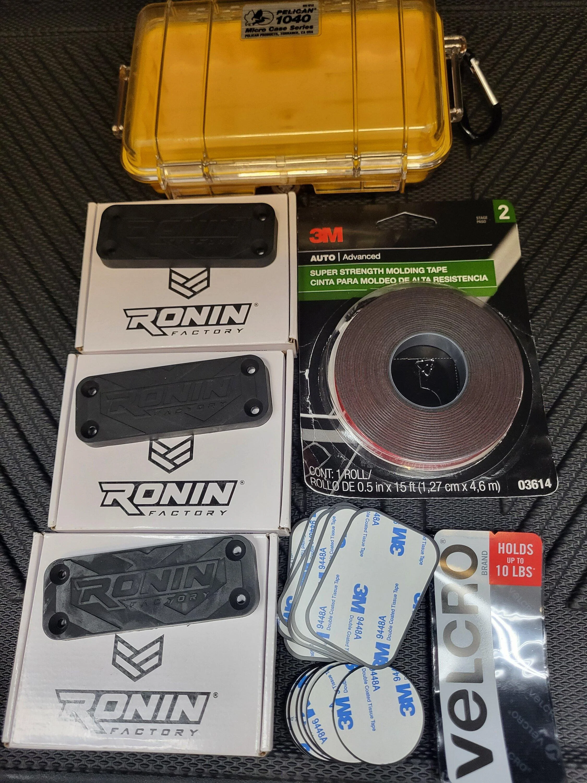

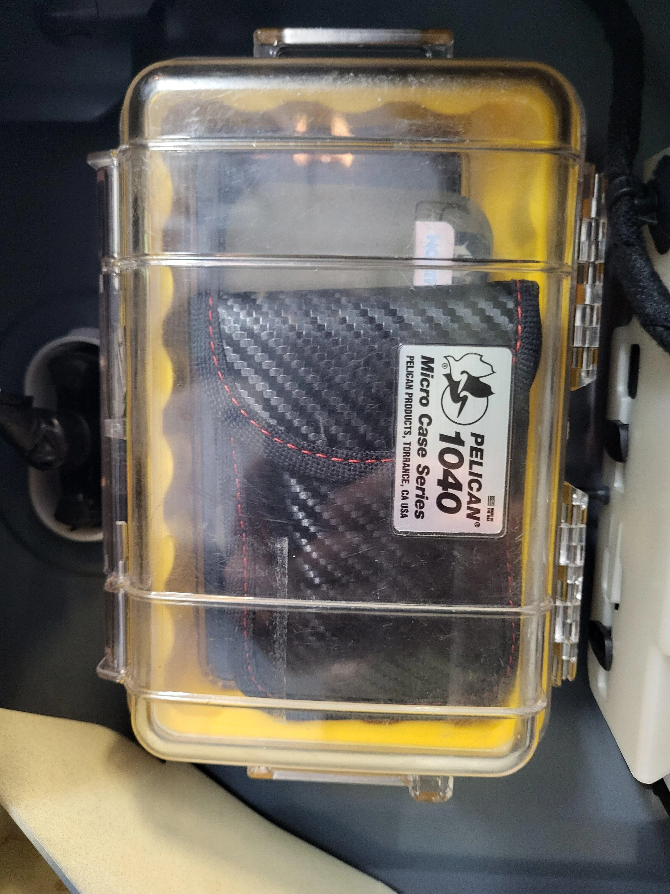

I use my keypad to lock my key inside when I run or bike but didn't want the Bronco to start if someone got in. I also didn't want the key, my phone, or wallet to be found. I figured a criminal would go to the usual spots like center console, glove box, or under the seat. I had to remove the tailgate panel when I installed the spare reinforcement and knew there was room behind it. I removed the metal retaining clips being careful not to break the plastic, added some industrial velcro, and I had an easy on/easy off tailgate panel. I already owned a waterproof Pelican 1040 for paddleboarding, and it fit perfectly in the void. Using Ronin Factory magnets, 3M super strength molding tape, and metal plates I was able to secure the Pelican. It is very secure and perfectly fits my Magpul wallet, my phone, and the key in a faraday pouch that keeps the Bronco from starting even though the key is inside. A bonus was that the Ronin magnets are strong enough to hold other "heavier items" very securely as well as seen in the pictures. If anybody needs any more details just let me know

Your illustration of the "heavier object" is well taken, but in many states that would be insufficient, so check the statues where you do this. My state requires a solid locking mechanism or container, not shown in your picture. Perhaps a skinny lock box could squeeze in there? Or would a trigger lock be sufficient?
Research your state laws, and consider consulting with a sergeant or detective (or above) in your local jurisdiction.
I installed the Tuffy/OEM lockable drawer box, which is roomy, strong--and legal.

You're probably okay. Was that a barrel lock I saw? Two levels of lock: the doors, electronically, and a trigger or muzzle lock should be evidence of due diligence in most states.

That is the thread protector for the threaded barrel for a suppressor.
