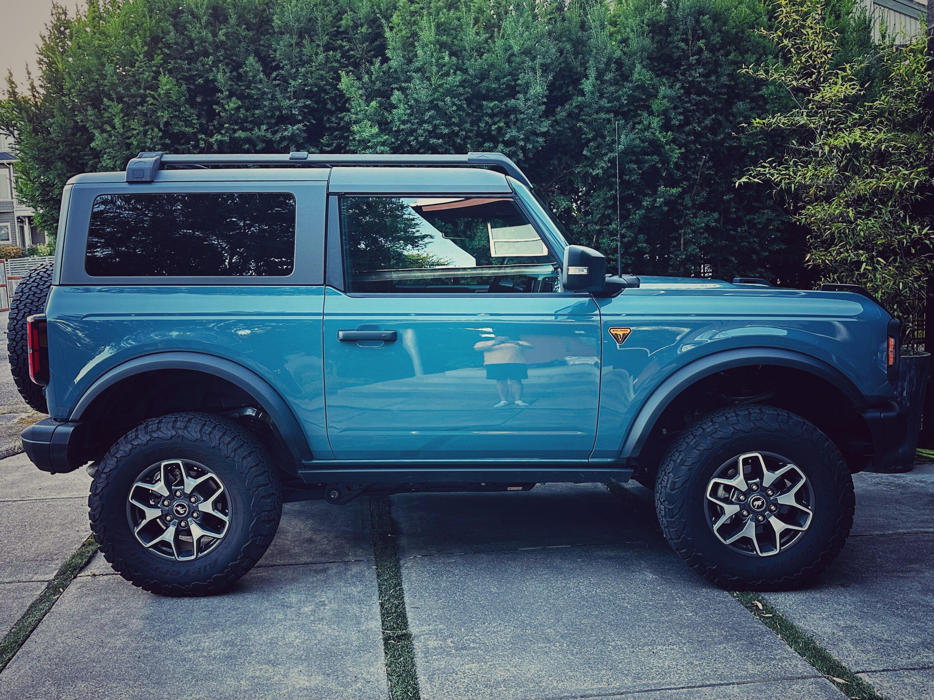

I just had the Bilstein 6112 installed in my 2 Door Badlands. The ride is terrible. Quick call to Bilstein and we discovered the WRONG kit was installed. There are specialized kits for 2 & 4 door Broncos, engine size, sas/non-sas. Needless to say the correct kit will be ordered/installed soon.
If you go the with the Bilstein's make sure your installer orders the kit specific to your build.

My goal was ride comfort, not lift. When the correct kit is installed the height will come down (less preload, more compliance). It does look cool at the current height.

Looks great, are the tires the stock 33" KO2's. I've been considering a ride improvement with different shocks but don't want to go to 35" tires yet. Might not fit thru the garage door!
Yes, stock 33's. The KO2 do soften up over time, when new they were very firm.
