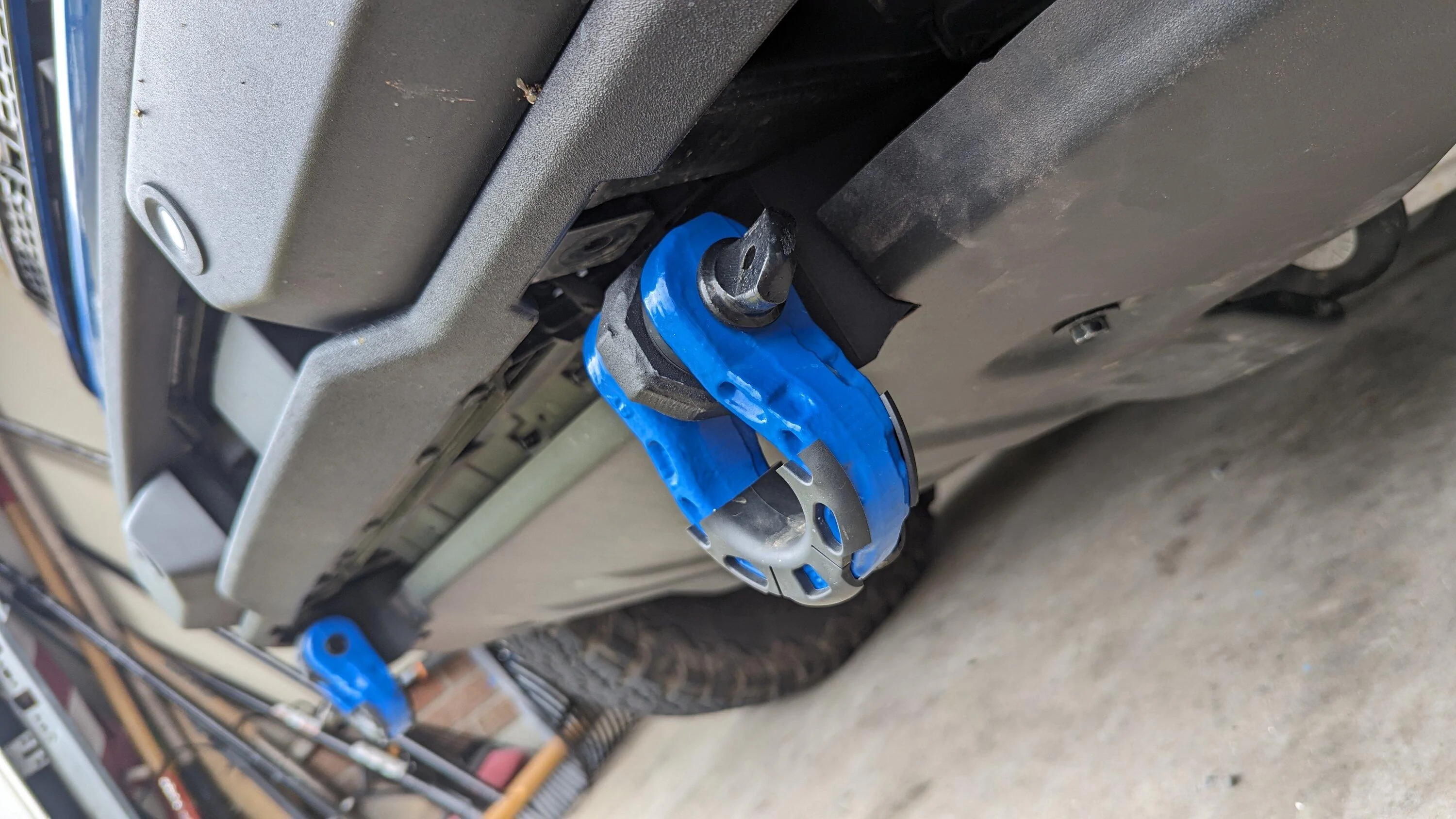

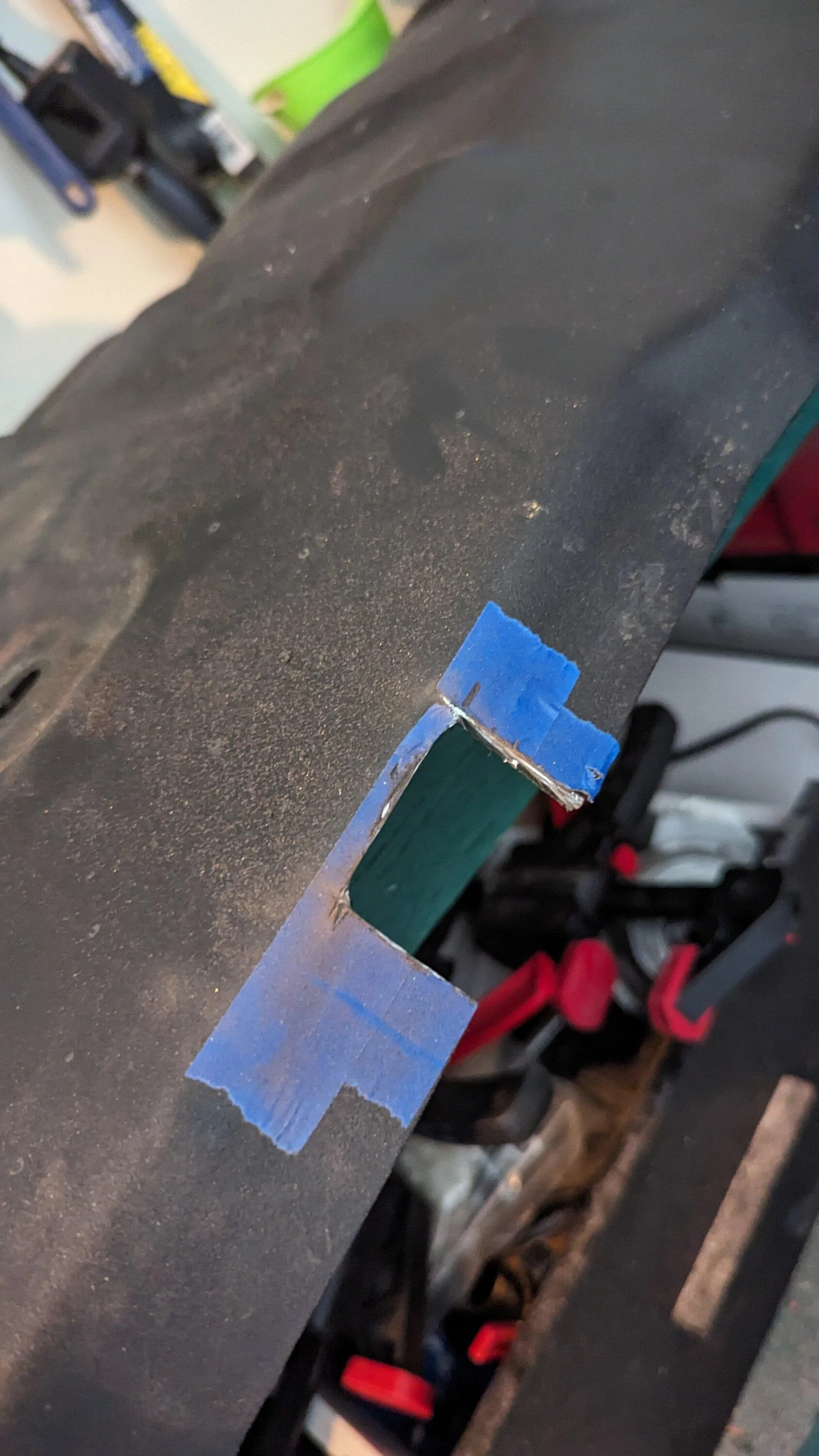

I mounted the front bash plate, taped off & marked where I would need to notch it out. I used my dremel because that's the best tool I had for the job (I went through about 10 standard cut off wheels, because I didn't feel like going to the store to get heavy duty ones). There are better tools for this, but this worked just fine for me. I then filed the edges down with a 12" hand file and smoothed with another Dremel bit. Coated the raw edges in flat black paint, by hand.
It does leave behind a gap but it's minimal and still flows with the contour of the bumper so I still think it appears finished... but the main goal here is protection. I have a 2.7 so that transmission oil cooler was just asking to kiss a rock at some point.
Lining it up
Ford Bronco OEM Steel bash plate modified to fit standard plastic bumper PXL_20230804_171012289
Cut lines. Looks a lil rough here as this is before filing it down. I ended up needing to take more off length wise after test fitting. I wanted to be conservative in how much material I removed at a time.
Ford Bronco OEM Steel bash plate modified to fit standard plastic bumper PXL_20230804_173651181

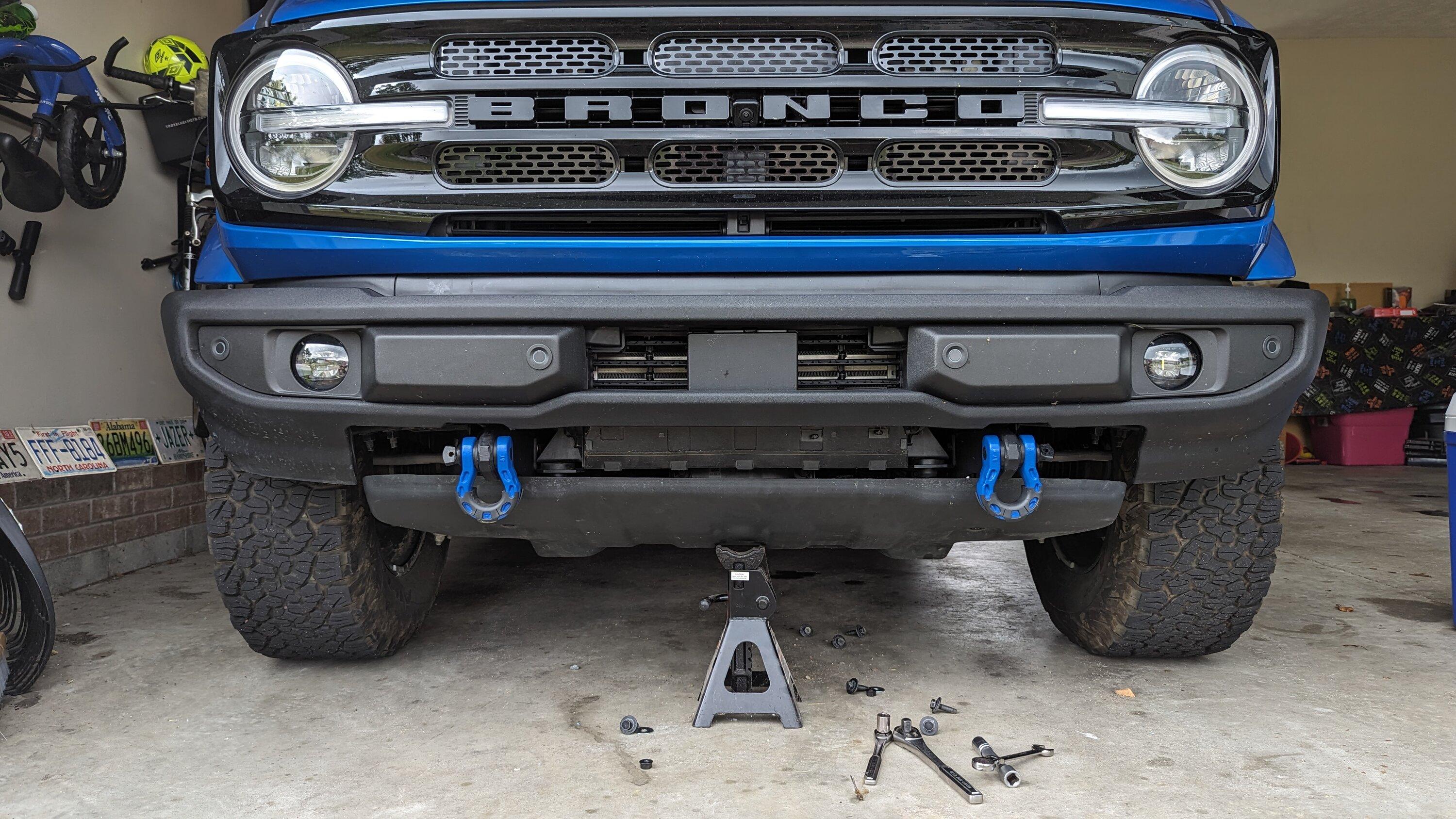

Mounted
Ford Bronco OEM Steel bash plate modified to fit standard plastic bumper PXL_20230804_192848993
This photo is taken at a lower angle than one would normally be looking at the vehicle. The gap is present but still acceptable, IMO.
Ford Bronco OEM Steel bash plate modified to fit standard plastic bumper PXL_20230805_185759993-01
I also installed the steel engine skid (no modifications needed). The OEM transfer case skid requires Ford Part# W717461-S439 "Skid Plate U-nut" (quantity 2) for the two bolts that mount to the frame rail on vehicles that did not come with one.

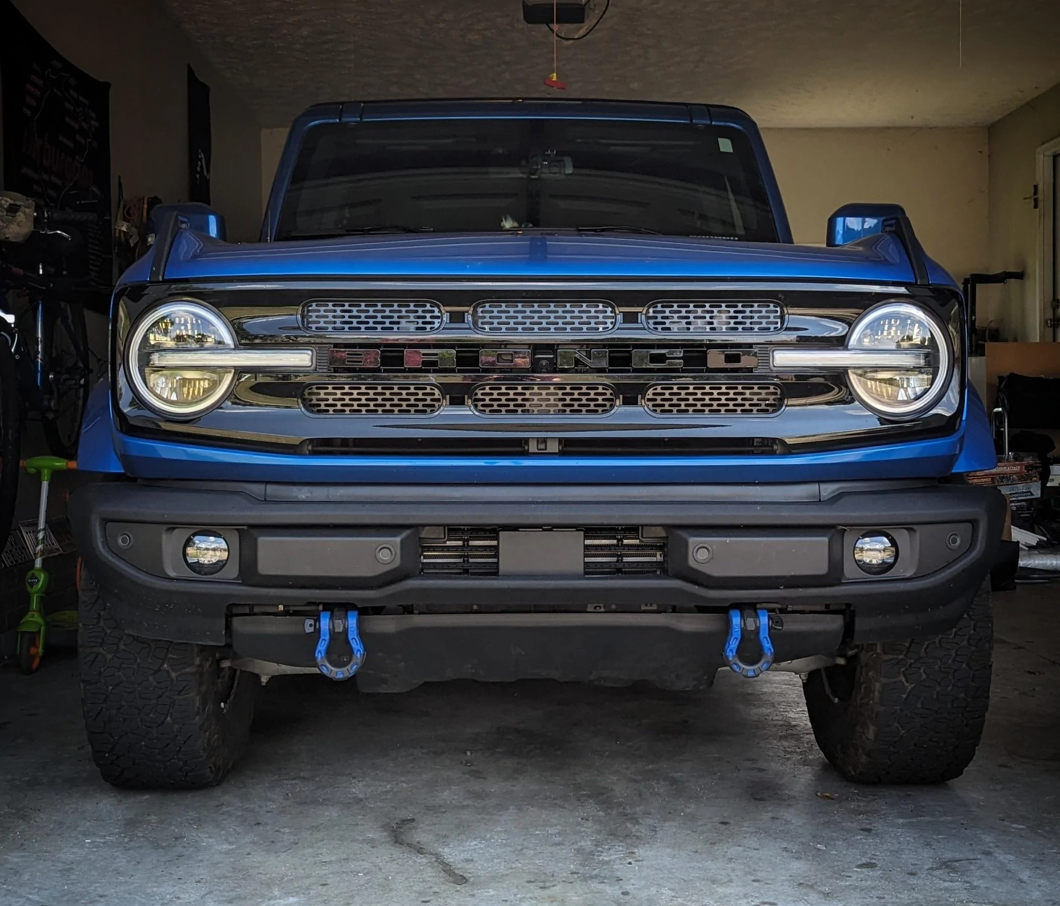

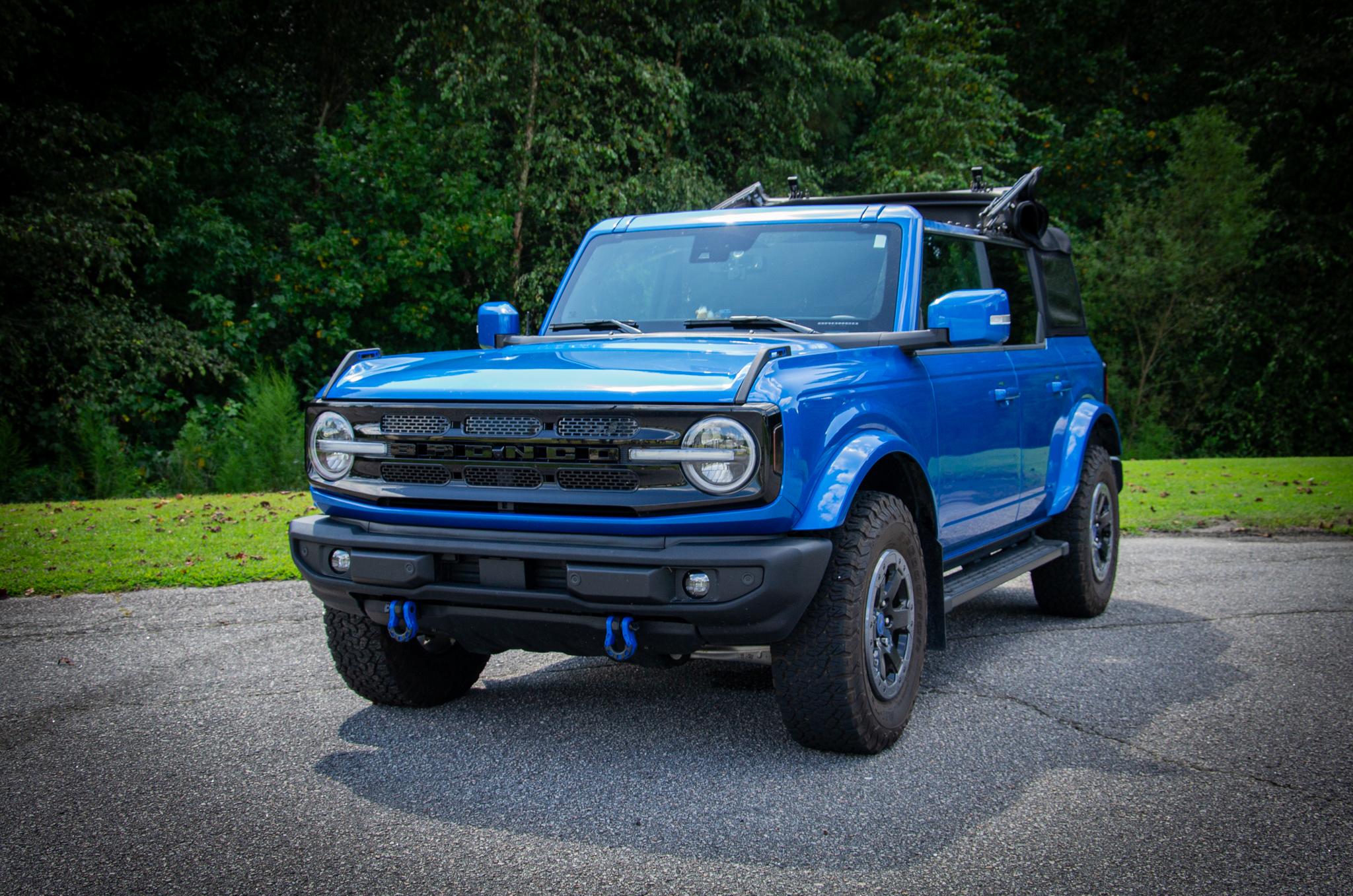

Recently got a better photo showing the bumper/bash plate & thought this may help people see what it looks like better than my crappy garage photo.
Ford Bronco OEM Steel bash plate modified to fit standard plastic bumper DSC_6395

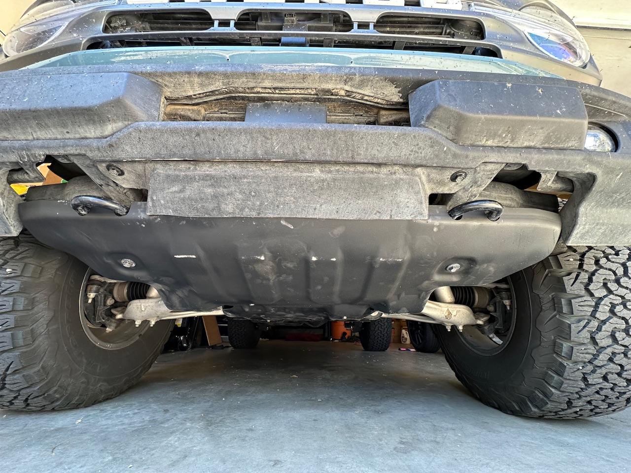

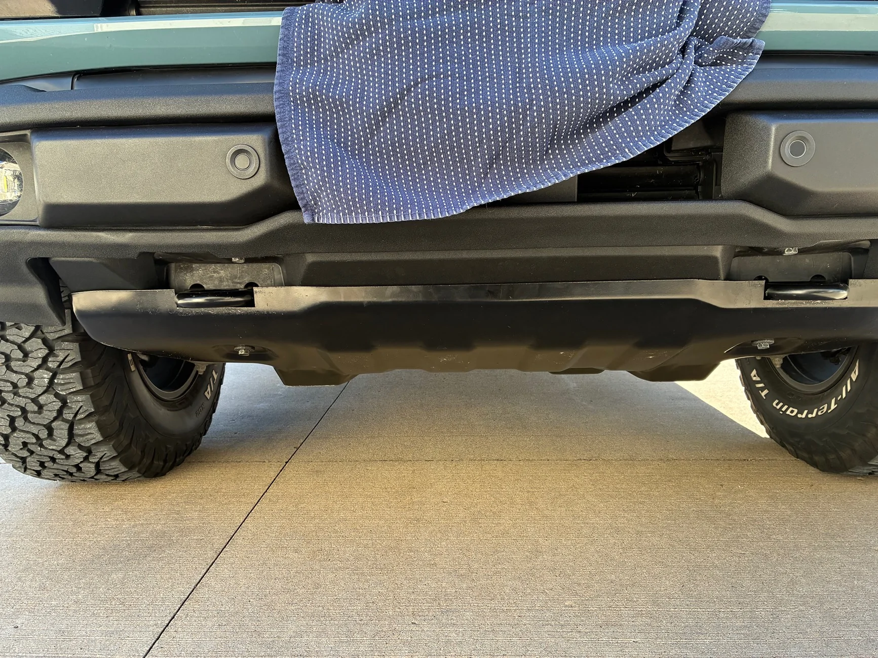

Just got mine mounted up and my only concern with the gap was the tiny chance of the bumper’s lower lip pushing something like a branch down just enough to slip in and hit the intercooler. Kept a little cut out of the plastic skid to cover that one vulnerable spot.
Ford Bronco OEM Steel bash plate modified to fit standard plastic bumper IMG_0430
Ford Bronco OEM Steel bash plate modified to fit standard plastic bumper IMG_0429

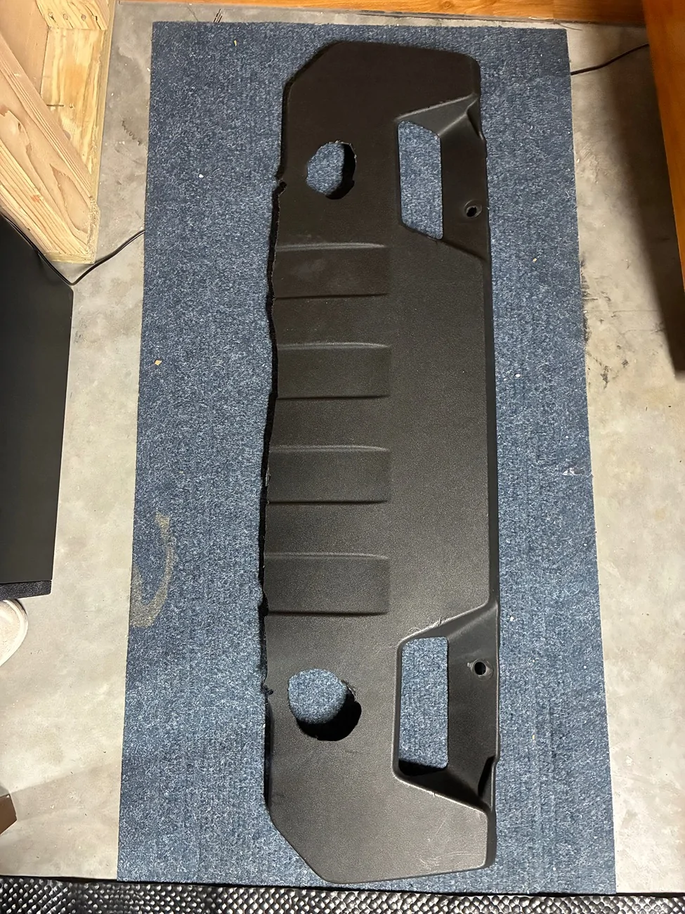

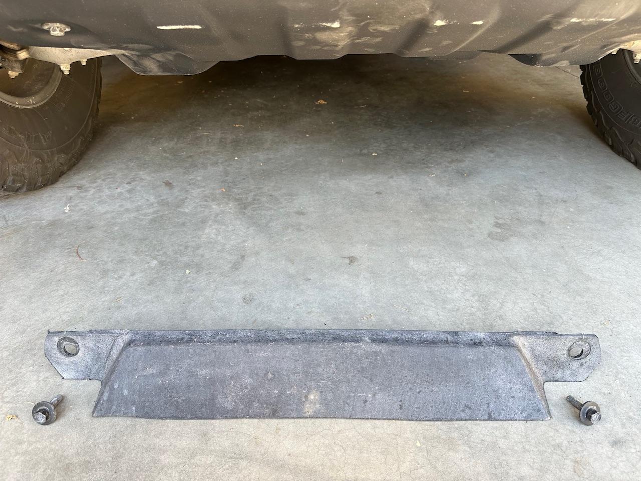

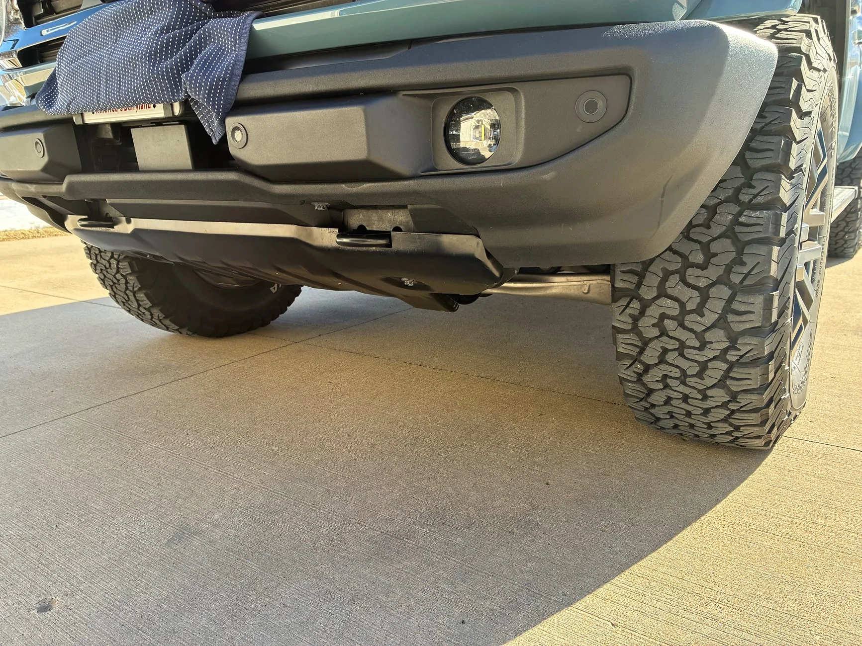

Old thread I know… but thought I would share my approach to this since it’s slightly different than others and someone might find it useful to see.
I trimmed the plastic plate and tucked it behind the steel plate to address the look and to get some extra coverage for the intercooler. The trimmed plastic is against the front edge plastic of the intercooler but it has some give so not worried.
Edit: I have the 2.3
Ford Bronco OEM Steel bash plate modified to fit standard plastic bumper IMG_0497
Ford Bronco OEM Steel bash plate modified to fit standard plastic bumper IMG_0496
Ford Bronco OEM Steel bash plate modified to fit standard plastic bumper IMG_0500
