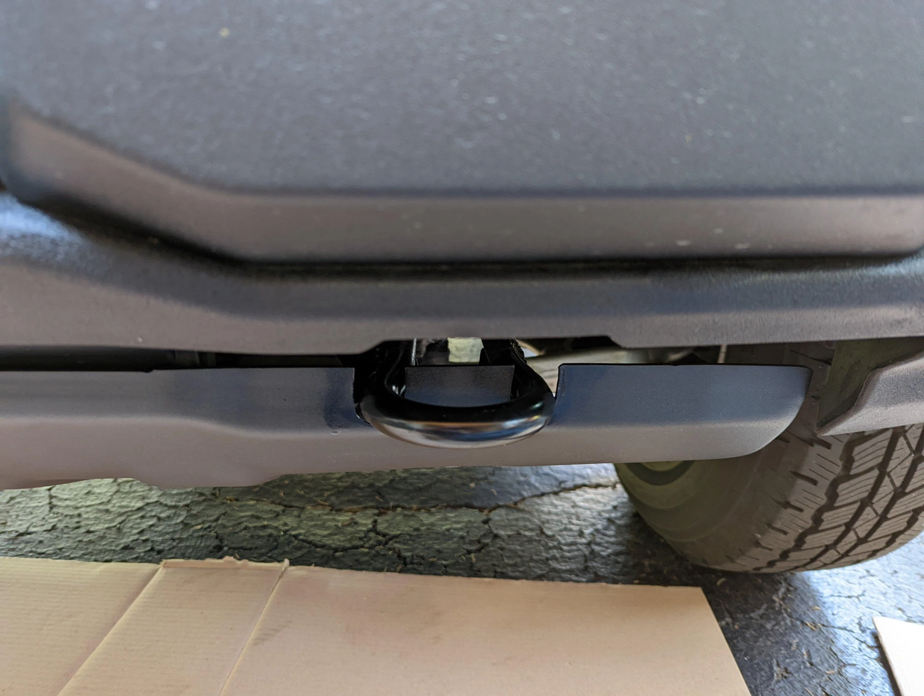

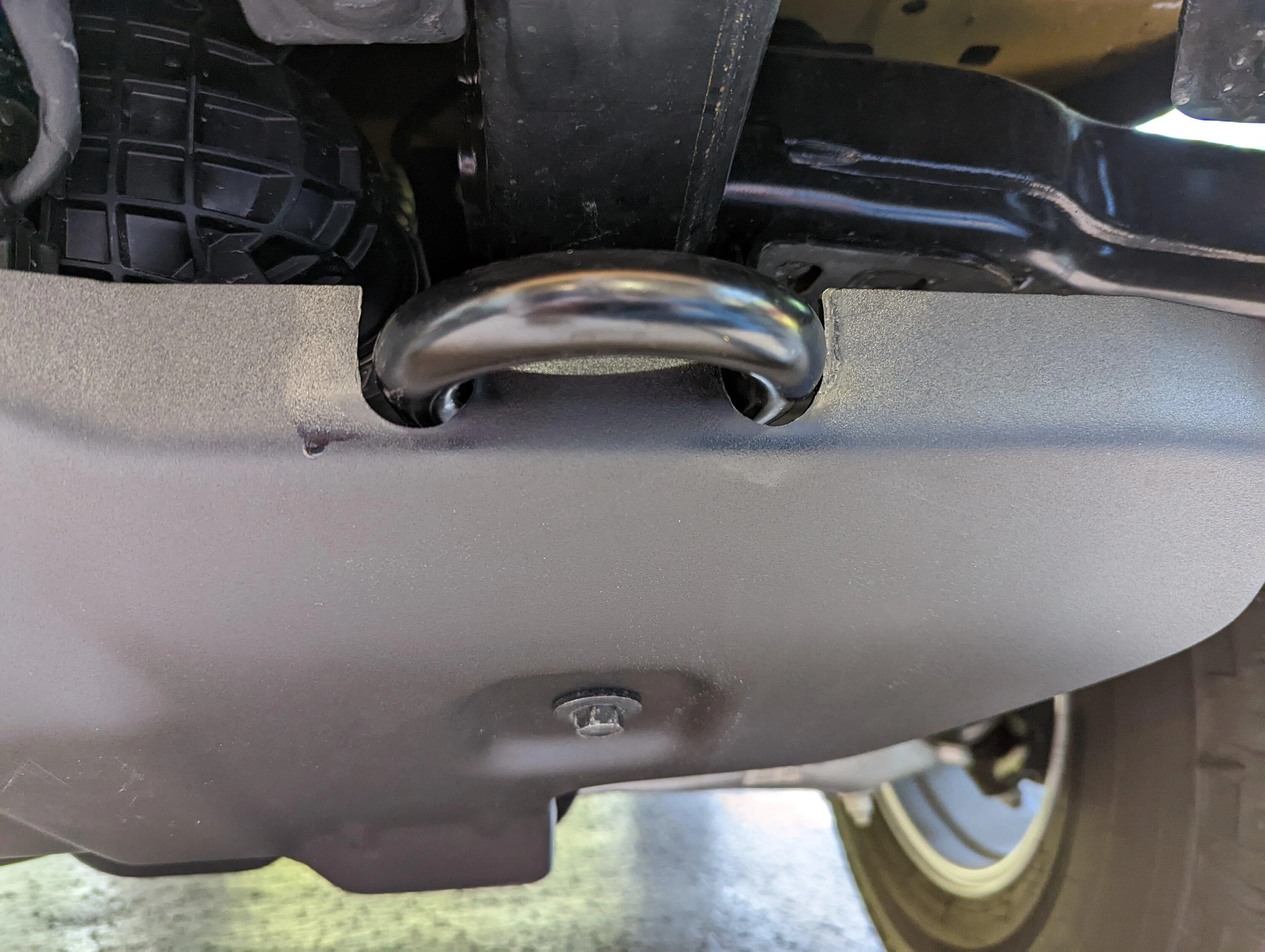

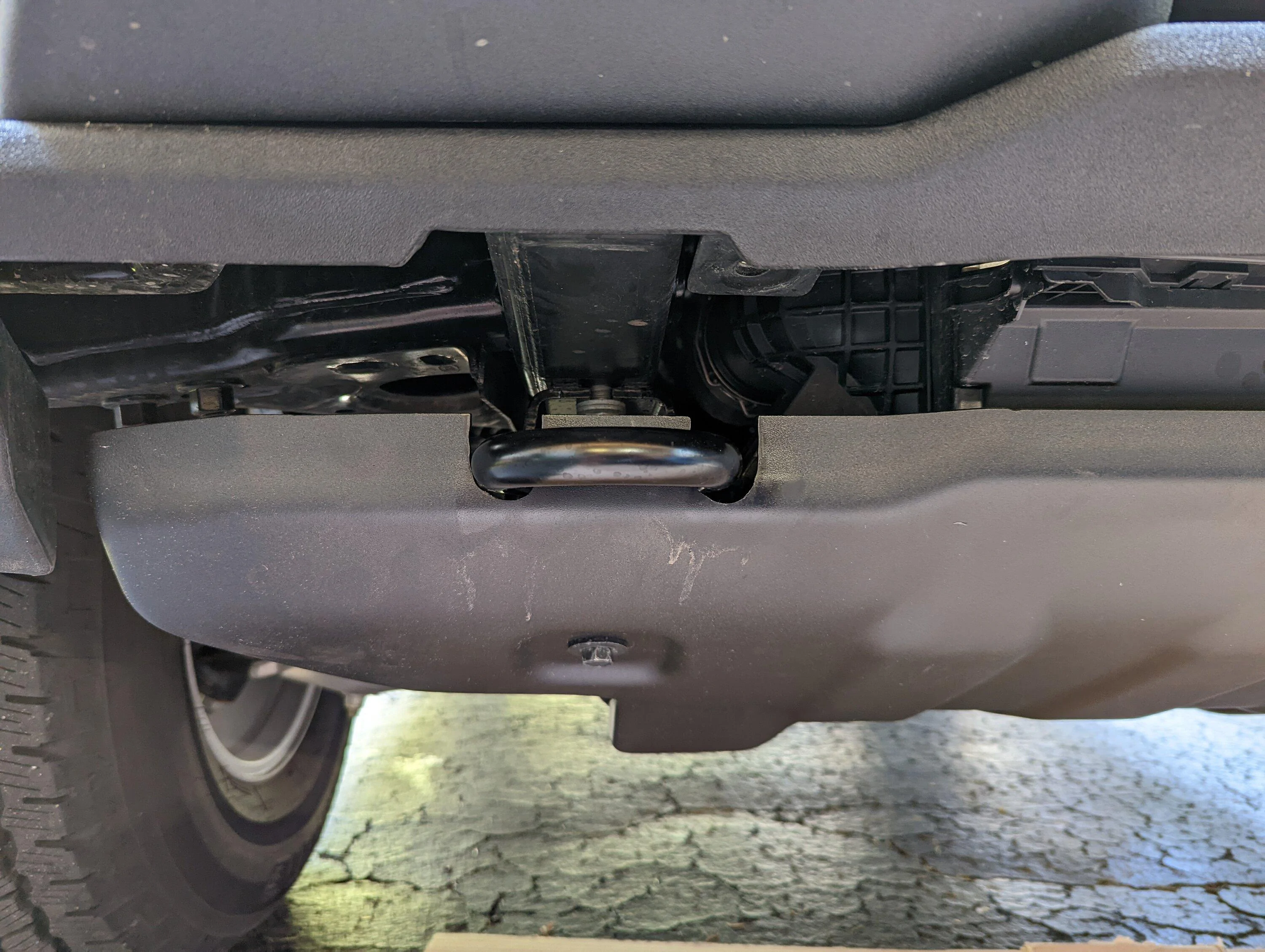

I did it, but cut 4 ~1"x1" slots out of the new front skid plate in order to keep the recovery points usable. There is a little bit of a gap between the plastic bumper cover and the skid plate, but you don't really notice it unless you are looking at the vehicle from a very low vantage point.

I should also note that I wasn't sure that a hard shackle would still fit on the front recovery points with the metal skid plate before cutting... fortunately they do still fit as do soft shackles.

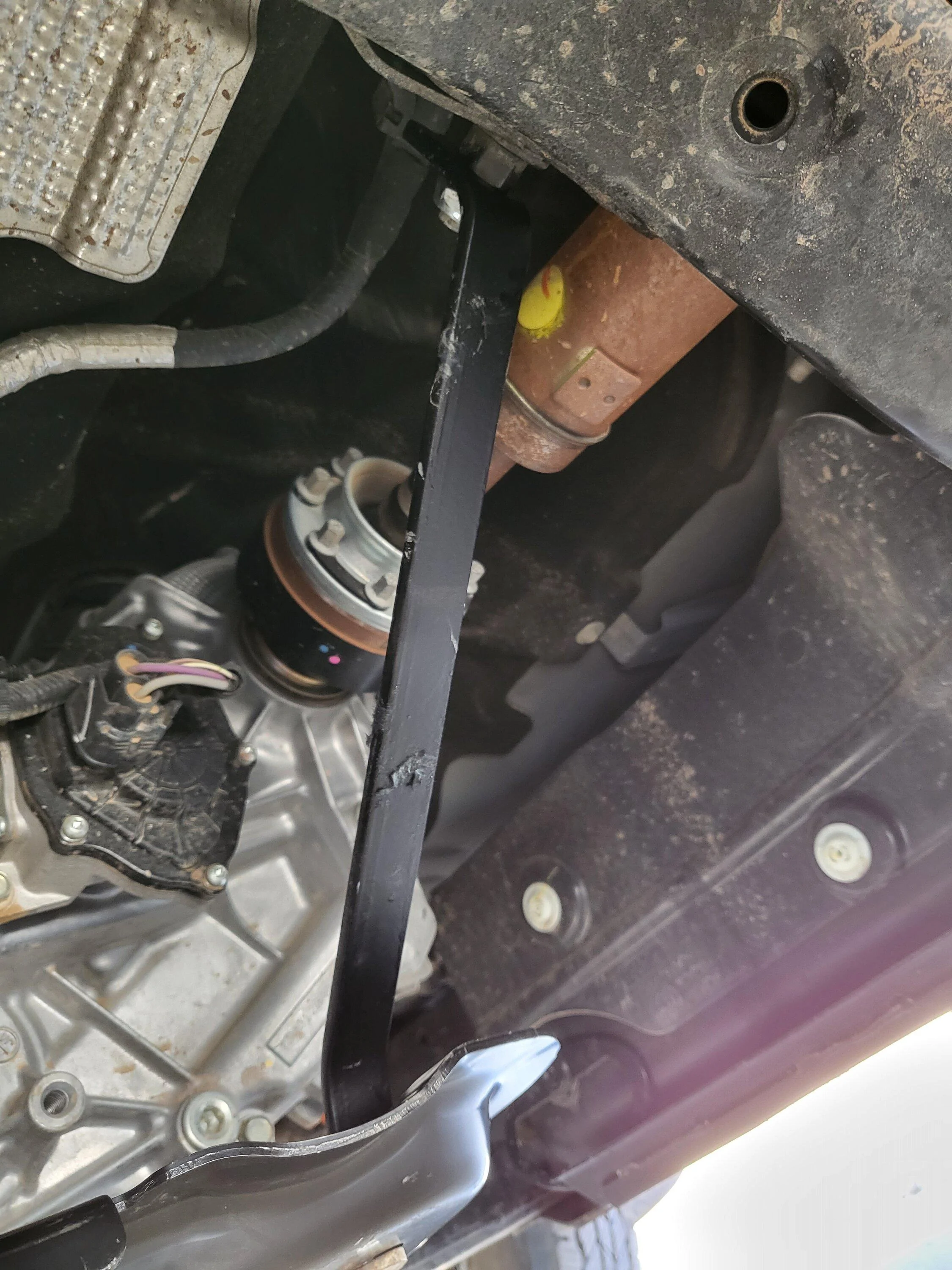

Same as I. BTW I made a brace for the tc skid like the asfir one for free.

And you will need a couple metric bolts an clip nuts for the tc plate
