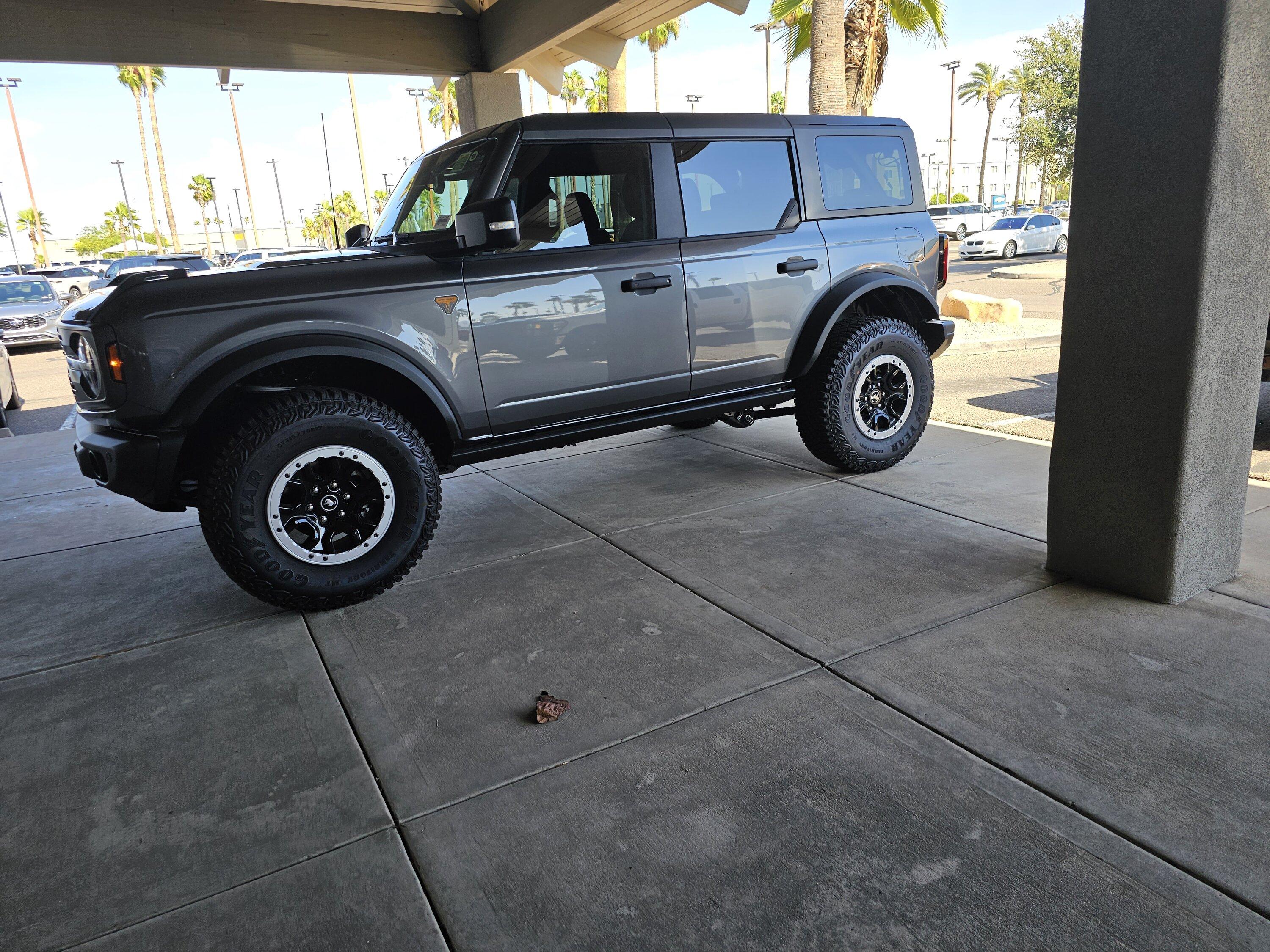

At the Dealer
Ford Bronco 2023 Carbonized Gray Sasquatch Badlands - Holy IFS Build 20230721_155458

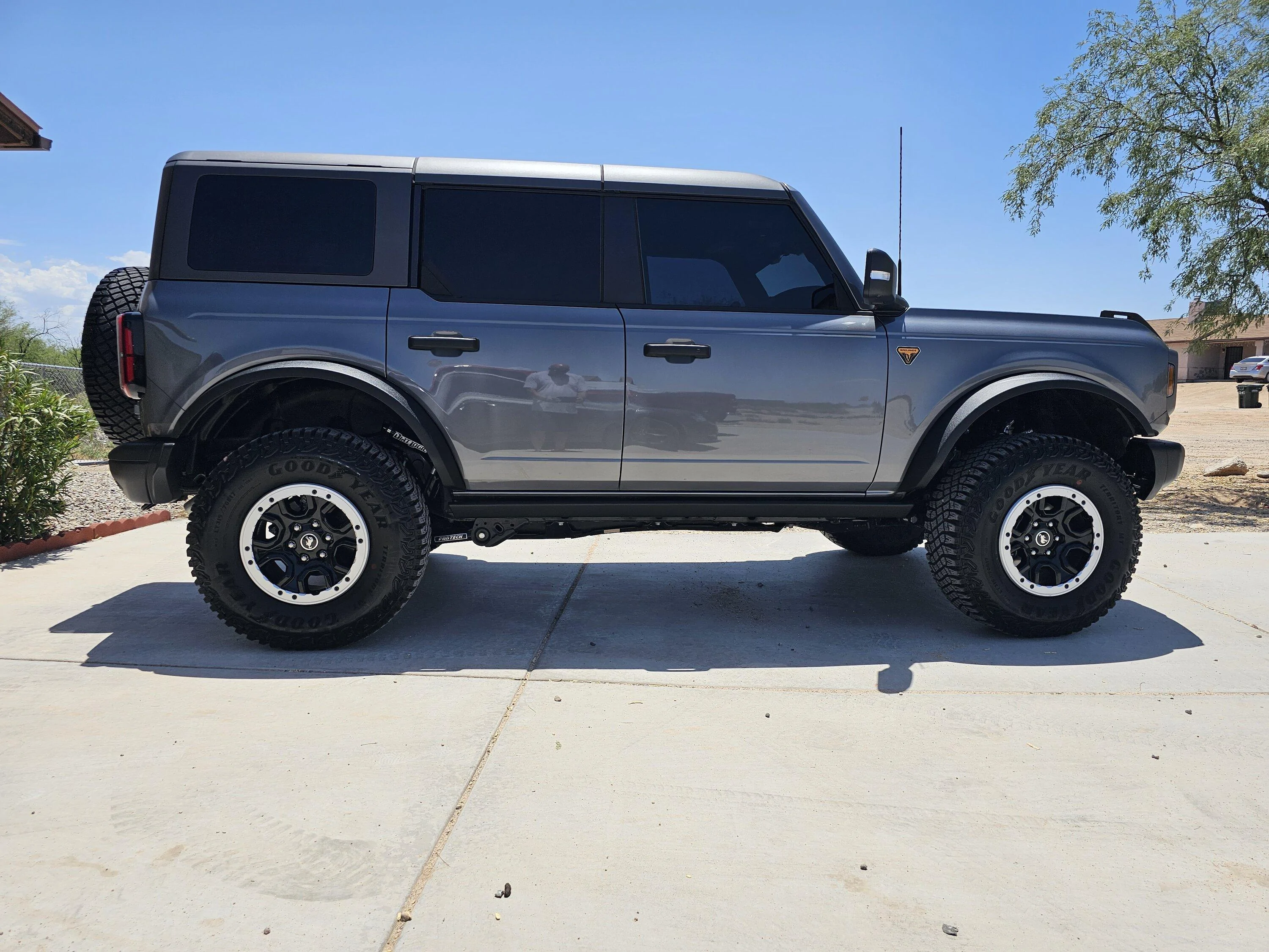

Stock with Window Tint

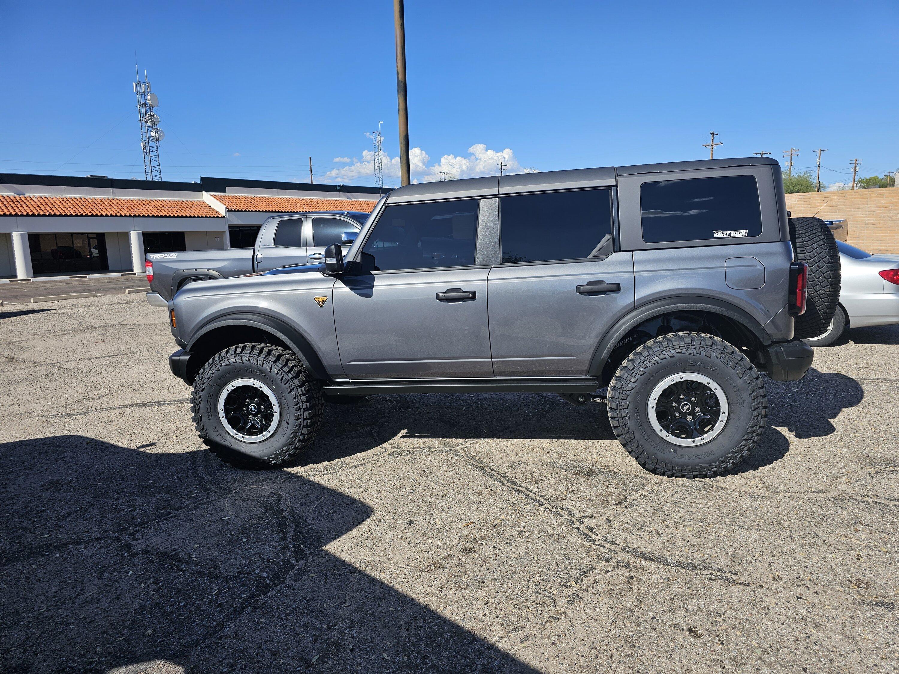

OEM Wheels with 37" Mickey Thompson installed.

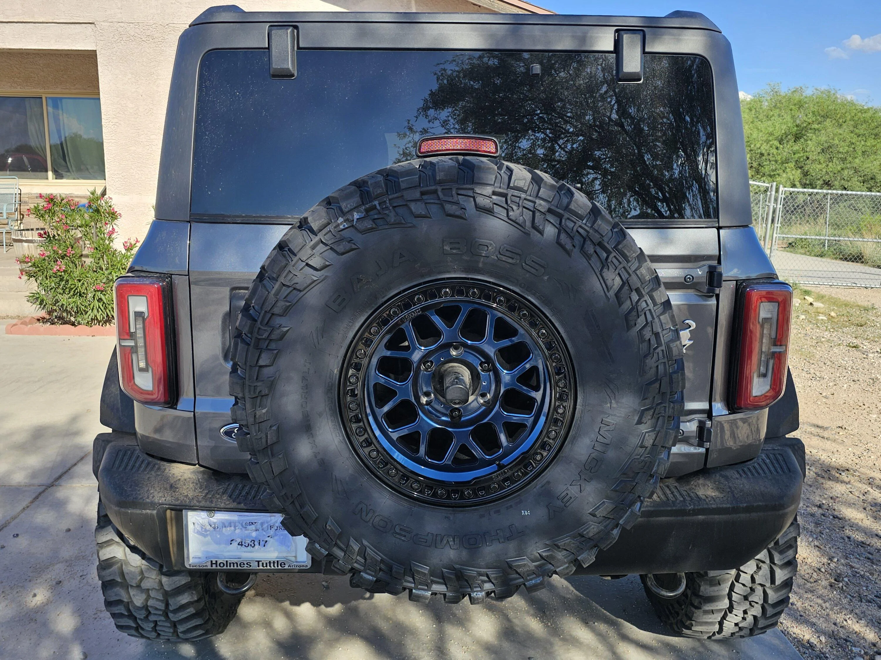

Ford Bronco 2023 Carbonized Gray Sasquatch Badlands - Holy IFS Build 20230802_161531

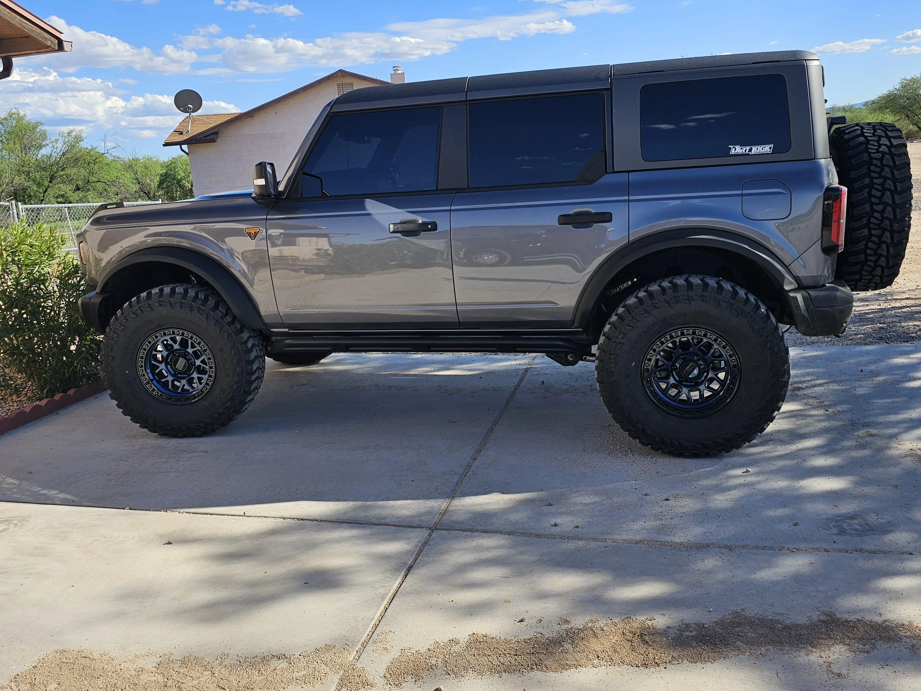

The New KMC Wheels. Poke is just right.

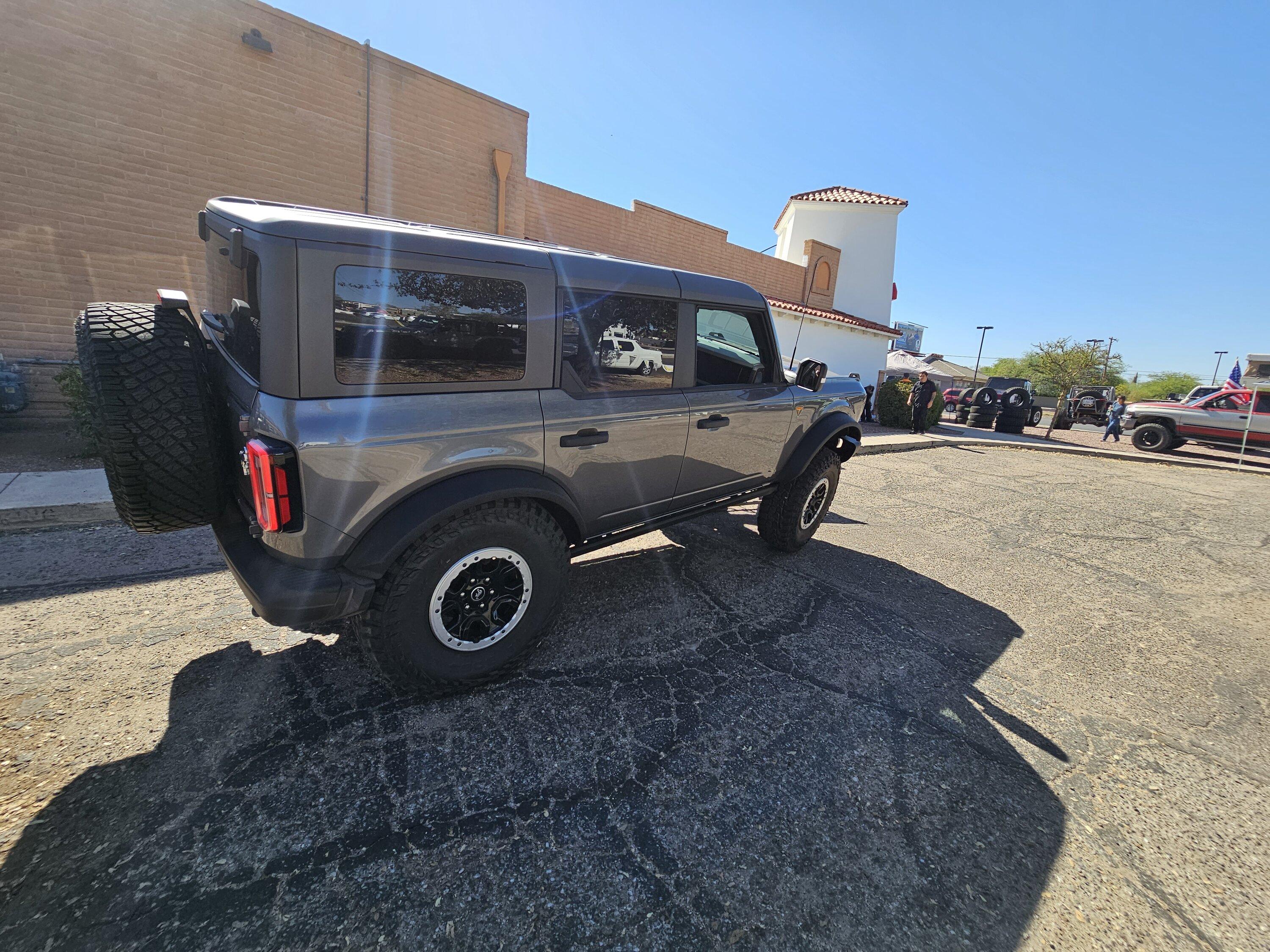

Ford Bronco 2023 Carbonized Gray Sasquatch Badlands - Holy IFS Build 20230809_164852
Ford Bronco 2023 Carbonized Gray Sasquatch Badlands - Holy IFS Build 20230809_171759
Ford Bronco 2023 Carbonized Gray Sasquatch Badlands - Holy IFS Build 20230809_164917

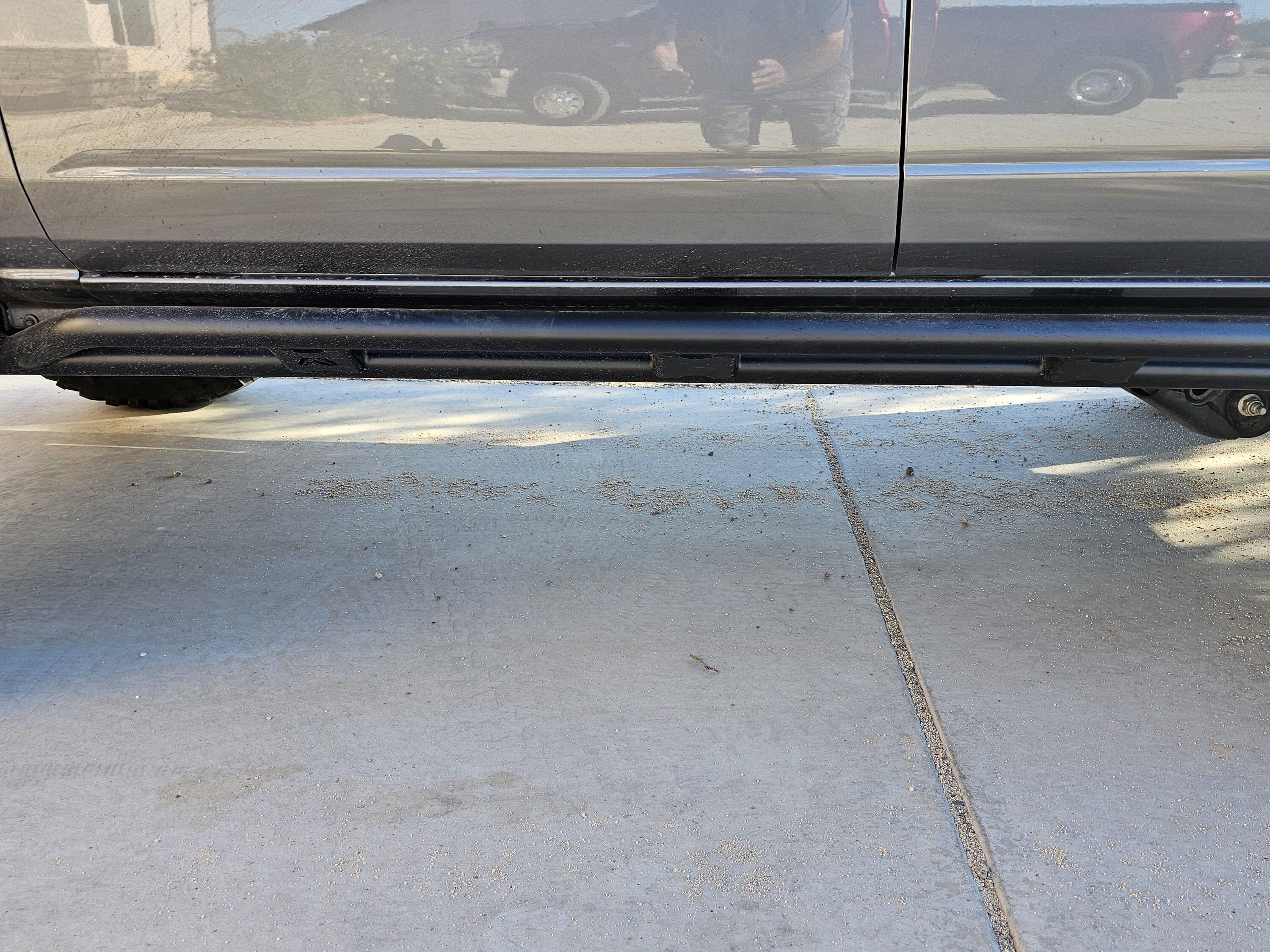

FabFours Rock Sliders
Ford Bronco 2023 Carbonized Gray Sasquatch Badlands - Holy IFS Build 20230809_171748

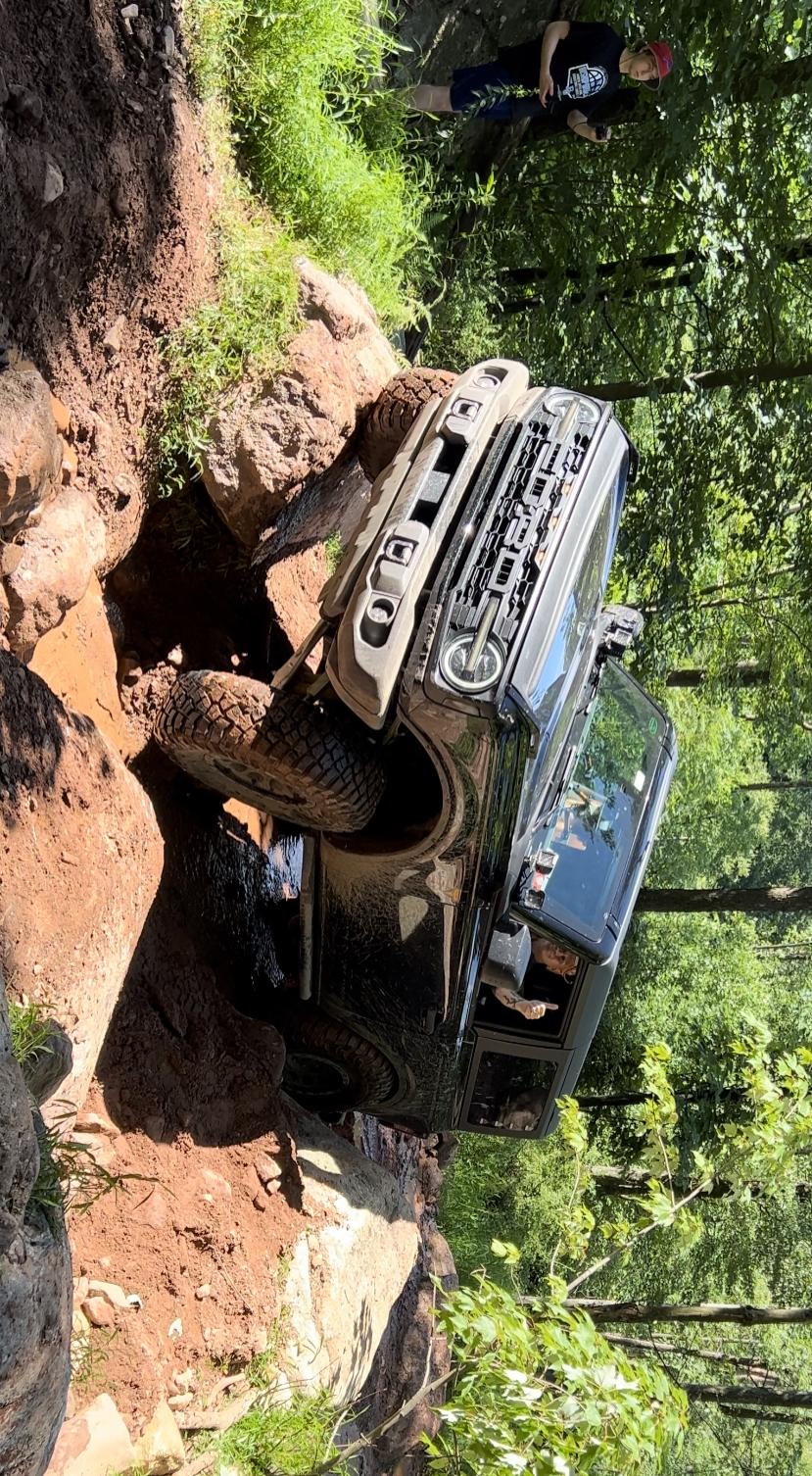

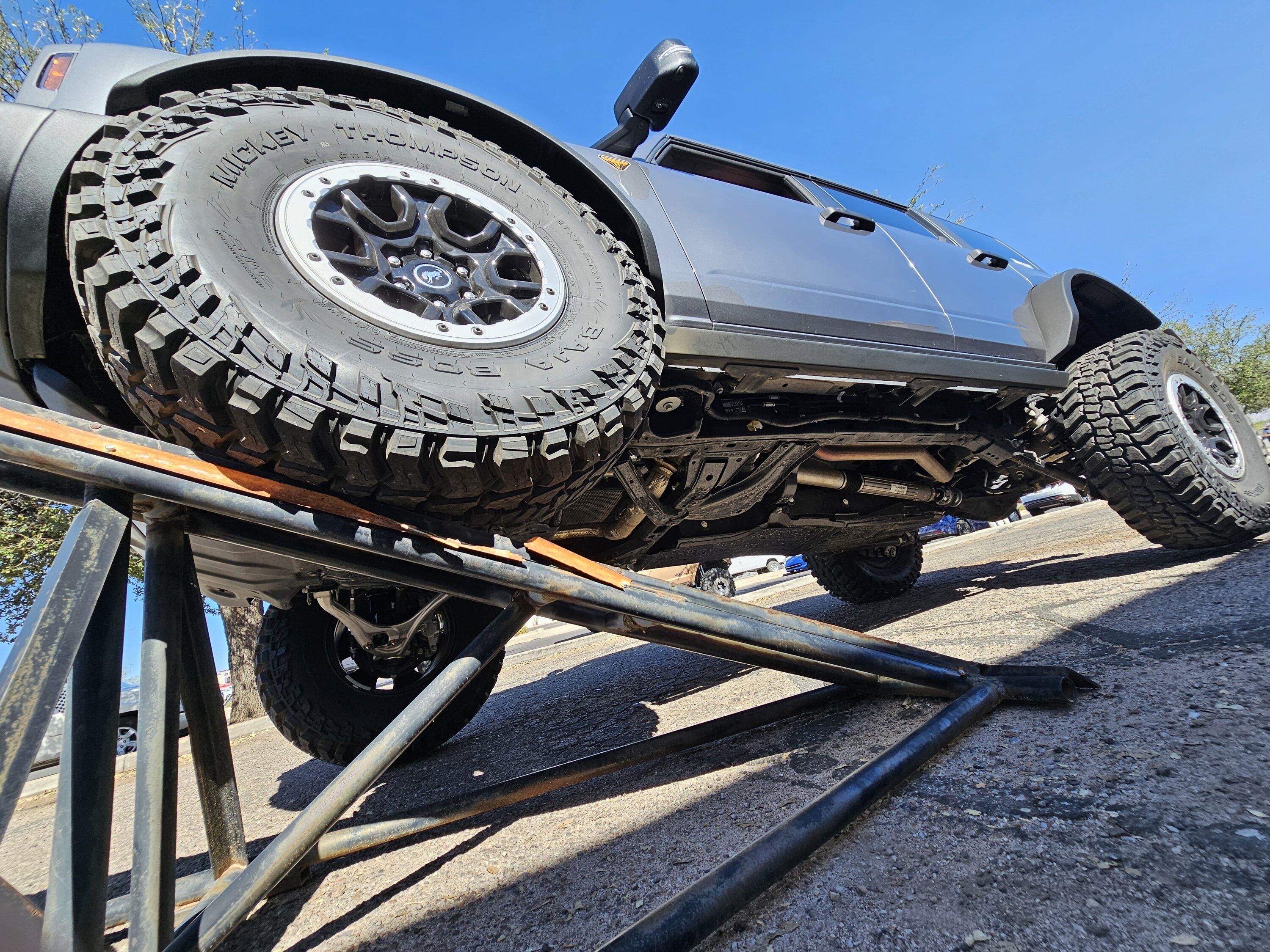

I was a little nervous to put the Bronco on the RTI ramp due to all my Jeep buddies were just looking for a reason to give me Sh*t. I did notice that after they all looked at the interior, they realized that there were many pros to the Bronco, but Jeepers are strange bunch and they wont admit to easily they like some aspects of the Bronco over the Jeep.
Depending on how you plan to wheel, some folks are just gong to prefer the Jeep over the Bronco, especially if its not their daily and have to suffer in cramped interior of the Jeep everyday. I do have a Ram truck but its not my daily and driving the Bronco daily is much more pleasurable then the Jeep. I felt like I had a bit more I could have gone up the ramp, but the spotter just wanted the Bronco off his ramp I think . :p:cool::LOL::ROFLMAO:

I love everything you got going on here EXCEPT for those body mount rock rails. A friend of mine in our off-road club has them and they keep bending up where she can't open her doors. Such a terrible idea. It works for the factory sliders because they don't stick out but when you put that kind of a lever on the end it just spells trouble...
If you're going to do any major rock crawling dump those and get some true frame mount rails. Mine are from RCI and they don't move period. Bolt on, no drilling or cutting brackets off or anything.

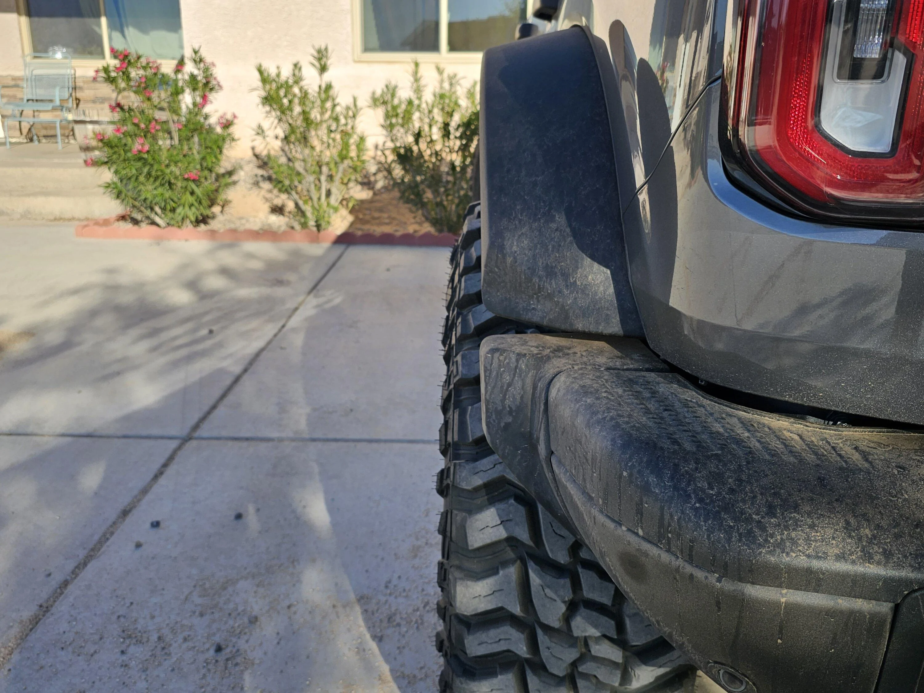

So what RTI did you get? Interesting to see that you dont need to remove the flare at full jounce. Curious what the compressed length is on those Fabtecs/
I have not officially RTI'd mine, but I also have 0mm offset 37x12.5's I have to take my flare off to get full stuff. Running just a 1" level on stock badlands (non-sas) coilovers. The flex is incredible for stock IFS but I definitely am in danger of kissing my fenders if I hit some whoops at speed. Need a more appropriate solution eventually.
The solution is aftermarket fenders. I took my flares off and still rub at full stuff (37's, Eibach 2.0 Coilovers, 1" wheel spacers on factory SAS wheels, DV8 inner fenders, Icon UCAs).
I still need to RTI mine as well... Metalcloak had their CTI trailer at one of our events earlier this year but I didn't get a chance to get on it.
Yea, I agree, fenders are the best solution. but it seems we only have a couple options that really increase clearance, 3 if you count the unobtanium APG kit lol. Wish there was someone willing to make a basic OEM clone that just raises the wheel arch and doesnt break the bank.
FabFour claims they have stress tested these and the y will hold up. I guess we will find out. I have had aluminum sliders on jeeps that held up fine as long as you do not drop the entire vehicle weight on them, like dropping off a rock. Pivoting around a boulder or sliding should not be an issue.
What wall thickness and brand off slider is she using?
Probably wont be doing teh same trails like the XJ....but you never know!
I didn't get the RTI number, I forgot to ask. Even if it rubs the flare on full stuff, I am not to worried about it since they are just plastic. I do like the fender delete look, but I am already getting rocks etc hitting the doors.
I looked at aftermarket fenders....but the are all ugly. Some of the fiberglass ones are nice...but not a good idea for rocks.
