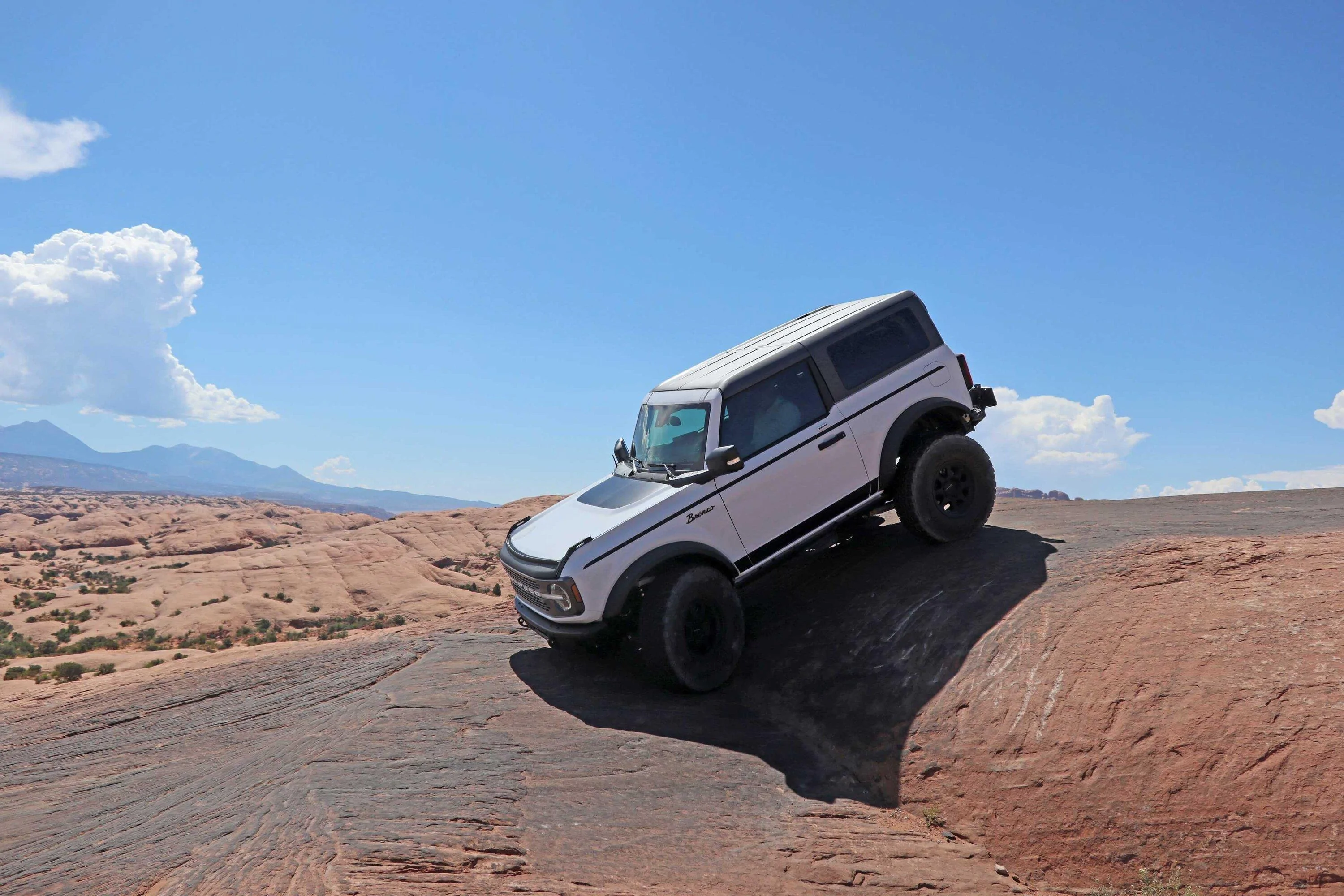

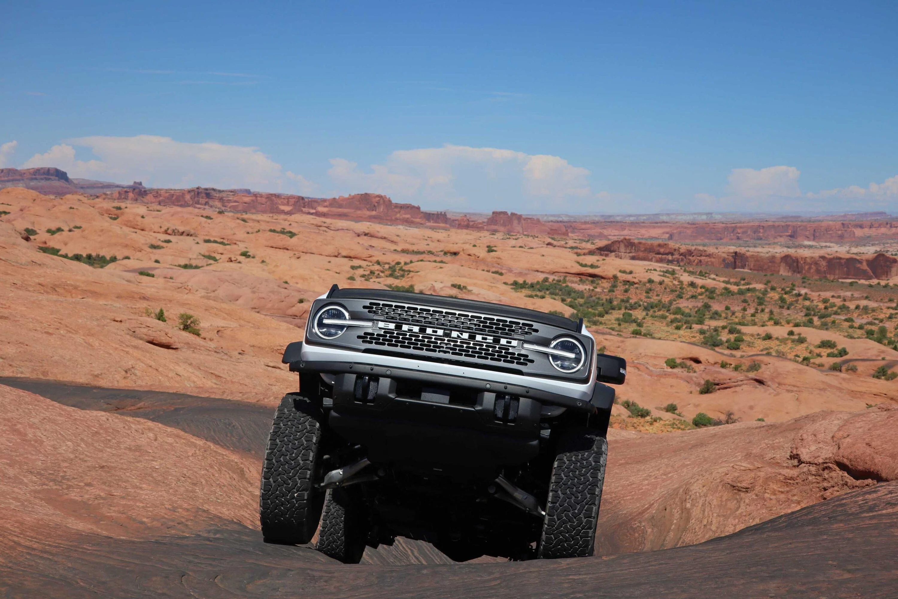

A few other pictures from Hell's Revenge. Yes it climbed the wall without a problem.

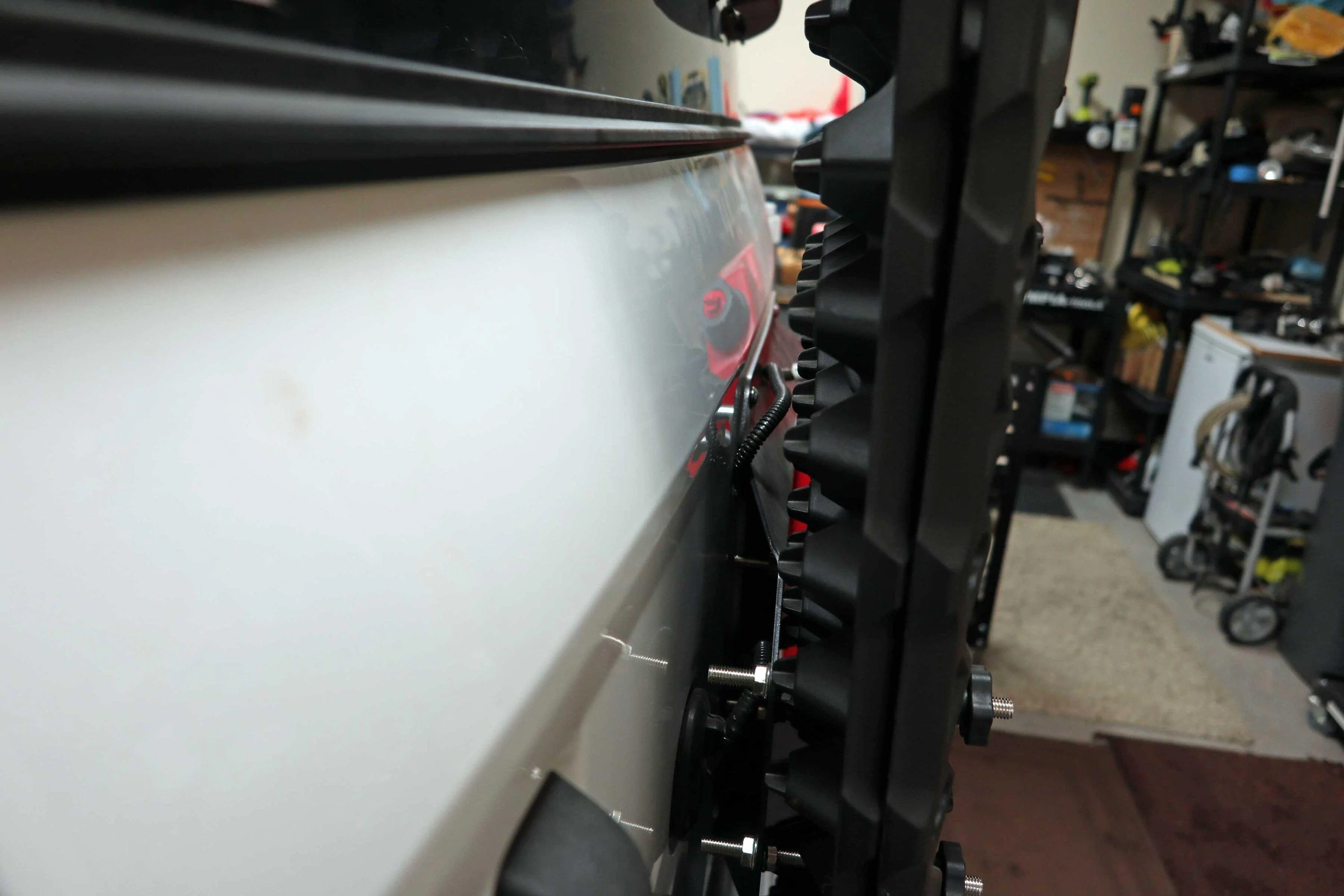

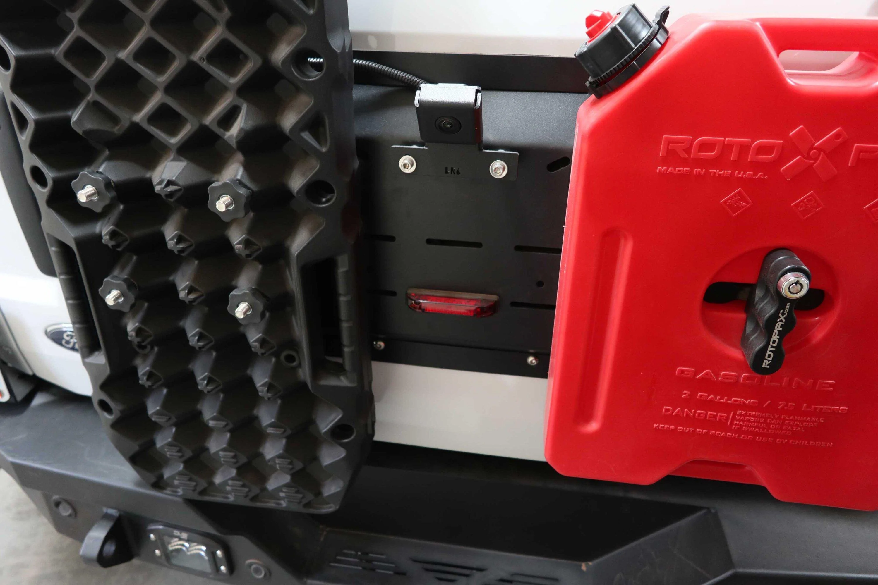

I am interested in the JCR spare delete because it gives the opportunity to use rotopaX options as you have done. However, I see the left and right sides have a gap away from the tailgate. My concern (like other spare delete products) is the "exposed" wiring. Could I please ask you to take a photo from the left hand side showing that gap and exposed wire?
Do you feel the wiring is protected and the design is good? I can't decide between the functionality of the JCR set-up and the SRQ option of completely covering the wiring behind the bracket and having a bottle opener in the hole - but losing the functionality.

I used the JCR back shelf (inside) and was very impressed with it. Solid and strong. In fact I mounted my ARB twin on the bottom side, and it holds it fine and does not resonate the sound. Having said that, I am not that impressed with the tailgate delete. First, if you use the license plate it is designed with, your rotopax and in my case the rescue boards will cover some of the plate. Second, the license plate assemble is kind of cheap looking, almost like an after thought. They also did not include all the parts needed for the camera, and that bracket didn't look great as well. So my builder used the license plate bracket that came with the DV8 rear bumper and then modified the camera bracket and third light position. There is some exposed wire, but it does not bother me. Would I do that again? Yes, because I like the way the rotopax and rescue boards mount, and even with the install problems, I like the way it looks. I hope this helps you.

Thank you and I appreciate your effort to take the photos. Those show what I wanted to see. It does help me - now I know I need a combo of the two!!! So I think I am sitting a little firmer on the fence :unsure:. (I saw that issue with the license plate but thought I would ignore it.)

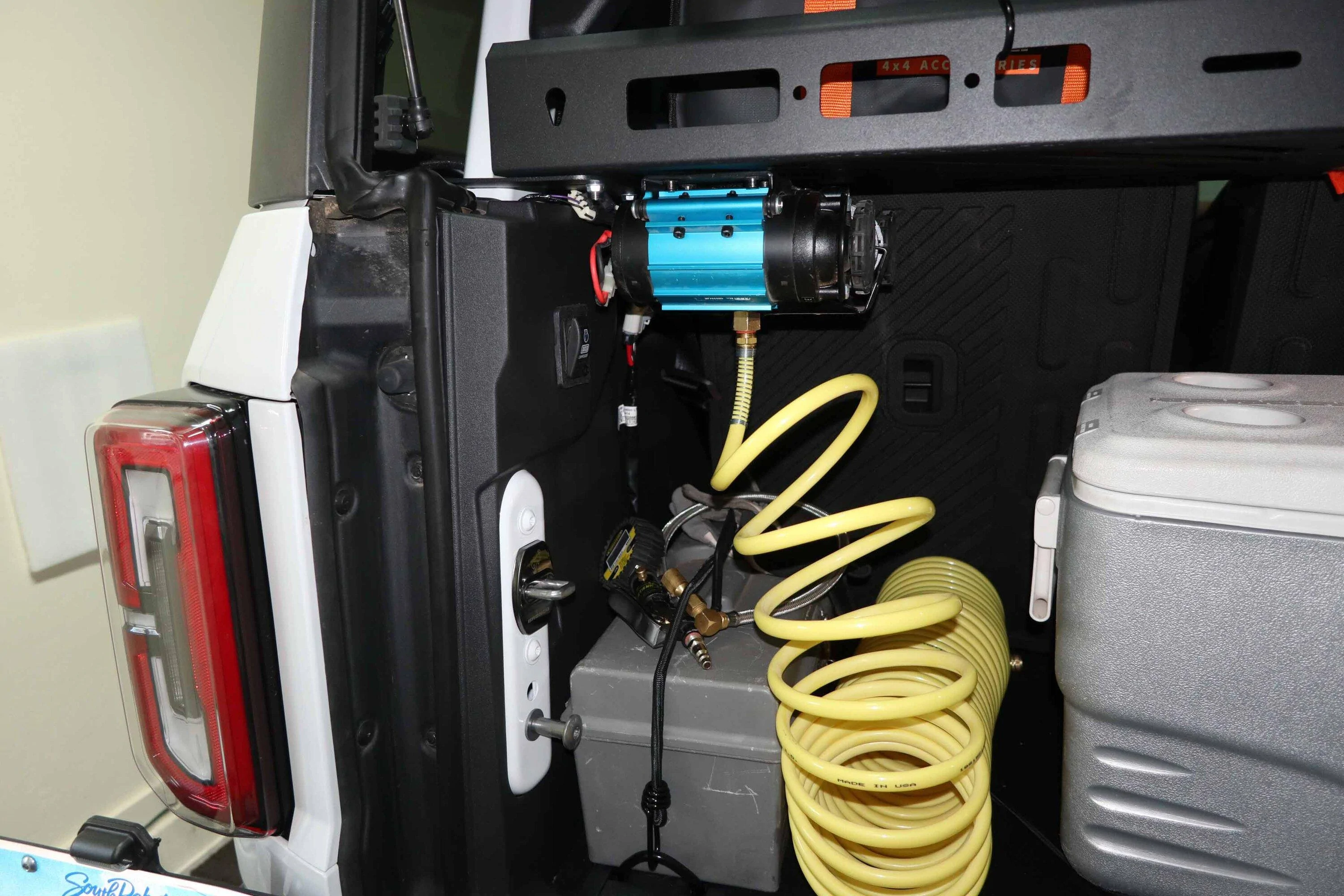

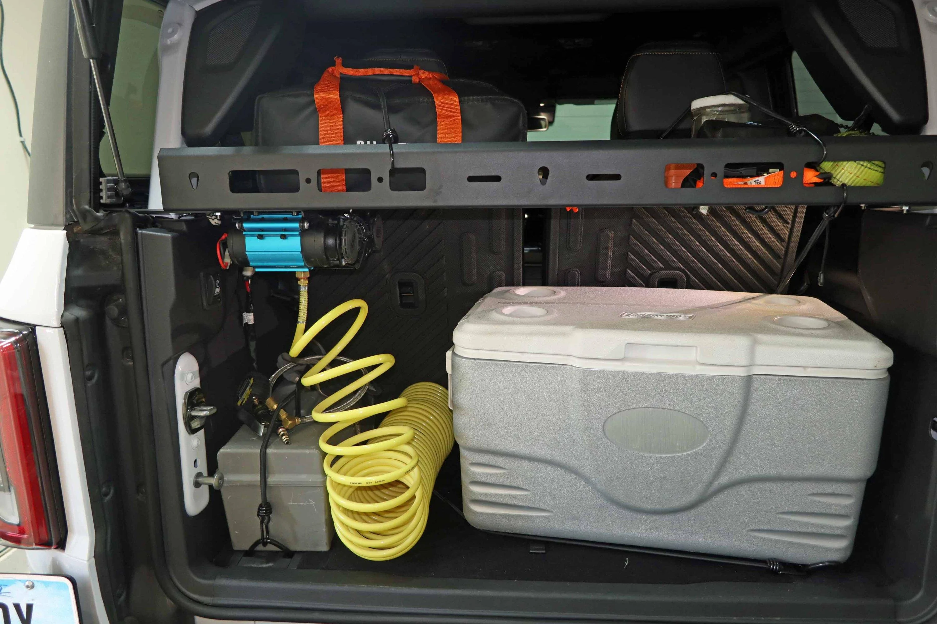

Now I am interested in your ARB twin! How did you wire that from the battery? Underneath and along the frame? What gage? Picture please!

The ARB install went better than I expected. I was worried that the shelf would resonate and increase the noise from the compressor. It didn't. Beneath the compressor under the carpet is a hole through the metal, covered by a grommet. He cut the center of the grommet and ran the wire down the side through the floor and along the frame all the way to the battery. Since we mounted it on the driver side, that is where the battery is. Mounted the two 40 amp fuses at the battery, and then mounted the on/off switch on the side panel under the compressor. I bought extra large coiled air hose that reaches all 4 tires easily and is light. I need to put a couple of brackets to fasten the wire to the side panel, but for now it is fine. That side panel is so thing that he had to use a plate to mount the switch, and then mount the plate to the side panel. I also had a plate for the ARB that I had used on my F150 Raptor, and he cut that and put it on top of the shelf to sandwich the shelf between that plate and the ARB.
