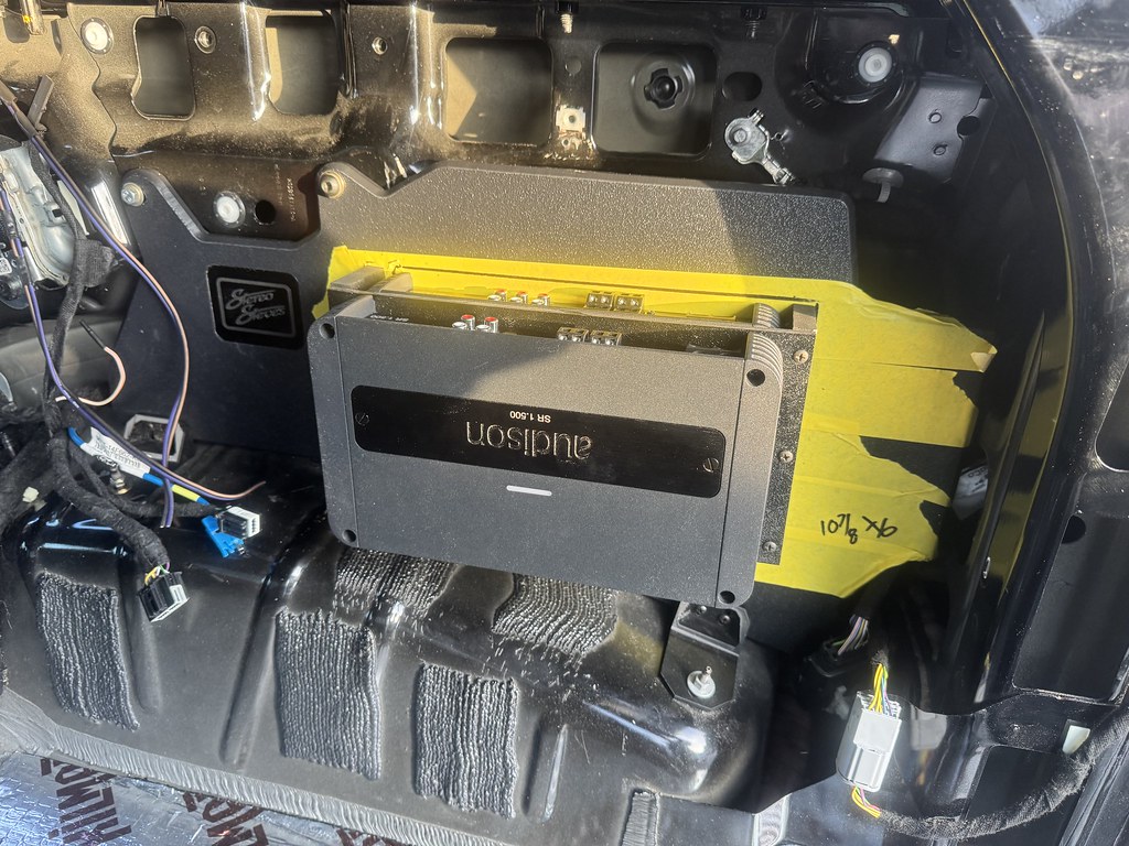

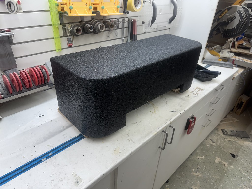

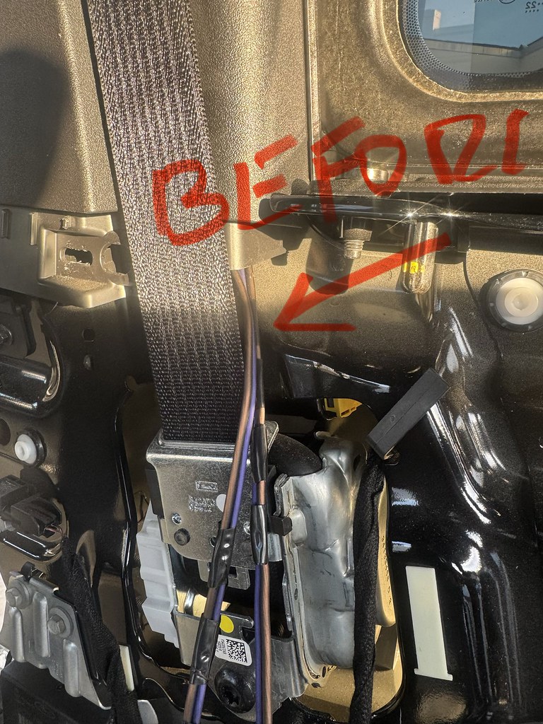

I don't know what to say about this install other than its the worst I've ever seen. This is a kids Bronco, he's in town for the holidays from out of state college. I will be removing the amps and cleaning up everything they did to make it safe.
Installing:
Mobridge A2B Standard
Audison 4.500
Audison 1.500
(2) JL 10w6v3-D4

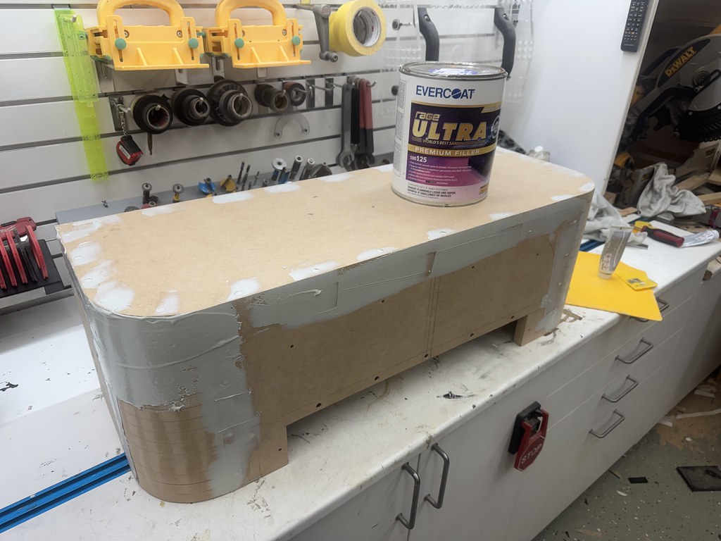

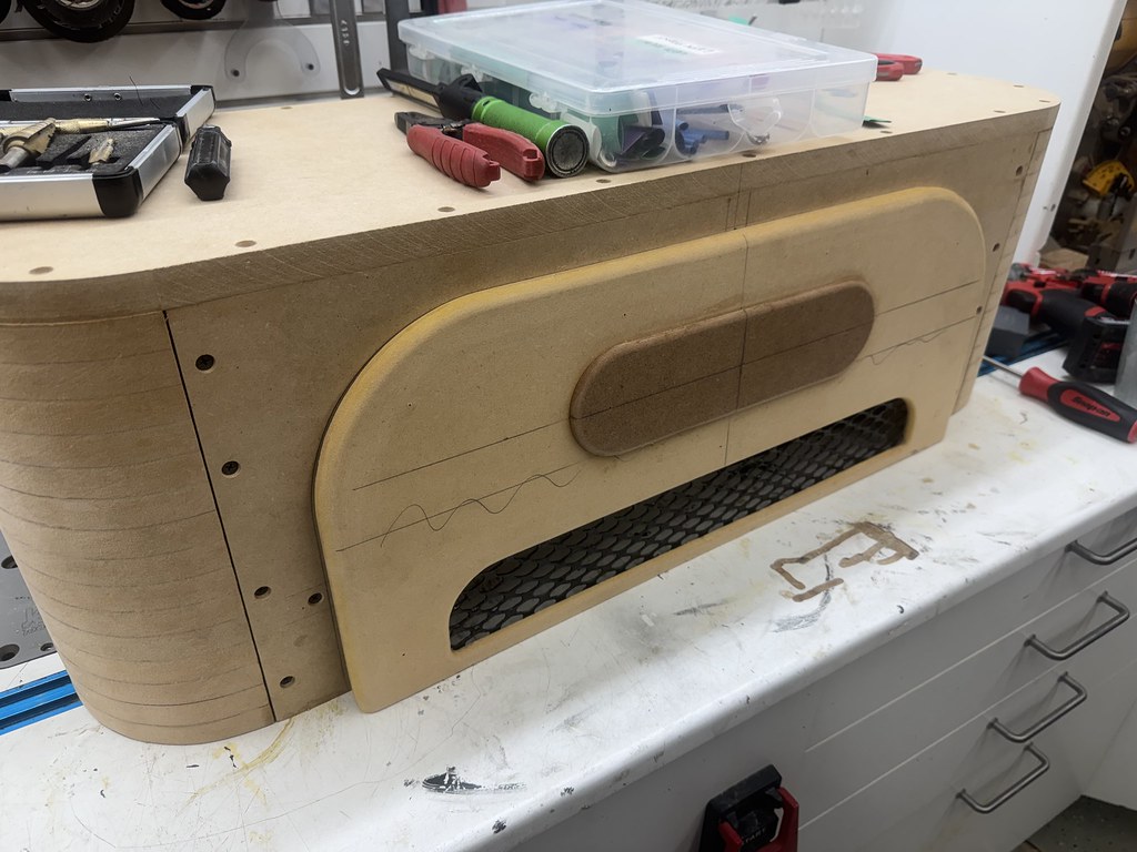

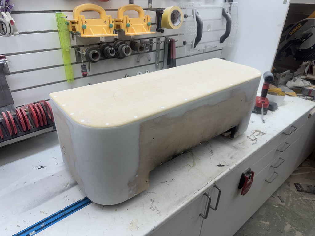

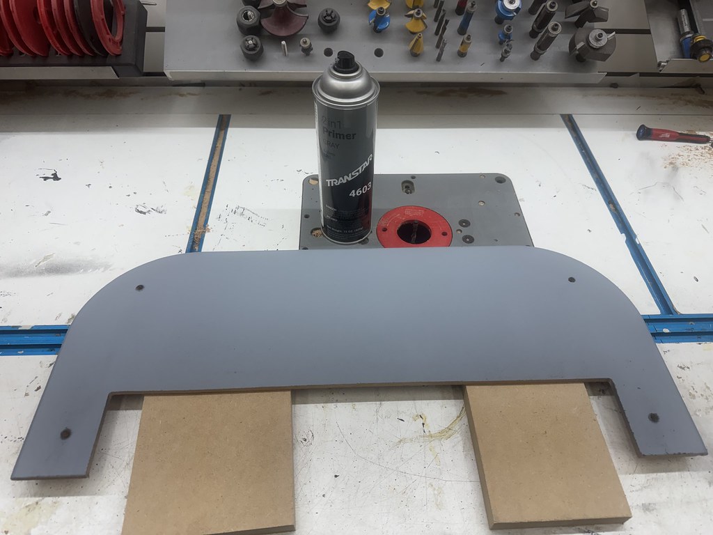

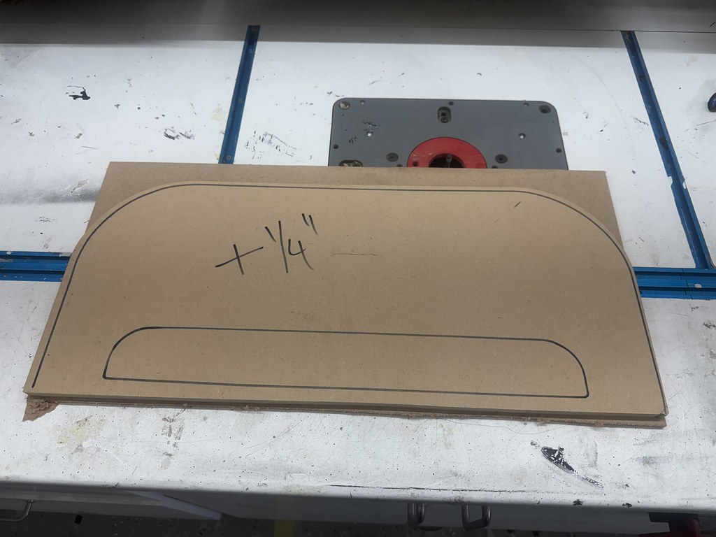

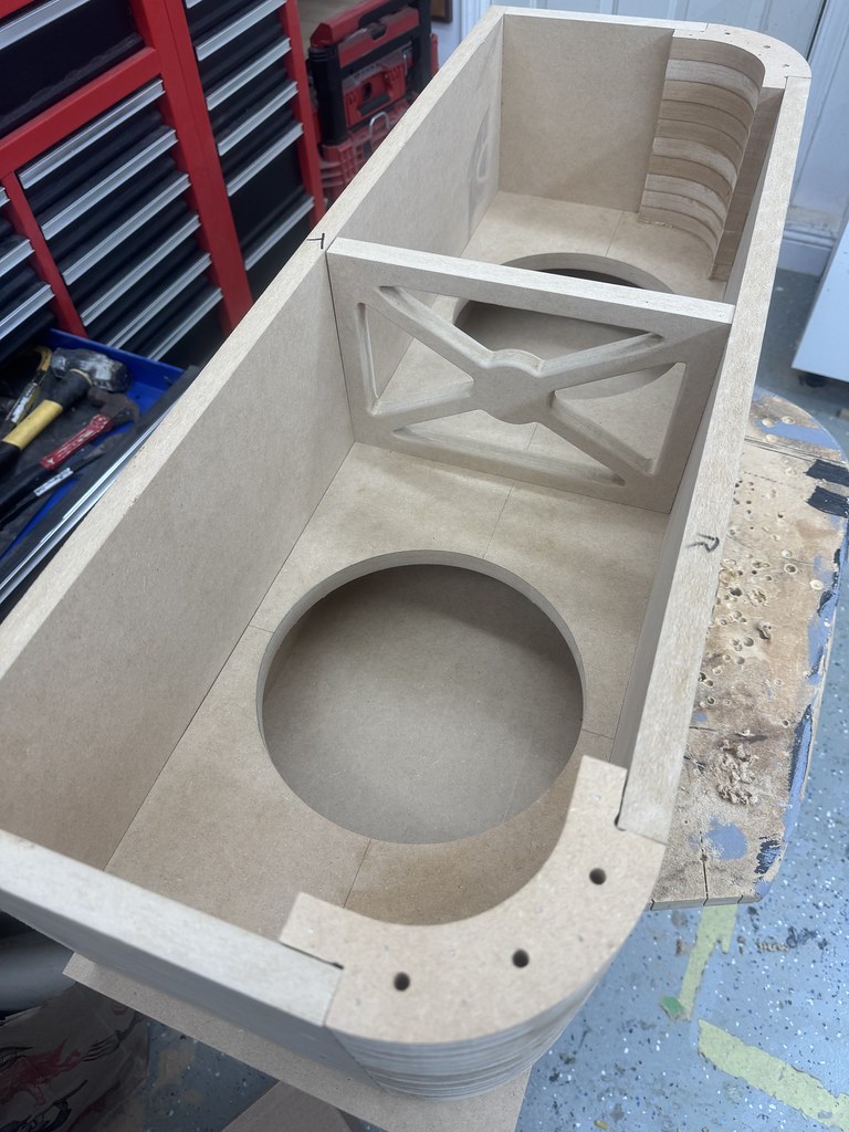

Building a sub enclosure

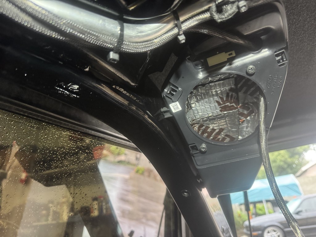

Going to run the existing Kicker speakers until he comes back for the summer and install dash pods and Focal Performance 3-ways
The first two photos are videos but wont play when clicked. I guess you have to go to my Flickr???

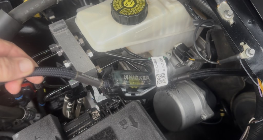

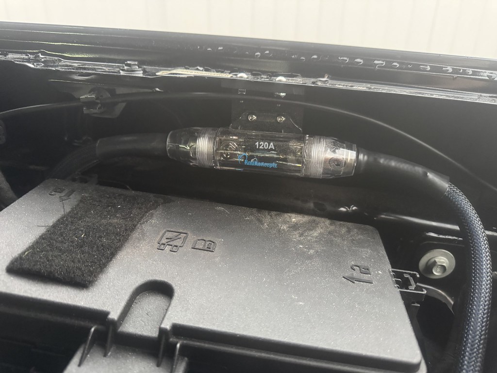

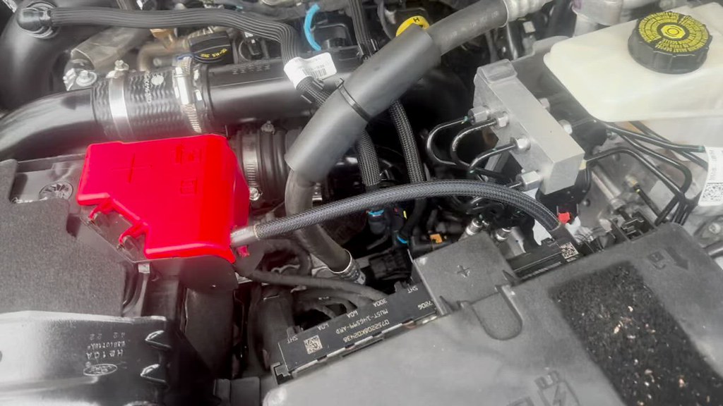

At least I see a fuse in that kick panel picture.
Just not sure it's going to anything on the stereo install.

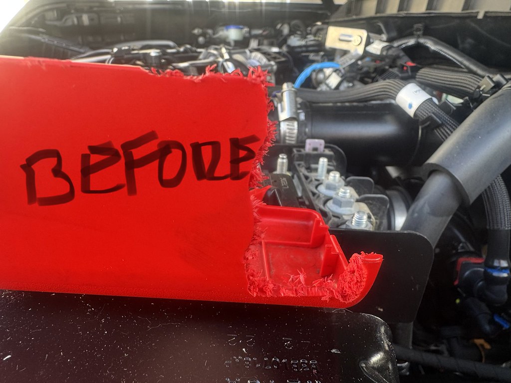

For kids... honestly, apart from the fact that I don't see a fuse coming off the battery... not the worst hatchet job I've seen (or, I have to admit, done myself in my younger days)
If they had just taken a hot knife to the battery positive shield to clean those cuts up it would have almost looked professional under the hood.
Hopefully you are teaching them the better methods as you are doing the work - they seem to have got it working in the first place, which is half the battle.

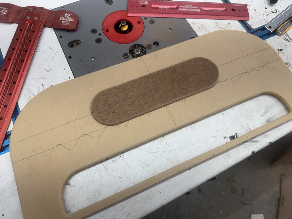

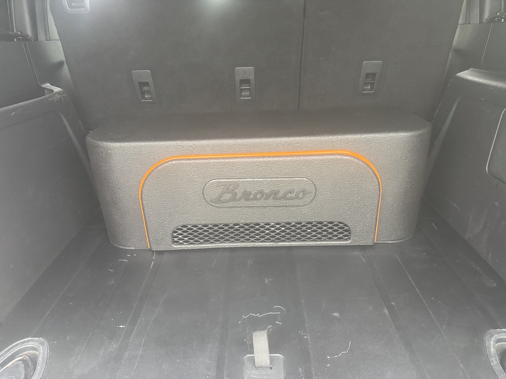

p.s. can you teach me how to make those enclosures - that looks nice.
The kid took it to a "professional" shop to do the work. You really need to go to my Flickr account and play the two videos, then let me know what you think.
Watch Car Audio Fabrication on Youtube for building the enclosure
oooooo.... if someone got paid to do that....
Ford Bronco 911 Stereo system rescue 55003793371_737a854400_b
Thanks for the Youtube tip!

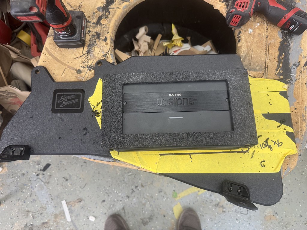

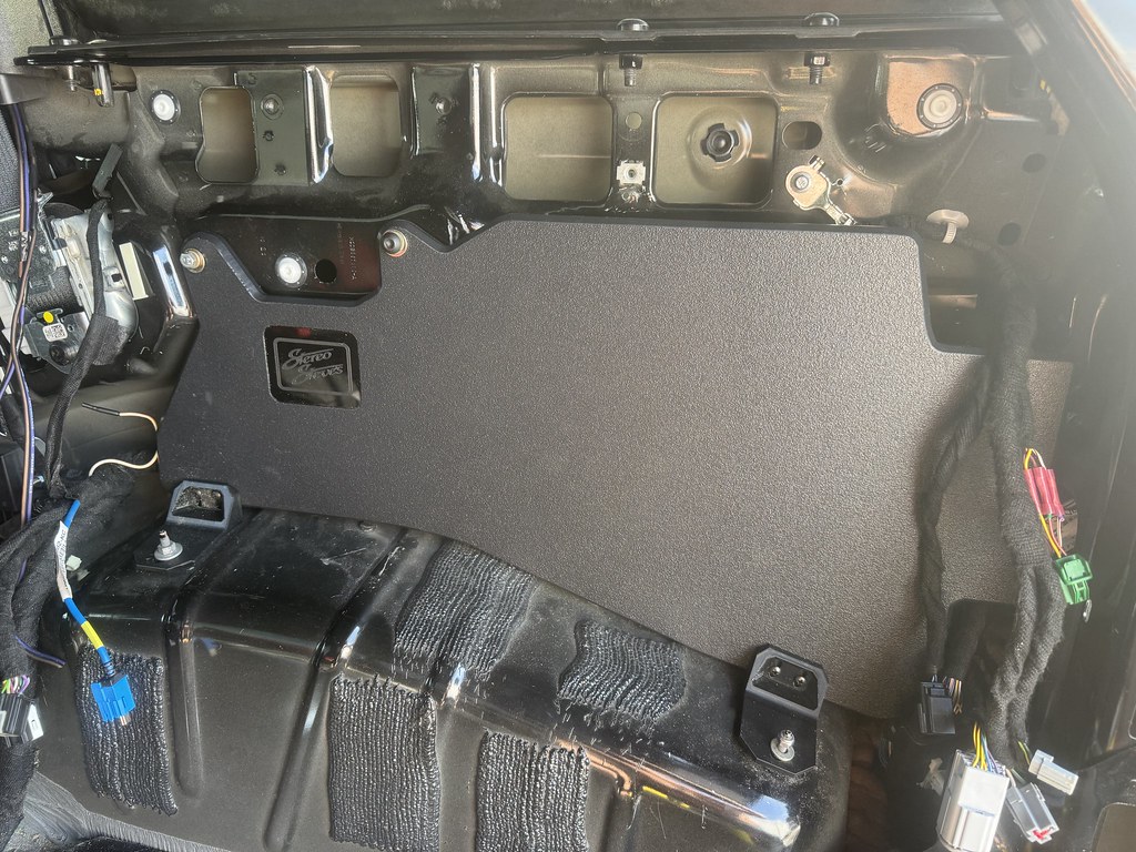

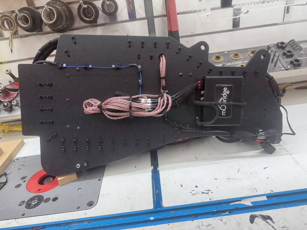

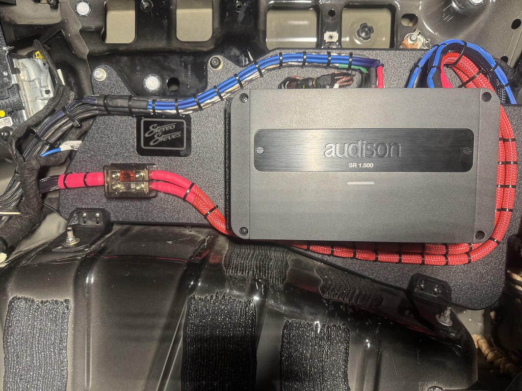

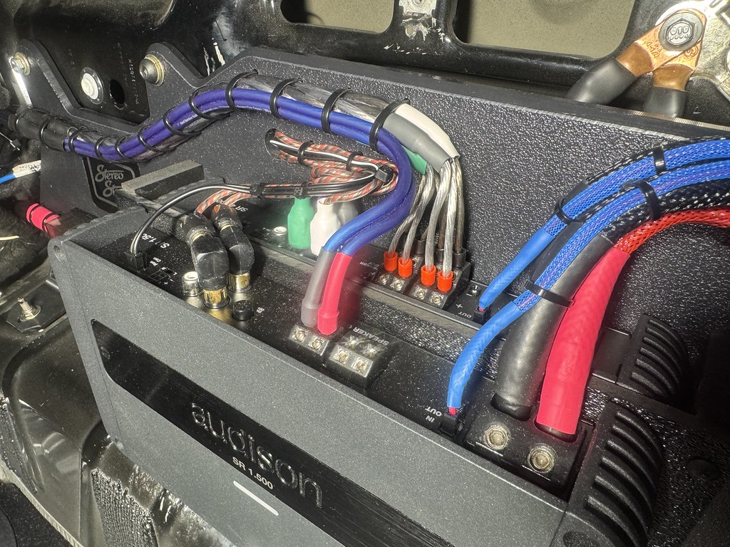

The amp rack is from https://www.stereosteves.com/ I was sketchy on the time frame that i have with the Bronco to get the amp rack in time but Steve came through. He has them in stock and got it to me super quick. It fits perfectly.

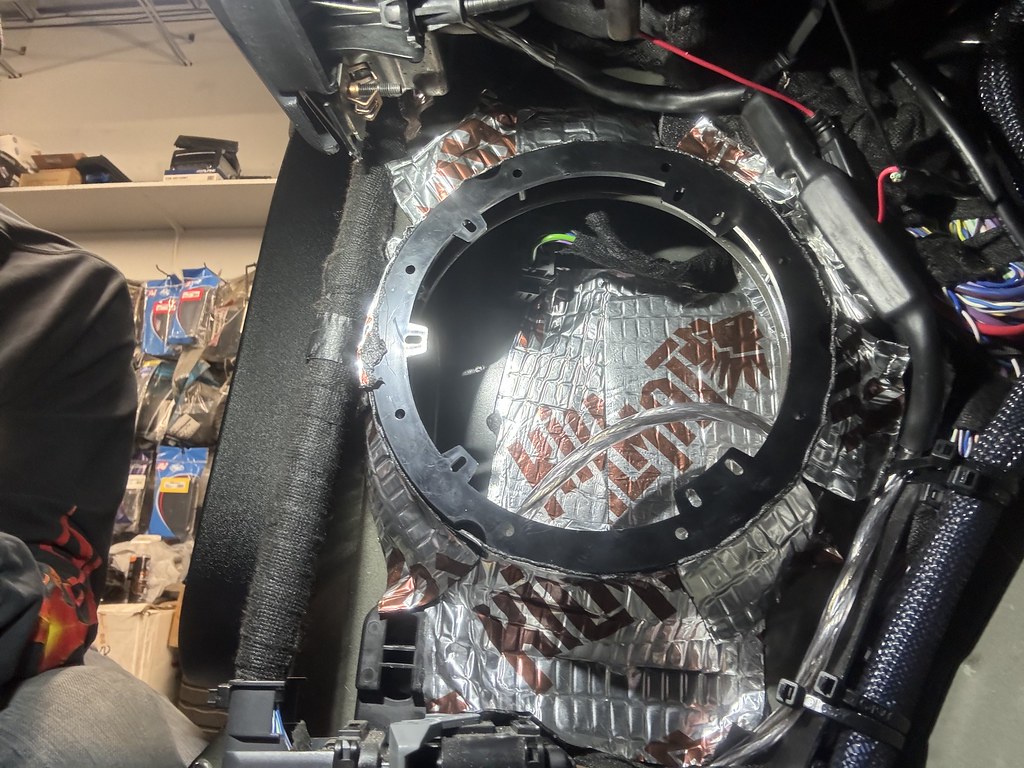

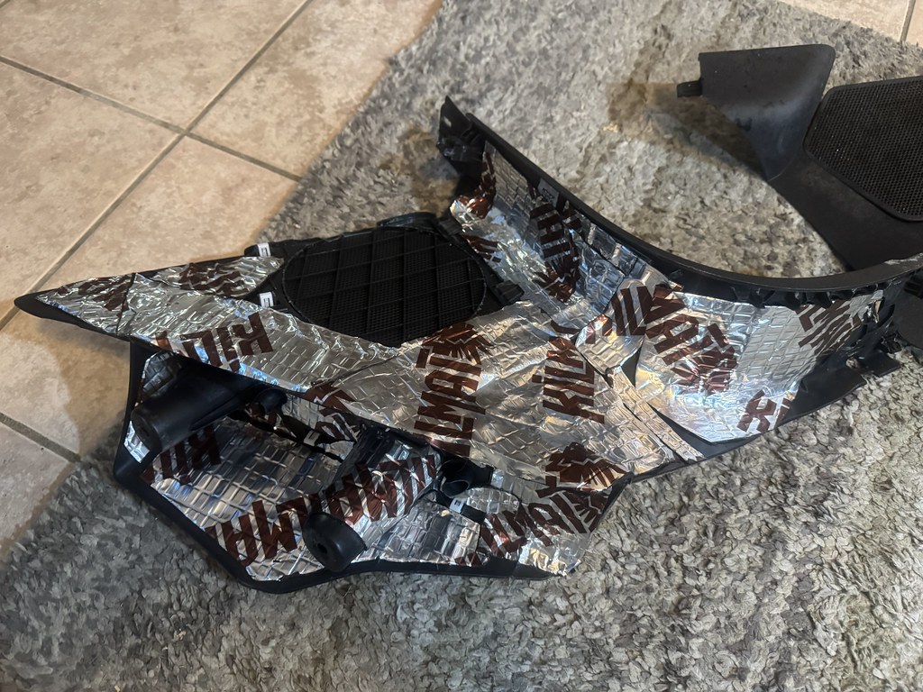

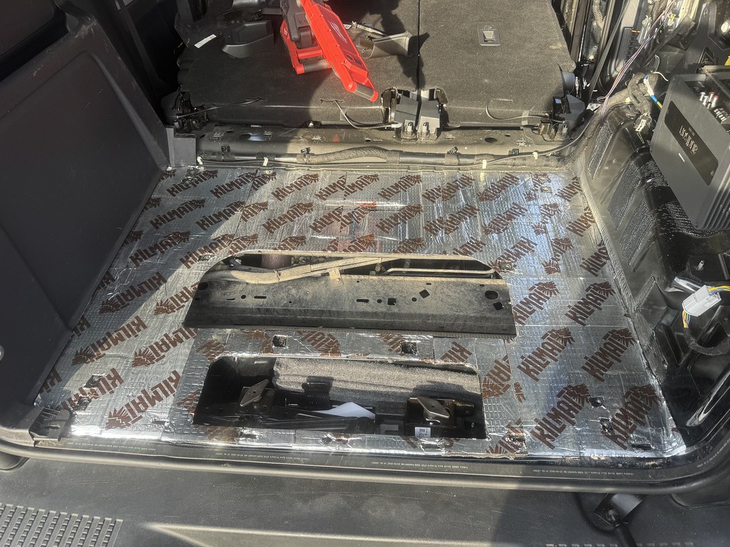

My #1 is also my sound deadening specialist

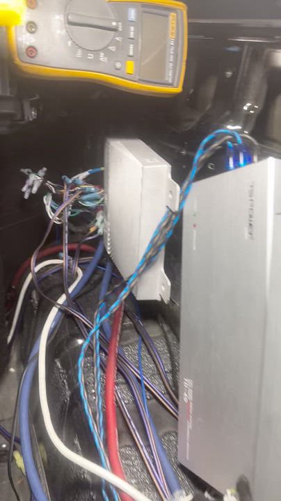

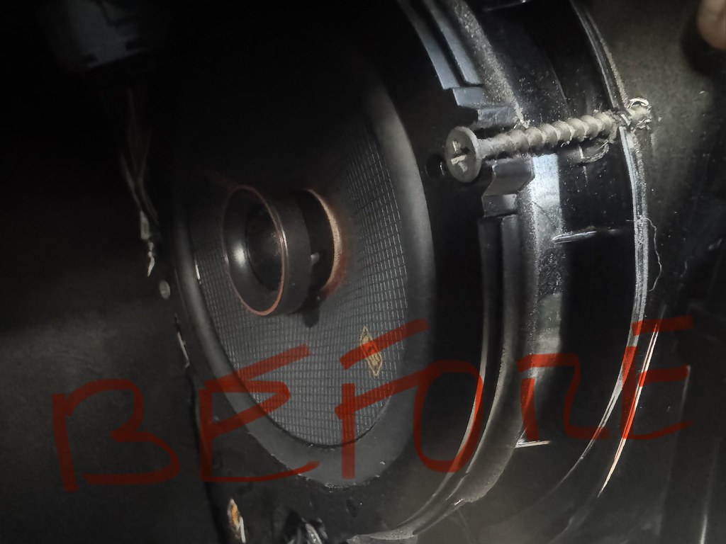

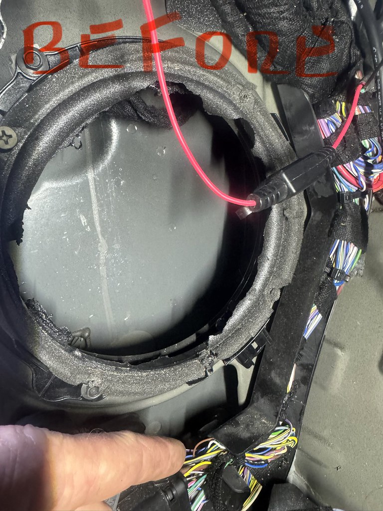

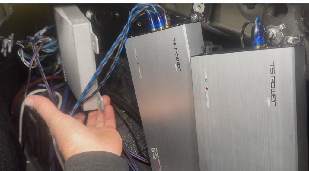

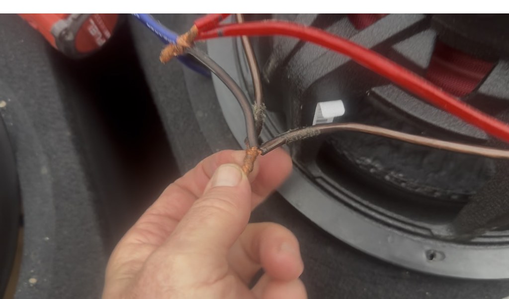

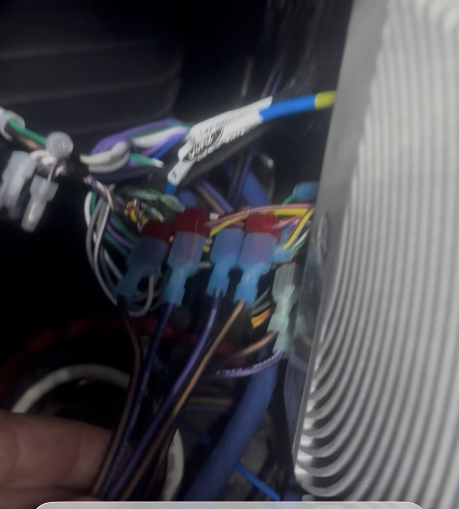

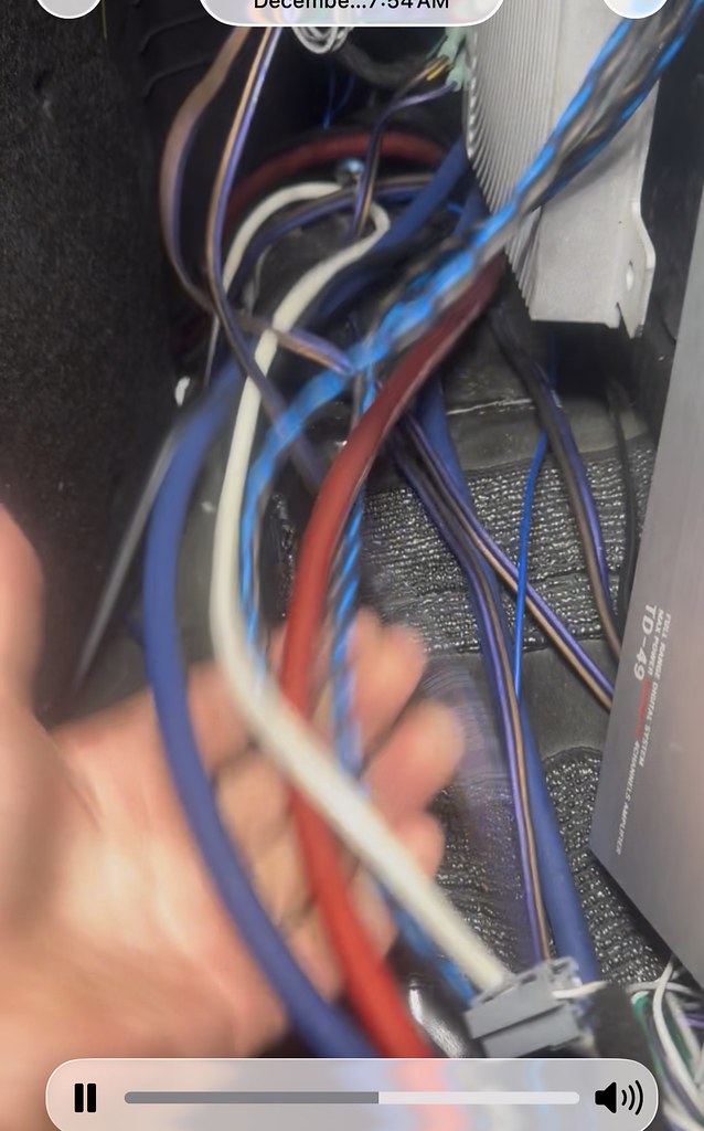

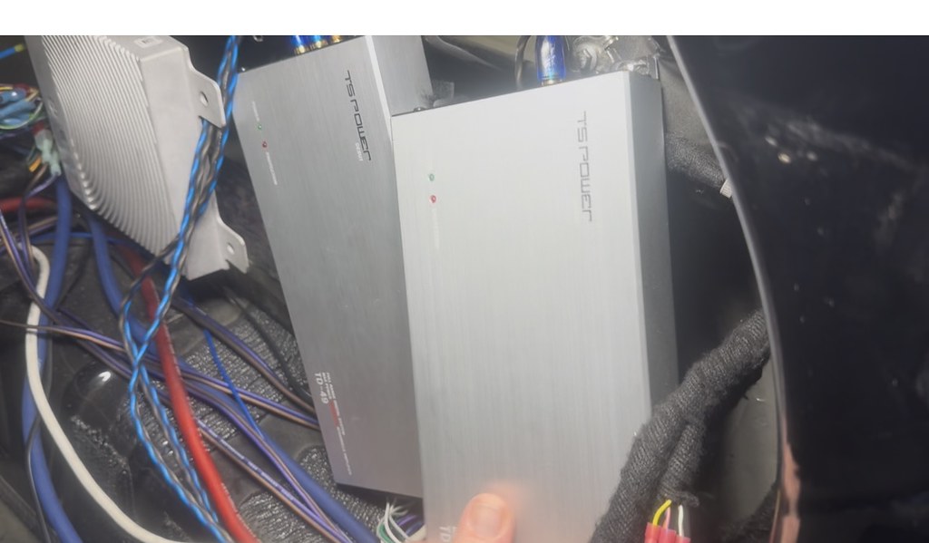

Some screen shots from my two videos:
-Main fuse not secured, not bolted/screwed done. Not a zip tie to be seen
-sub, 4ch, and B&O amps secured with one screw each
-sub wiring twisted and tapped
-butchered factory B&O wiring
-non secured wiring

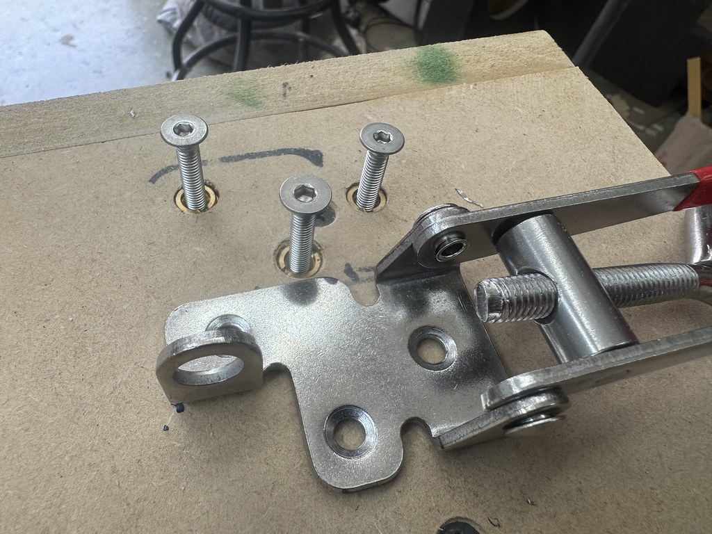

Awesome skills, that enclosure and securing system are amazing
