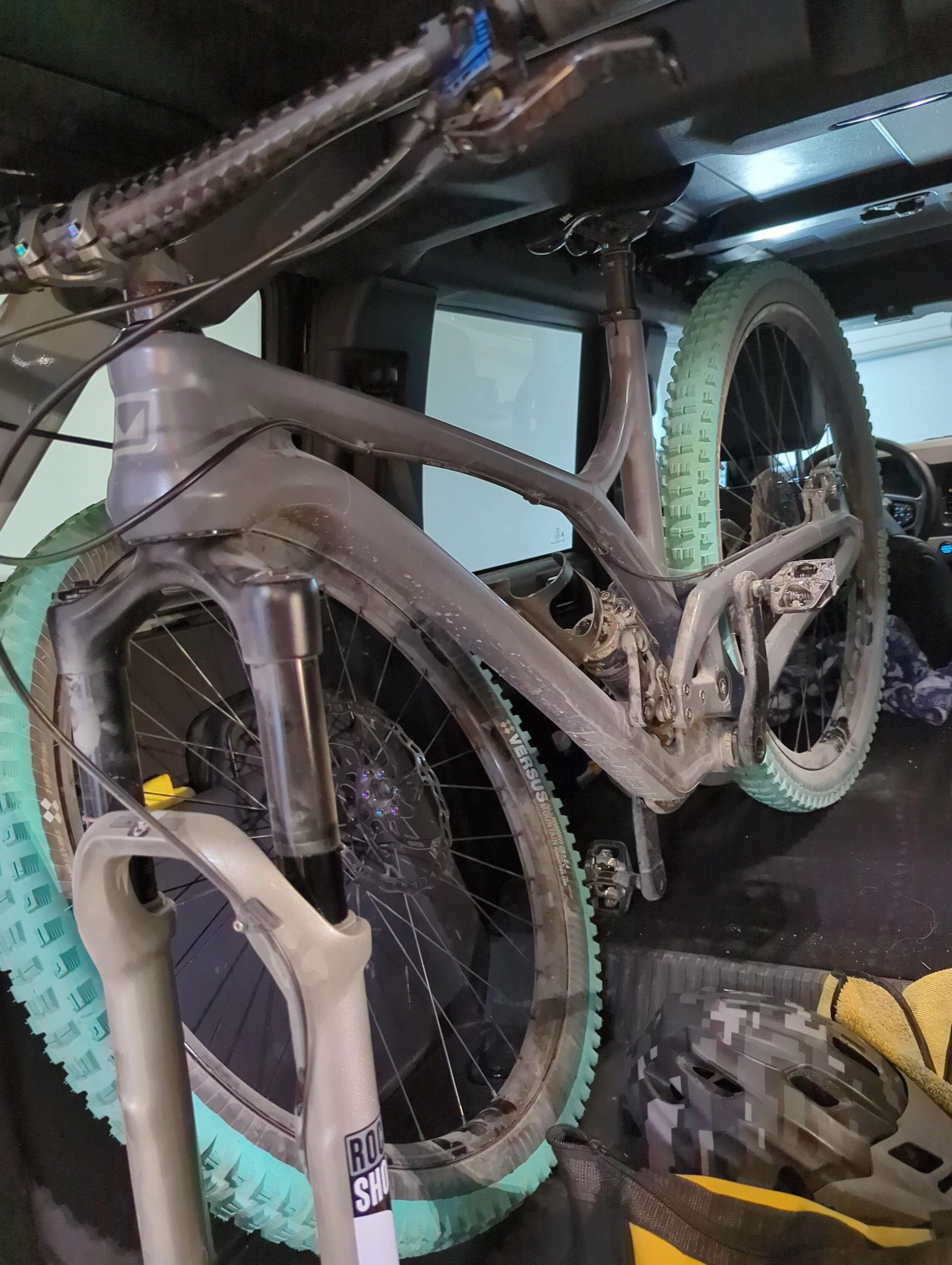

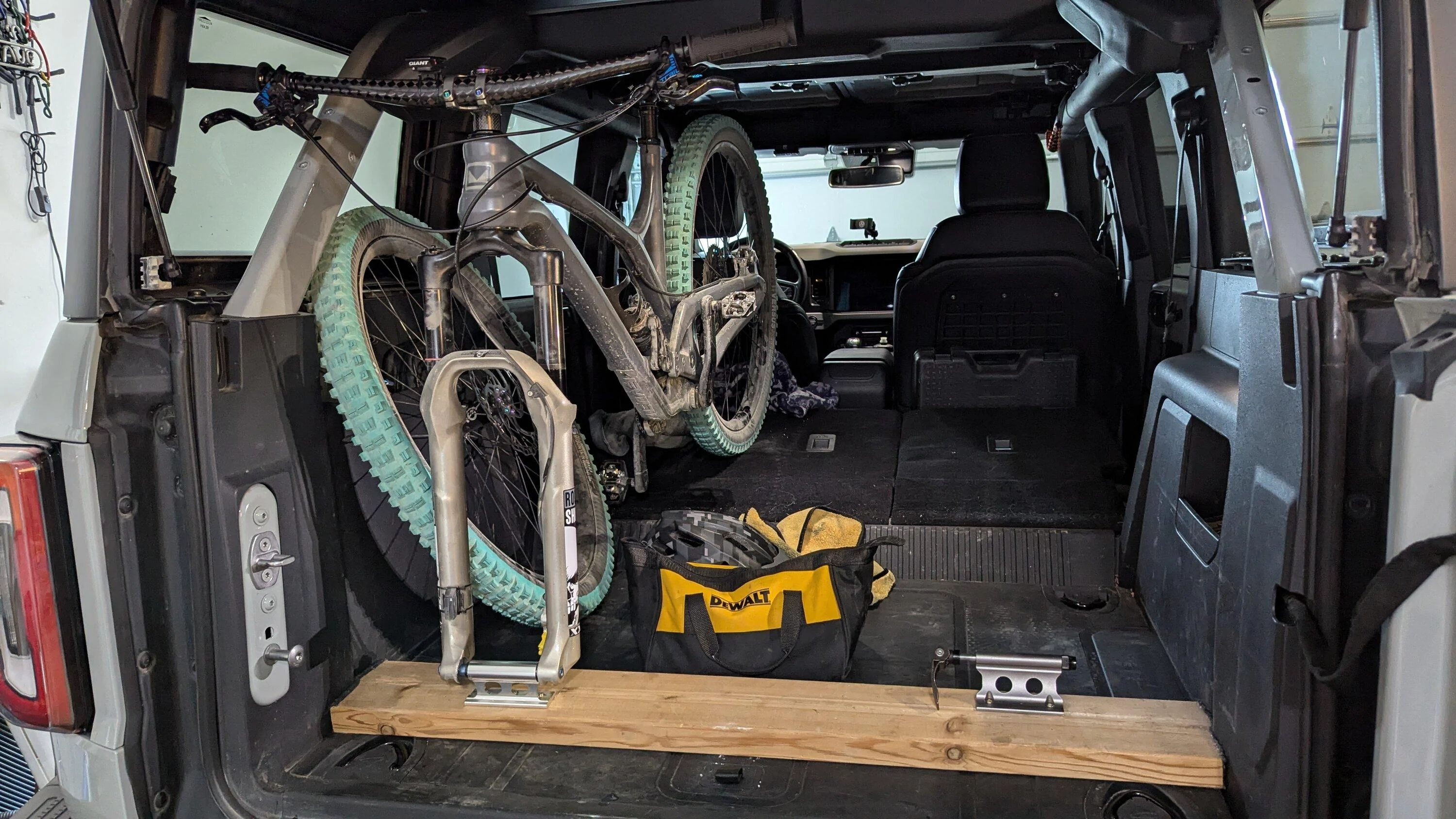

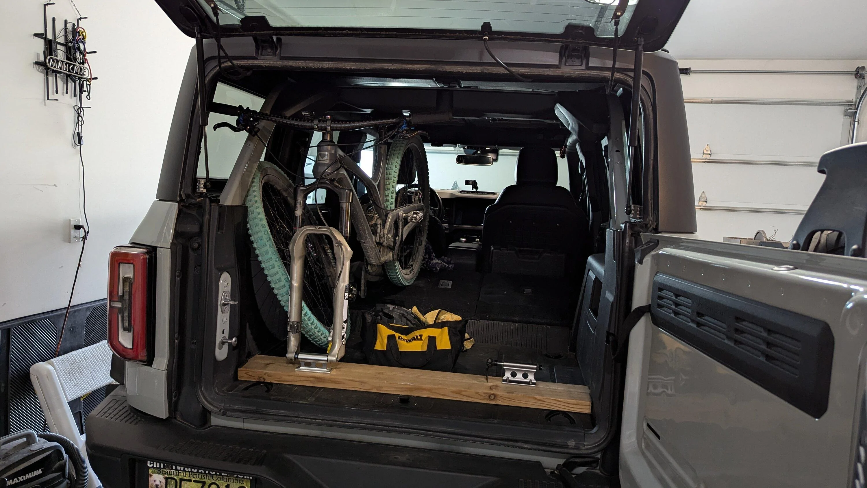

So I didn't like any of the racks available, and I didn't want my bikes hanging off anything. So I made this fork holder rack with a 2x6 and a couple fork mounts. About $60 total and a jigsaw. Works great.. for my bike to get it snugged in there I just hit my dropper post switch and the seat ramps up into the rear support brace. Bike doesn't move around or shake at all. Tires are in perfect location to strap down to the back of the seats if you wish... To the child support bars back there.
Took about 35 mins to whip up!

I have a similar setup. To prevent the wood from sliding, I stapled an old inner tube to the bottom of the wood. Works perfect.

I have felt on the ends, kinda of wedging the board in place. If I needed to I was going to strap the fork mount to the tie downs! But it hasn't been needed!

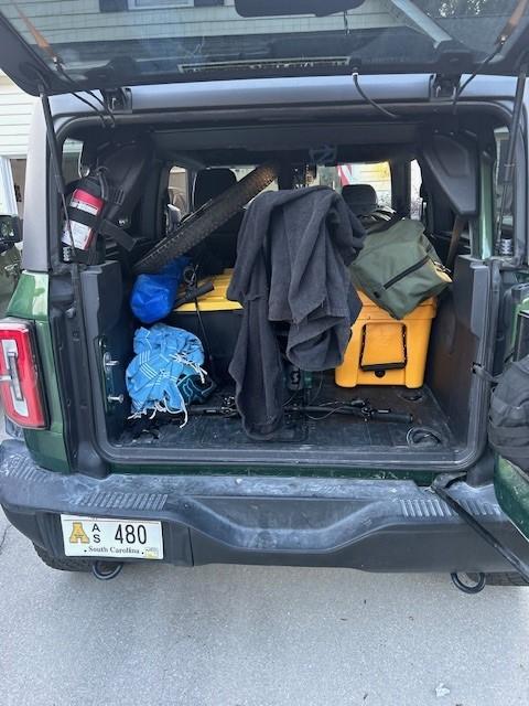

Not true - I have a large Transition Spur, it fits perfectly with the front wheel off. Here it is with all of my camping gear. I normally use surf straps to strap the fork to the tie downs so it won't move.
Now......I have no rear seats, that complicates things a bit (although it did fit when I first got the Bronco).
With all of that said, I'm debating a 1UP rack right now. I just don't love having to work around it every time I need to access the rear cargo area (which is a lot).

Nice work. Nothing like sweating bullets every time you go "iN" somewhere with $16K in bikes sitting on the back of your rig! All the cable locks in the world don't give me a whole lot of solis from a motivated thief. Just don't let those bars hit that side window. How did you bolt to the floor? I will have to look into this...thanks for posting. OH...I wish Maxxis did green tires!

I prefer the handlebars on the floor, it provides a more stalele base, and then it's just a strap through the tie downs. Standing it up is problematic loading/unloading.

It's not bolted to the floor. When the bikes aren't on it the whole thing comes out and leans up against the wall of the garage. The way it fits in its sturdy and doesn't move at all with the bikes on it. You could strap it down with the floor mounts if you wanted to tho. The bikes don't move side to side at all. So no worry about the handle bars touching the windows.
Oh, and the tires are Versus. They have been pretty good so far! Look cool to lol
