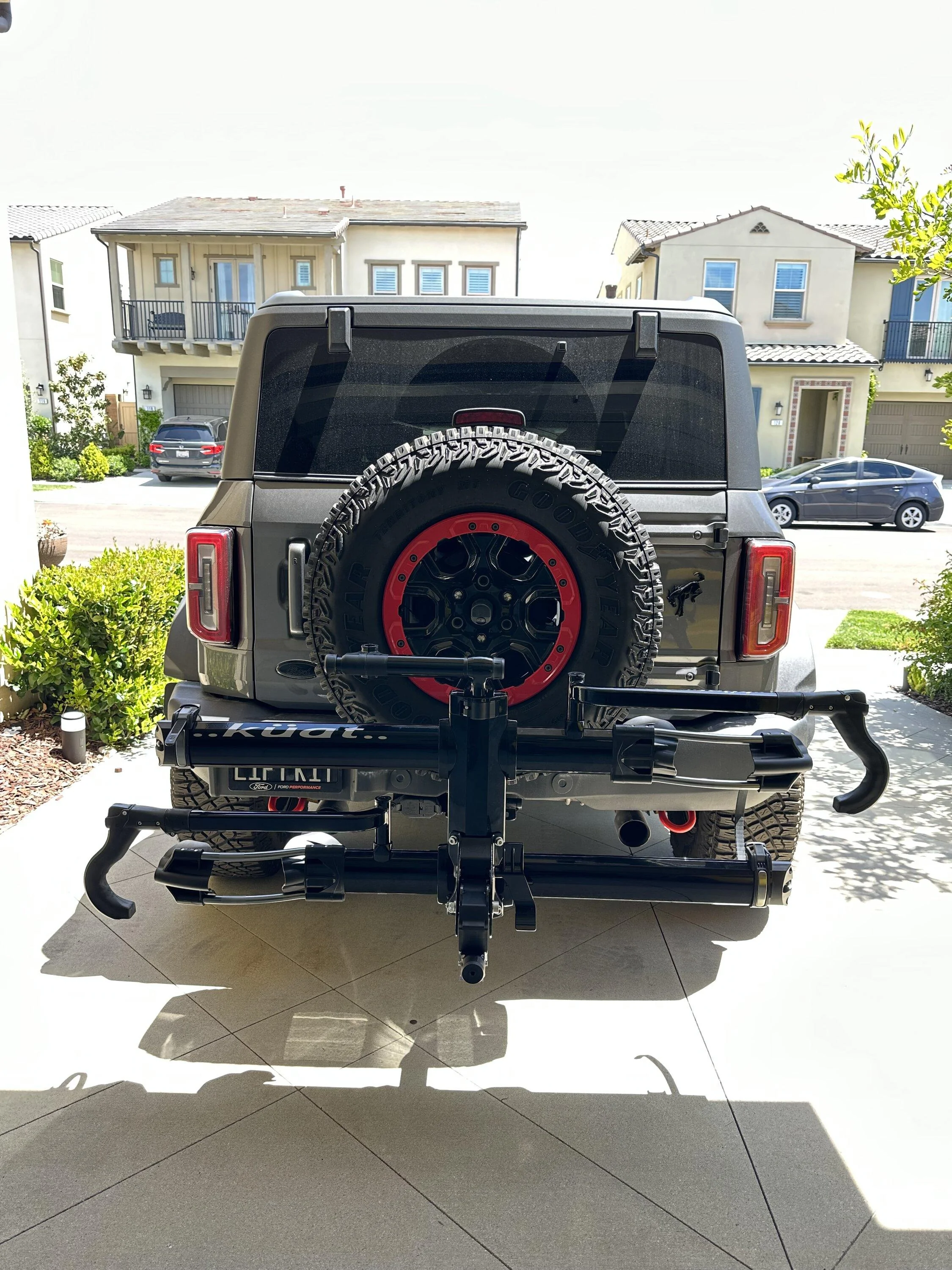

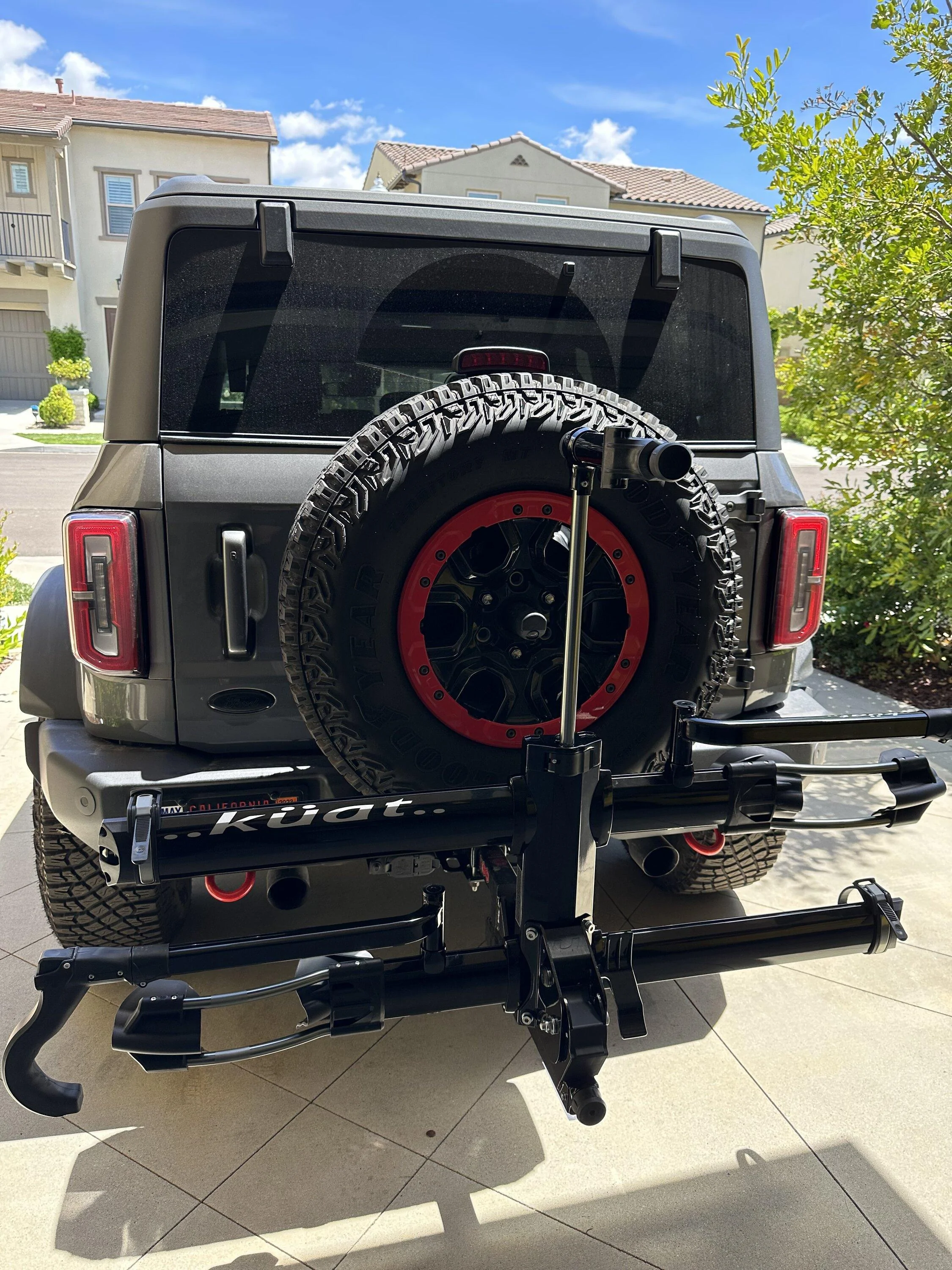

Get a KUAT NV 2.0 Bike Rack with a 7”-8” hitch extender (I did a drop/rise hitch extender for SAS tire clearance)
Kuat Racks NV 2.0 Bike Rack https://a.co/d/aLyGGHe
TOPTOW 64122 2-inch Receiver Trailer Hitch Extension Riser with 4.25-inch Rise/Drop, 7" & 9" Extender, 2-inch Solid Shank, 10000lbs Towing Capacity, Anti-Rattle Bolt https://a.co/d/8v0RDgo

Is the extension stable in the hitch? I hate watching a bike rack rock back and forth while driving down the interstate.
Most all the extensions move around and need a tightener clamp
This is what I use with zero Play and movement from the extensions.
TICONN Shackle Hitch Receiver for 2" Receivers, Heavy Duty Towing & Off Road Accessories for Vehicle Recovery (Hitch Tightener Clamp) https://a.co/d/iWKLkT0

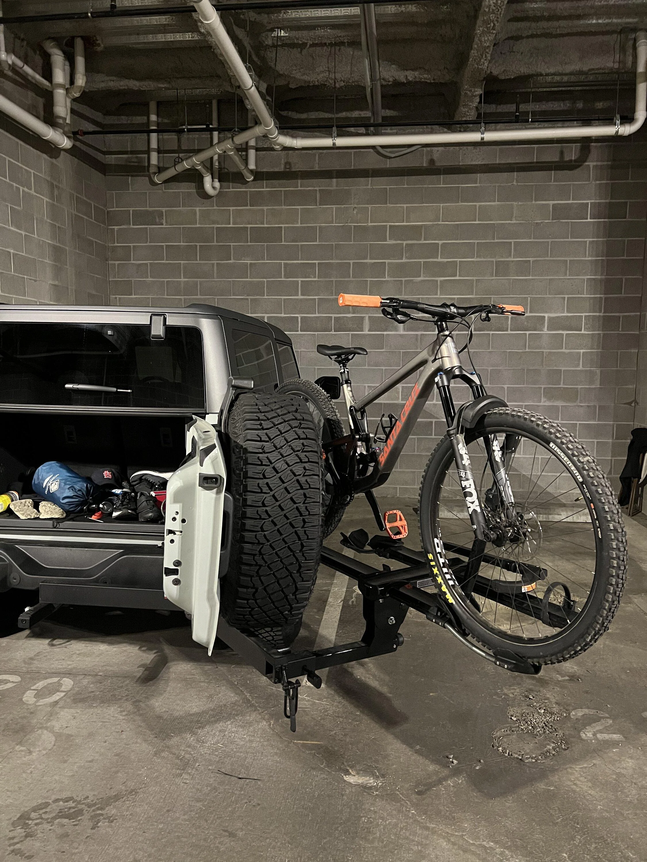

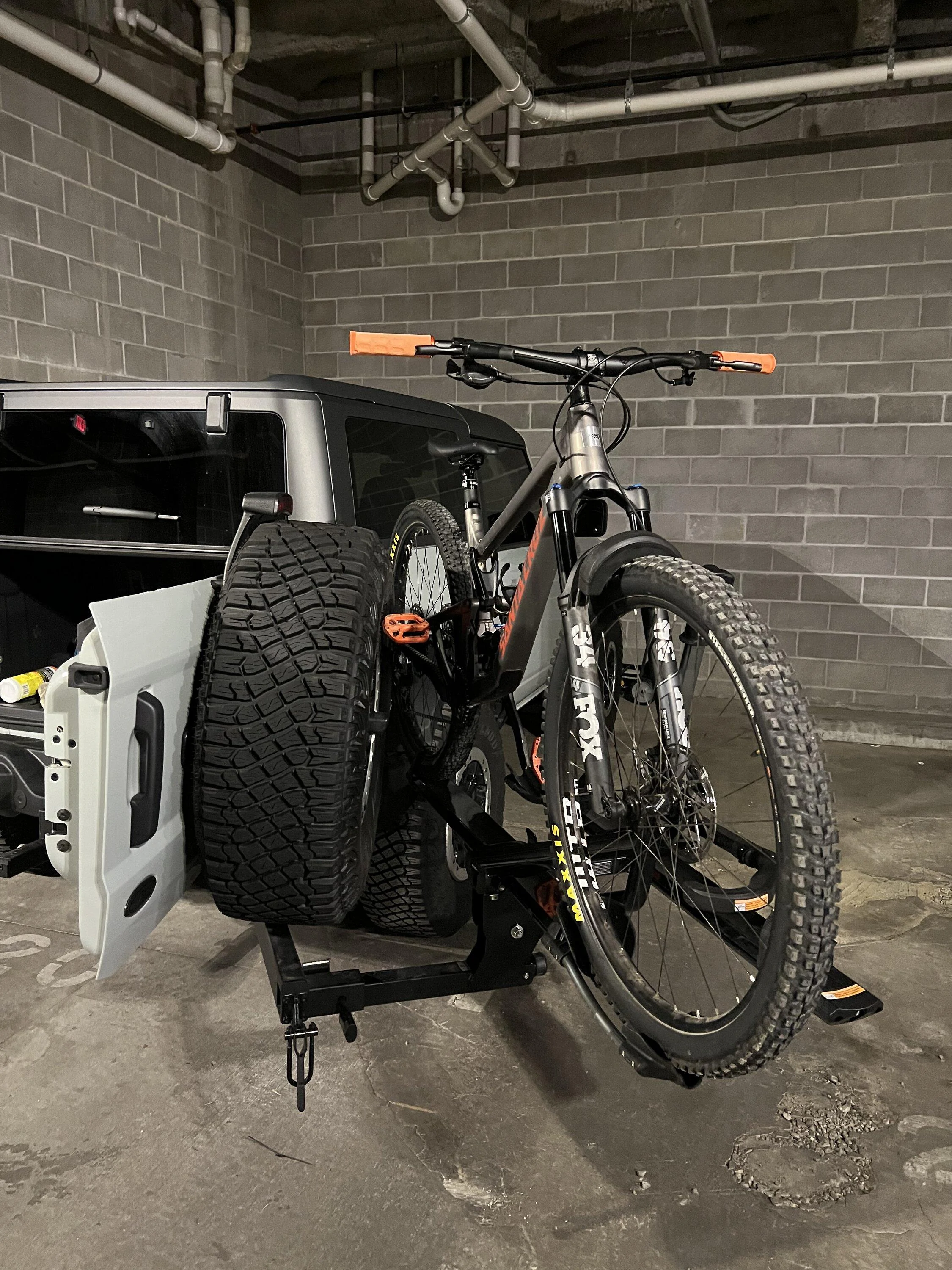

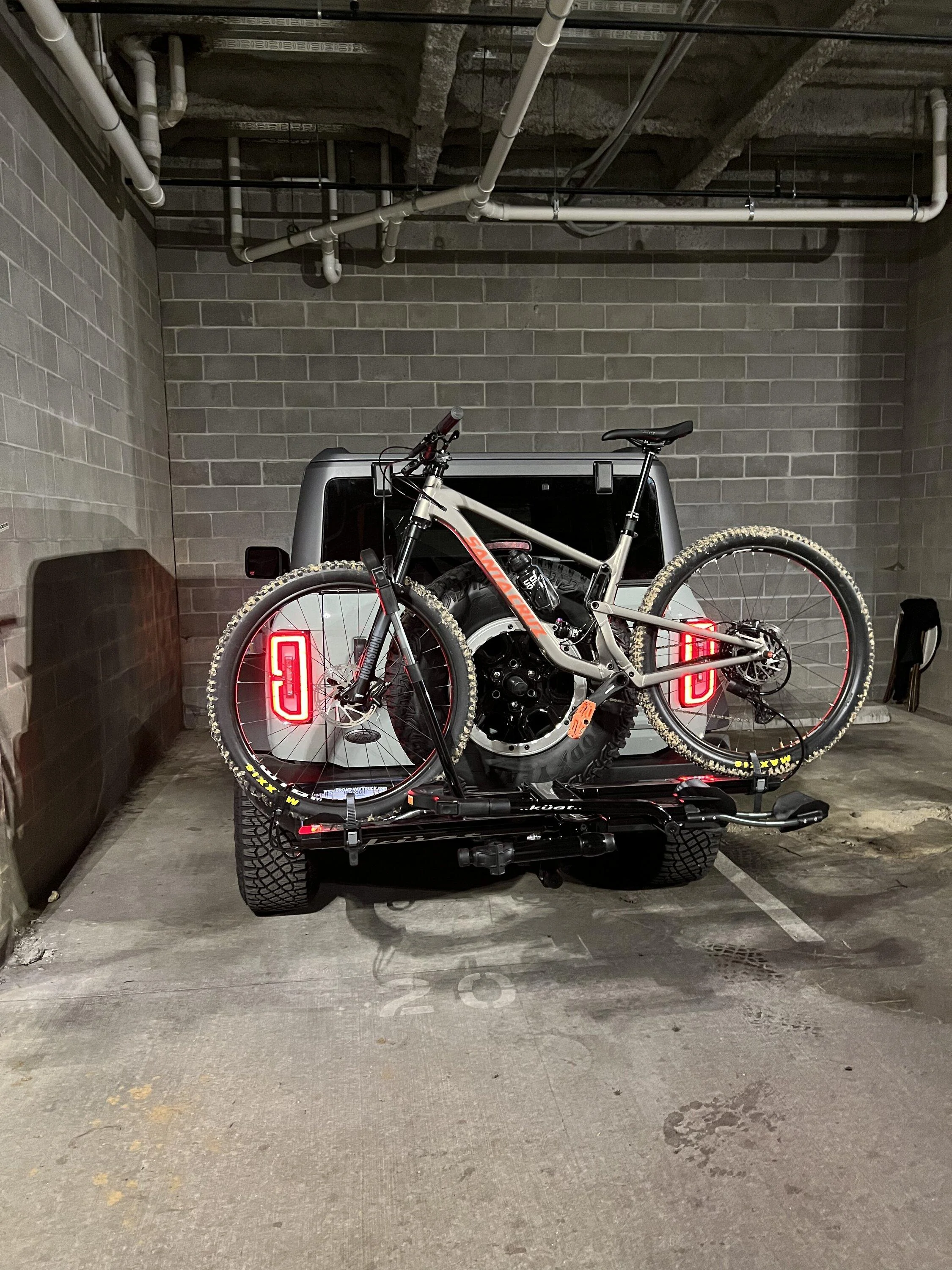

I would suggest starting with the Kuat V2 pivot. You won't need a separate hitch extender us you can open tailgate without having to unload bikes
I second the Kuat Pivot. v2
I started with only the Kuat Transfer v2, but the spare SAS tire hit the knuckle when trying to open the tailgate. Added the Kuat Pivot and problem solved. As an added bonus, both Kuat products have the FlatLock tightening system that prevents any movement in the hitch.
