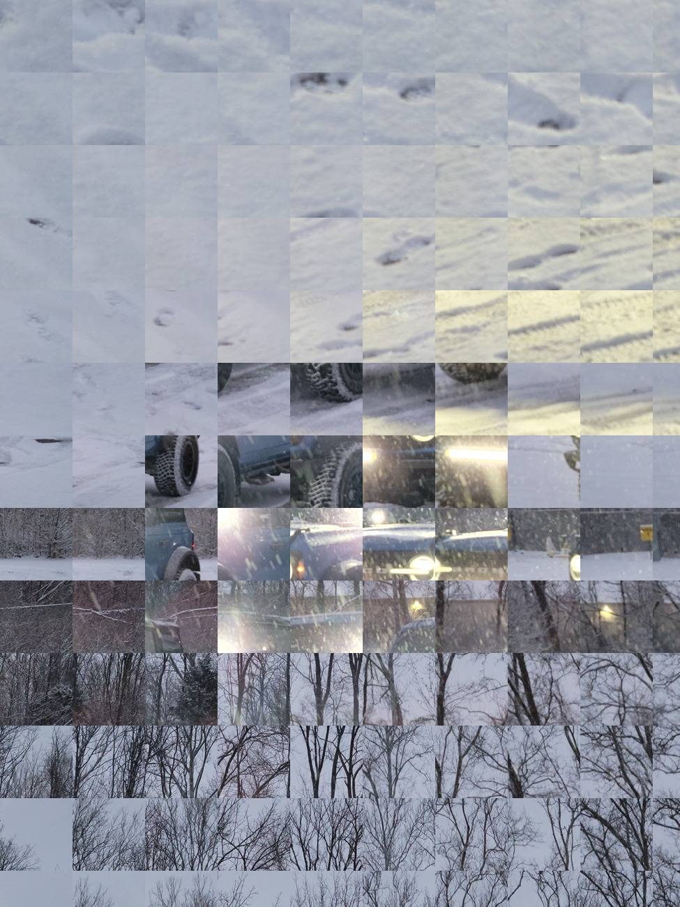

Hi - I just installed the modular bumper Baja Design 3-light kit from 4x4 Truck LEDs. I went with their "staff pick" for lights: S2 SAE Amber, S2 SAE White, and Squadron Pro White Driving/Combo. I love it so far. The SAEs are good (and street legal) for everyday use and the Squadron Pros can light up a trail pretty good. I opted for this setup as I like the clean look with everything within the lines of the Bronco, not hanging out like A-pillar or roof mounts. I'm not a hardcore off-roader and this is my daily driver and I think this combo works out perfect for me.

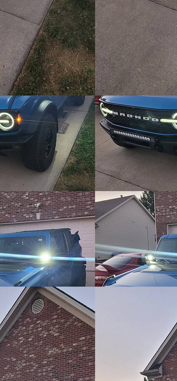

I went this way to get a LOAD of light out front. I'm very happy with this easy install between the grill and bumper. @MandRautomotive

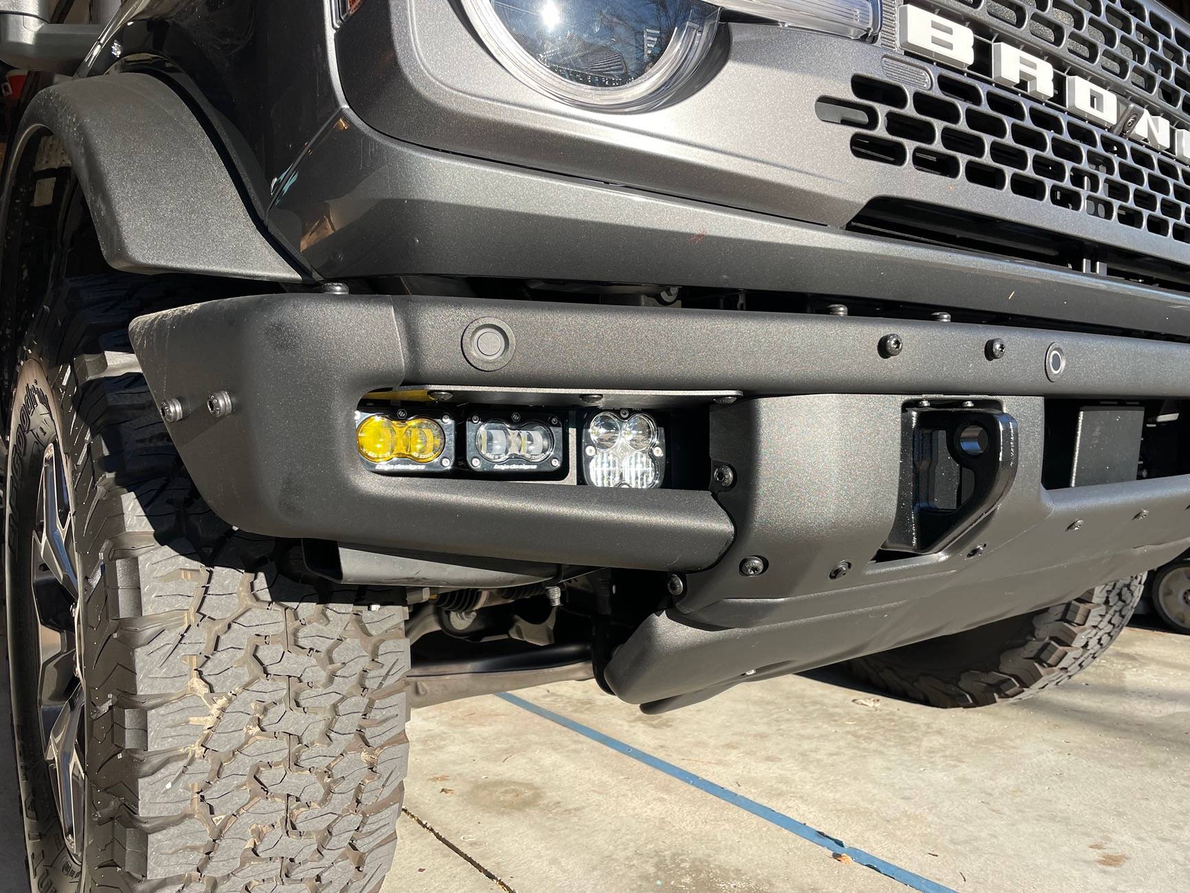

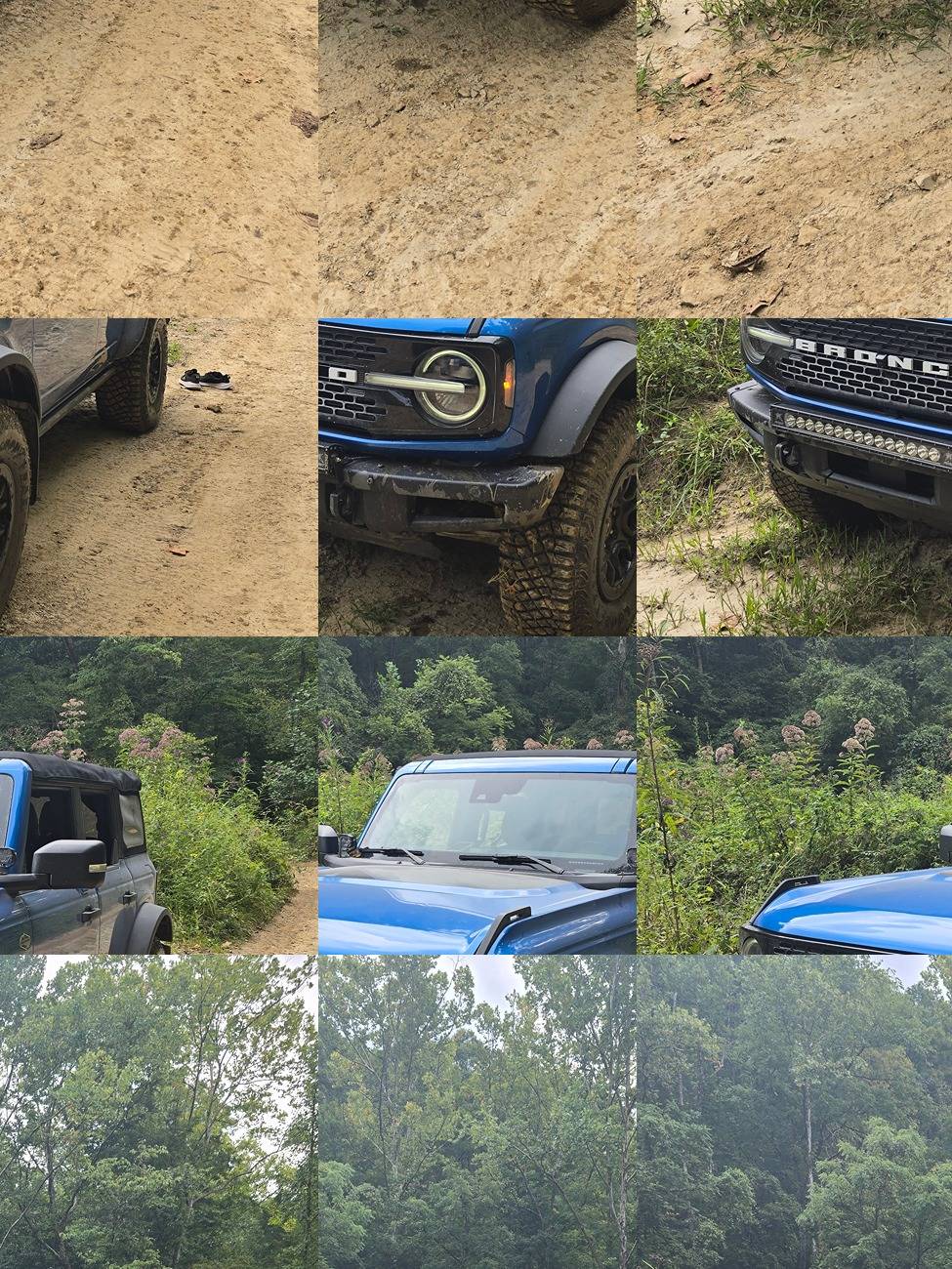

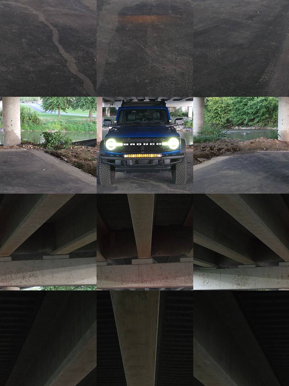

I did a 30" rigid light bar on the bumper and morimoro HXB 4 bangers for the a pillar lights. They are the wide angle. I love them both. The Rigid has a great Hotspot the throws light super far and the morimotos cover the rest.

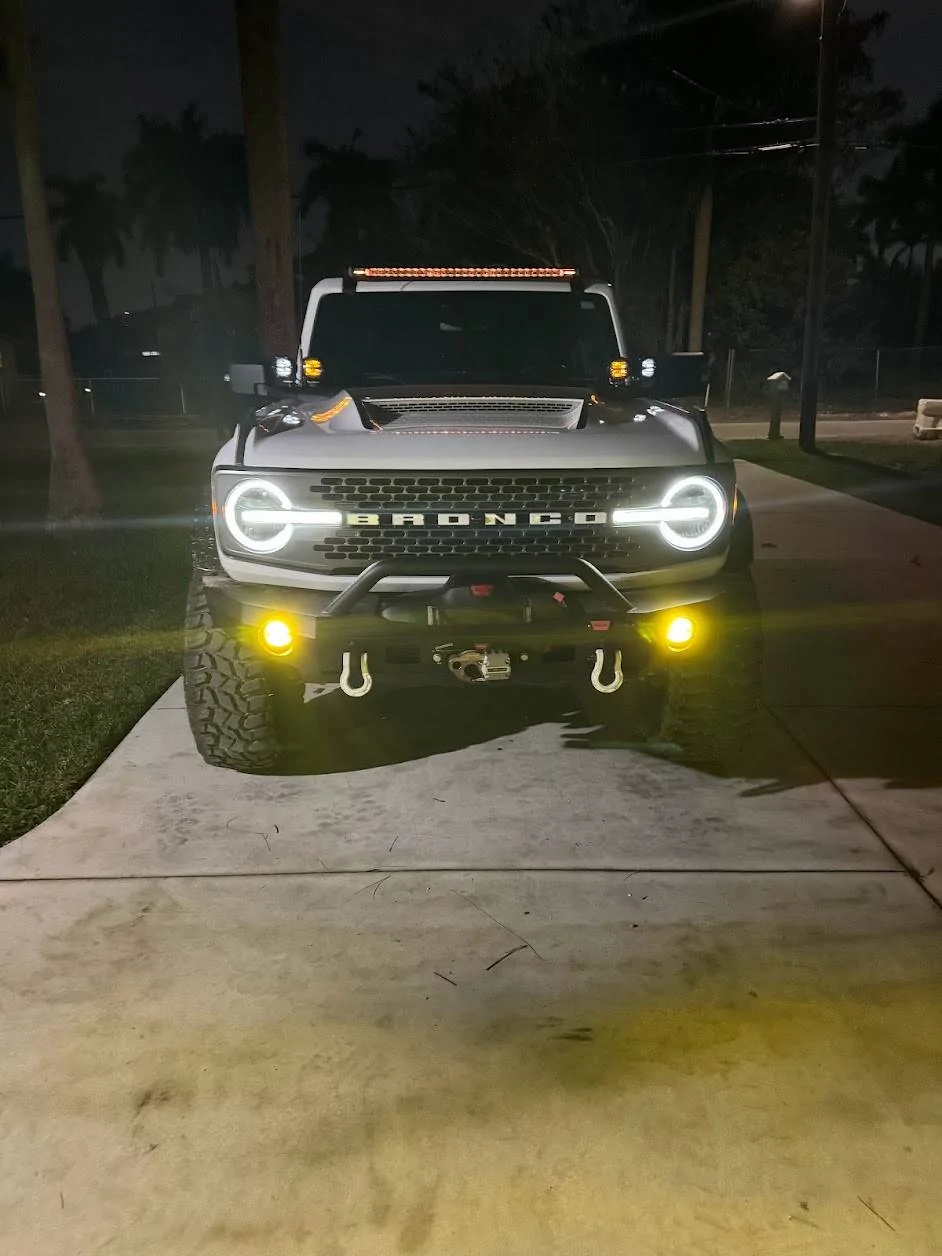

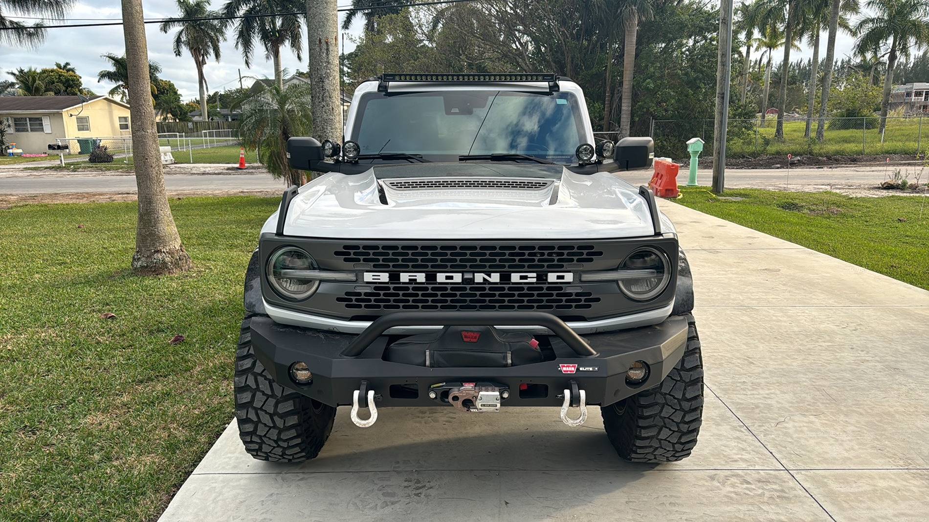

I have A pillar pods, a roof bar, and fogs in the bumper. It puts a crap ton of light, I can turn night to day with this setup. All Rigid setup. The bottom pic is with the backlights on and fog.

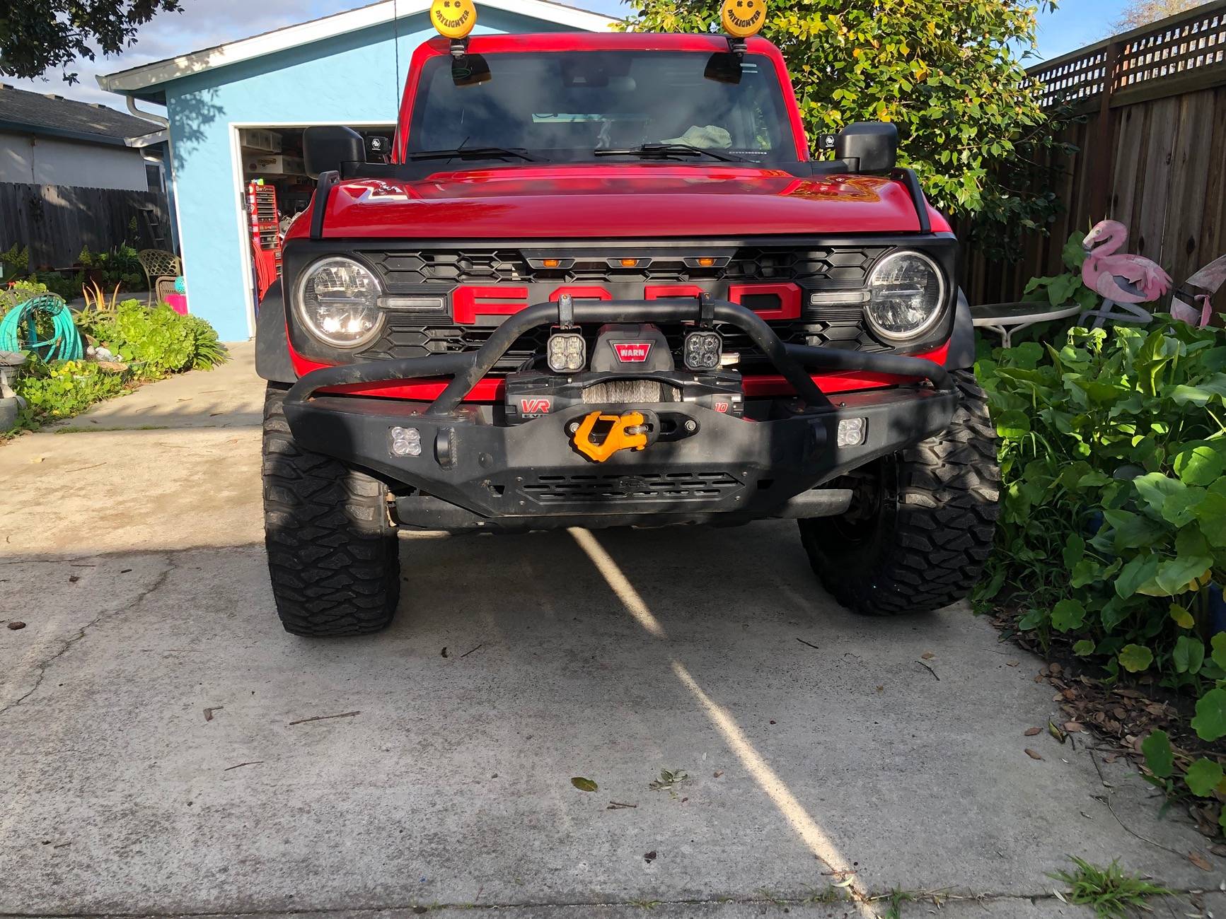

Pillar mounts should only be used for “ditch” lights pointed to the sides to keep reflections off the hood…fog & driving lights should be out front (bumper/grill) and if ya want spots, put them above the windshield.
SAE fogs in bumper, SAE driving on bull bar, combo flood/driving on pillar, Spots up high…

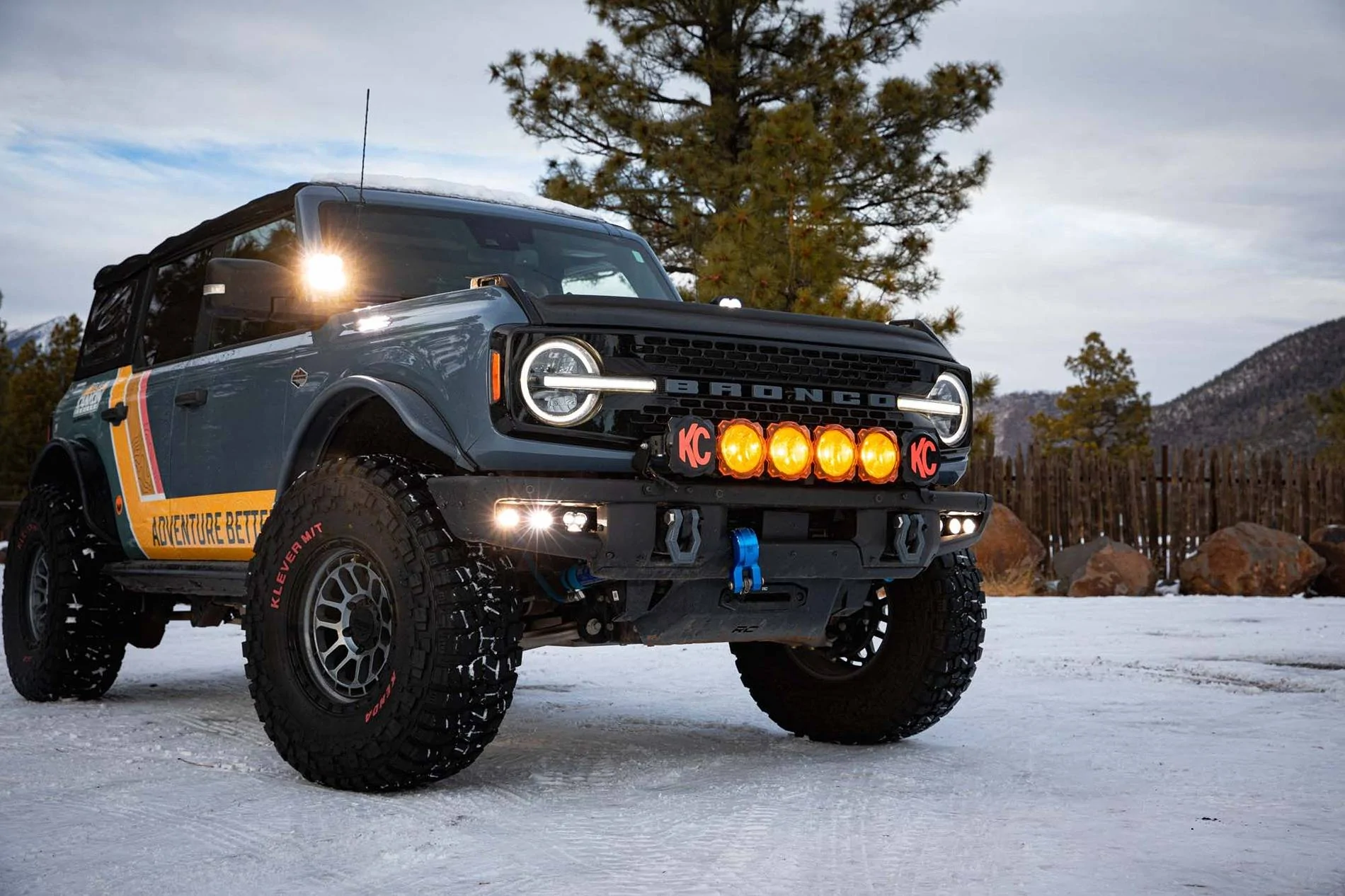

I dont point my ditch lights straight sideways as I often move at a pretty good clip, in high open savannah and less dense pine areas. The black vinyl on my Wildtrak hood helps with glare. Yellow helps some too in dust and snow.
I like KC for being an OG brand, up the street from me, with a complete line, and Nacho for their desert racing technology, and awesome vibe. I'm also partial to working with Arizona companies.
