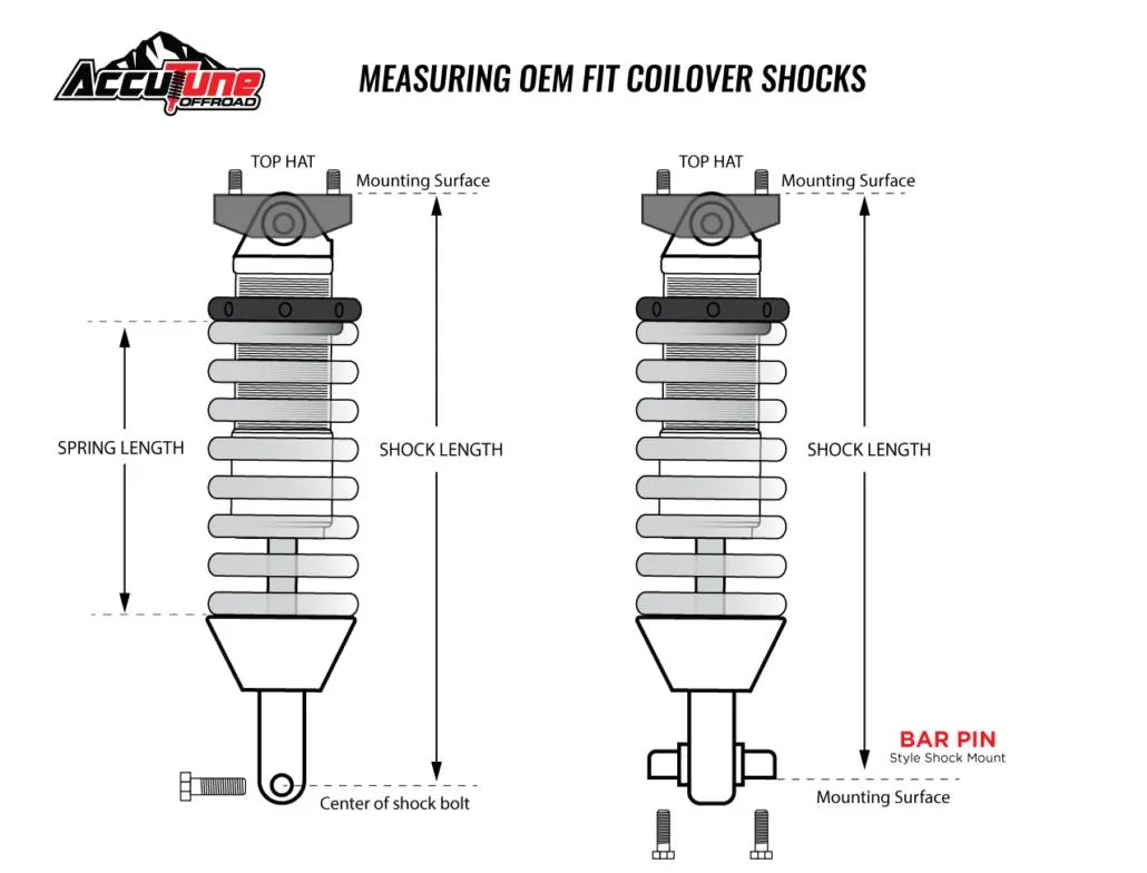

jasongrim2016 thanks for messaging us and lets keep this conversation going with our sales team. Its really important for us to get accurate measurements to be sure we are talking about the same thing. If your shock lengths are accurate, there is room to go taller in the front and less preload in the rear to level out the Bronco. We should be referencing this diagram when measuring:
Ford Bronco Accutune Fox coilover question measuring-oem-coilover-shocks-1030x784
Front Fox Coilovers:
Compressed Length: 18.79 “ | Extended Length: 24.26”
Max recommended length at ride height = 22.50"
Rear Fox Coilovers:
Compressed Length: 19.24” | Extended Length: 27.21”
Max recommended length at ride height = 23.00"
Rear Fox Coilovers:

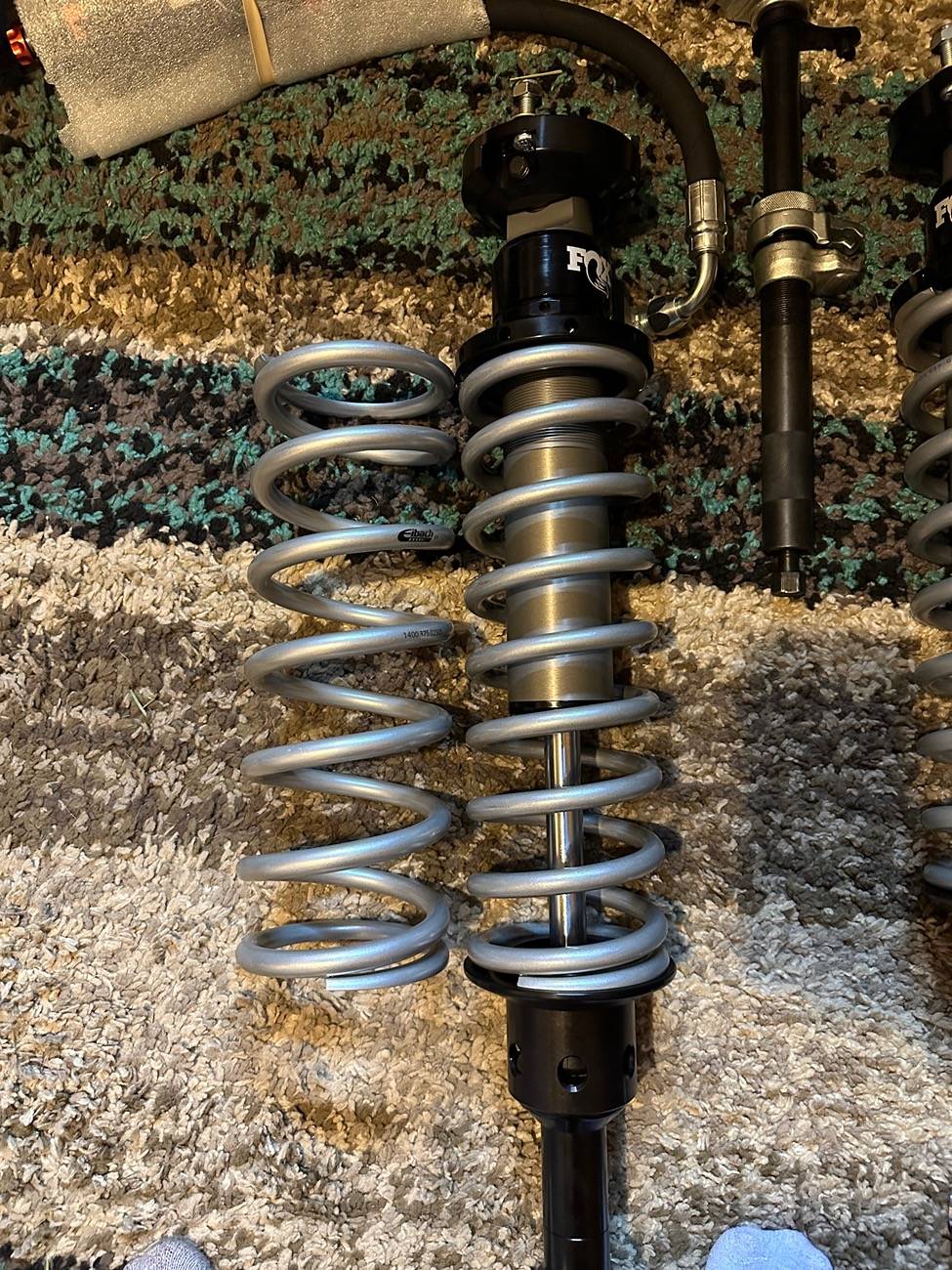

Fox is releasing an upgraded spring option that is .5 taller than the stock option. I believe the accutune eibachs is even shorter than the factory Fox. I would go with the upgraded Fox.
Fox reps at the Bronco stampede in TN told me they were coming out with a whole coilover with new rates to match the firmer springs they were planning.
Pic is a eibach 250lb spring next to a fox factory coilover.

For those comparing springs, its important to compare the spring rate which includes length and weight rating. Just bc the spring is shorter, doesn't mean is softer or provides less lift.
In fact soft springs are usually longer than stiff springs.
