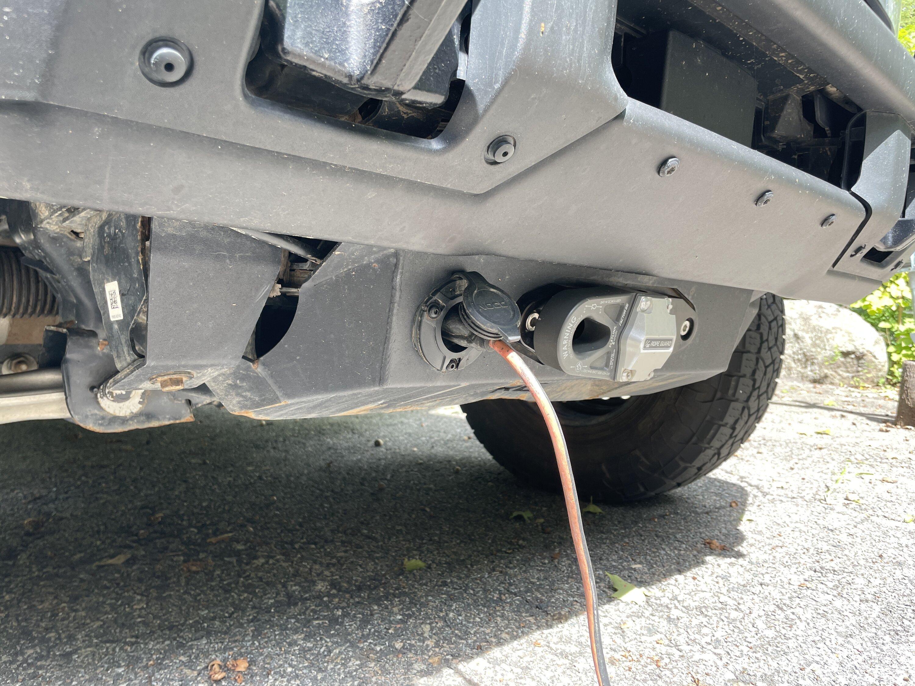

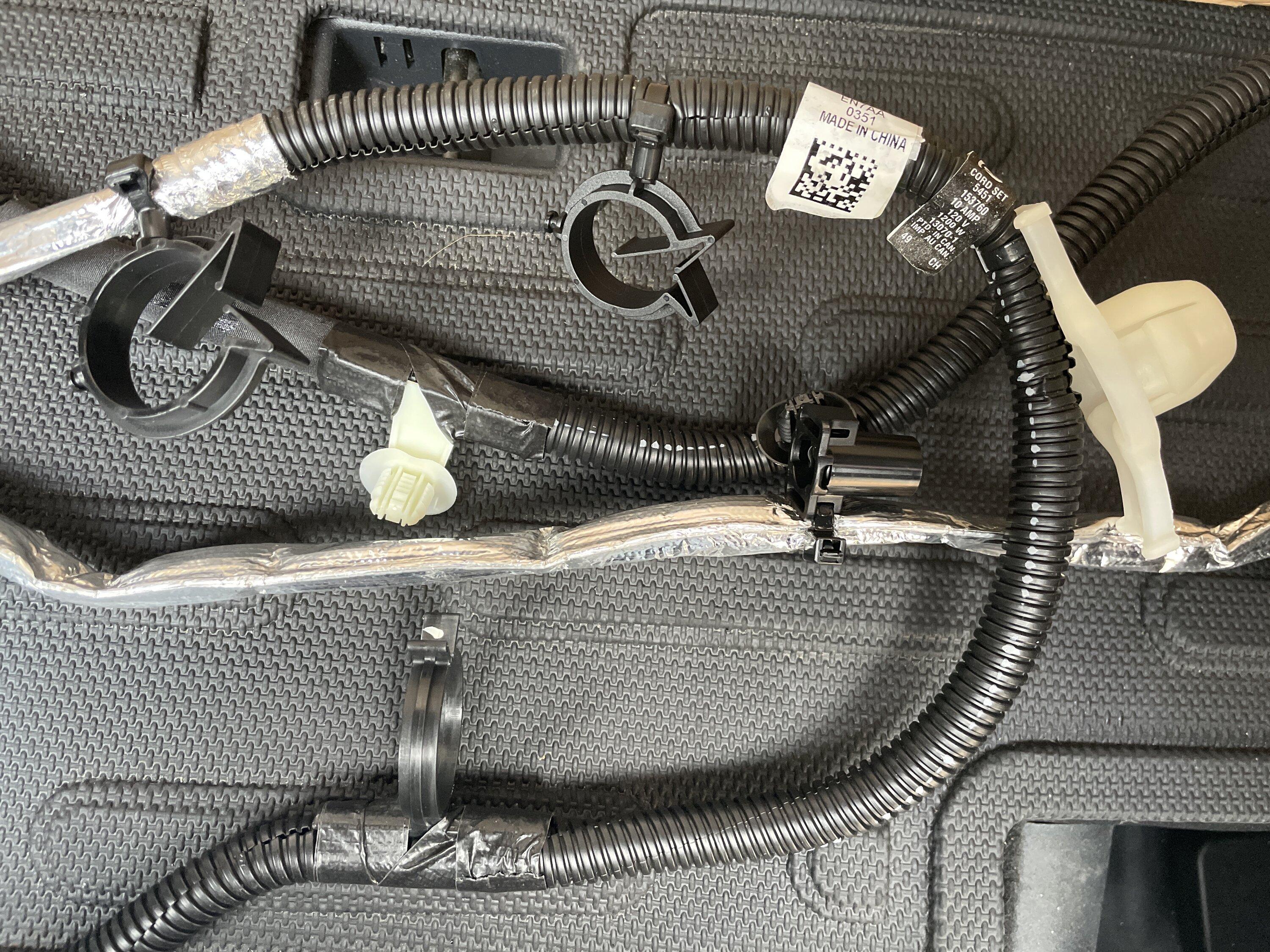

Anyone out there with a 2.3L that can shoot some pics of where the wire is routed?
There are all of these body mounting clips and other contraptions that I’ve never seen before.
I guess it may be more obvious where they connect and their function once I have it routed - but, that’s pretty much left up to the imagination.
I have the service manual info on installing the heater itself - but, not the cord. Gonna check that now.

Yeah it got forgotten on my 23, with 2.7. I will have to buy it and install, my 22 has so I can follow routing that way.

I put this off for the past two winters and my short commute may have been the culprit for my failed catalytic converter. I was severely misquoted at $130 to install the block heater…$210/hr and 3+ hours…I got them down to $500. Next time I’ll get the quote on paper. Lesson learned. But, it’s done. So, that’s great. Seems like it was a pain to route the cord with all of the clips in the factory locations. I was trying to dig into the service manuals for that info. I’m glad they got it done. But, $100 from factory vs $800 after the fact…
