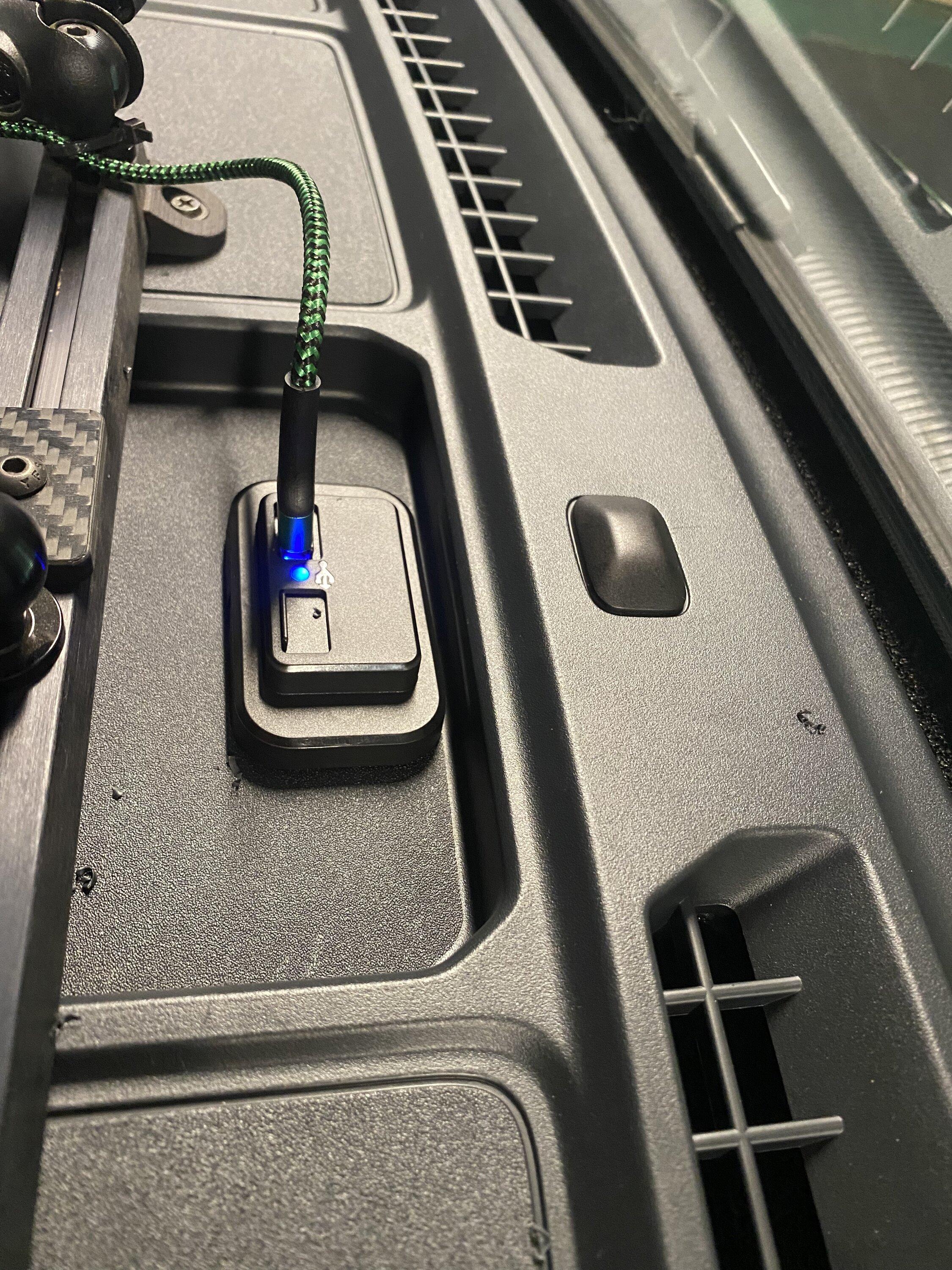

I’ve done this mod several times, I tap into glovebox aux wire, run to aux6, which i leave always on to power USB, gmrs and amp trigger wires
Ford Bronco Adding USB to a non Lux dash ? 4E84FFF0-9BB4-4441-A1D3-254BC44D456A
Yep! Those are the ones I linked. I think from one of your pictures in another post. Much appreciated! 👏
I've done it too, but not on this vehicle yet and not these mounts in particular (I've done the cigarette lighter replacement, with voltage reading).
On the left and right hand side of that pocket on the flat panels, is there enough room to do that same thing? I would like to keep that pocket open if possible.
Not sure about that, I’d probably do some dash disassembly , and get a peek before drilling there
