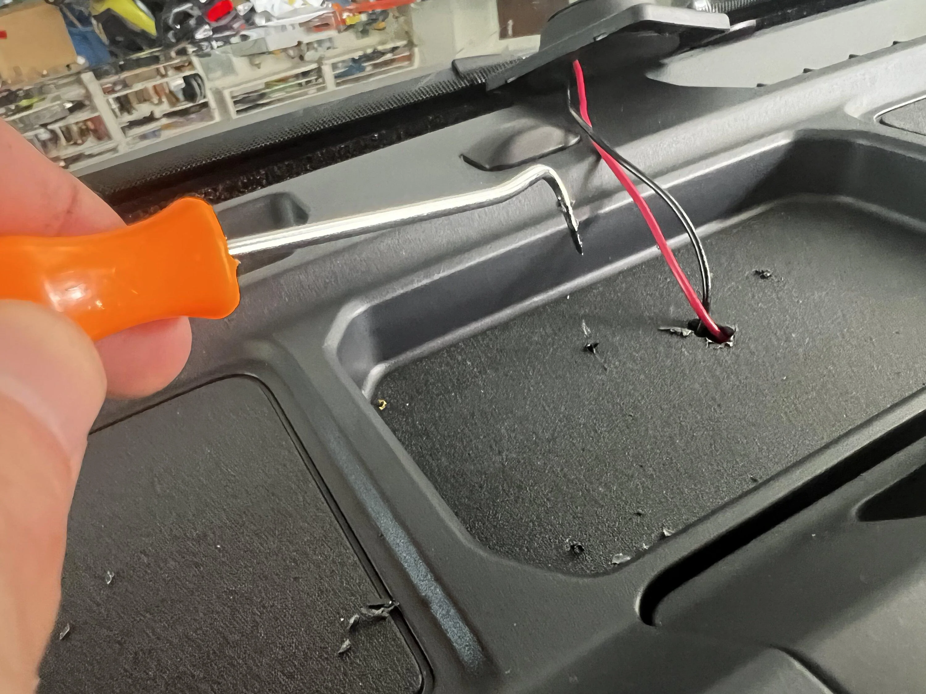

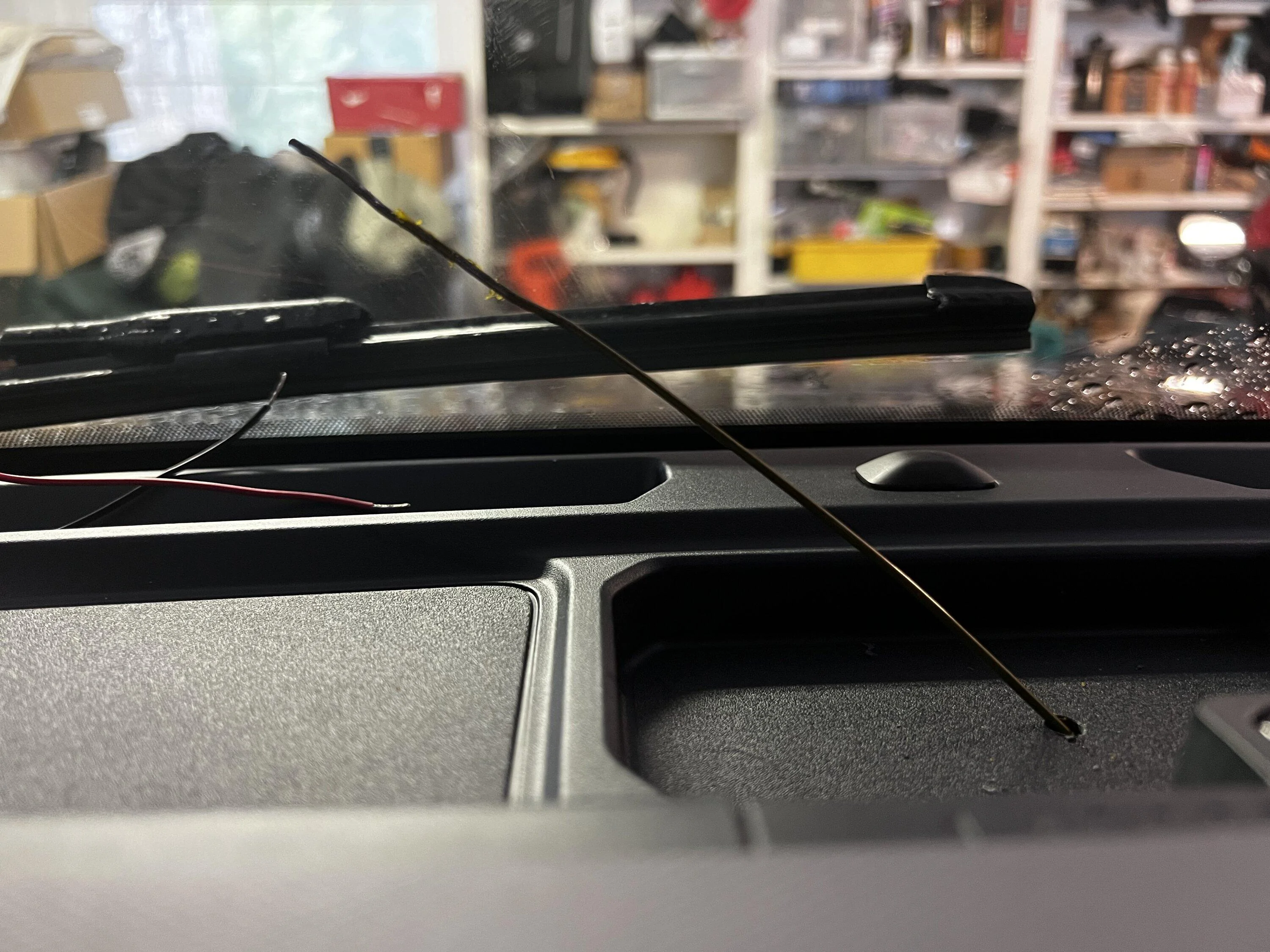

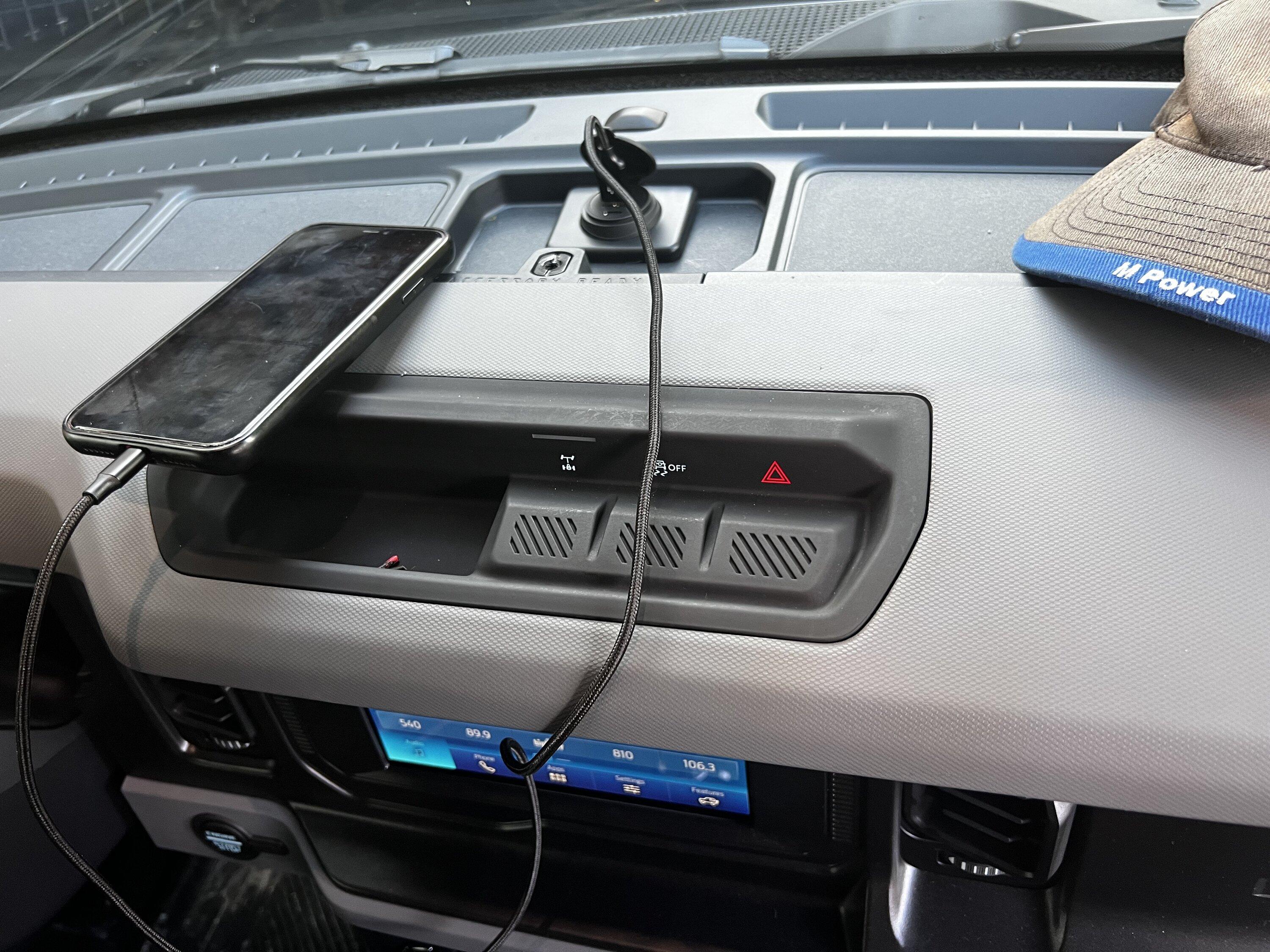

I just added the USB port. I hooked it into accessory switch 6. Heated up a pick to melt the holes for the 2 screws. Drilled a hole for the wire - used a hanger to find a path over behind the glovebox. Then pulled the wires up to the dash.
Hi. Were the wires from the USB ports long enough to reach the built-in wires under the glove box? Or did you need to extend them?
And the UBS port you used can be connected directly to 12V power? Don’t need a power converter?
Also why did you go through the Aux switch vs connect directly to battery for always on power?
It’s a great looking setup. Just add a dash rail and all is good!
