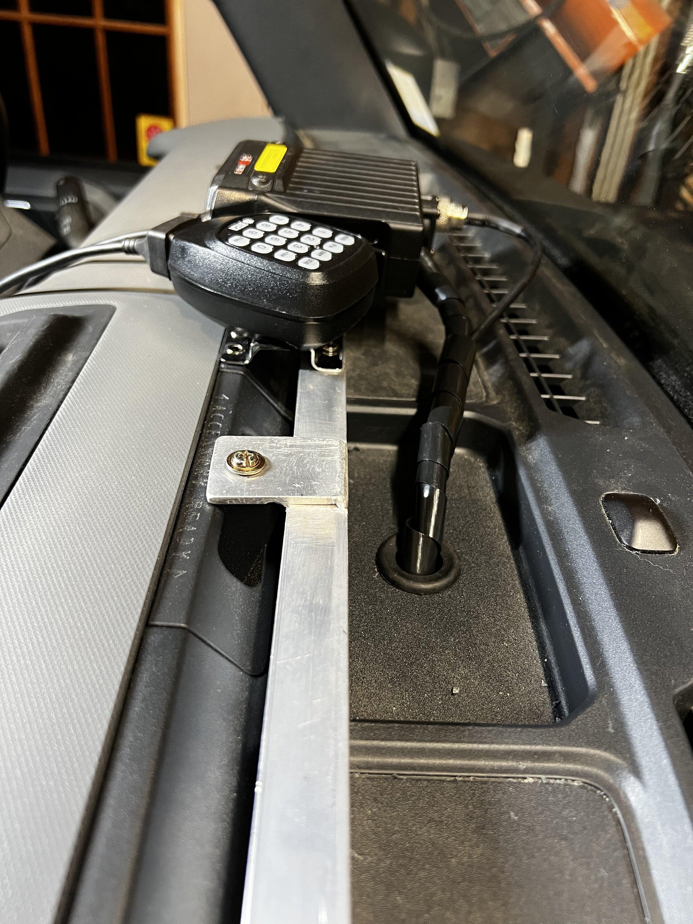

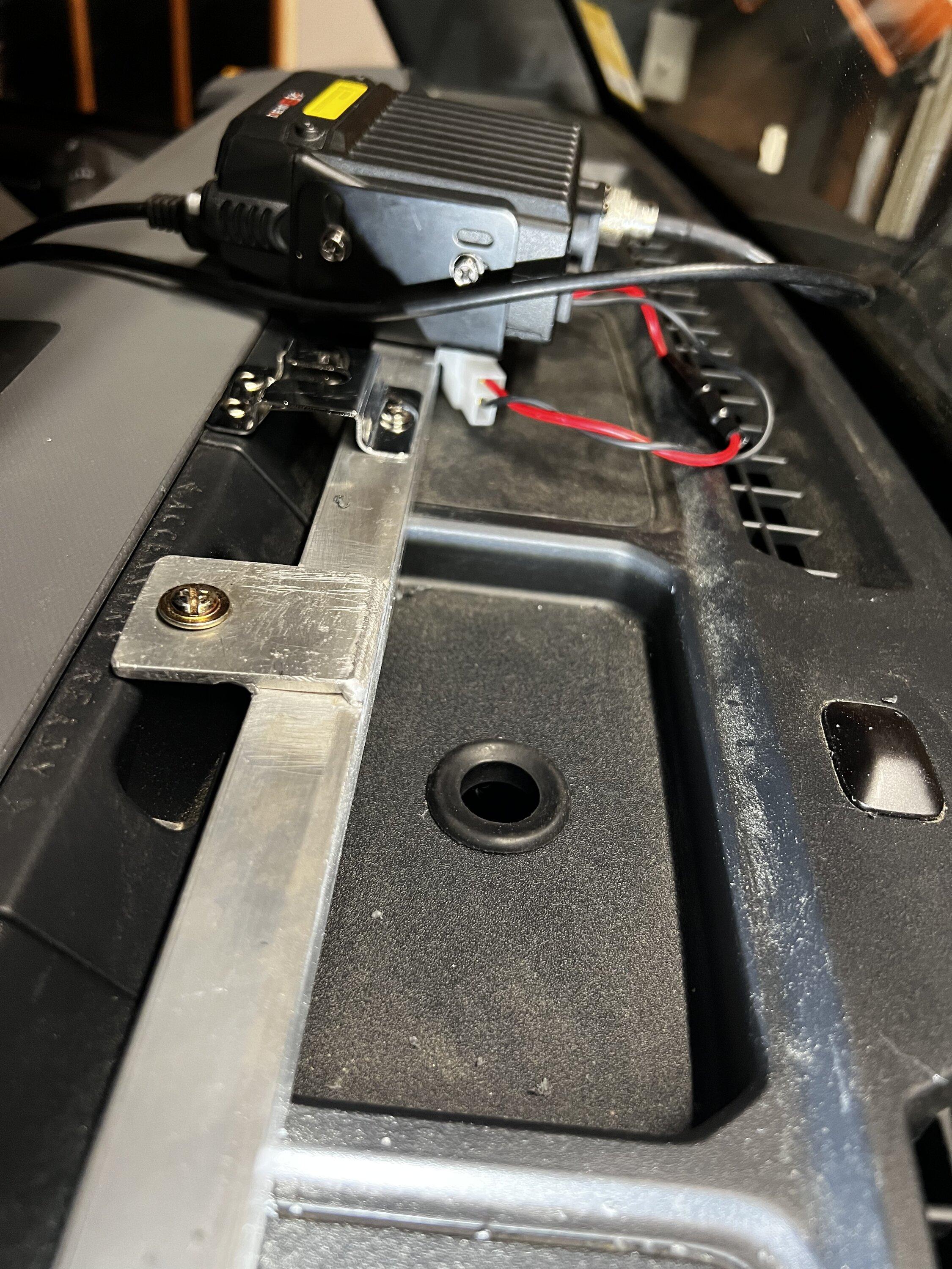

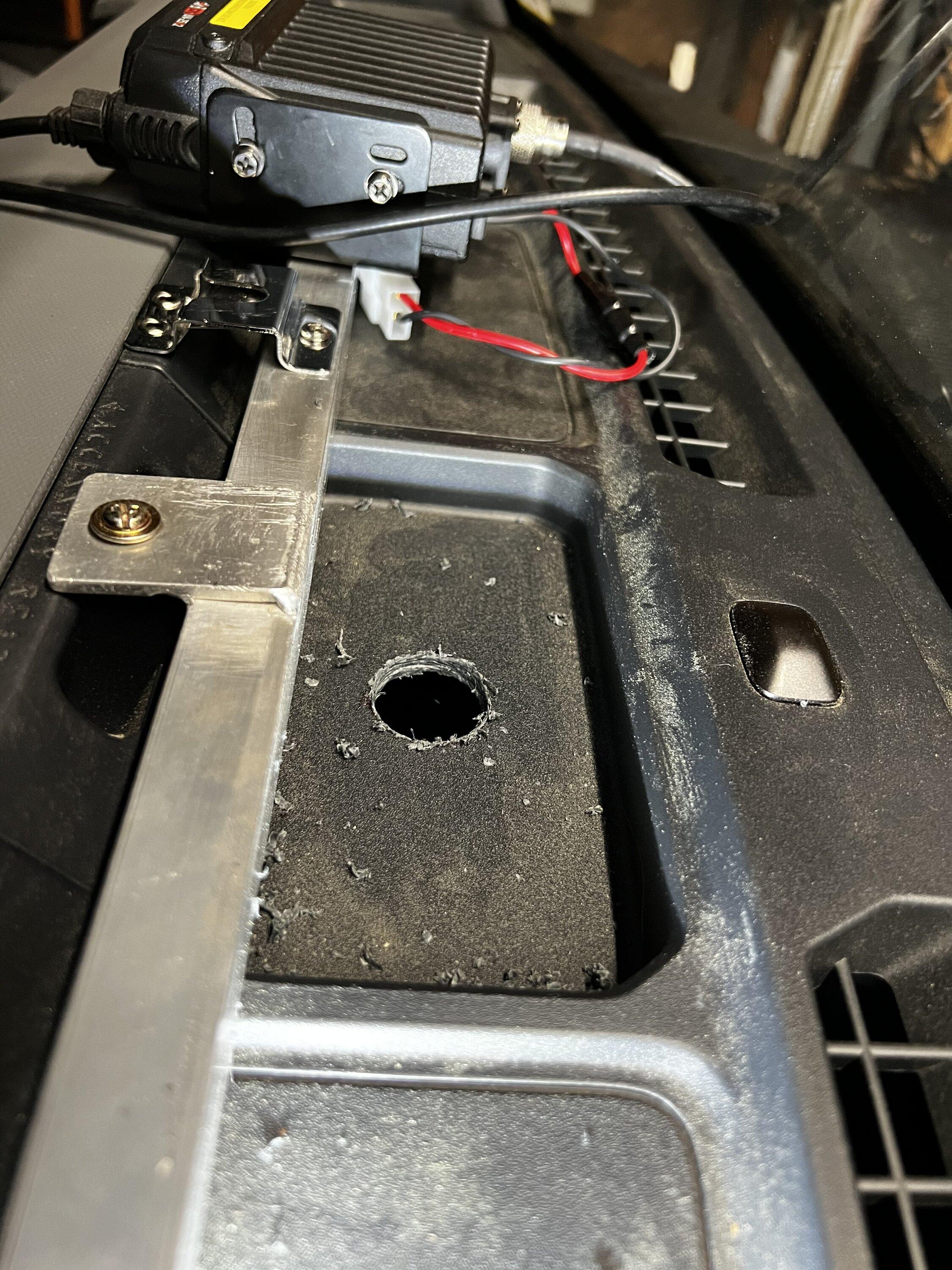

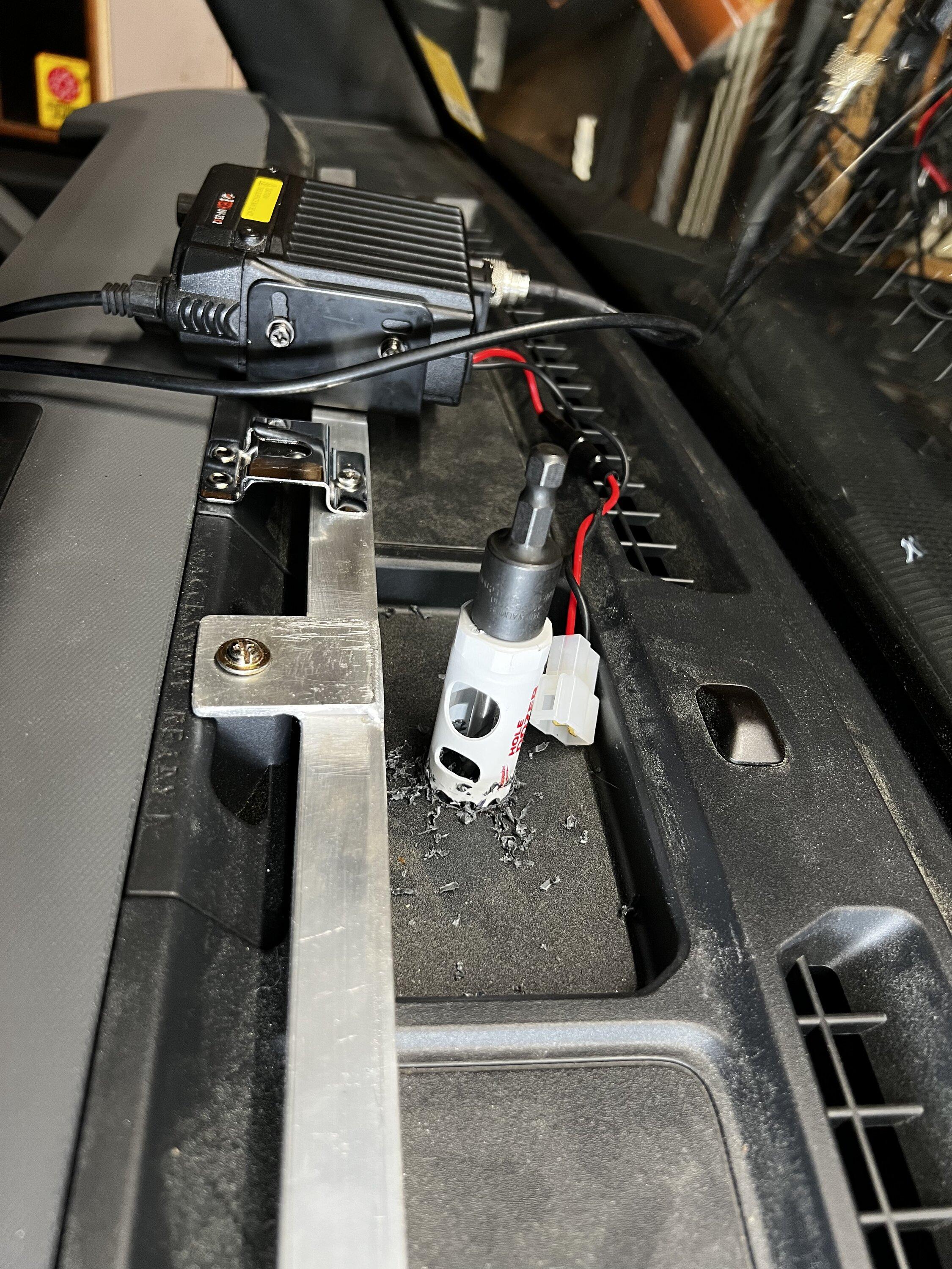

Nice info here—thanks to those pics I was brave enough to also make a 1” hole dead center of the middle dash compartment.
Some tips: 1) There are several wires under there, so drill slowly by hand. It’s just plastic. Wear a rubberized work glove and turn the drill/hole saw by hand until it just breaks through. 2) Make the hole dead center if you need space underneath, like for the back of the USB socket or cigarette lighter socket. There’s 5” of open space below the center, but there are more wires, and metal/plastic that I could feel in all directions as I probed inside the hole I made. 3) A 1” hole saw worked perfectly. You could go larger, maybe 2”, and still have a lot of clearance underneath, but you will have to push wires around.

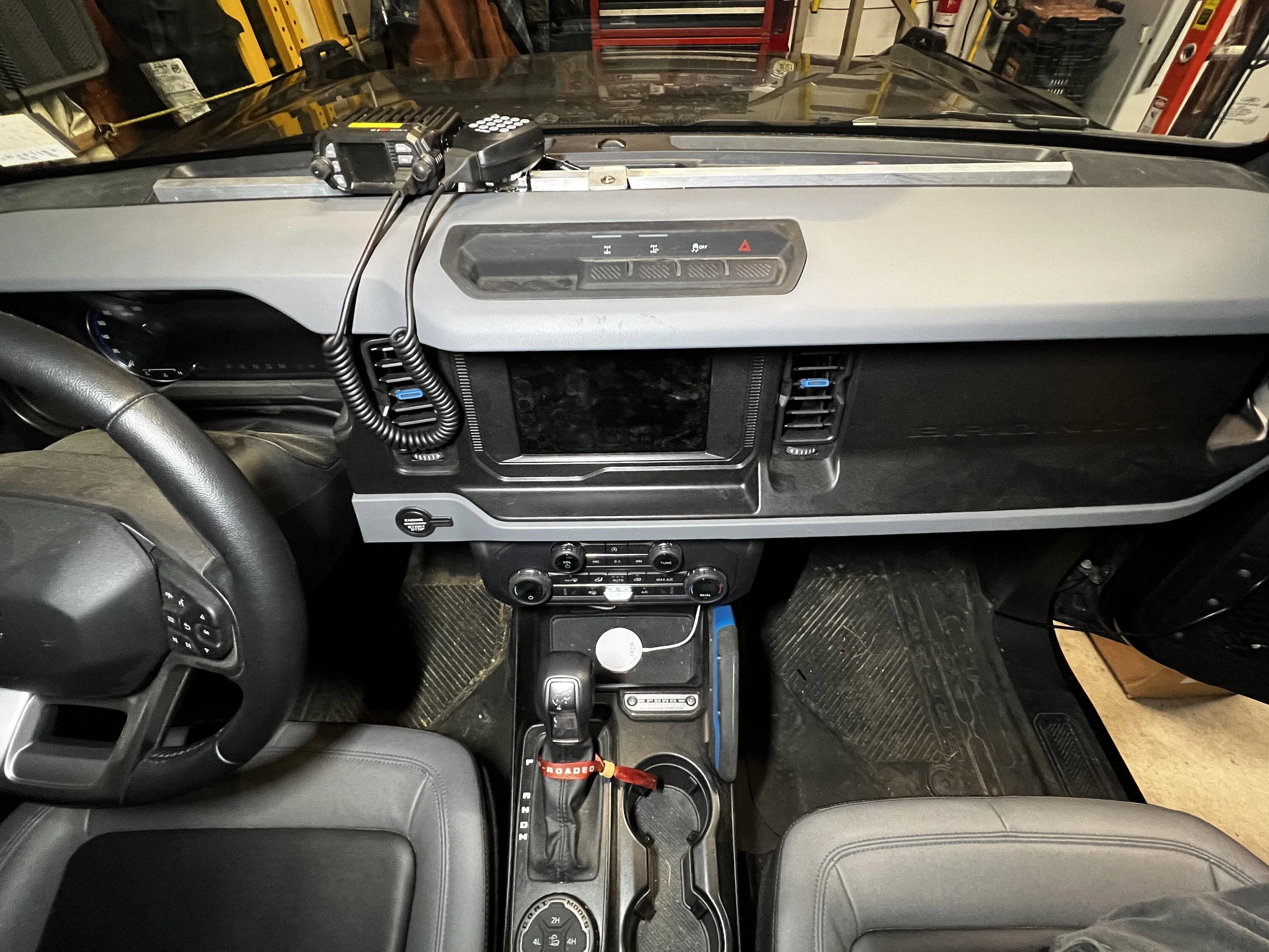

Check out my homemade accessory rail and ham radio setup. I’ll probably coat the aluminum tube with black Flex Seal or textured spray paint.
Ford Bronco Dashboard USB Ports on Non-Lux Bronco 69B1EC96-6A7B-4C56-8708-1F1CE8081BE9
Ford Bronco Dashboard USB Ports on Non-Lux Bronco E5922240-ACF4-4692-895C-01138E9730BF
Ford Bronco Dashboard USB Ports on Non-Lux Bronco 34E46FB1-4291-4C74-B414-6A1D65B3B1BB
Ford Bronco Dashboard USB Ports on Non-Lux Bronco 2719DF8A-08BE-4651-9292-E1B53D0E0FD3
Ford Bronco Dashboard USB Ports on Non-Lux Bronco BD0669A5-06BB-4471-AEE8-1D5083DFCC98
Oh, and the wires were easily fished from the glove box using a length of 10 gauge insulated solid copper wire. Poked it through my hole, tight to the passenger side, then looked for it from under the dash.
For those curious, I used my Aux. switches to power the radio. I connected the radio wire to B1(Brn/Wht) wire behind the glove box, and connected B1 to Aux 1 under the hood. Now I have an ignition-switched circuit for the radio. Even though I don’t intend on ever switching it off, the ignition-powered circuit is very handy.

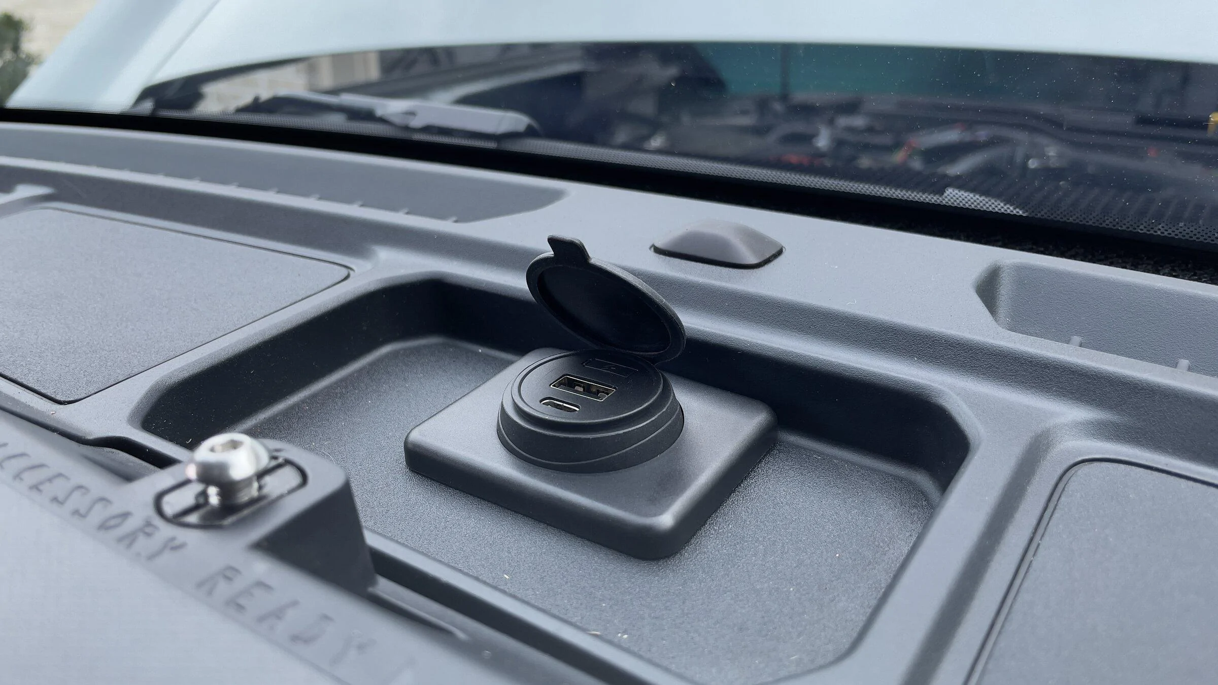

I just added the USB port. I hooked it into accessory switch 6. Heated up a pick to melt the holes for the 2 screws. Drilled a hole for the wire - used a hanger to find a path over behind the glovebox. Then pulled the wires up to the dash.

Black and red wire are from the USB port. You will need to go down and remove the glovebox. The owners manual - in the dash screen goes over the power from the Aux switches from the overhead console. you will need to hook up power under the hood - to provide power to the wires behind the dash.
