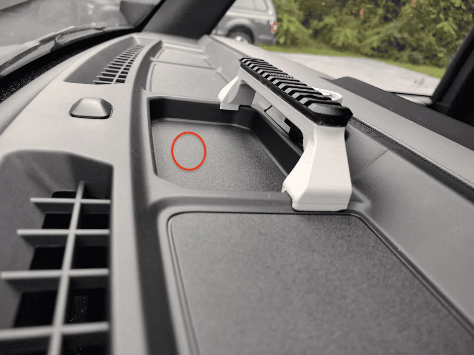

No, I am looking to buy the defrost panel, port and speaker grilles out of a wrecked Bronco. It would just be a swap of the trim piece and wire the port for power. Since I have to tear it all down regardless, I thought the lux panel would be cleaner.
What I like about the Lux panel is the USB is located near the ambient light sensor and angled back toward the cabin. The non-lux trim panel has the sensor centered in that spot so there isn't enough room to place the port. I would have to put it in a different location.
like here:
Ford Bronco Question about the dash mounted USB from LUX 1634585787746
the only thing that worries me about this location is if the top is down and I'm caught in the rain. That tray could pool moisture and drip down directly in the infotainment modules.

I have installed usb ports (dual usb-c/usb-a) on the outside of my camper trailer. Just pick up marine grade ports that have the o-ring seals and dust caps and you’ll be fine.
