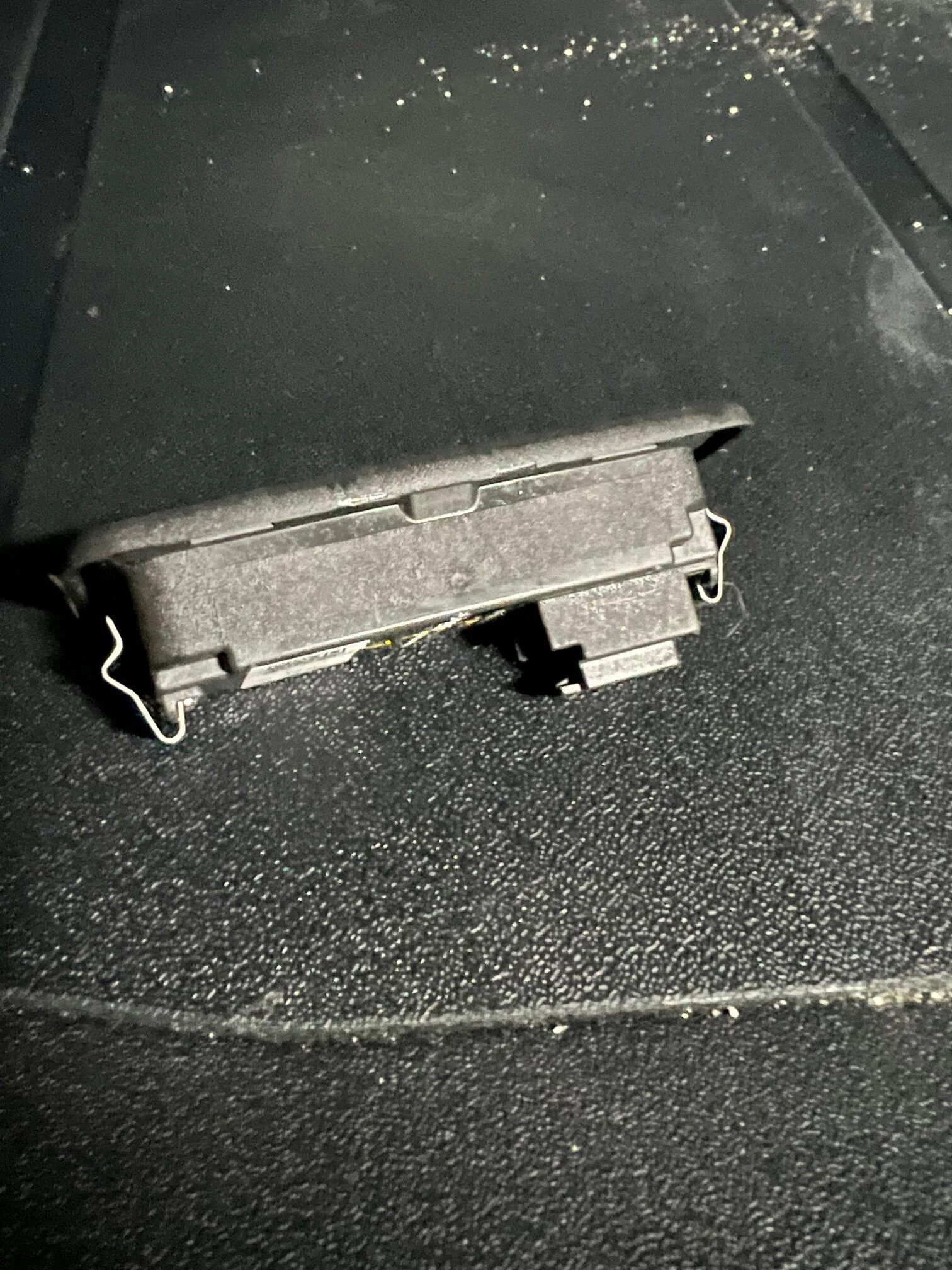

I discovered after a bit of investigating that it is not too difficult to pop the rear dome light out it is held in by 2 little metal clips and you can wedge a screwdriver in from the top of the quarter panel and pry gently on the front with another and pop it out. that gave me enough room to access the 12 volt wiring and plug in the wiring harness. then I installed a small unobtrusive switch and voila I have light in the back of my bronco. here is a link to some of the products I used, and a video of what it looks like.
