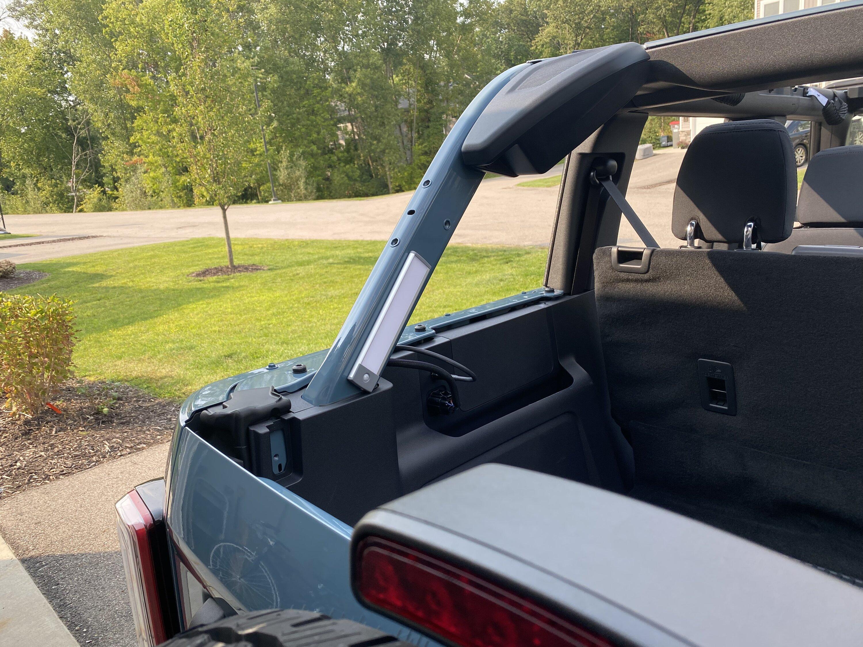

I'm rocking these. They are amazing. Photo and motion sensitive. Super slim. I put them right on the roll bar.
https://www.amazon.com/gp/product/B089QNNL8L/ref=ppx_yo_dt_b_asin_image_o02_s00?ie=UTF8&psc=1
I stumbled across your post a few months ago and purchased these lights. My Bronco finally arrived this week. Just curious, did you try putting them on the metal part of the roll bar first since they are magnetized? It feels strong enough to hold to me, but if you already tested and it failed I will secure them more. This is where I have them at the moment.

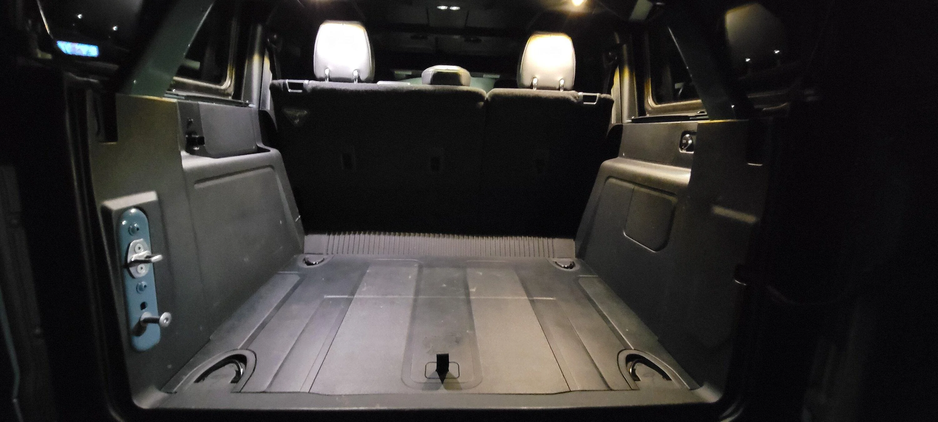

@Just_Jim I got it all installed this evening! I couldn't be happier with the results! I built upon your dome light wiring and added of all things; livewell lights. I got them on Amazon, they are made by Lumitec. I will link below. The color temp is really close to stock and now my cargo area lights up like it should have from the factory! I might add some in other areas in the future. Thanks so much for thinking outside the box! Check out how lit up my cargo area is now!
Lumitec Newt Livewell / Courtesy / Accent Light, Waterproof https://a.co/d/a2NTj7r
