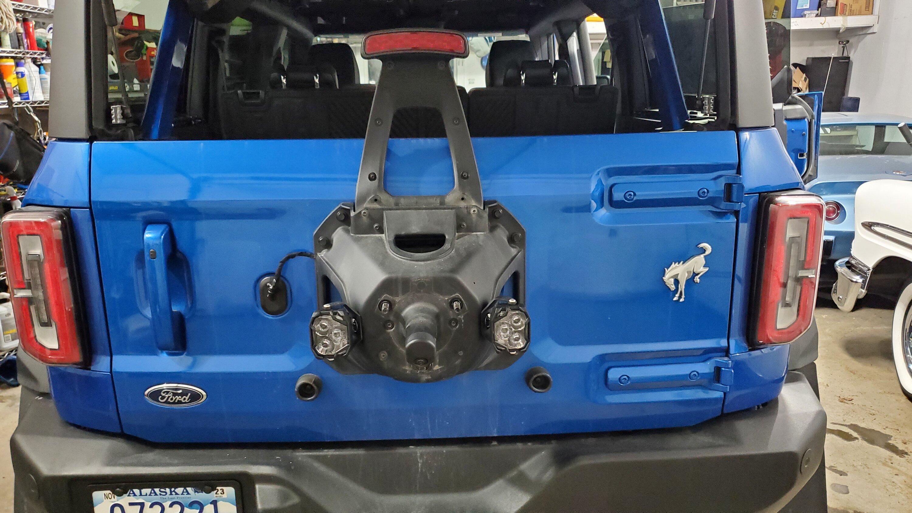

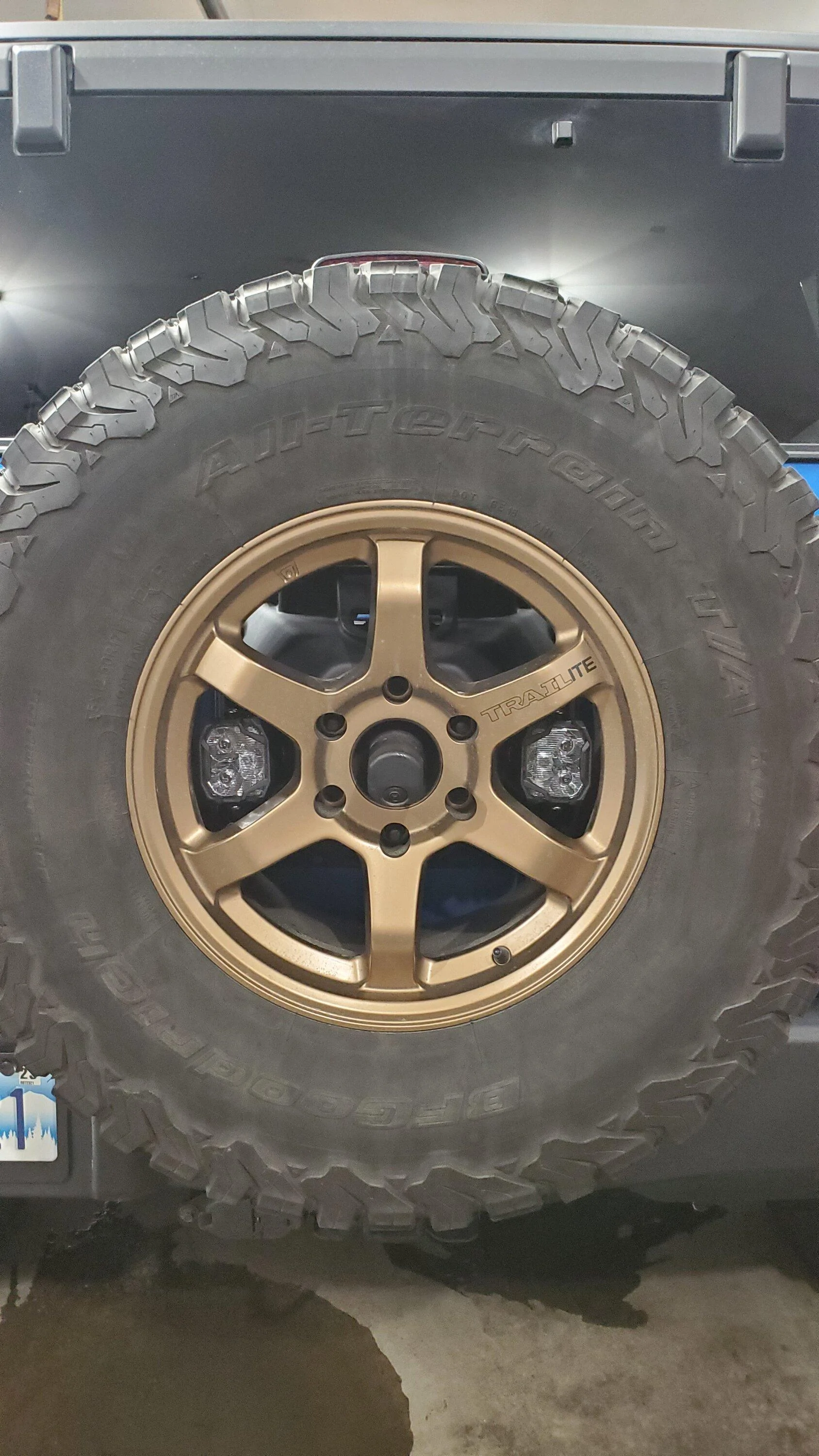

I've been meaning to put a set of lights in the spare, tried multiple different lights that didn't fit. Ended up with a free set of Morimoto 4bangers. They aren't the ideal beam pattern but will work for now. I wired them utilizing the factory wire ran to the rear QT panel hooked to AUX3.

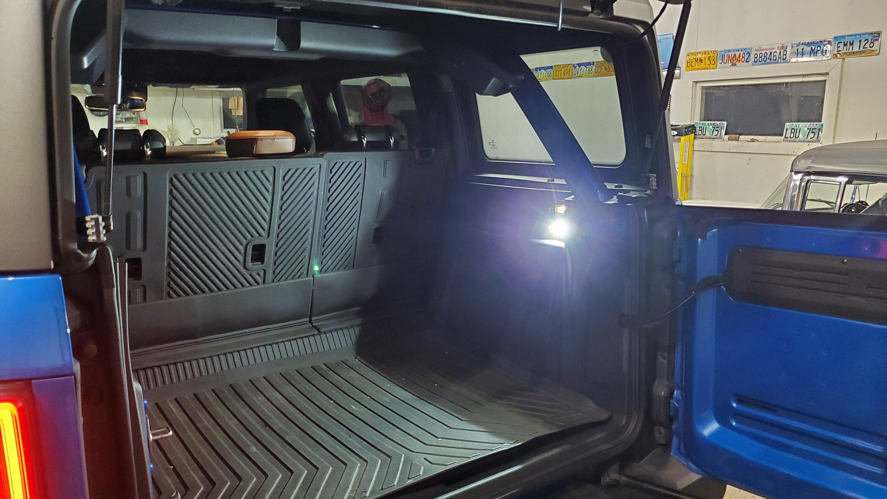

I also grabbed a small surface mount light, which is the size of most "rock lights" I mounted it under the factory cargo light and tapped Into the factory rear dome lamp.

Nice! For the lights you mounted in the spare, did you have to screw your own holes into the tire mount, or are there already some screws there? Thank you.
I had to drill holes in the spare mount and bolt the lights on with supplied hardware.

Think both turned out great. The pods fit perfect in the dimples on the spare tire carrier. Benefit is that you didn't have to pay for a bracket with the associate Bronco Tax. I've seen other aftermarket options that mount a bracket outside of the wheel above the camera which is a problem in the event of an emergency needing access to the spare tire. The problem in that scenario can be overcome by unmounting the bracket/lights, but it is just another layer to overcome in a scenario that doesn't need additional problems.
I'd be interested to see more on the cargo light and how you mounted/wired it. Can it be turned on/off independently of the rear cargo light?

That looks great! Nice and clean, and no additional mounting bracket needed! Love it!
