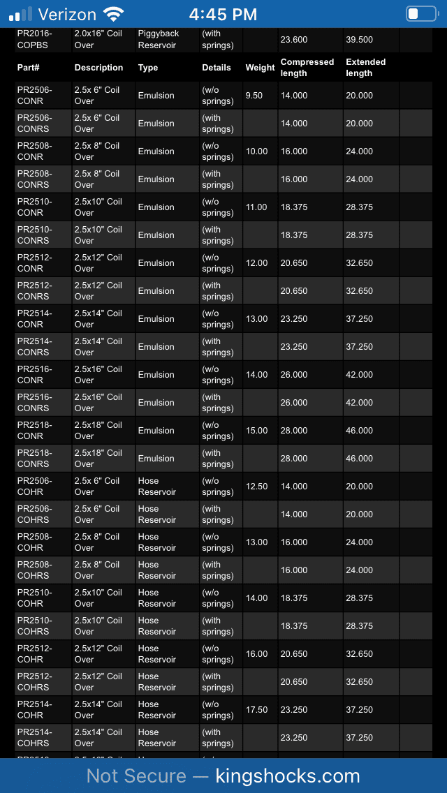

Does anyone happen to know the travel (extended vs collapsed ) on the various coilovers that are available for the bronco

Well what I am looking to do is move the shock mounts up on the rear axle and then possibly triangulating the 4 link in the rear by moving the top link mounts back on the rear axle tube and moving the frame mounts back far enough to get around the gas tank so for the coilovers I am looking for the amount of shock travel so as not to limit my up travel by moving the mounts up in front I intend to install long travel arms

Check out Kings web site. It list the lengths. I am doing something similar swapping the 28” to 32” total length.

Please if you could give me a comparison and if you know actual expanded and collapsed lengths I can't seem to find any of this published I wish someone made shock hats that would allow me to run regular coilovers. I have always wanted to work with accutune when I was running my jeeps just never got the chance. Their setups seem really well researched and take alot of the guess work out

Ford Bronco after market coil overs 66DF246E-3E99-430C-B681-F2501A0C9A1C
Are these regular coilovers or assembled bronco coilovers
