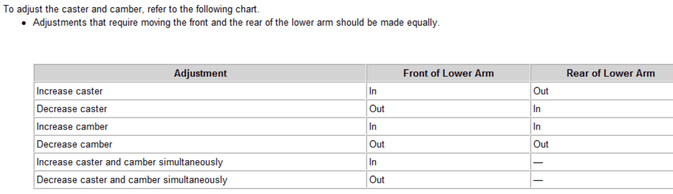

Adjusting Castor and Camber is on the lower control arms. Here is how you do that in general with eccentrics on the lower control arm.

Here is how the caster & camber adjustment is done for Bronco using the two cam bolts on the lower arms. If front alignment to spec is not possible, parts probably need to be replaced (bent, etc). Just look at the cams and see if they are already at min or max offset (no adjustment range left). An aftermarket UCA can provide additional adjustment range.
The rear is not easily adjustable (just a check for bent frame, etc).
