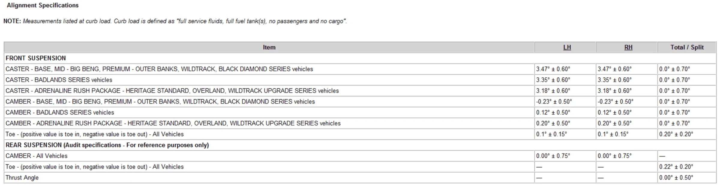

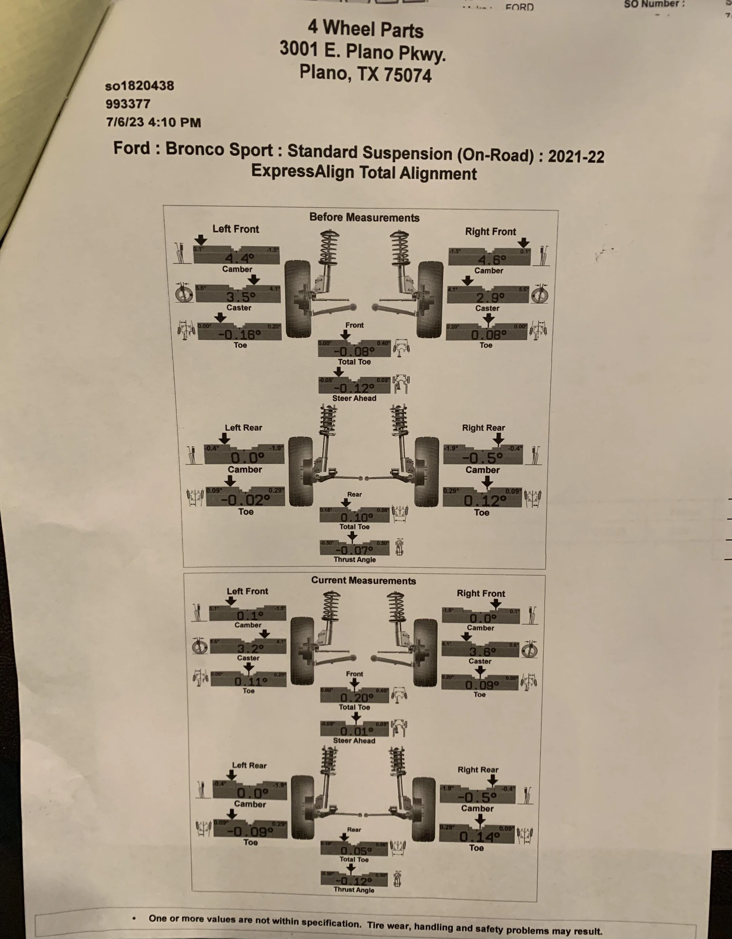

I have a ‘23 Badlands Sasquatch 2.7 and had a 1.25” level kit put on the front at 4WP. They also did an alignment afterwards. On the way home I noticed the steering wheel was off center so took it back a few days later and had that fixed. I was just filing the paperwork and noticed the spec sheet said Bronco sport. I called and they told me that didn’t matter bc the guys in the back know the difference and know what they are doing. That didn’t seem like a good explanation and gave me an uneasy feeling I understand about alignments and factory specs - what is semi-voodoo to me is the difference in before and after.
So I thought I would throw this out there for the more knowledgeable folks to get their take on the numbers on the printout. Can someone explain and maybe verify the after measurements are ok? Thanks for any help.
Ford Bronco Alignment Question ?? IMG_6602

My insurance shows my Bronco as a Bronco Sport as well. We smart humans know the difference but those dumb computers can't seem to tell the difference. 😂
