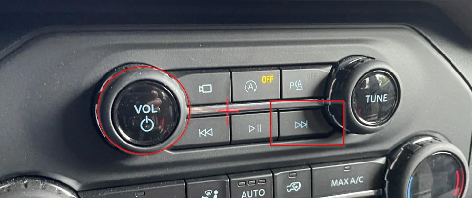

I have found that a lot of odd issues (phone not connecting, loss of sound, dropping out of XM, etc.) are corrected with a 'soft reboot' of the Autio system. Use the Power+FF

I put a post-it on my dash to help me remember this and then didn't have to use it for about 4 months. Saved me from pulling over and shutting down completely.

Reboot the radio as @helifino16 stated above.
I have tried the soft reboot multiple times and it has not helped. The truck has not updated since February 2025 and my phone since Nov 5th 2025. This connection loss deal just started in the last week or so.
